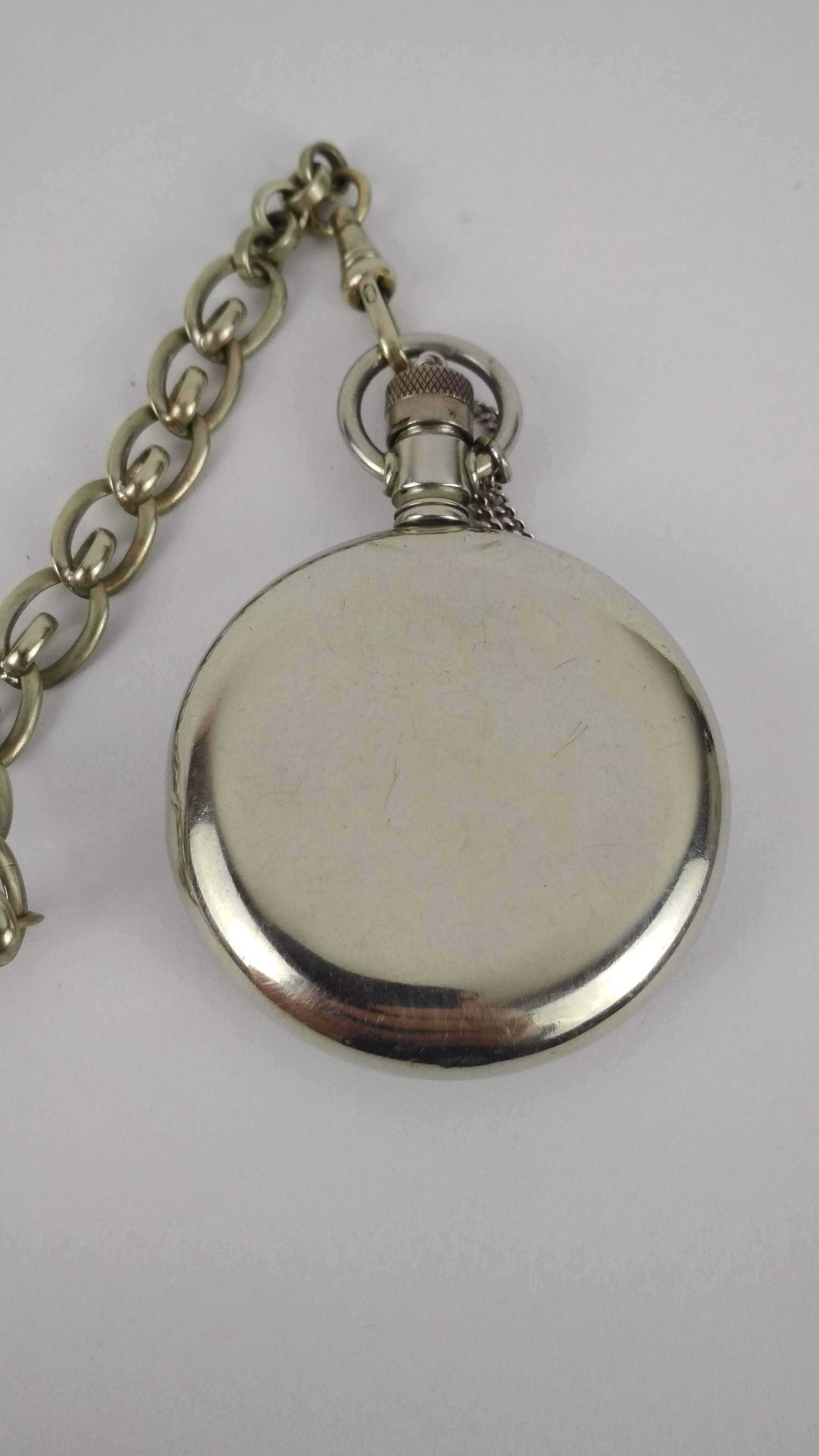

Omega pocketwatch
8

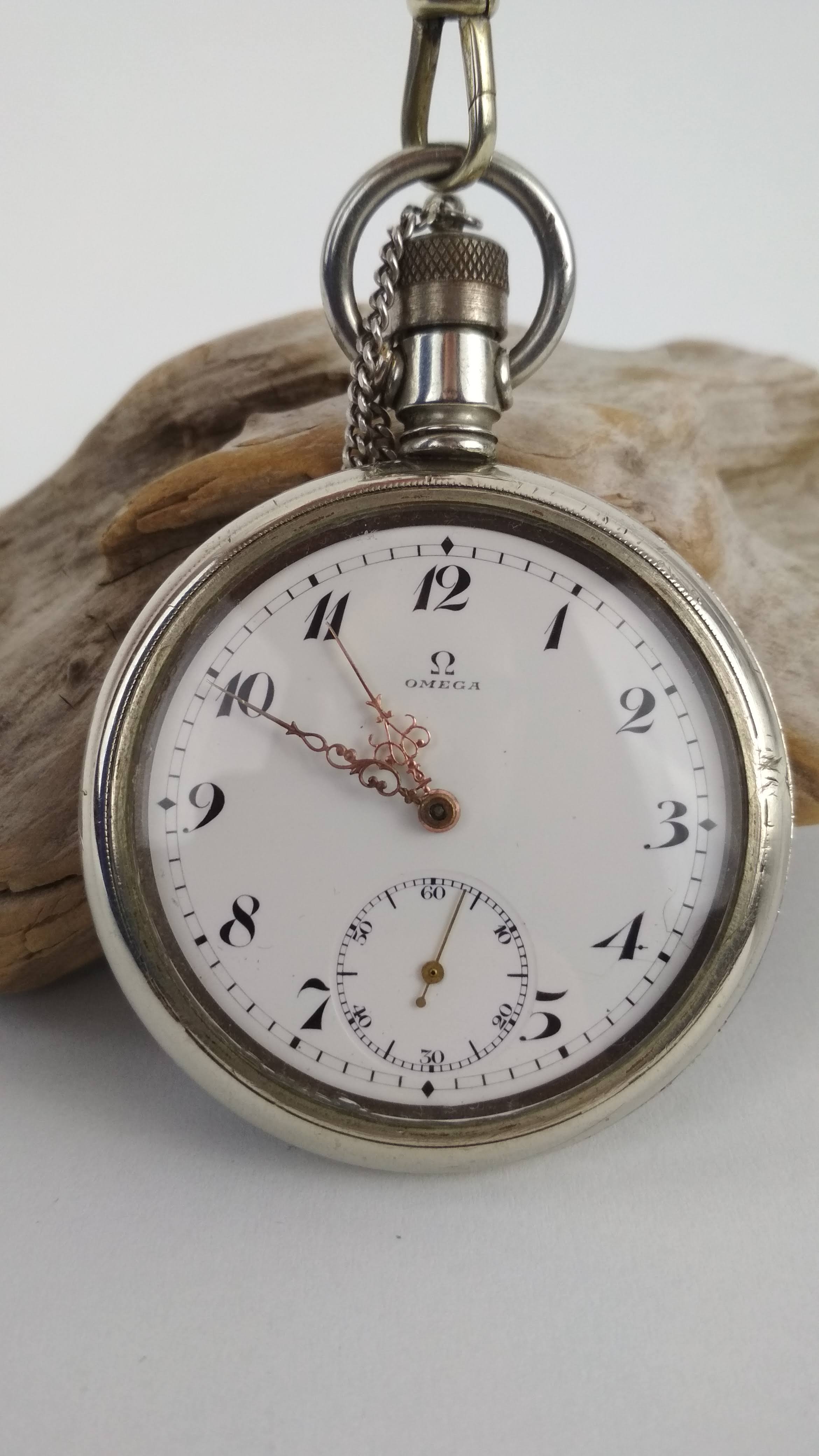

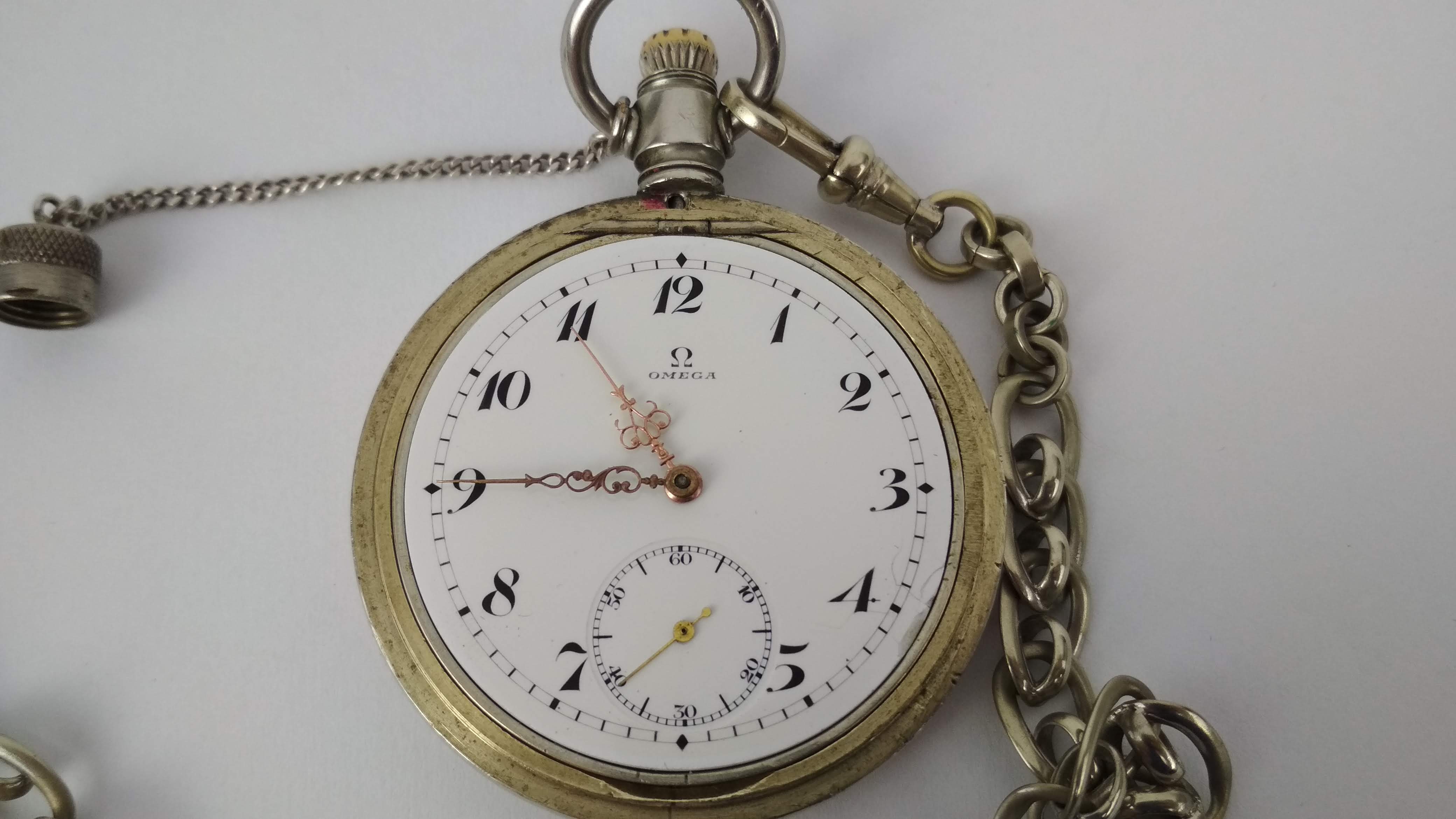

Hello, I have a question about Omega's "pocket".
What is the professional name of this screw cap, is it a standard closure or protection?
What is it for, whether it was protection for the more working Omegs, I also met with the indication that it was a military omega.
15,996
48,111

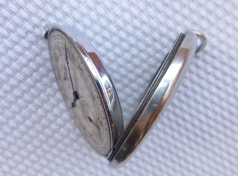

I think the answer to your question (as I interpreted it) is that this style of case is called a “swing ring” case. There is only a front cover, and no removable case back.
1,884
9,610

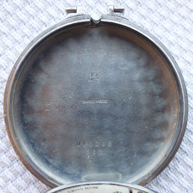

I think it is a a first example of a waterproof case, similar to FB cases
18,840
39,182
I think @bubba48 is on the right track.
Let me see if I can remember where I saw something like this.
8
JimInOz, thank you for link. So this is the so-called explorer's watch. And the idea for the twisted crown is the work of Fitch from the late 19th century. Did I understand correctly?

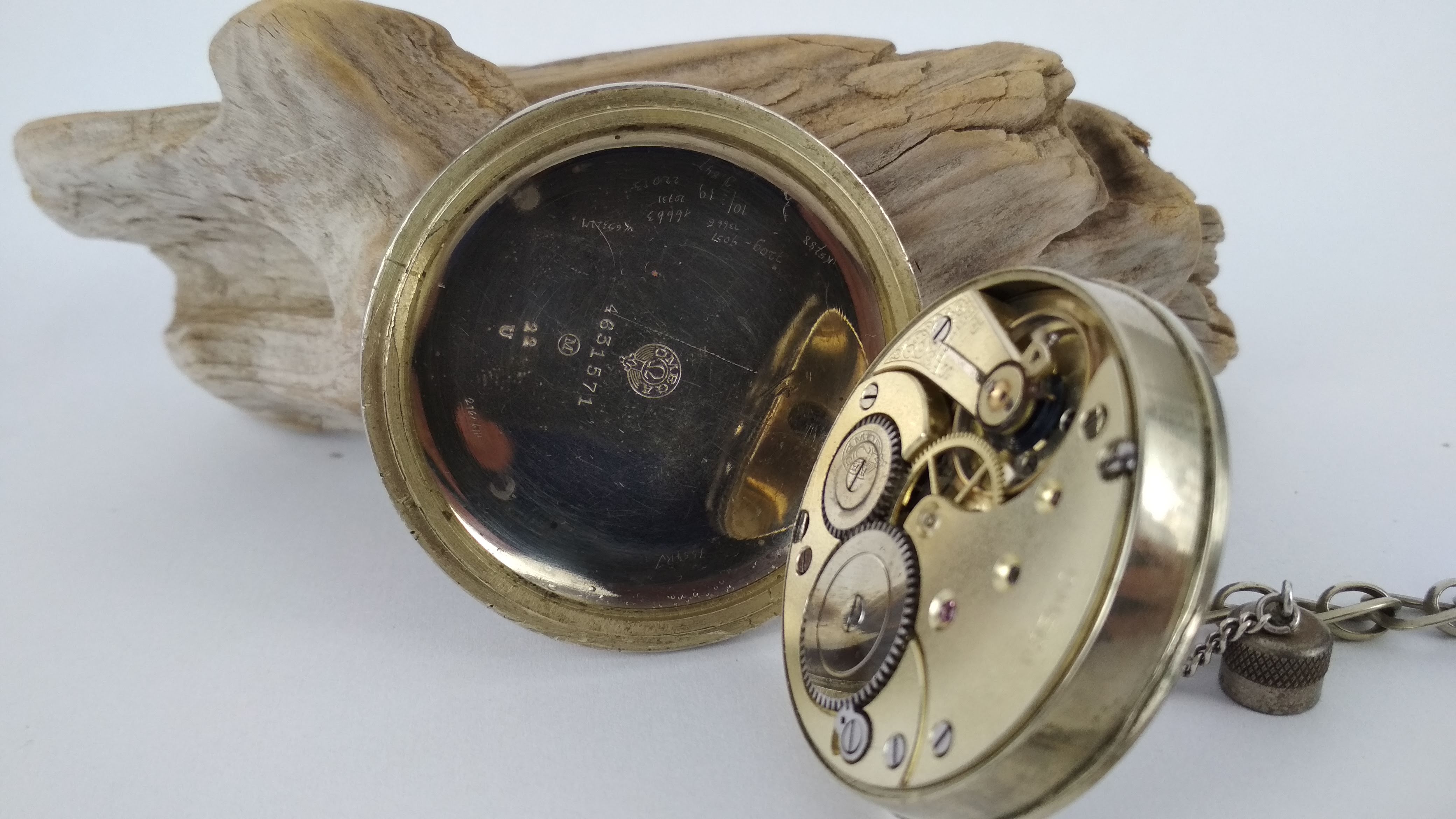

Or maybe you still know what the symbols M, 22, U mean? These are not typical British or Swiss markings.
I apologize for my English but I am assisting with Google translator...
