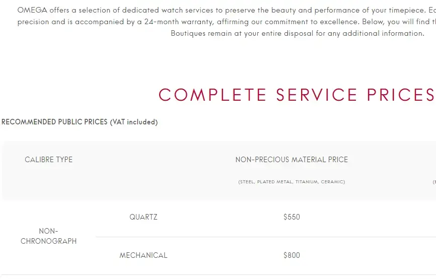

My 2200.50 45mm PO is speeding up on me. Prior to my April 2026 purchase, it had what appears to be a 2024 partial service of some sort via a card I received with the watch with no information on the servicer but at that time running +4spd. I verified that with the Atomic Clock & Watch Accuracy app. It's been creeping faster over the last 6 weeks currently +9-10 spd. If I were to take it to the OB in Scottsdale (not having had the best of experiences there) what could I expect in terms of a full service $$-wise and would it get sent to Geneva? I also have a relationship with a California Omega AD where I purchased 2 Longines watches in the last 2 months. What might a full service involve? Thanks

They will send it to the Swatch Group (Omega) service center in the Los Angeles area (Culver City), which is the closest.
But I would first get the watch demagnetized and see if that fixes the issue. You can do it yourself.
