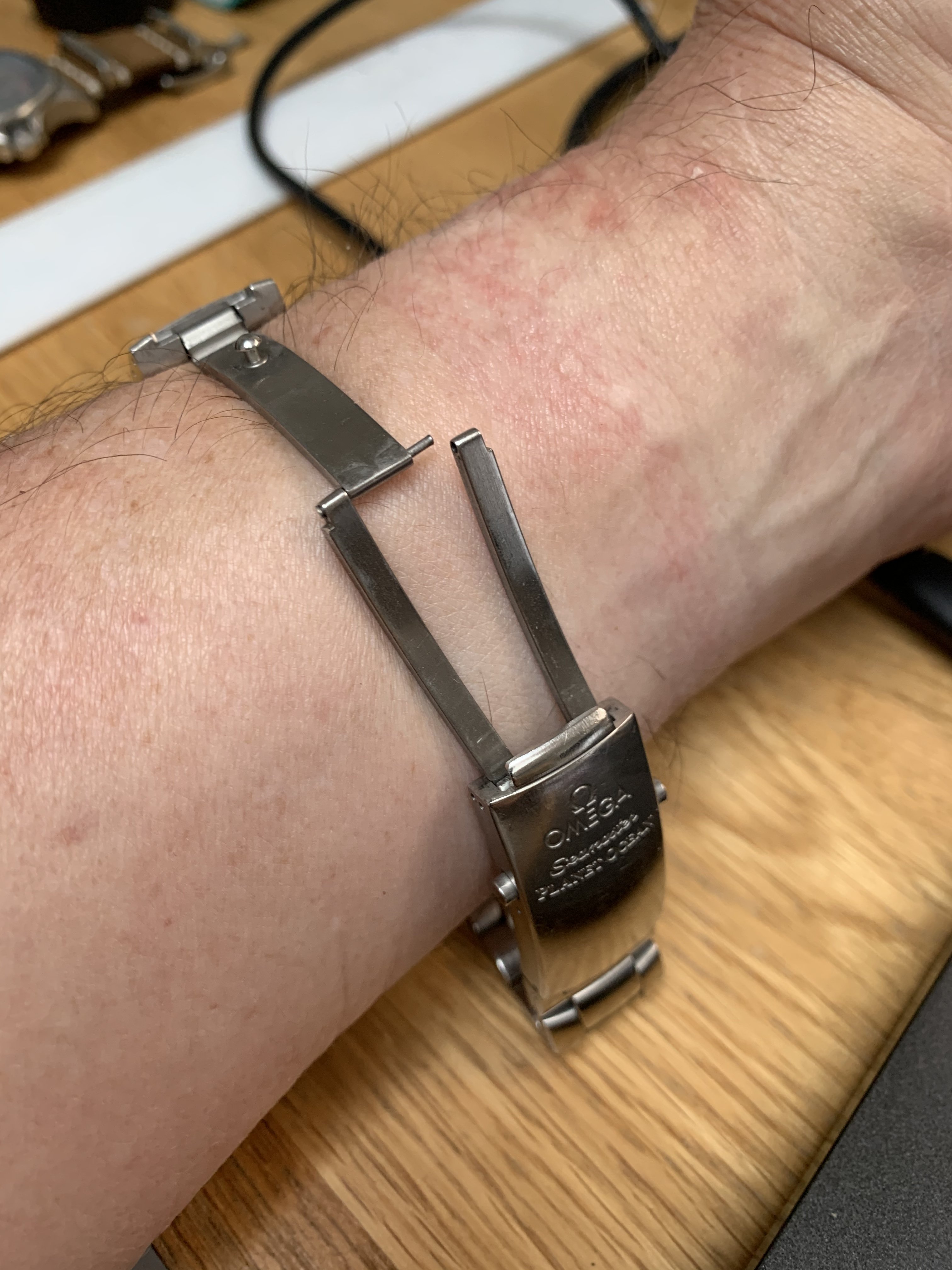

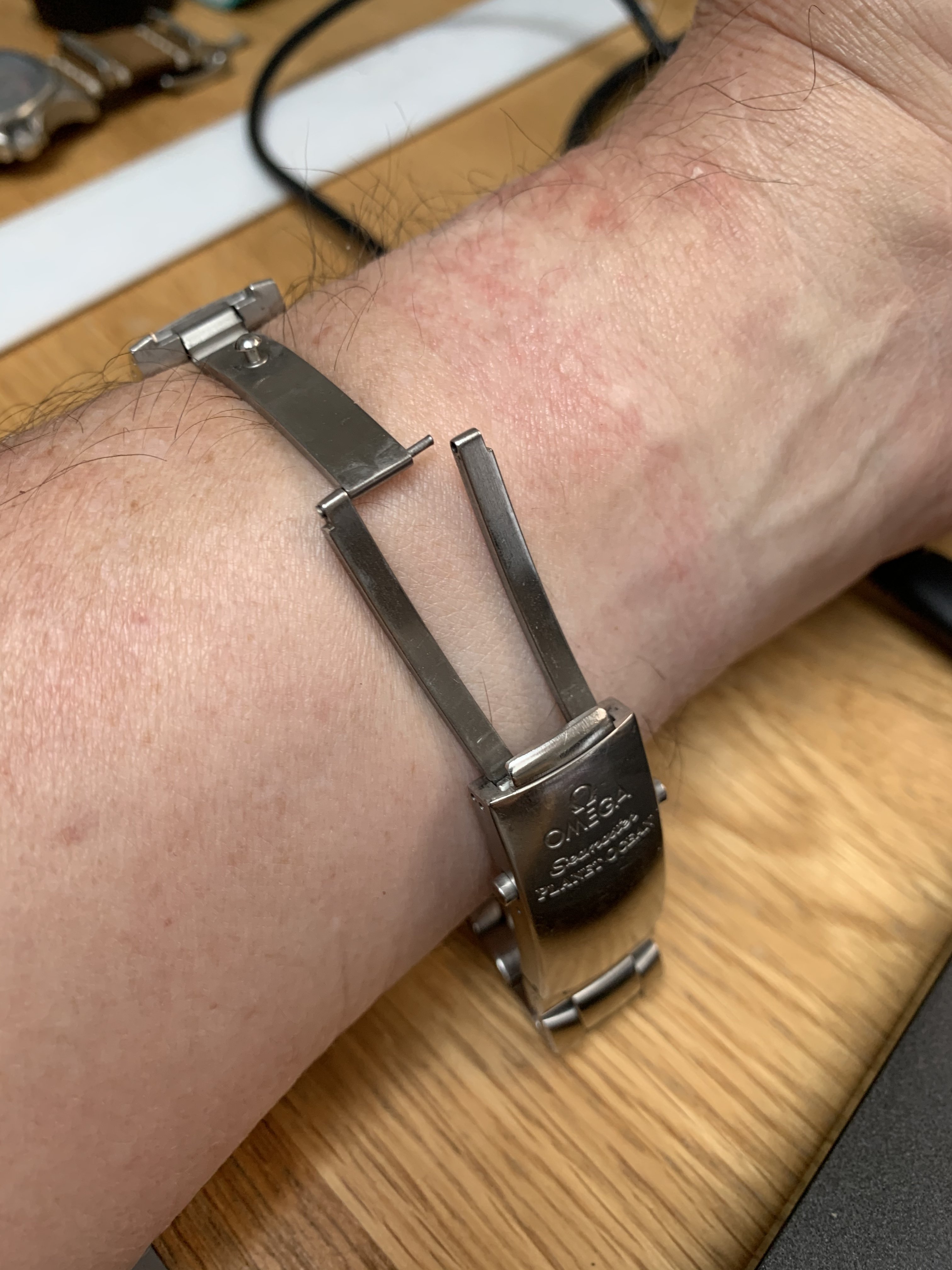

Anyone have a solution for this predicament.
It has actually happened before and was repaired in a dodgy back street watch shop.
For 5 years I’ve had no issues and in the meantime the watch was serviced by Omega in 2018. Not sure if they include the strap but if it was functional would they have changed it??
Anyhow I need a repair solution without having to resort to spending another £500 on a service!

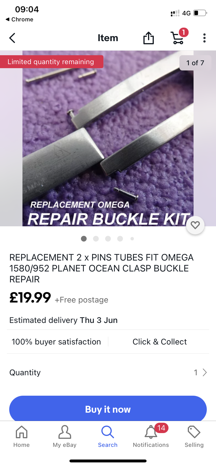

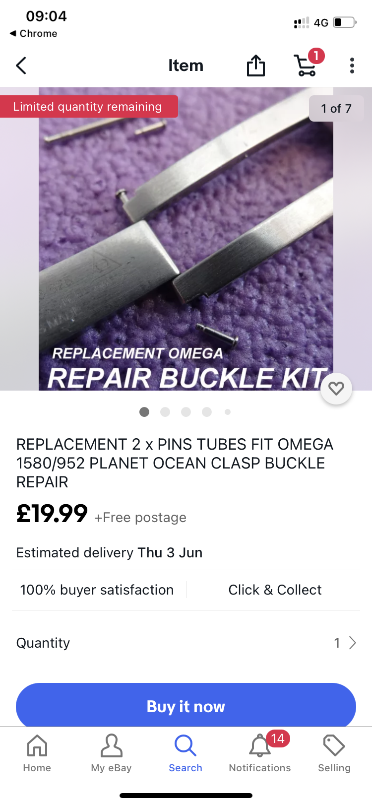

Found this on line- it’s an eBay special solution. Seems technically sound as it appears to positively engage with those swage points
Any advice welcomed

Typically with this Omega would replace either the entire clasp of the steel underpiece if the rest is in good shape. Assuming this is a 1580/952 bracelet, the underpiece is not available for this bracelet so the entire clasp would be replaced. Clasp parts number is 117ST1580952.
Cheers, Al
287
444
Probably the safest is to replace the whole clasp anyway.
If you can handle the work yourself (not different from removing/adding links) you can have a local major AD or a boutique to order the clasp for you, Archer just provided the part number above. I reckon it will be in the 200 euros range.
It's £219 in the site below, which is know for being generally overpriced:
https://www.swisswatchspares.com/pr...t-ocean-1580-952-steel-clasp-bracelet-2201-50
