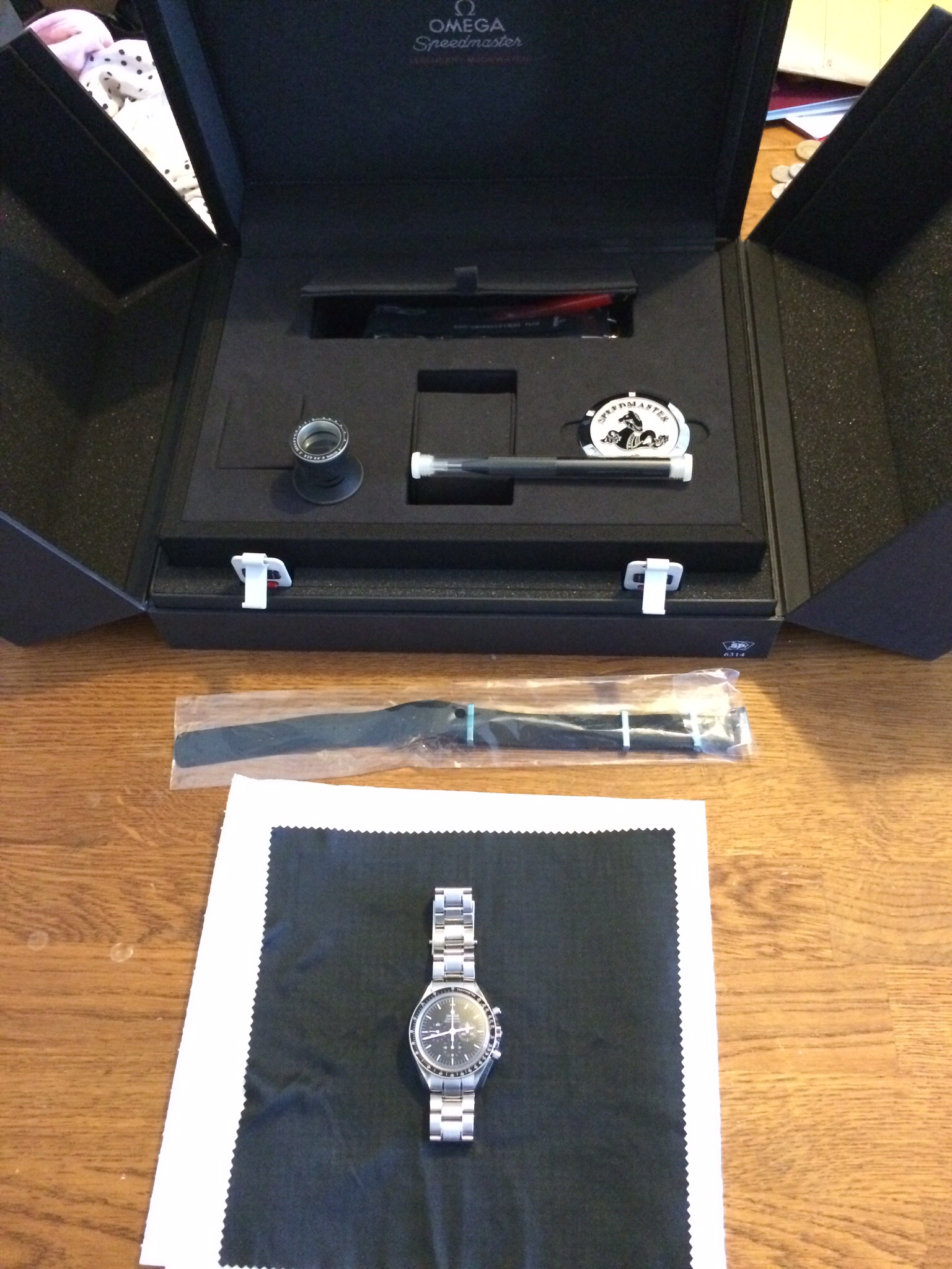

I want to save the bracelet on my Speedy from the daily scratches etc that it seems to attract, so I'm going to be putting it on the supplied NATO from the new box. Any tips on switching besides masking the lugs and taking it steady? Ideally I'd want the option to switch back to the bracelet (or even buy a leather strap or two) if I want to dress it up a bit and I'll be more inclined to do that if it's an easy, 5 minute job!

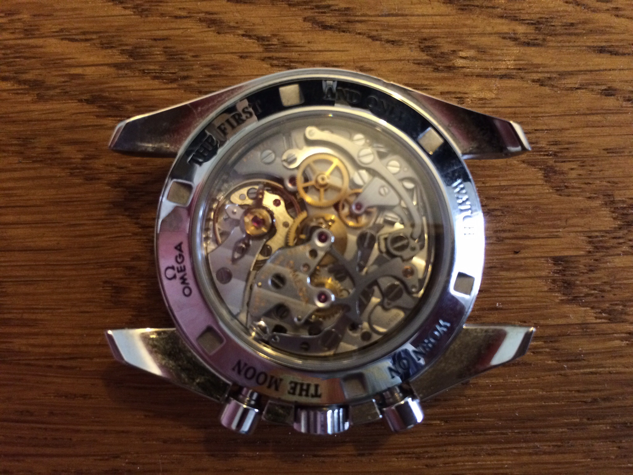

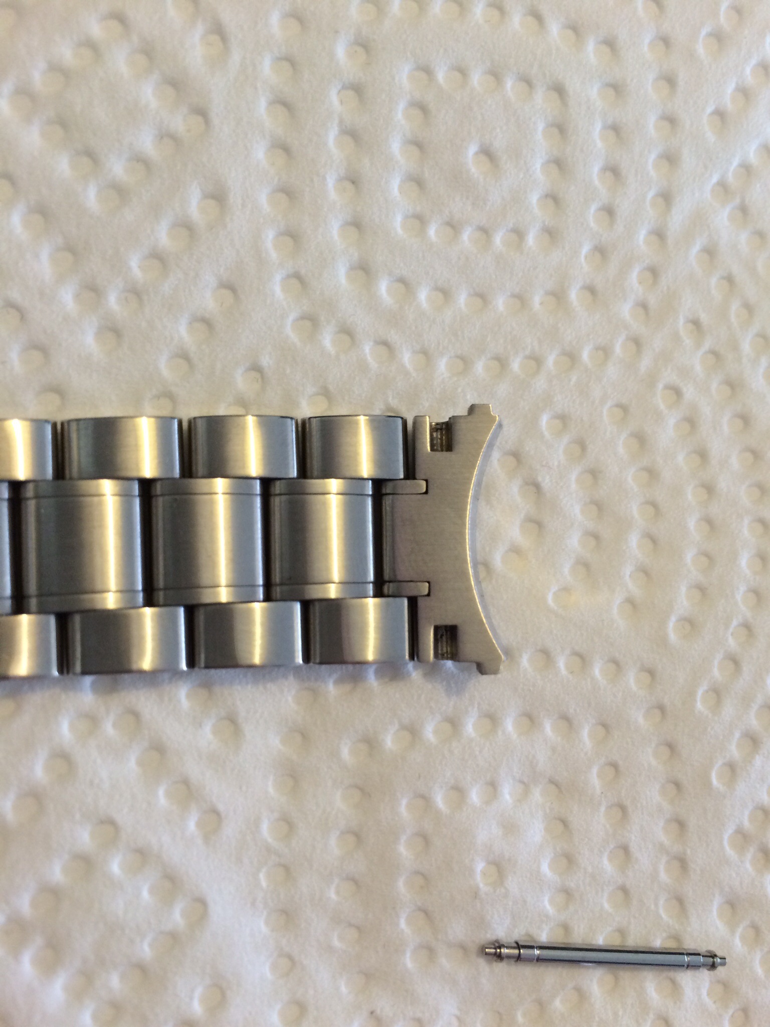

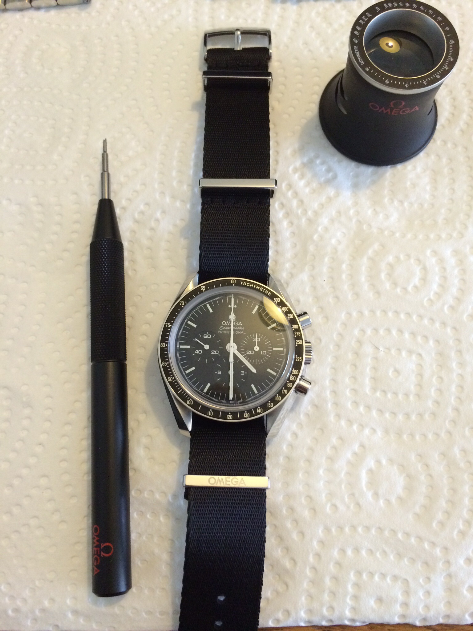

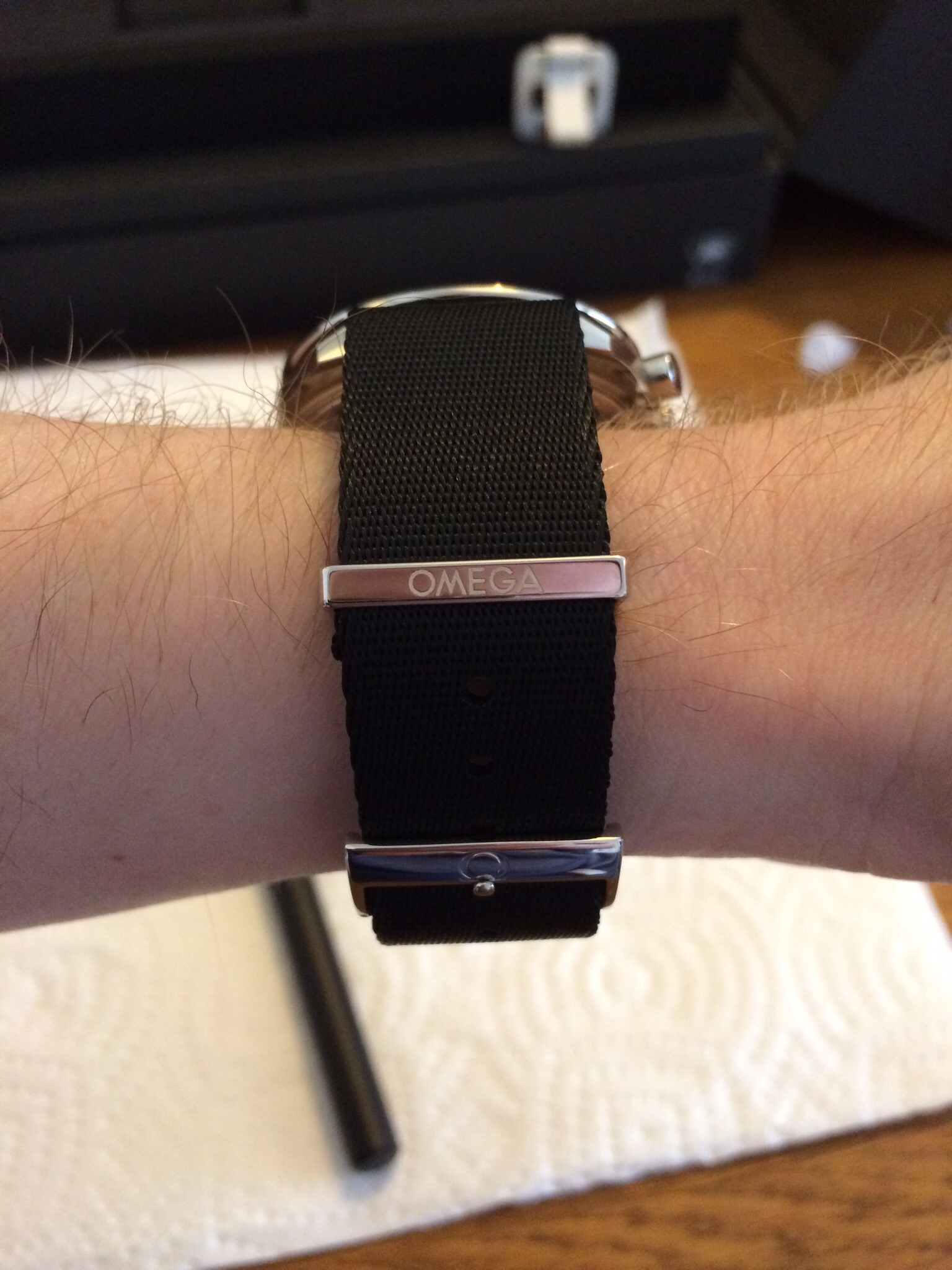

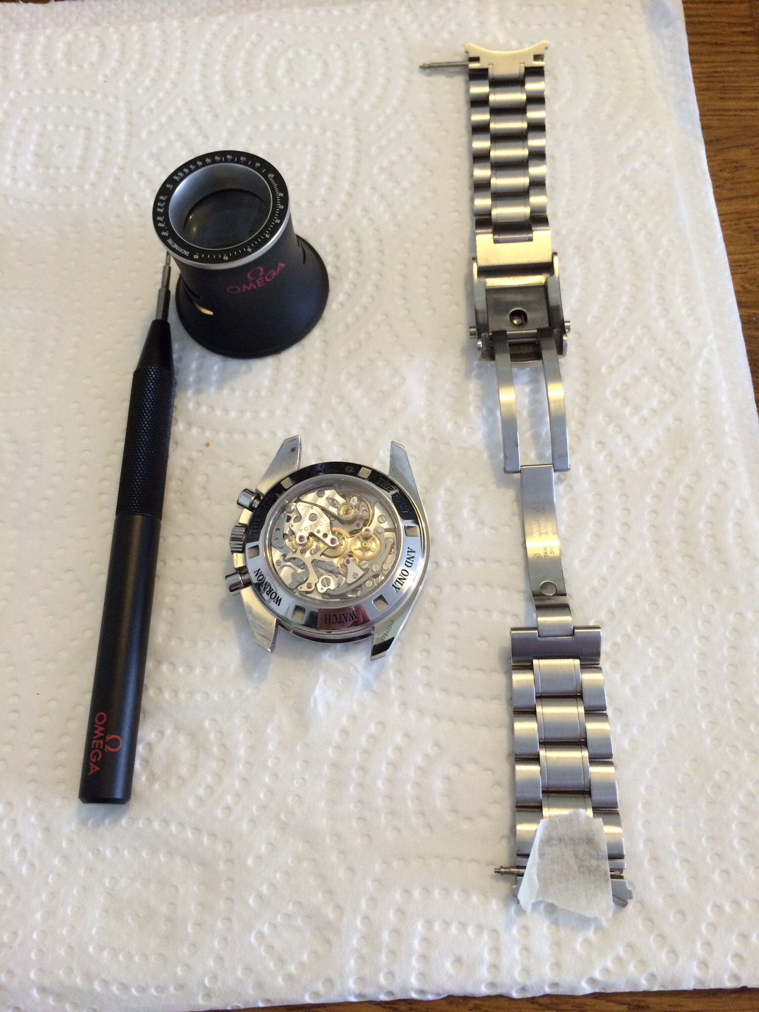

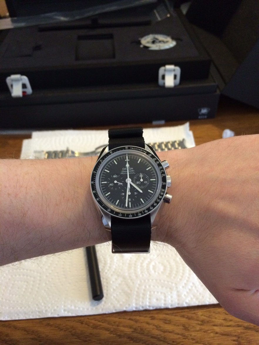

So, I gave the switch a go today. A little tricky to start with but got the bracelet off after a couple of minutes fiddling.
However, the small retaining lugs on the bracelet scratched the underside of the case lugs when I slipped each end off!
The worst scratch is on the top-left lug. What did I do wrong? I know it's on,y the underside, but still annoying and I'd rather I hadn't scratched it! Anyway, the results...

Ooph, sorry you ended up leaving a scratch mark via the bracelet solid end links as opposed to the from the changing tool. One trick with solid end link removal is to do it via pushing up towards you (ie towards the case back) instead of out away from where the case meets the lugs. Of course you have to remove the spring bar before doing this, which takes some careful wiggling, but it ensures that the little "wings" on the solid end links don't end up dragging across the backs of the lugs.
One good thing is that the scratch doesn't look to bad and/or deep, so a slight polish with a Cape Cod cloth should be enough to remove the imperfection.

If you run your fingernail across the scratch and the nail catches and doesn't just "skip" over then no amount of polishing will get rid of those deep gouges, so you'll probably need a new case or just have to live with the scars which isn't too bad in the long run; they add character!
