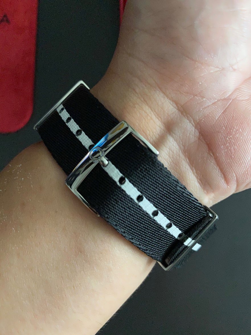

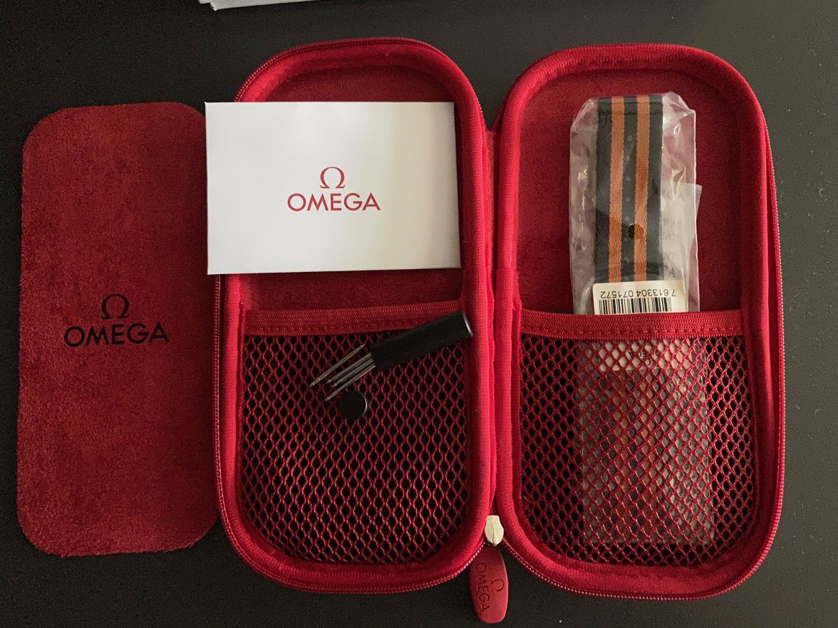

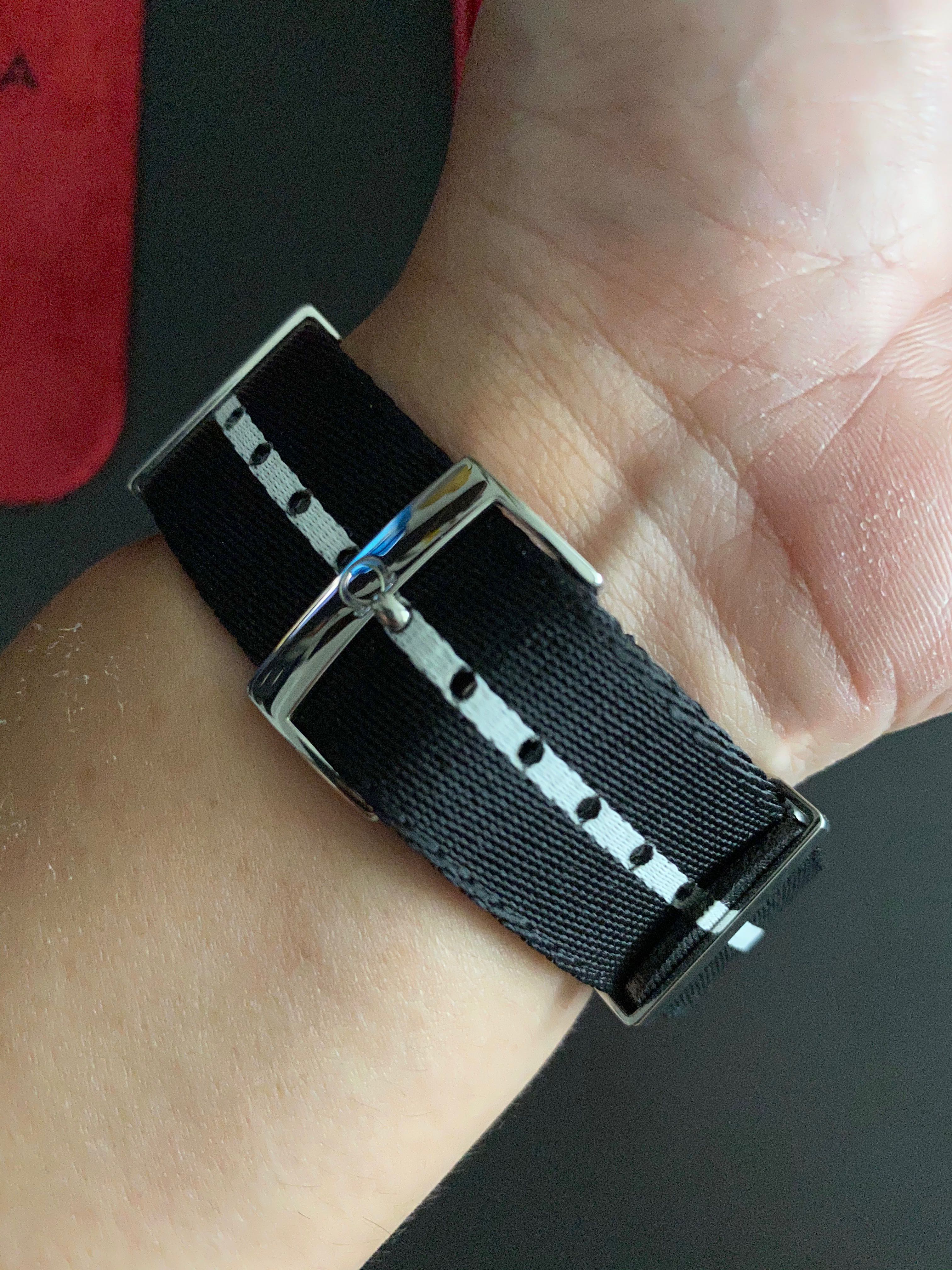

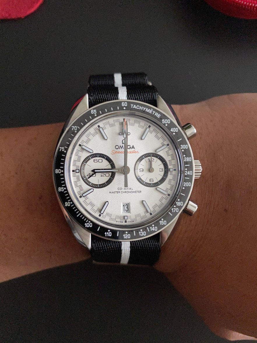

Hi - hopefully I'm able to help out the community with some details of Omega NATO straps I recently purchased for my Speedmaster Racing Co-Axial Master Chronometer directly from the Omega online store.

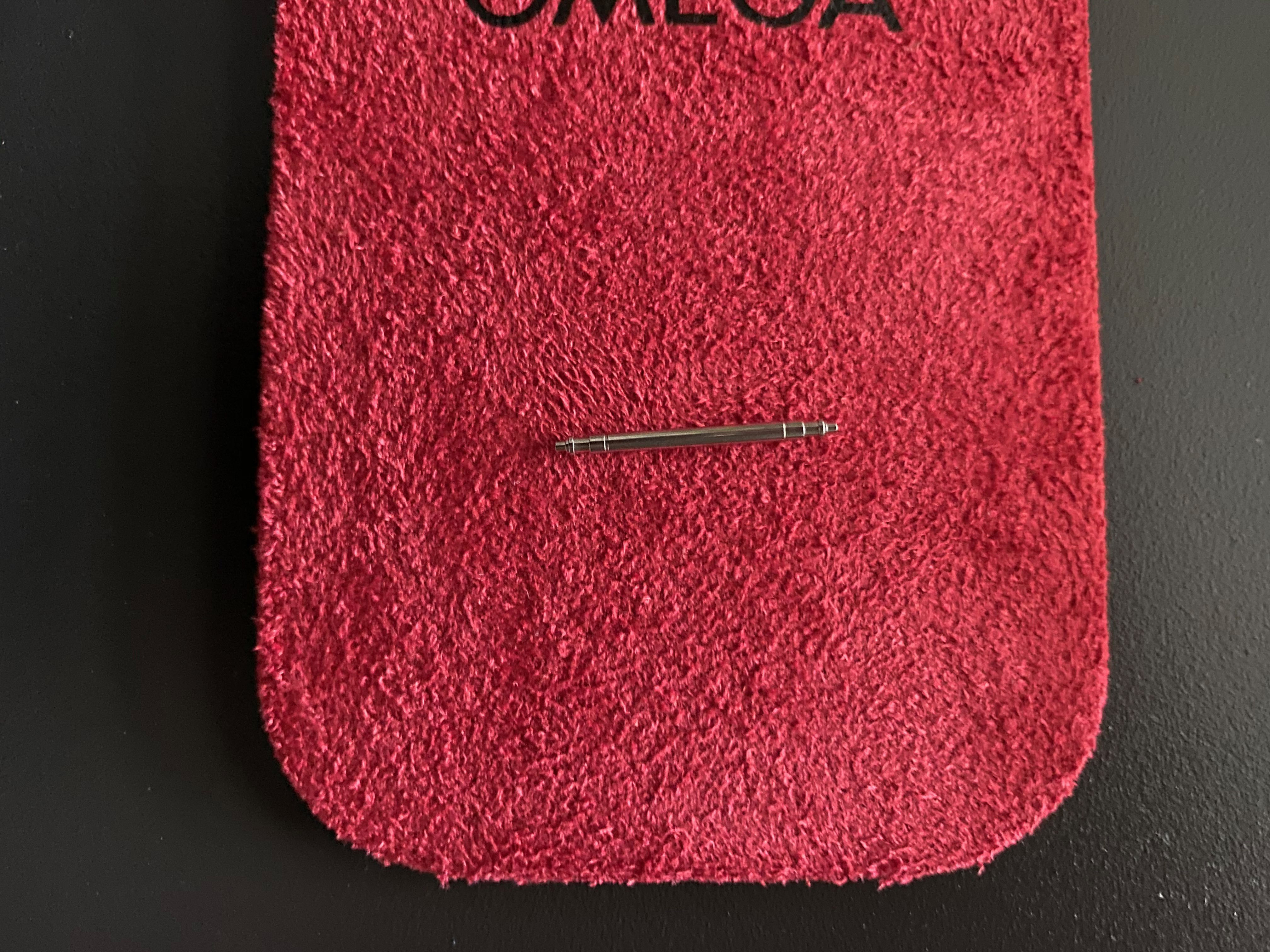

The straps come in beautiful packaging from the Secaucus, NJ Swatch Group Center as seen in photos. There are two sets of new spring bars included with each strap, though I ended up using the same bars from the Omega leather straps I had on my timepiece previously. There were no fit issues threading the NATO through those bars.
The straps themselves are soft, high quality nylon and the added touch of Omega badging on the metal pieces helps differentiate these from 3rd party manufacturers. The only downside I see is that the glossy finish on the metal pieces will scratch rather easily, but that is to be expected.

Nice pairing of NATO and your timepiece! It took me a while to move to a NATO strap as well but the wearability and comfort is there, especially during the warmer months.

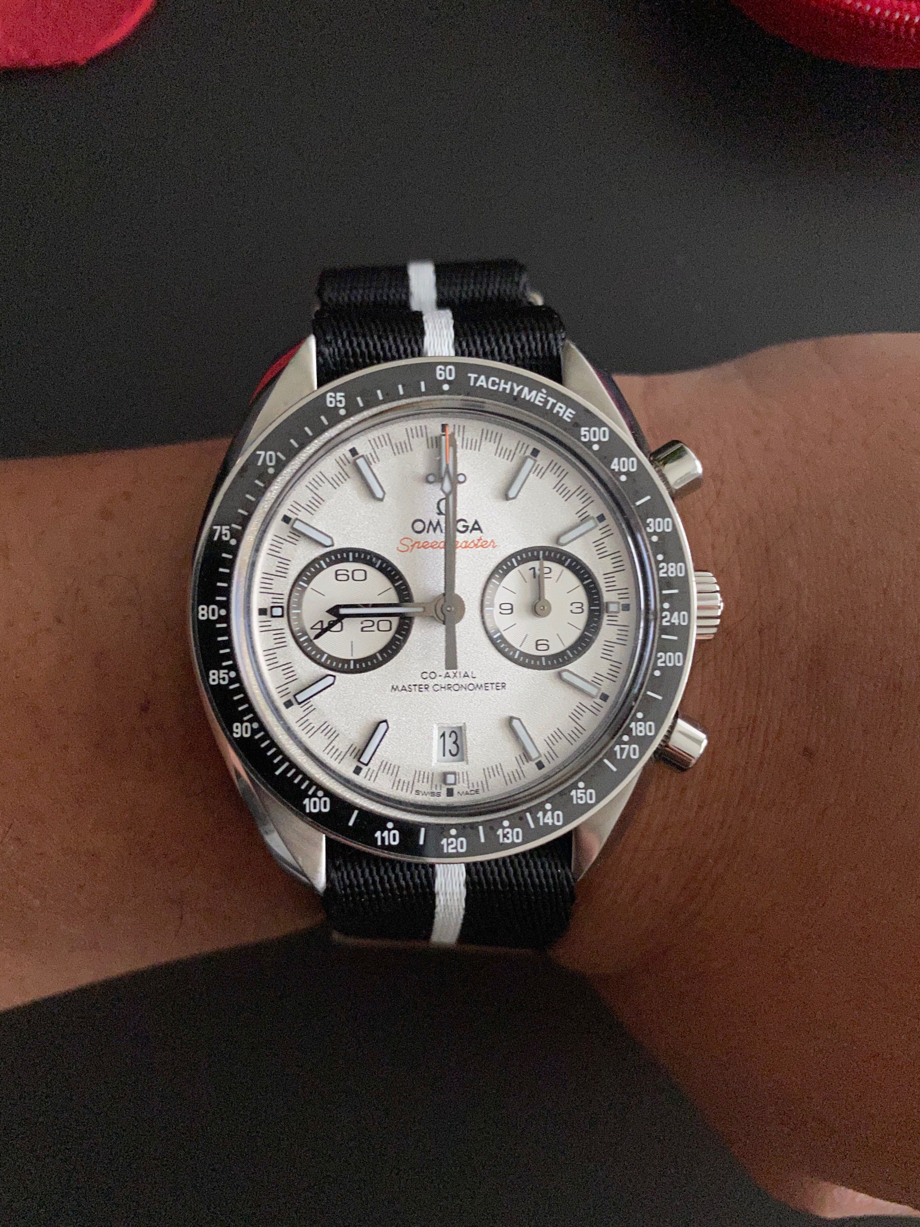

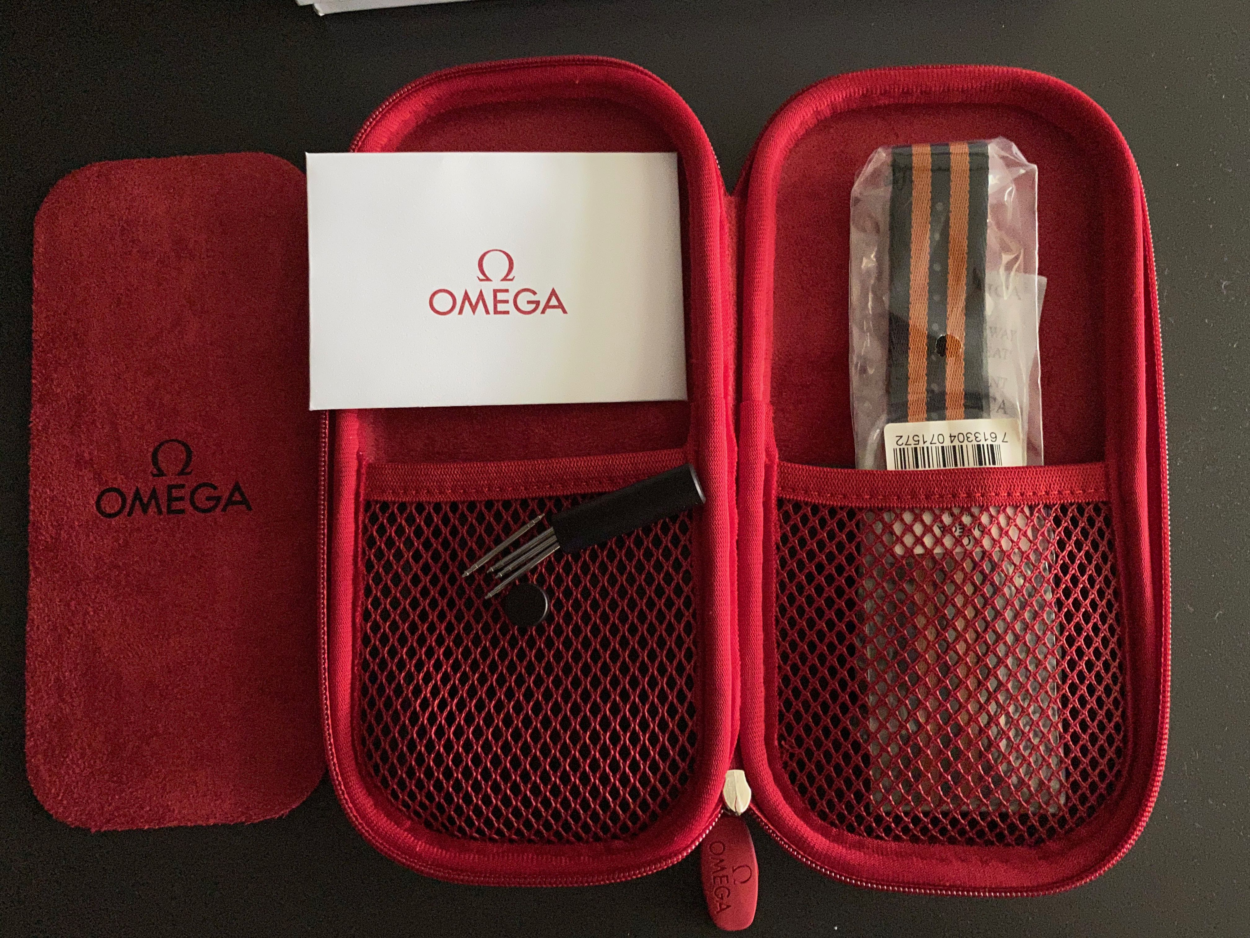

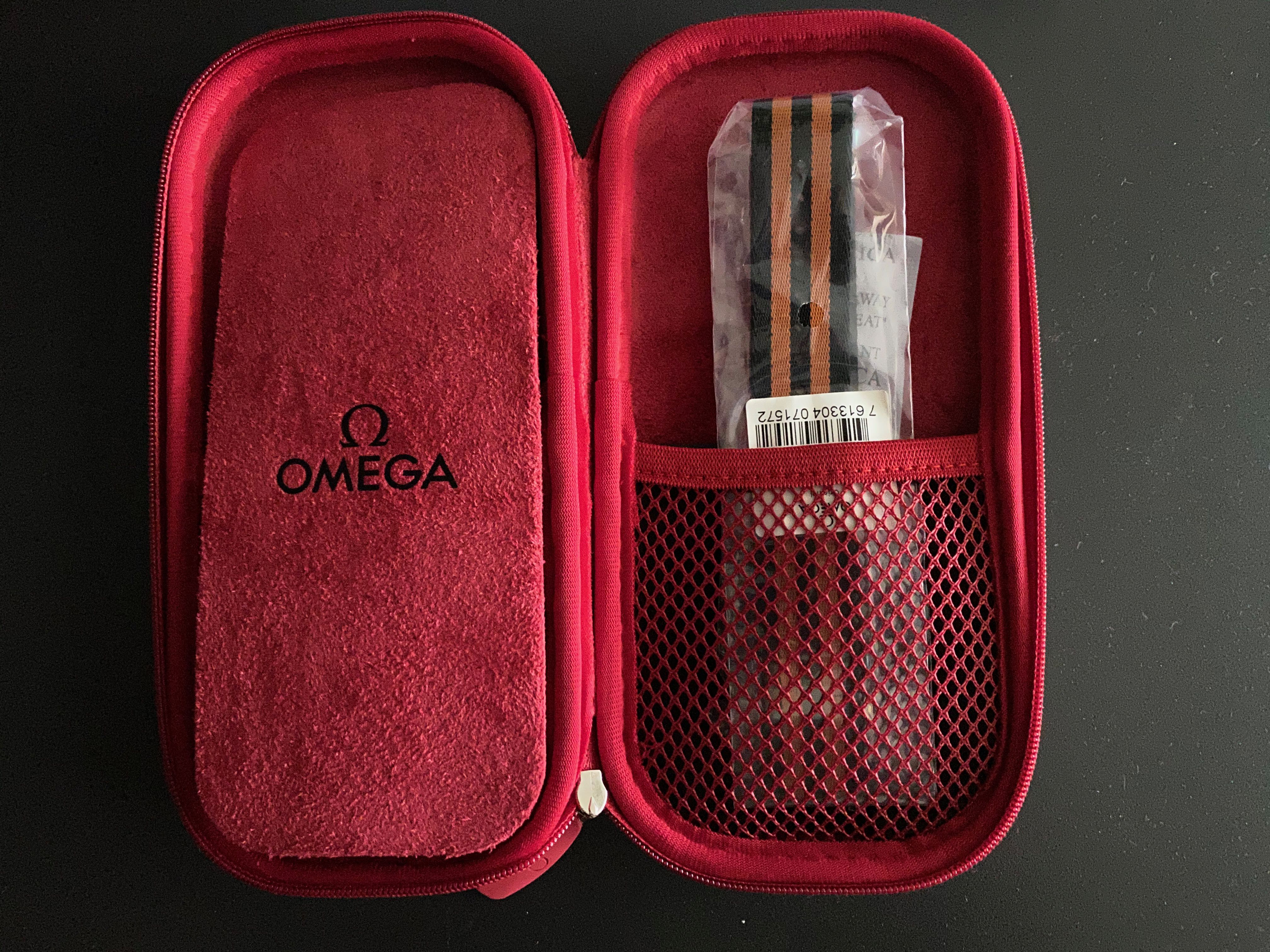

Hi - hopefully I'm able to help out the community with some details of Omega NATO straps I recently purchased for my Speedmaster Racing Co-Axial Master Chronometer.
The straps come in beautiful packaging from an Omega boutique as seen in photos. There are two sets of new spring bars included with each strap, though I ended up using the same bars from the Omega leather straps I had on my timepiece previously. There were no fit issues threading the NATO through those bars.

Oh wow, mine did not come like that, I bought it from an AD and all I got was the nylon bag with the strap.
Did they "steal" my case?
I purchased mine directly from the Omega website, so I should correct my post to say that it came from the Swatch Group center in Secaucus, NJ. Interesting that they don't provide the same level of packaging from a boutique.

Can anyone who bought his Omega NATO at an AD confirm if he got it in the same case as OP?
6,489
31,963
My understanding is this is only provided when ordering online.
1,407
2,780
My Nato came in the red box when I ordered online, spring bars were present, I also received an Omega tool in the box which was unexpected as they are usually charged as an extra and I didn't order one.

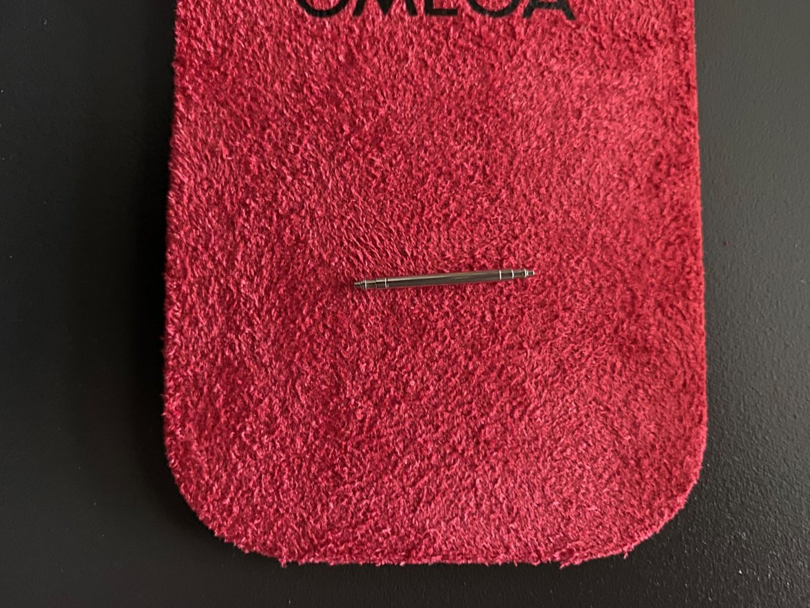

Pkg now in Indianapolis. Guess it didn't like Newark too well. Tomorrow I'll find out what I get. To those who got spring bars were they curved? 007's appear straight.
I only received curved bars for leather straps - but from experience, curved bars work better on all NATOs.
If you don’t want to buy official Omega spring bars, you can order some from Amazon. Just look for the Swiss-made, 1.8 mm ones.
