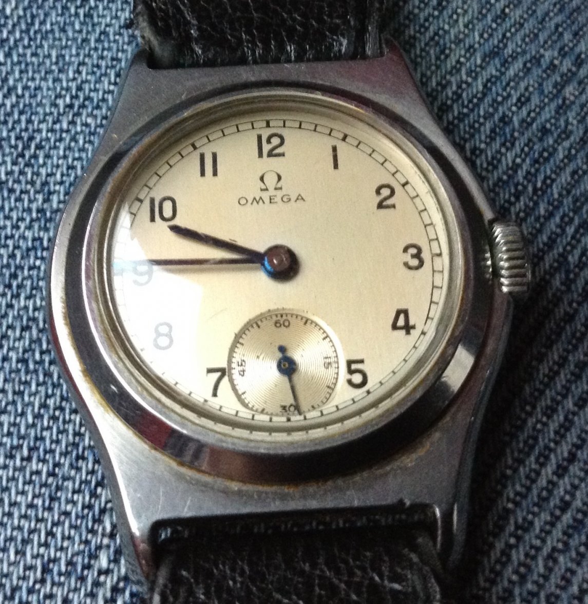

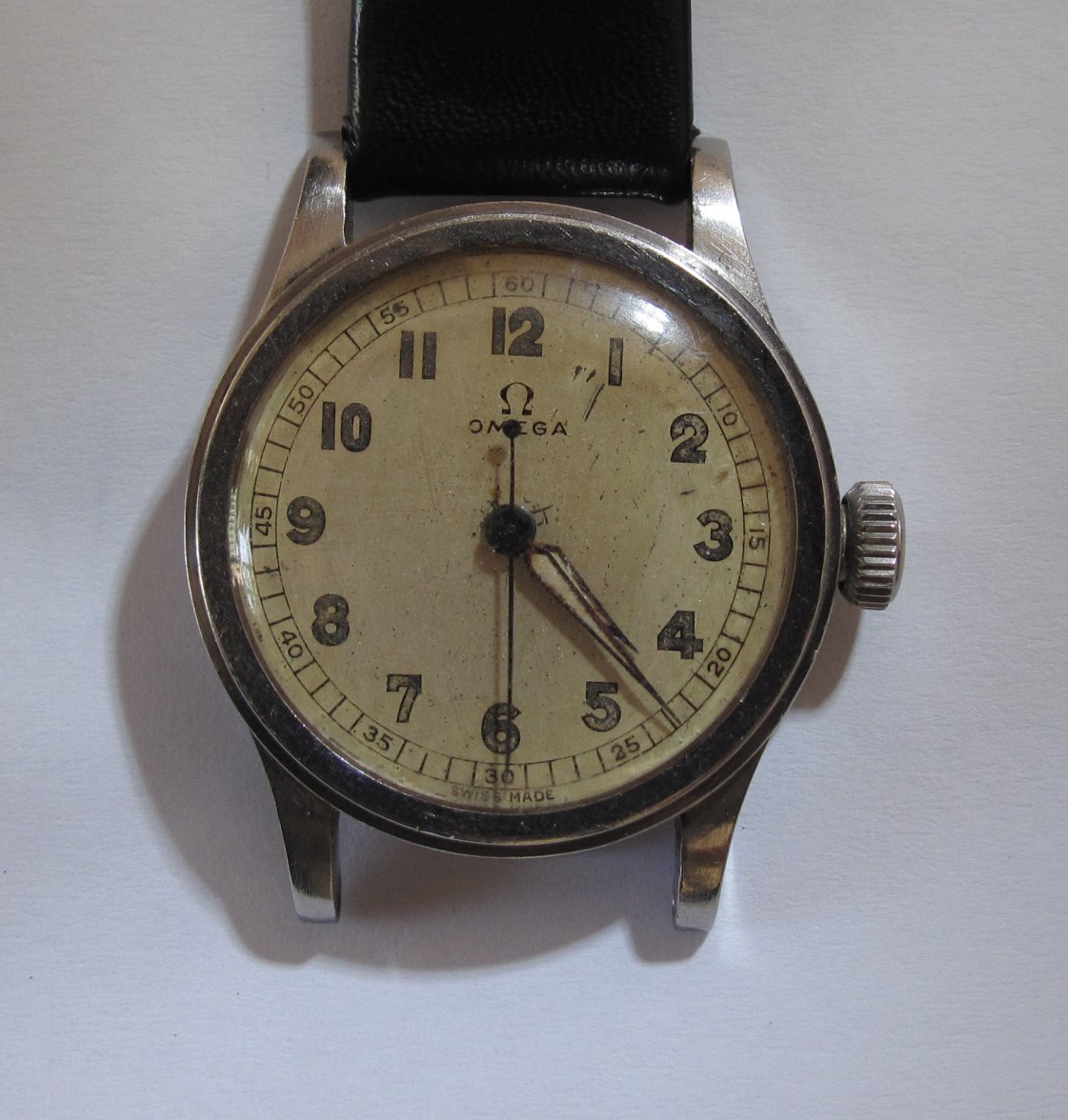

This have just arrived.

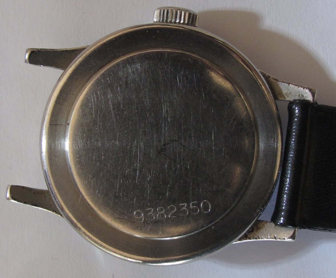

My best guess is that it is a Omega Naïad, posible a ref. 2064. Serial date it around 1938, it has a heavy gasket in the back of the case. It is a caliber 23.4 SC.
Any comments and old material on these Naïad is velcome 😀

Pretty little watch. I like the contrast of its blue hands and dial shade. The case looks in very good shape. Yours?
1,727
14,715
Yes it has just arrived to day 😀 It seems to be in good condition i think.
1,329
3,686
Yes indeed, a beautiful Naiad markI. It still has its cork seal in the tube. It seems in a good condition, be careful however, the spring that keeps the sweep second pinion in place is missing. If you don't replace it, the pinion may move and the second hand will stop.

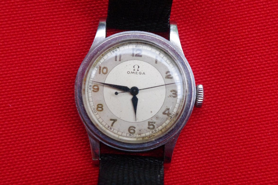

one of mine with unusual original black dial :

What a beautiful watch!
My dial is gunky and I'm too chicken to try and clean, yours is fantastic!
Our caseback numbers aren't too far apart.

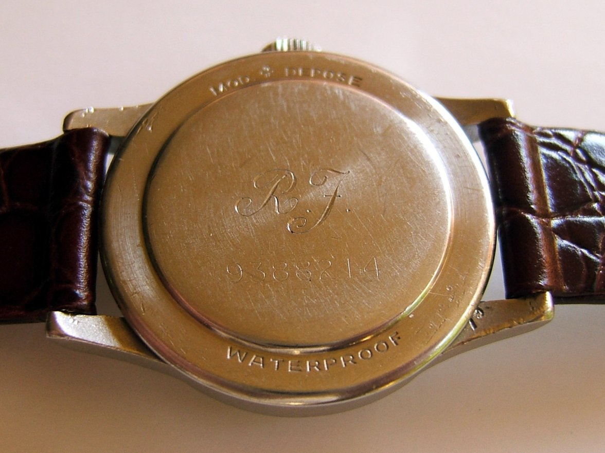

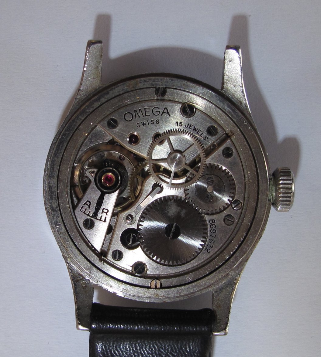

I think my puppy must come from the same litter as yours - only three numbers earlier in both movement and case number. But yours is in beautiful condition - clearly from a private school (mine was a street fighter). In fact, putting the two together shows just how good yours is. Whoever ‘RF’ was clearly got his money’s-worth.
Ever-observant Yann has picked up the missing spring over the pinion (luckily, mine is still there).
My crystal is badly crazed - but I think it’s not a case of a simple replacement. Maybe Yann can comment? Weren’t these a special material?

They're tiny, but wear bigger than they look. Mine, like @UncleBuck's, doesn't seem to advertise the Waterproof on the caseback.

That's the next generation of Naiads with screw in back.. It appeared in the 1940 catalog. I think the one with three slots is the first model, then there were six slots. Not so rare case by the way but yours seems to have a nice original dial. I'll be able to post some material on this model this weekend if you're interested.

well I think it is a standard plexiglass crystal with nothing specific.

Hi,
Skrotis watch is a ref 2108, here in the 1940 general catalog :
It has the 23.4 with small second, therefore not a 'Medicus' (although this name was then given by Omega only to its first central second model, ref CK651, with a square case, and was recently extended to all 23.4SC models, even in the OMDB), but certainly a Naiad.
I have a series of their little sisters, ref CK 2111, same case design and size but with a 23.4SC inside. Here are two pictures from 1940 catalogs :
Here one of mine with unusual black original dial :
Another one with a nice aged dial :
Both are from 1941-42 with the three slot screw in caseback :
And I have two other ones with the same case (one is a project/donnor) :
I don't think this case can be qualified as 'rare'. Less usual is the same case design with the six slot screw in caseback :
This caseback came later I think (no image of the dial side, it is still a project...) but still has the 'waterproof - modèle + déposé' inscription.
