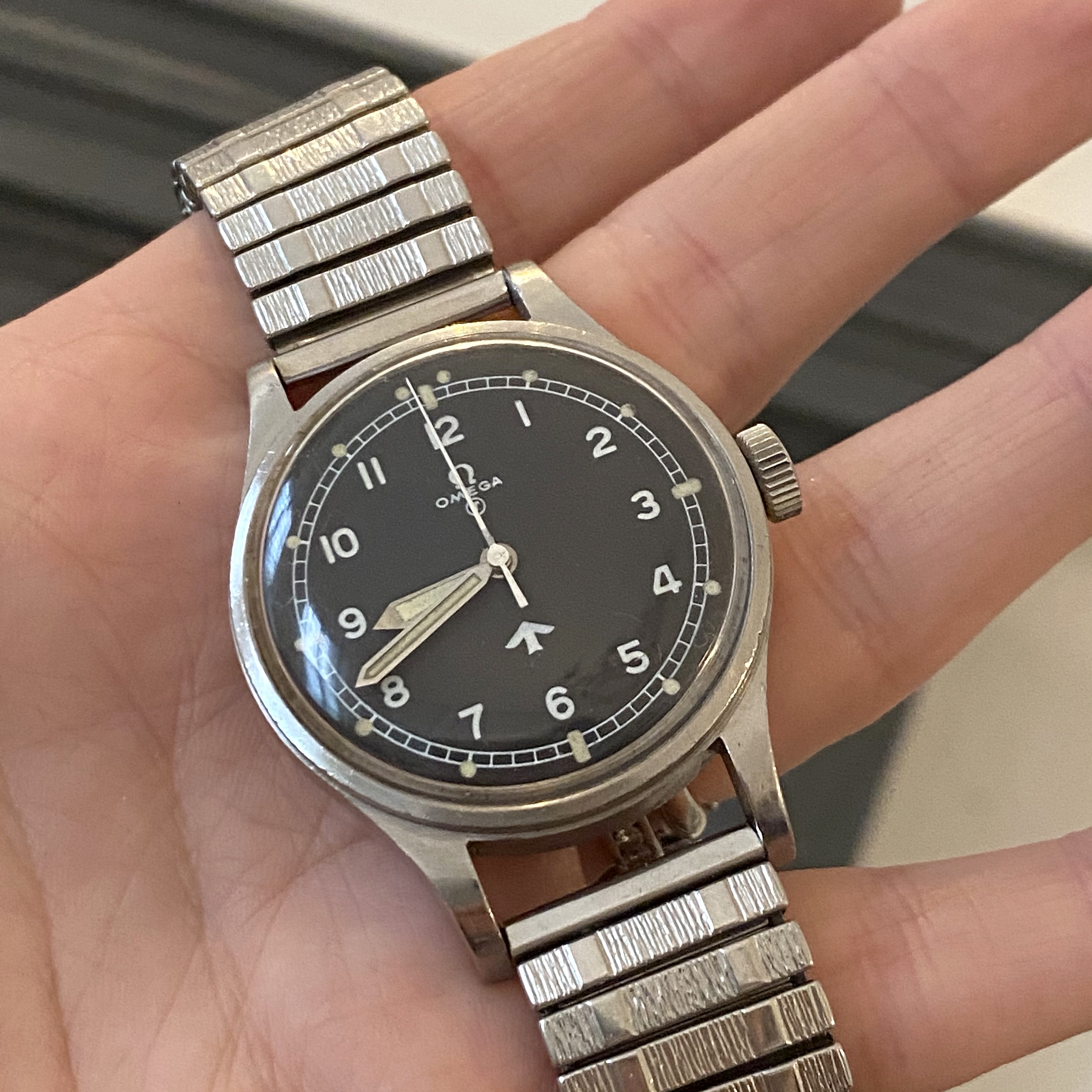

Evening all,
I've seen this watch for sale. Listed as Ref 2771-1 Cal. 283. circa 1953
I like it, but just wondered what the experts thought of it and what I should be paying for it.

Could do with seeing the outer case back but it looks quite a nice example, £2k - £2.4k, I would say.

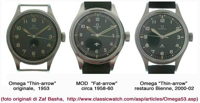

Why do you say redial? I think is the MOD “fat arrow dial”. These are the 1953 RAF issued navigation watches. They all were produced with radium, with the so- called thin arrow. But in 1956-1957 the RAF had to have all 5000 of them redialled by their own facility in Mounfichet and a redialled of the time, with tritium. The arrow was thicker, and the whole dial was somewhat imprecise.

it’s a desirable watch. Just search Omega 53 fat arrow and you’ll find many examples and sold prices.

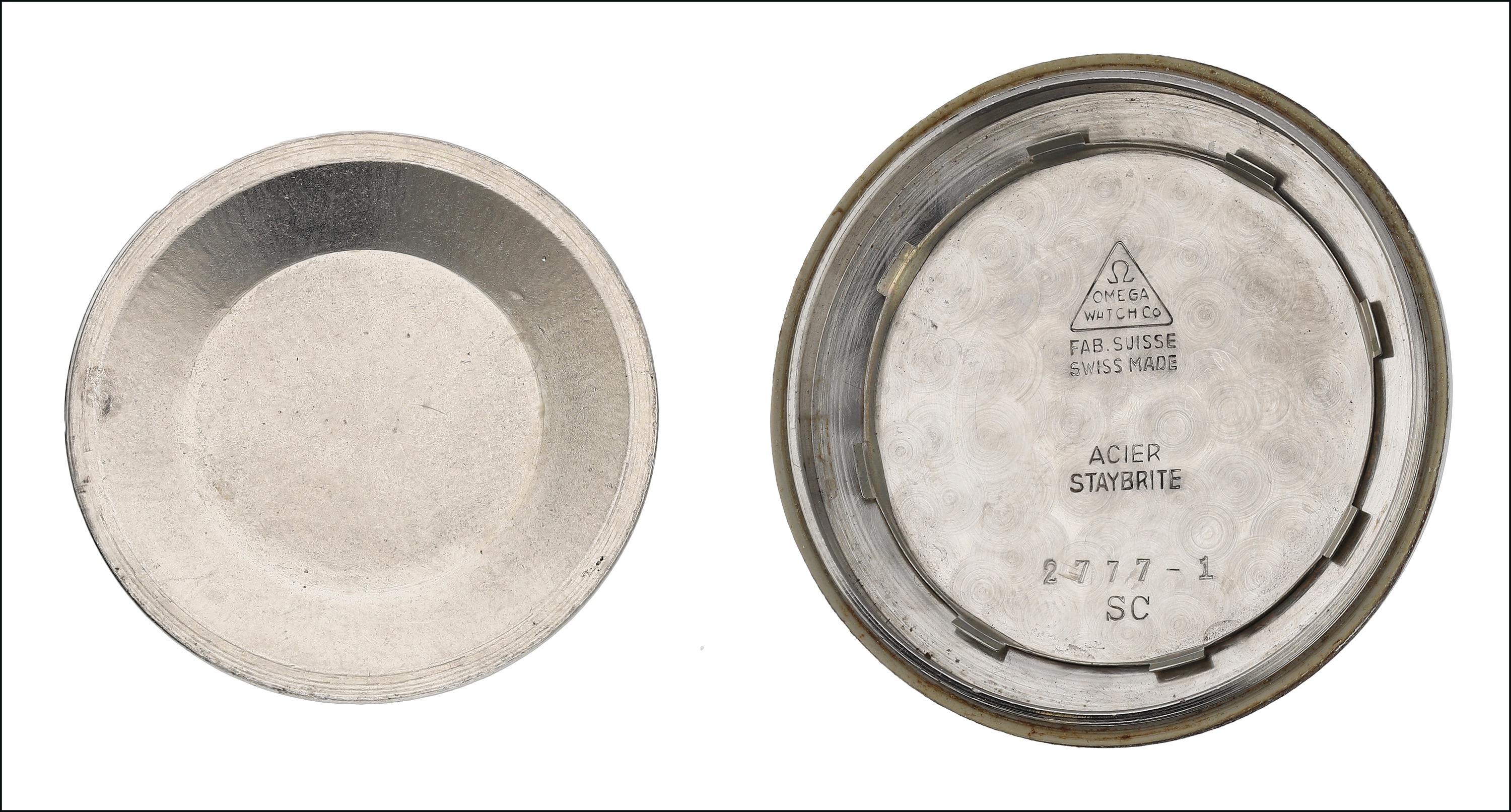

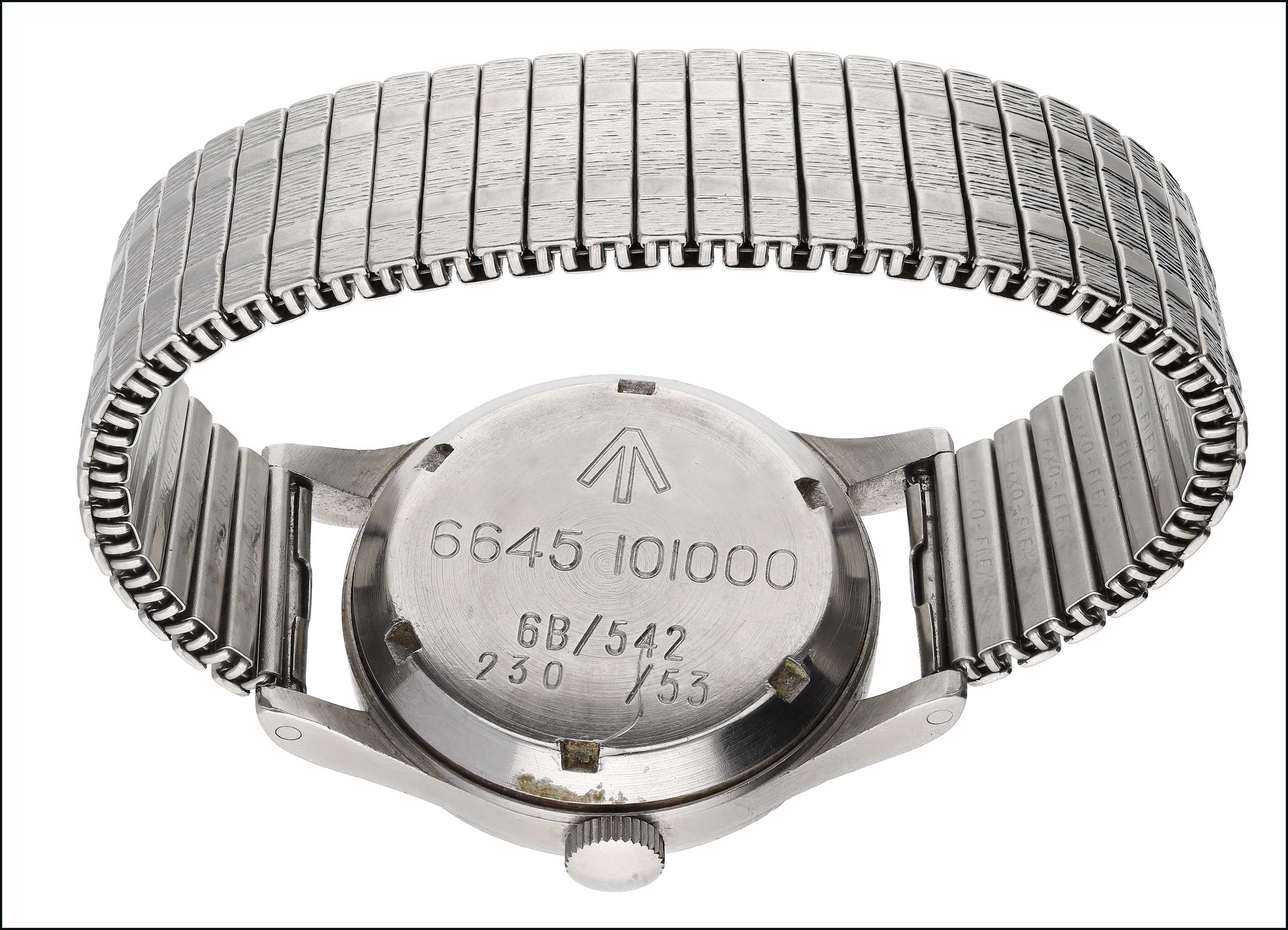

Here's the case back Marco, if it helps.
Also, but what are the thoughts on the bracelet. Is it aftermarket or of the period. Pretty much everything I've looked at has a Nato style.

the watch has fixed bars so yes a nato style strap would be correct though this predates the NATO strap. The bracelet on it is known as a Bonklip which was used by some servicemen as well.

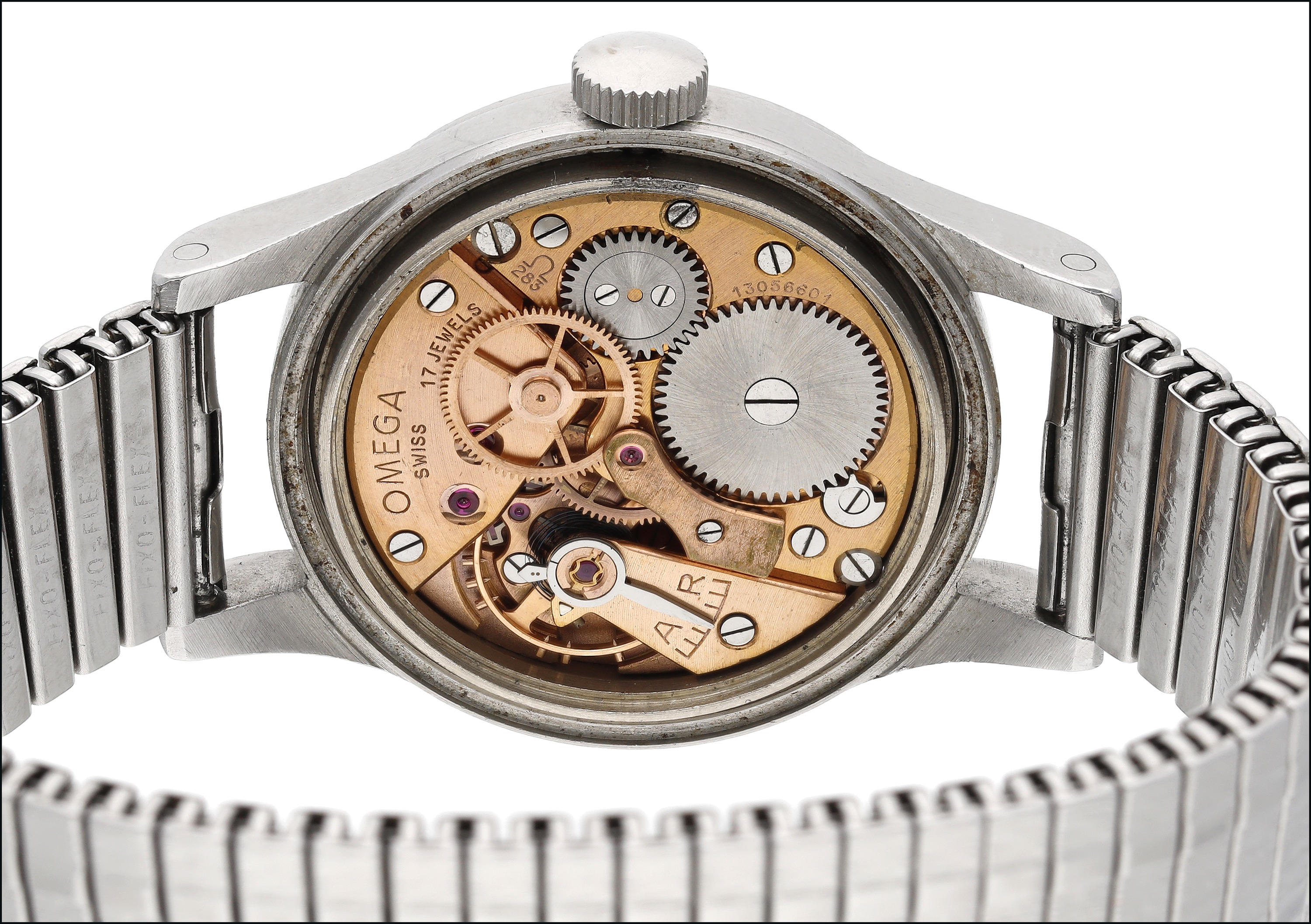

the watch looks good and correct. Movement looks clean. As said it’s a desirable piece and the price mentioned earlier is reasonable.

Bracelet is after market from the period and would have been highly unlikely to have been fitted to an issue watch.

It's not a Bonklip, it's a Fix-O-Flex. Different animal.

yeah I just meant those sort of bracelets can fall into that misused catchall occasionally.
Didn’t study the back branding. That’s the bamboo pattern? A real hair grabber.
