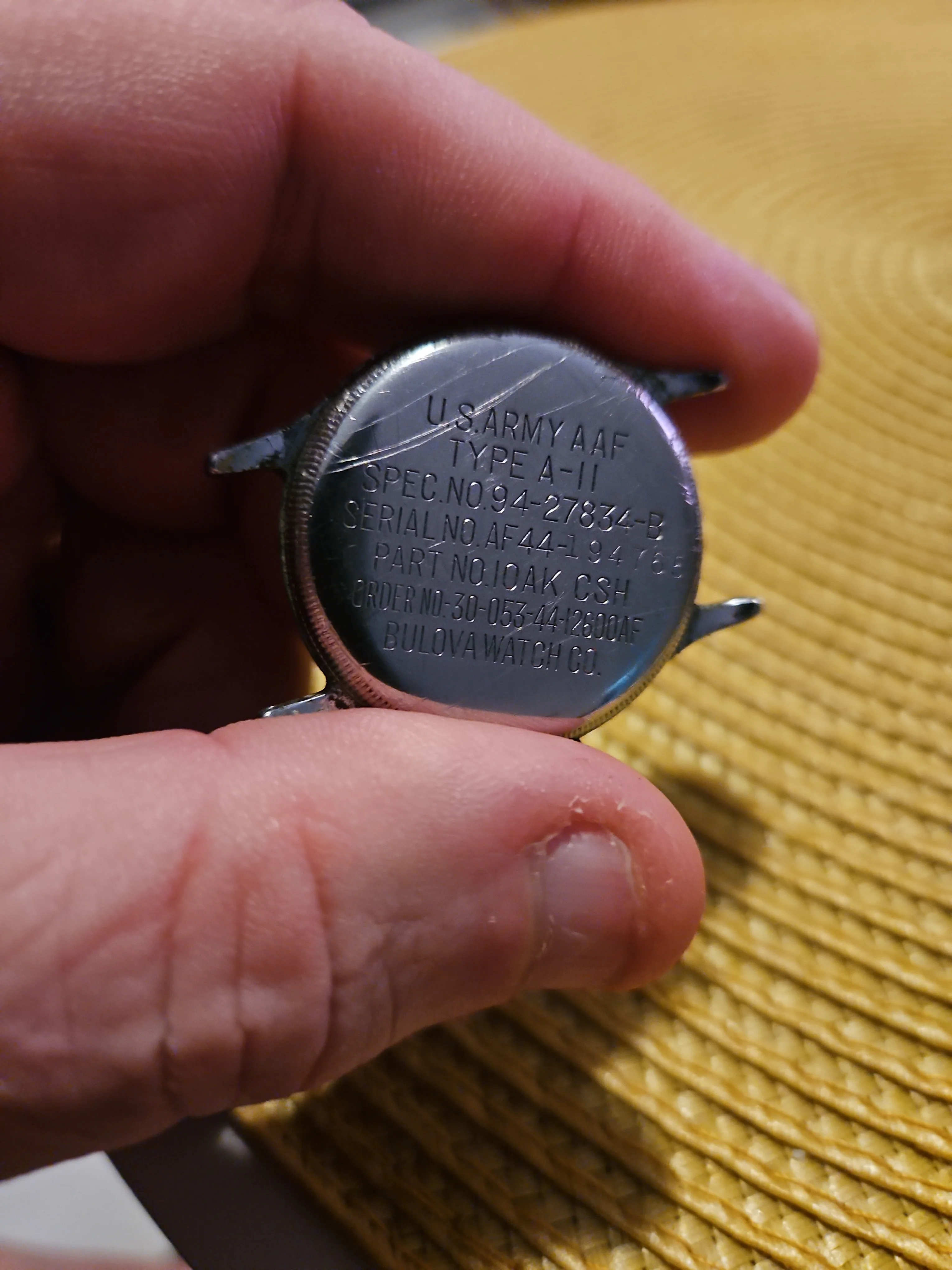

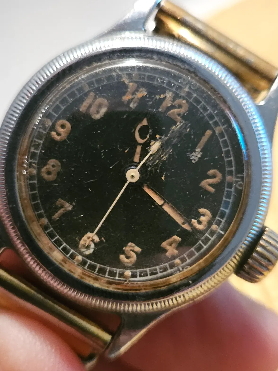

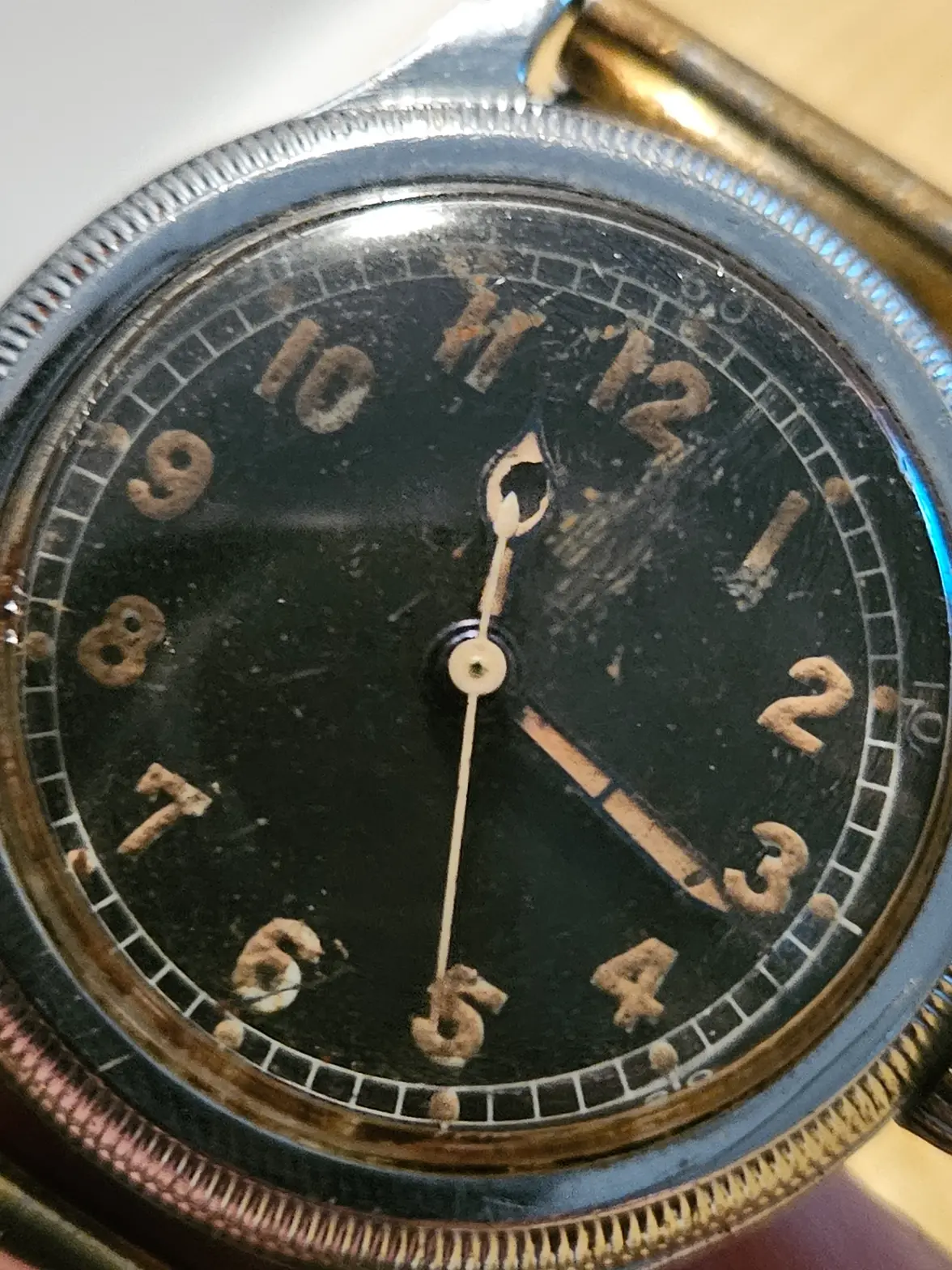

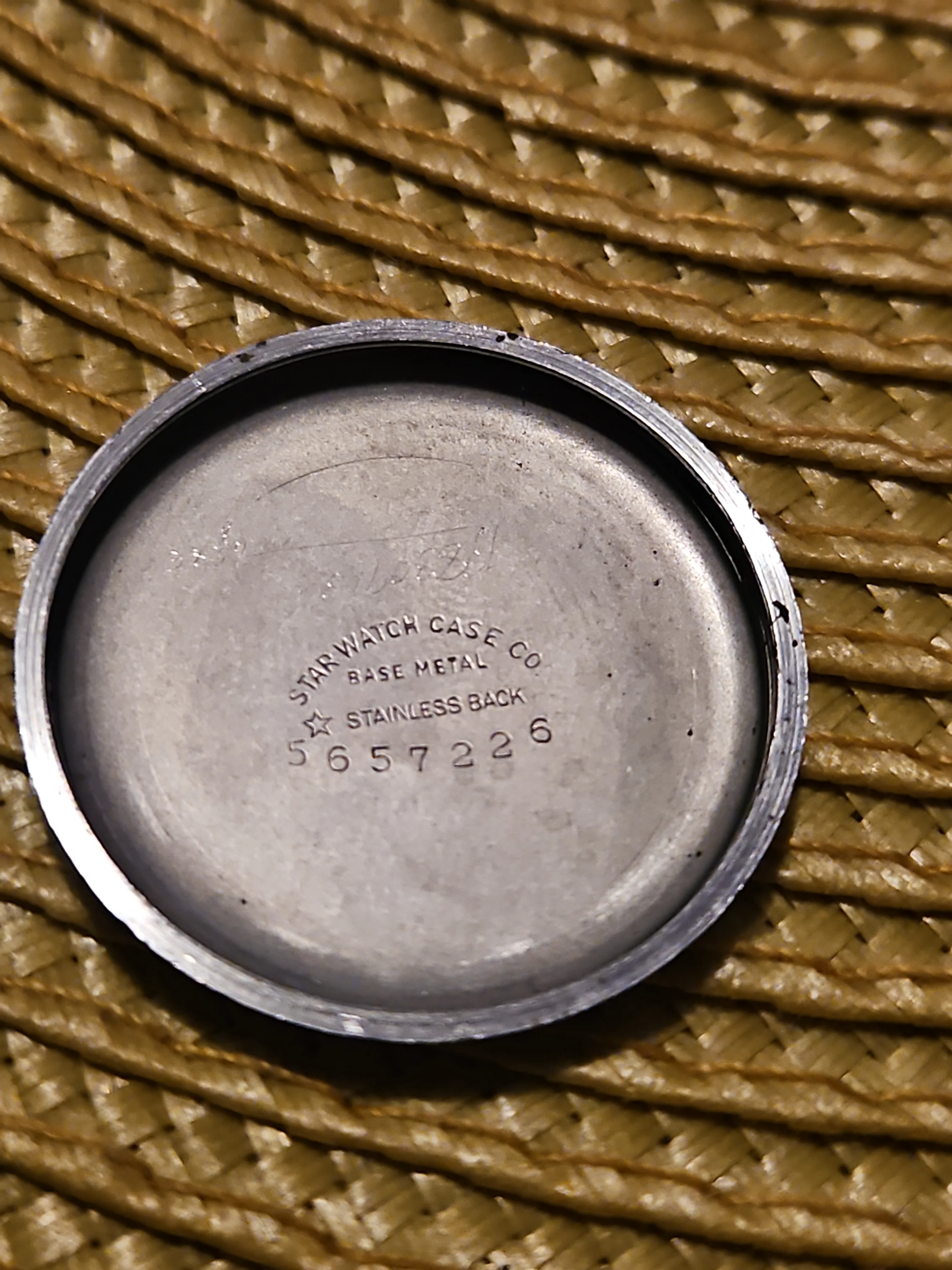

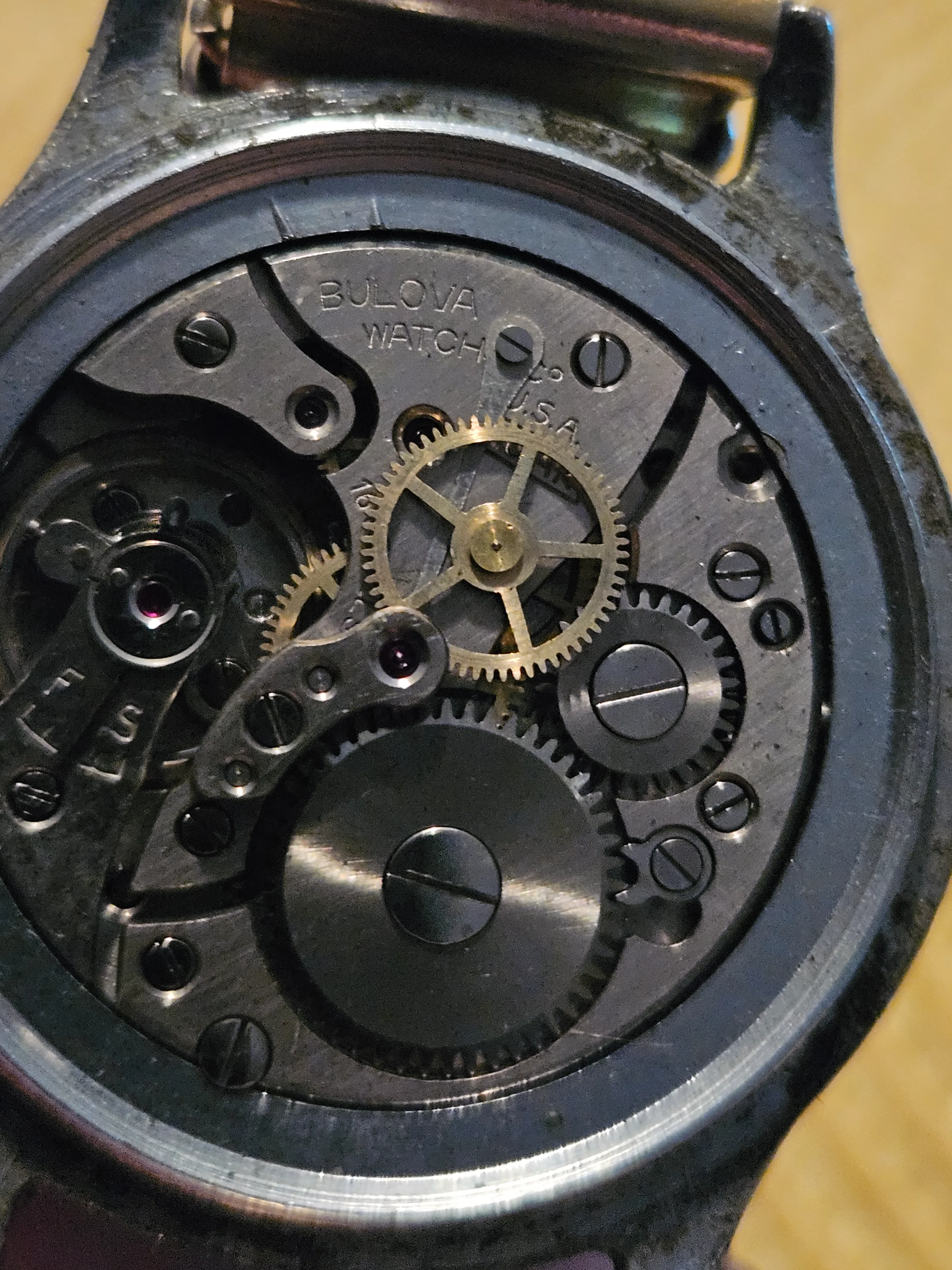

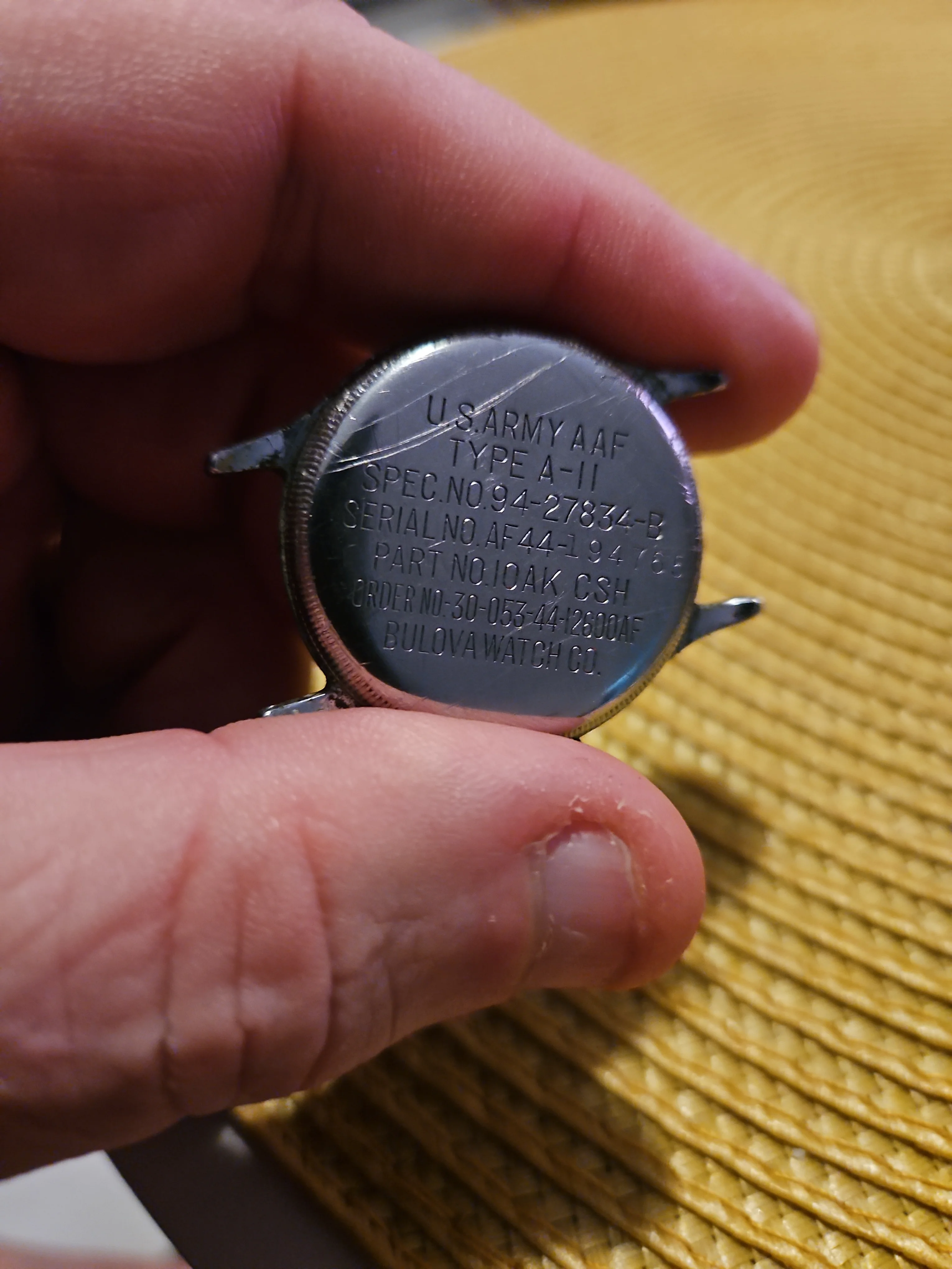

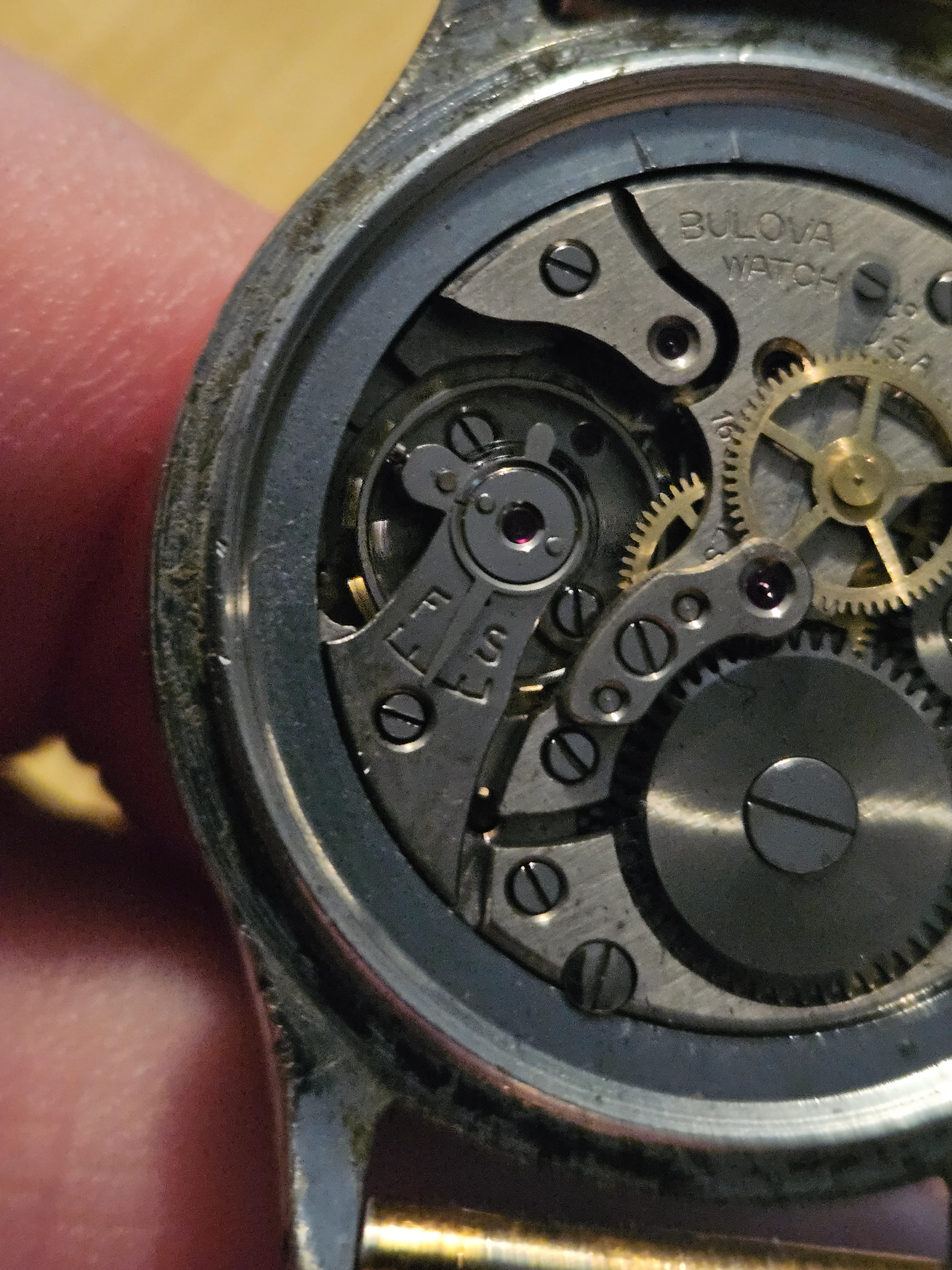

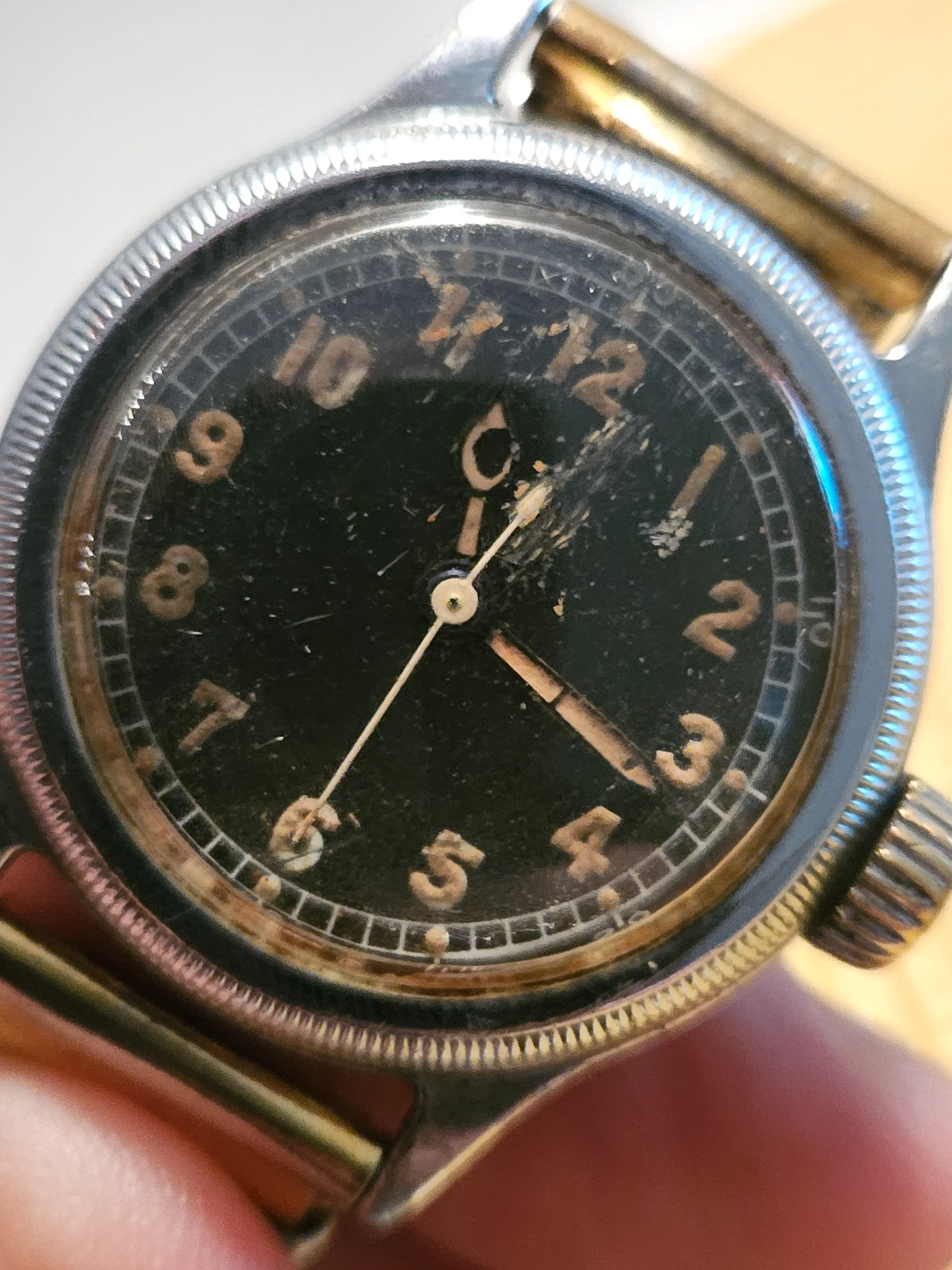

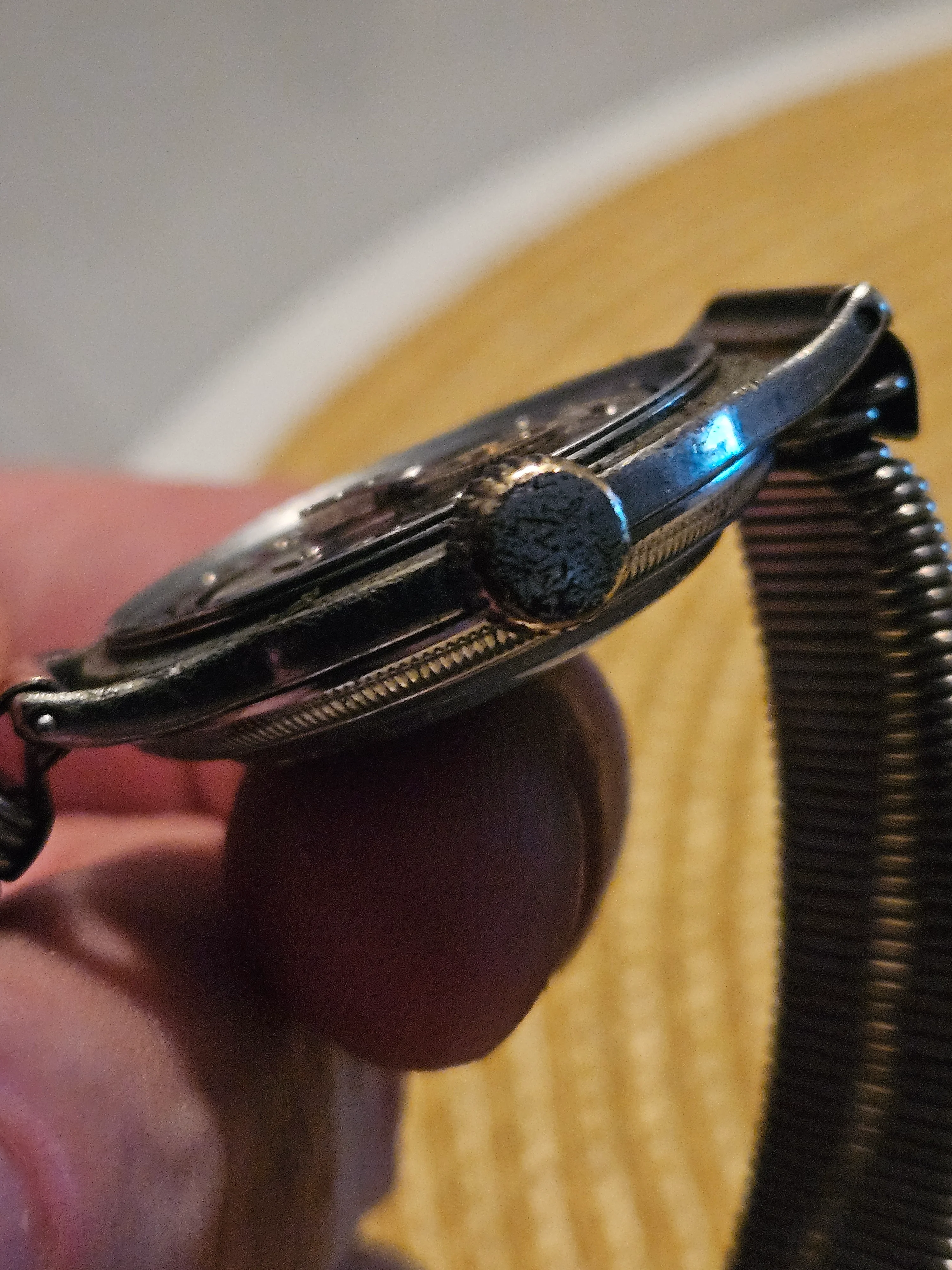

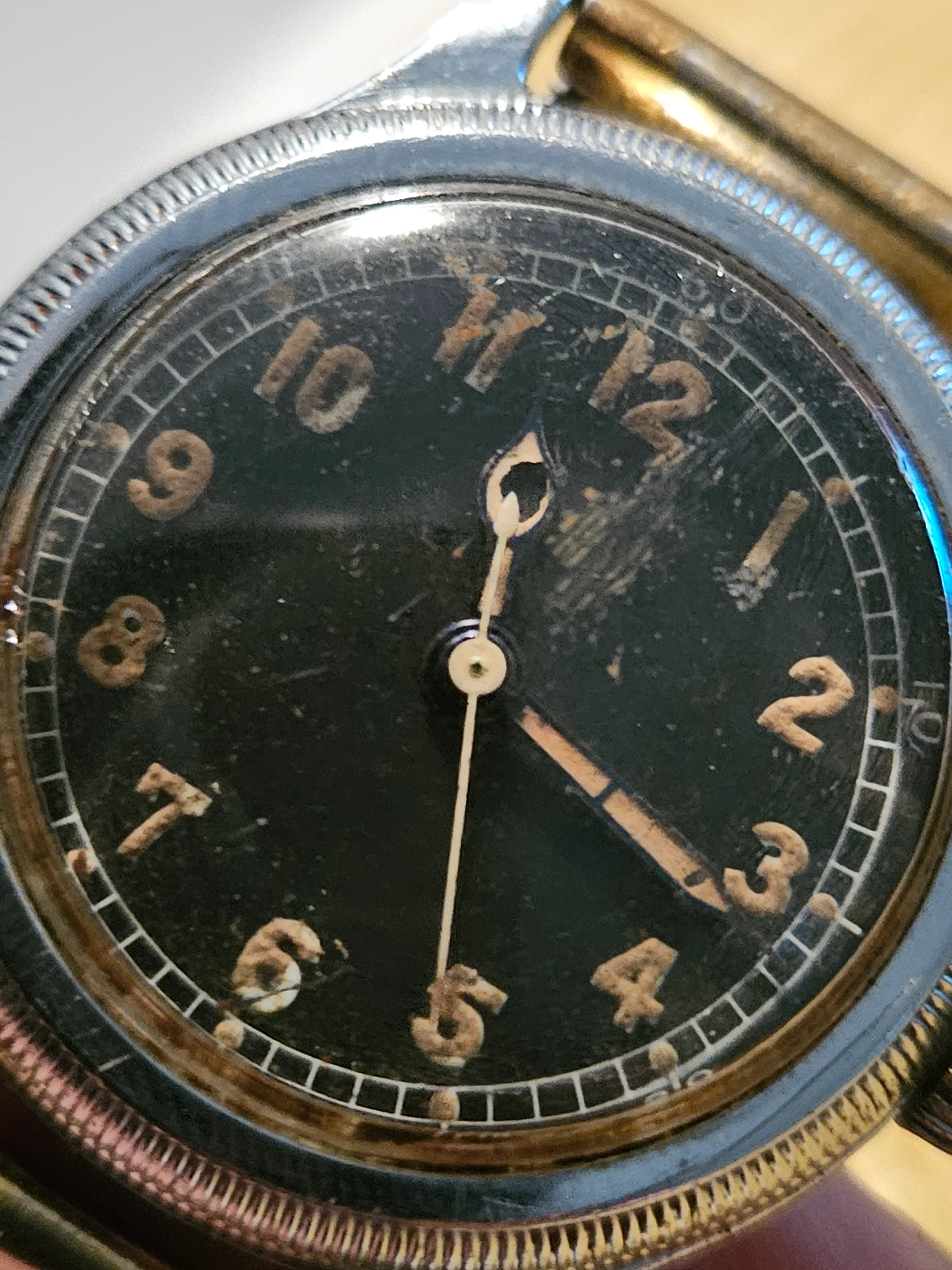

Recently picked up this 1944 military wristwatch at a UK auction for about $300. It’s a manual-wind piece and is currently running, though it’s losing around 5–6 minutes per day on the timegrapher, so it will likely need a proper service if I can’t regulate it myself. The case is on the small side, about 32 mm, but that seems typical for wartime watches.
I’m not entirely sure which branch of the military it was issued to, and I’d really appreciate any insight. The crown appears correct and nicely oversized, which I understand is common for military specifications. My main question is about the dial—I don’t yet have the experience to tell if it’s original or a redial. Any thoughts on authenticity, correct configuration, and historical context would be very welcome, as I’m fairly new to collecting military timepieces.

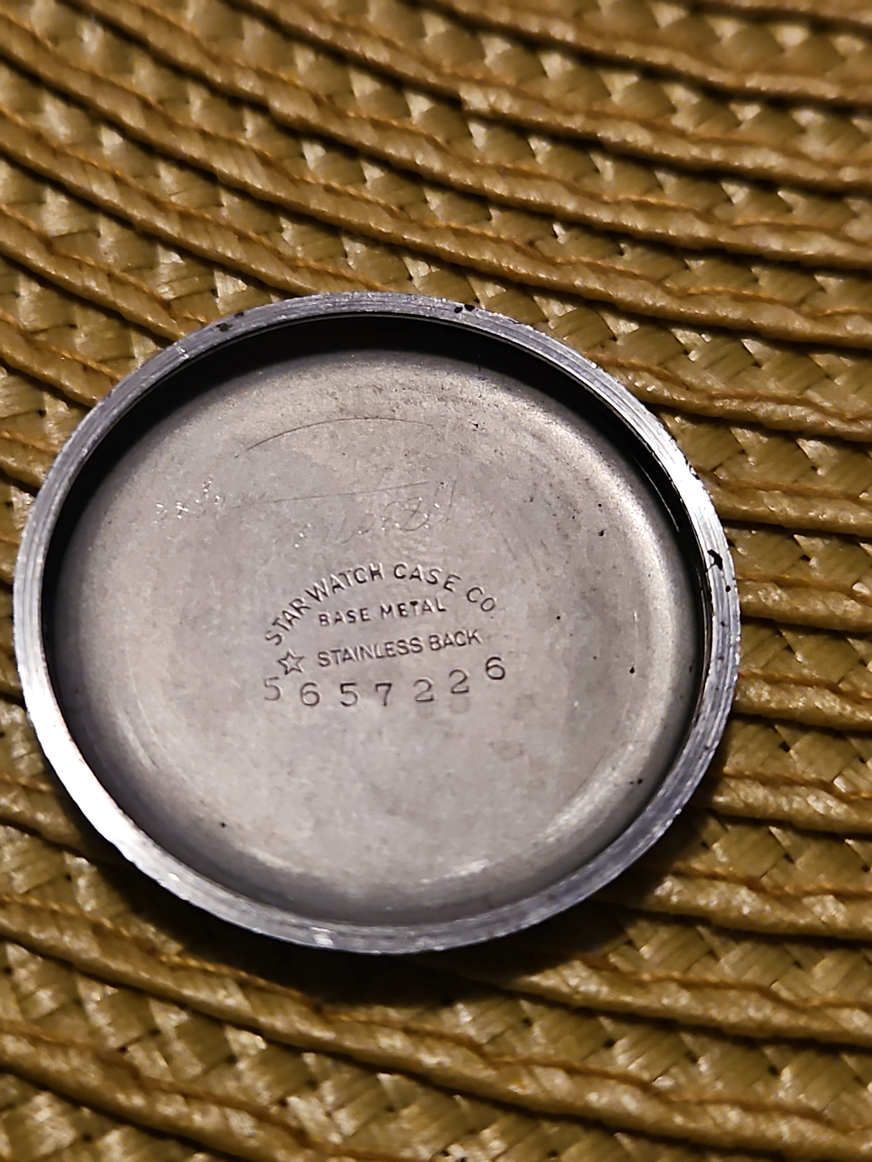

Caseback has the branch info. AAF = Army Air Force. But I think A-11s ended up pretty much everwhere

Yup, United States Army Air Force, just like it says. The A-11 was the standard pilot's watch for the USAAF and it makes sense that yours was found in the UK since so many airman were stationed there during the war.
Those old Bulovas are very good watches, but who knows when it was last serviced, it may have been 80 years ago. With a proper service it should be a good time keeper,

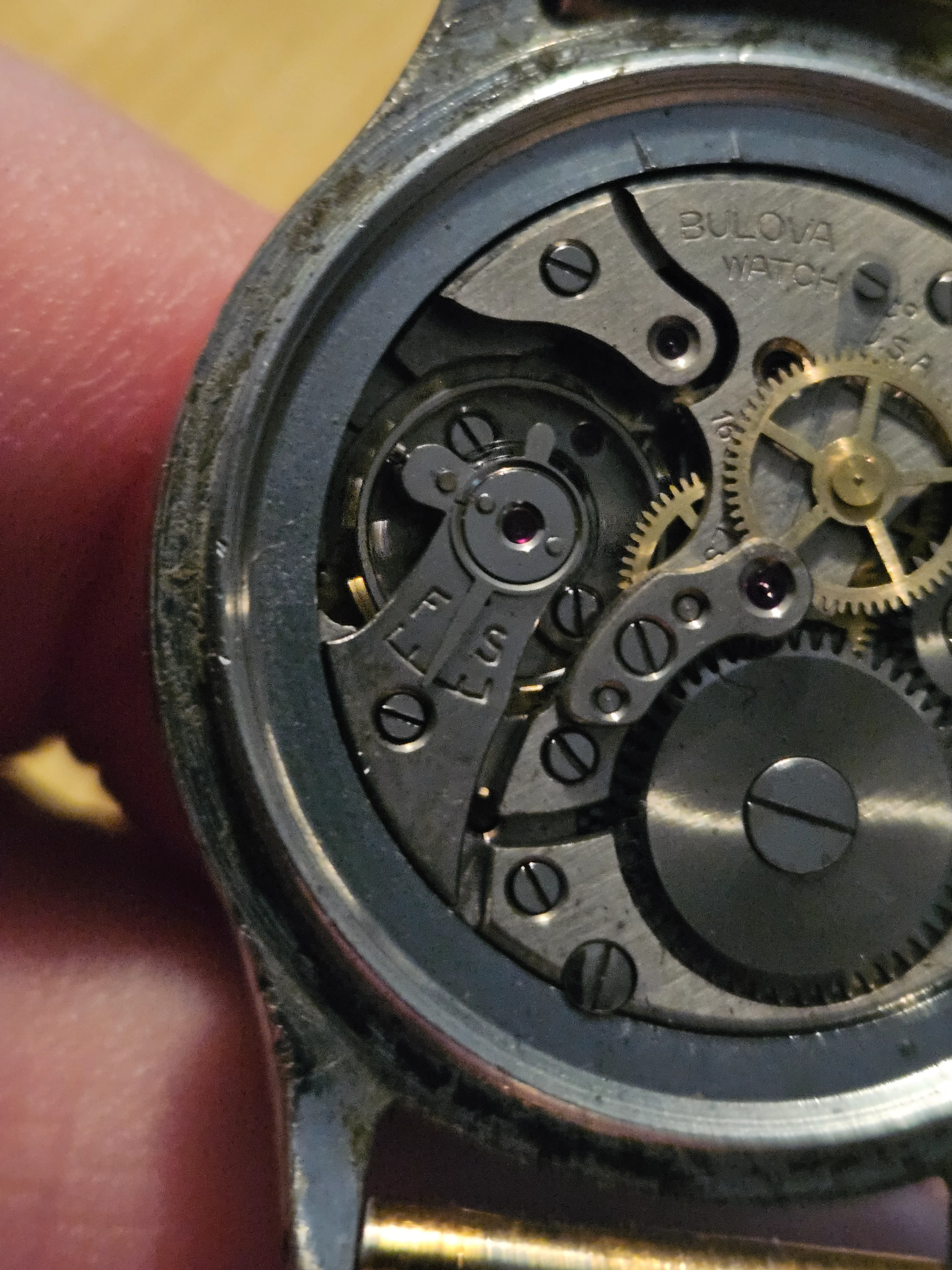

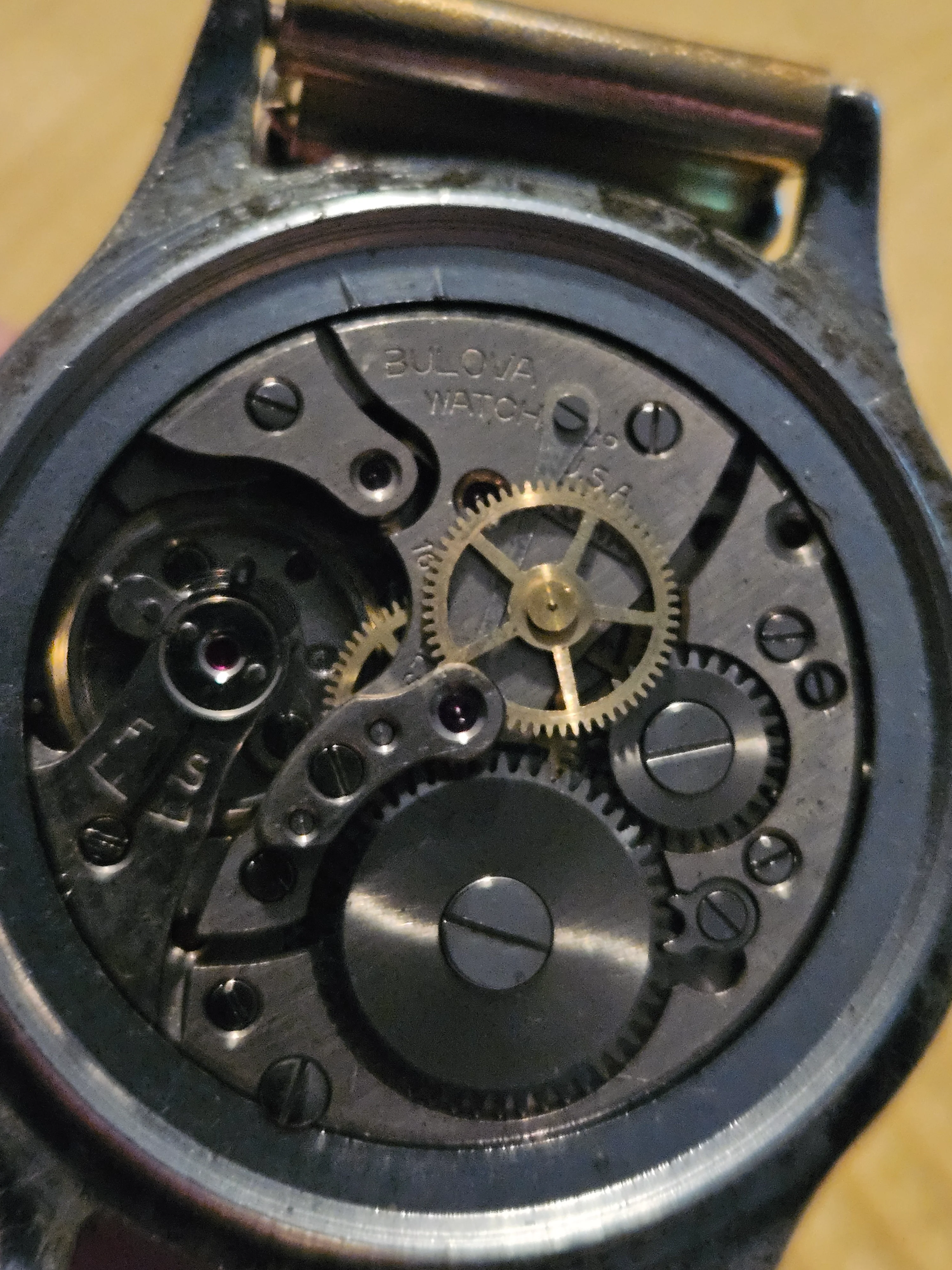

Thank you so much for your insight.Yes, it's actually kept time pretty well.I'm gonna try to clean the crystal or maybe even change in.It might even be dirty from the inside, hard to tell.I'm gonna take it apart later tonight.Take care and thanks again artis
3,617
9,183

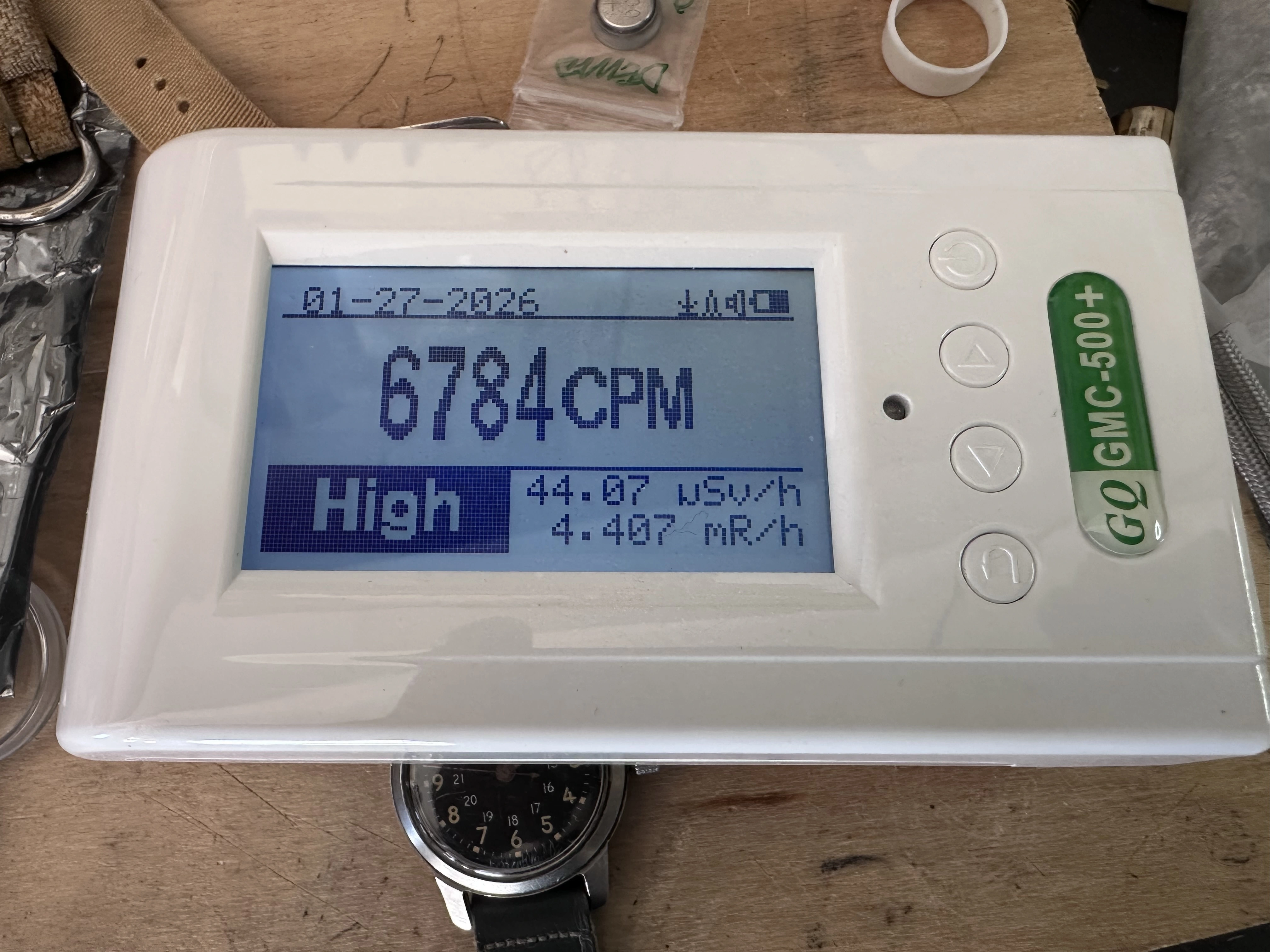

That lume is radium so you need to take proper precautions!
3,243
6,798

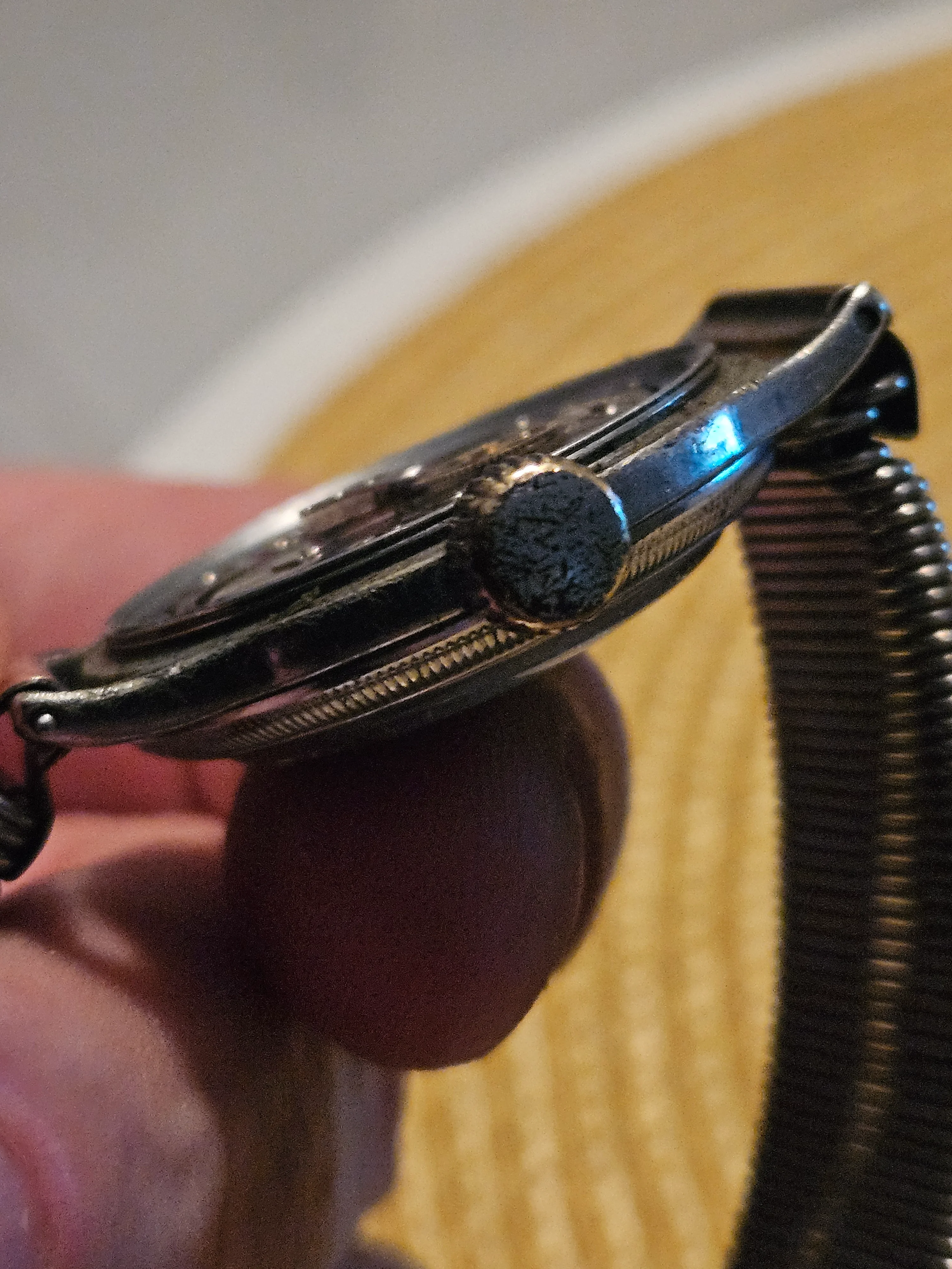

Probably it s a "front-loader": try to turn the bezel to take off the glass. But read above ;-) -> radium
217
104
Thx!
Yes, I will be careful.I've done it before thank you
322
210

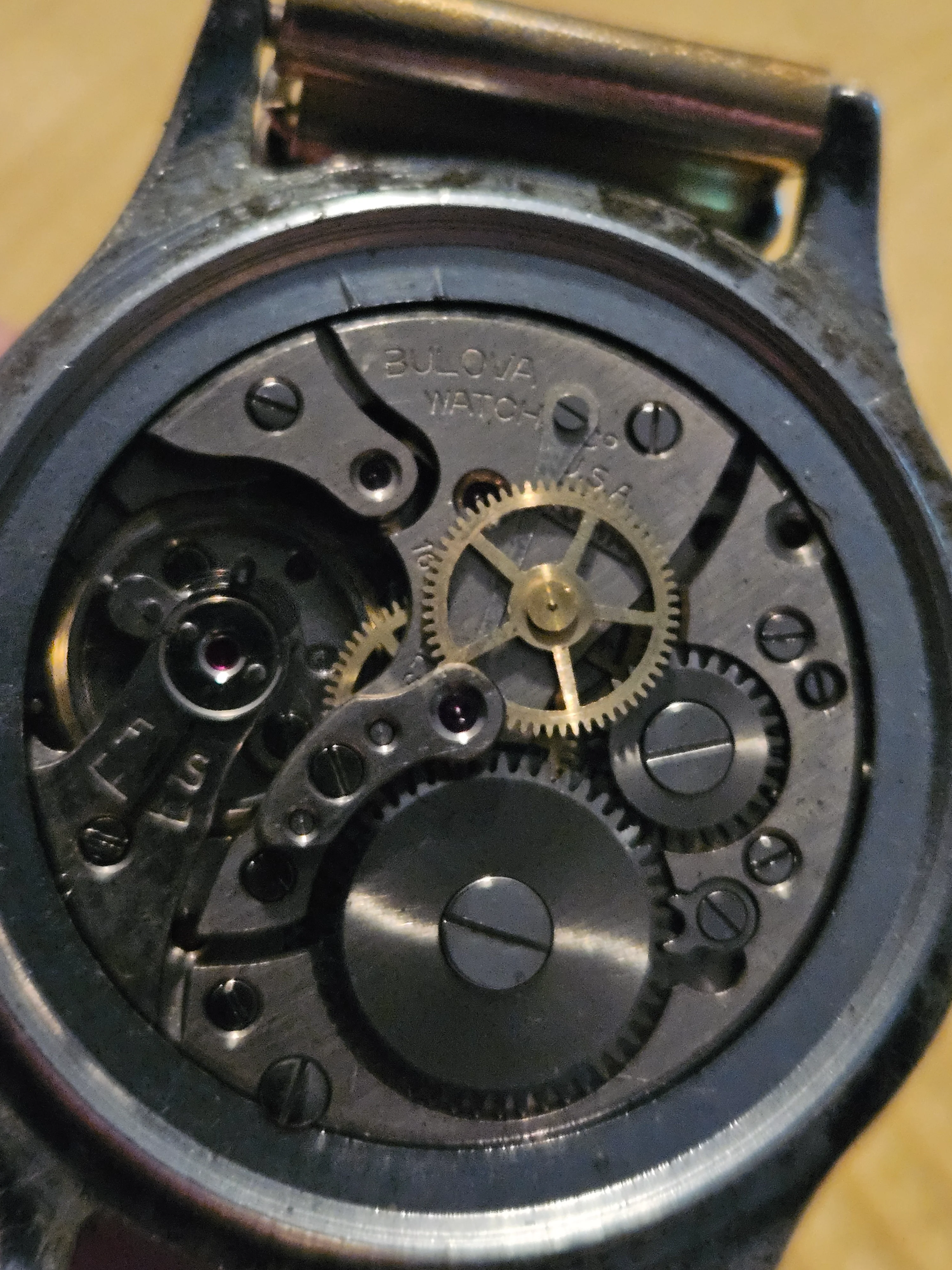

The movement is in a spacer ring and it comes out the back. It will be super “hot” with all the radium lume on the dial and hands. You might want to wear disposable gloves and N95 mask and work over a piece of paper. A friend who is into these kinds of watches will put the hands and dial in water and use a toothpick to get the lume off without generating dust. Getting it in your lungs or intestinal lining is bad.
