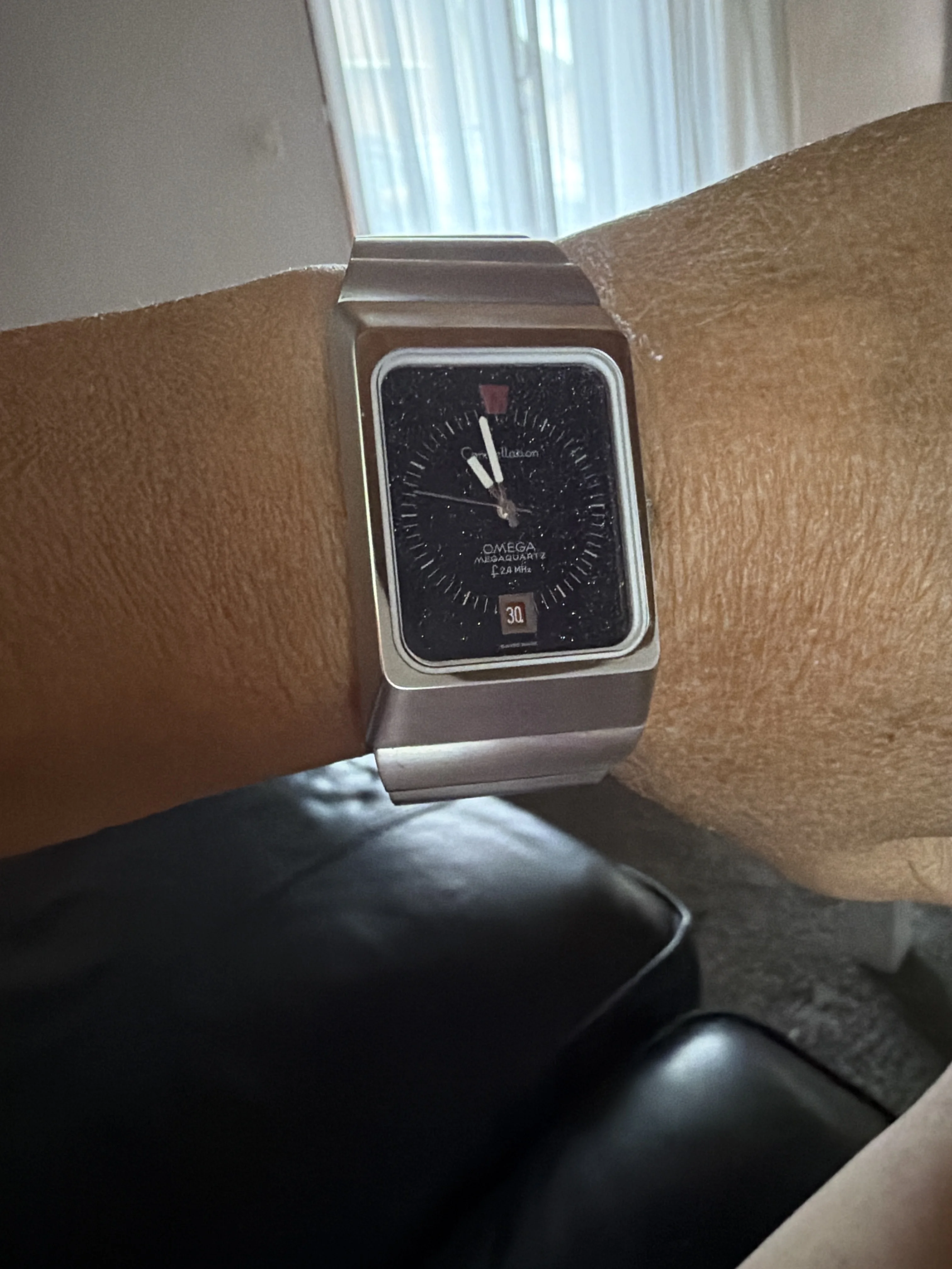

I’m hoping the collective knowledge here might help me find someone who is still willing and able to work on an Omega Megaquartz 2.4 MHz Stardust, cal. 1510.
The watch isn’t completely dead. With a fresh battery it starts and runs, but subsequently stops. I’ve tried changing the battery with the same result.

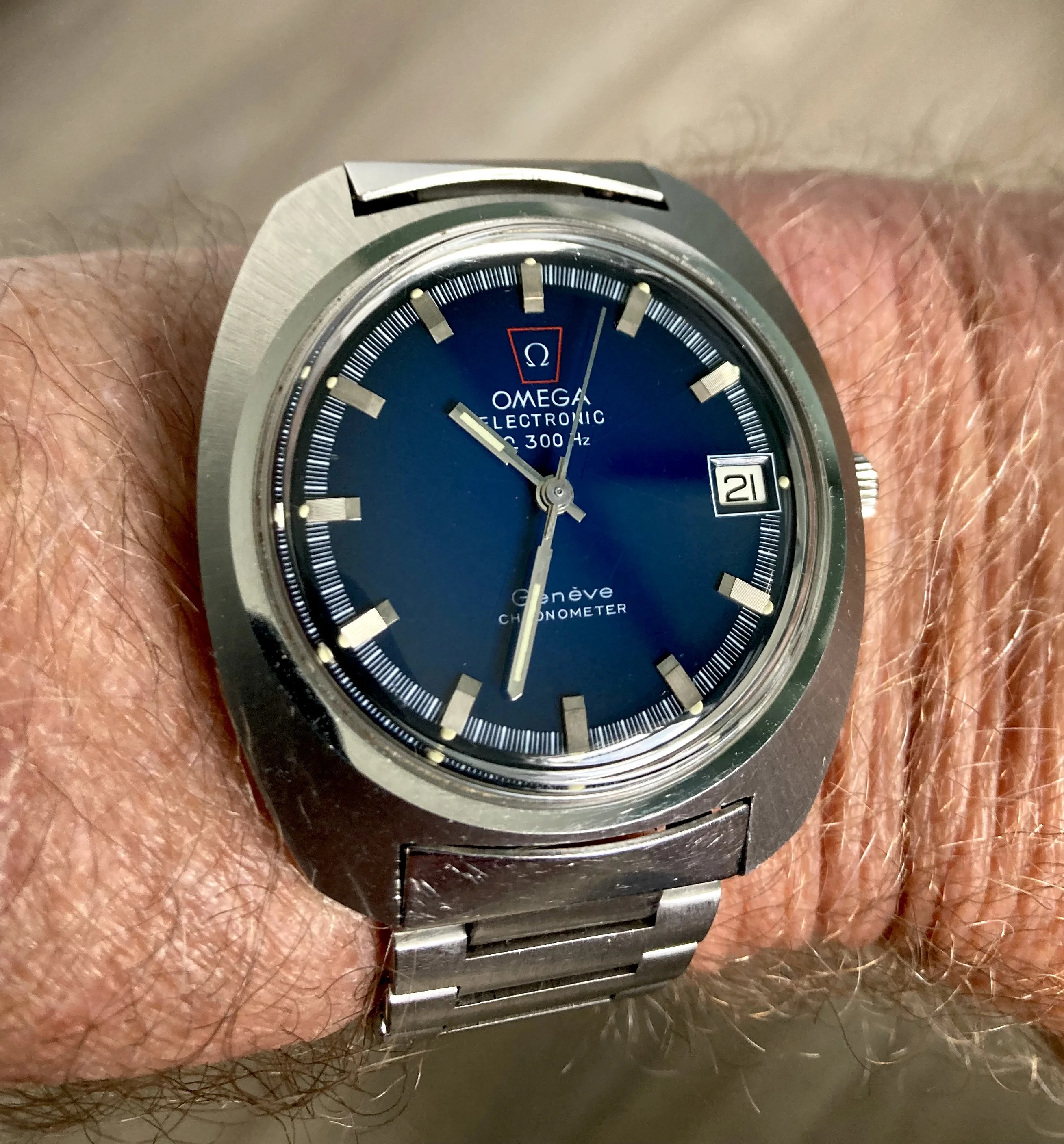

Have you tried the Croydon Service Centre?
They have repaired f300 watches for me and specialise in electric chronos

They charge/charged a £30 inspection fee which is deducted from the cost if you go ahead the service/repair. They seem to have a stock of parts. They’ve done a couple of things for me. They’re not cheap but they are competent

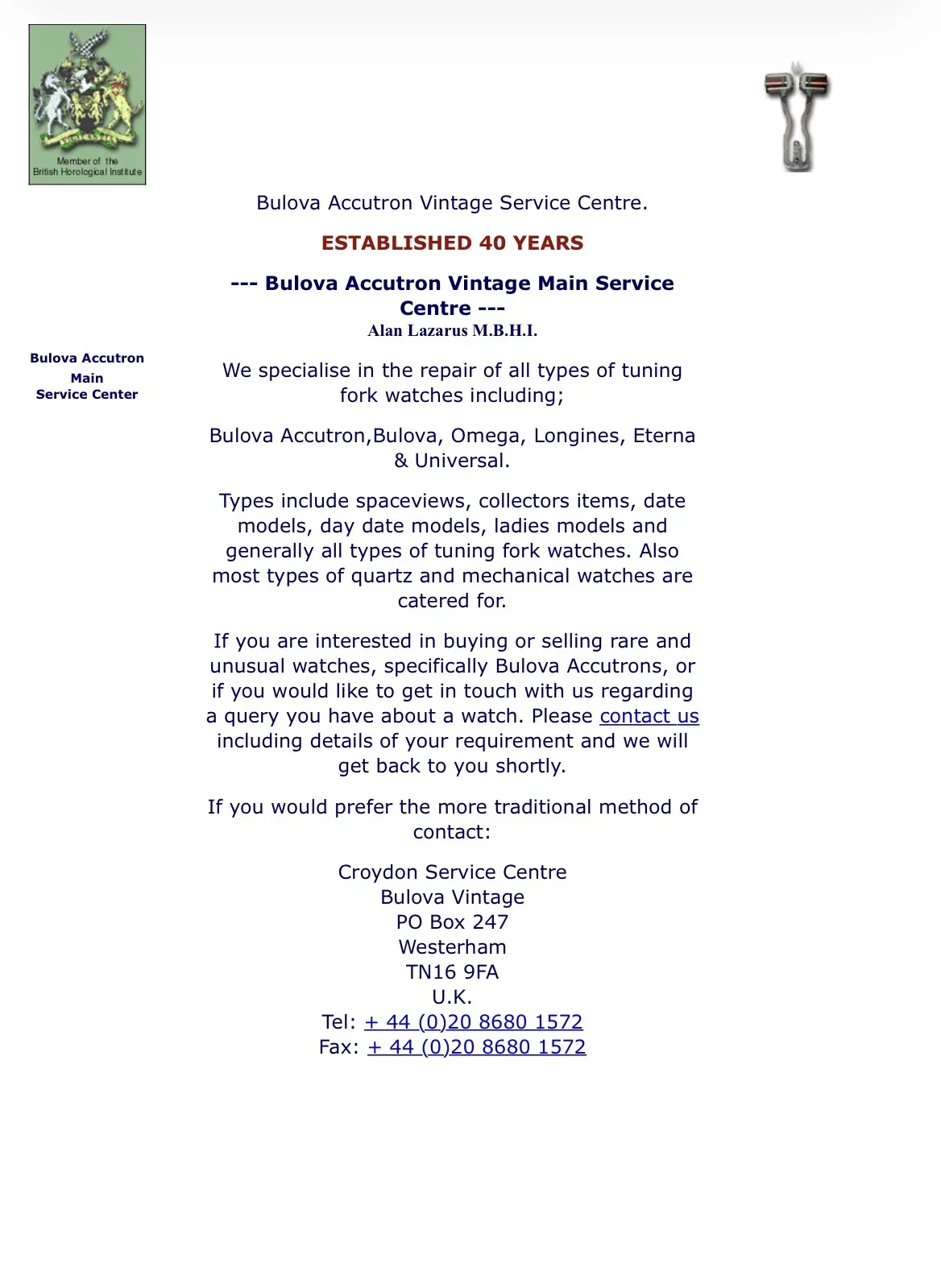

They’re in Croydon

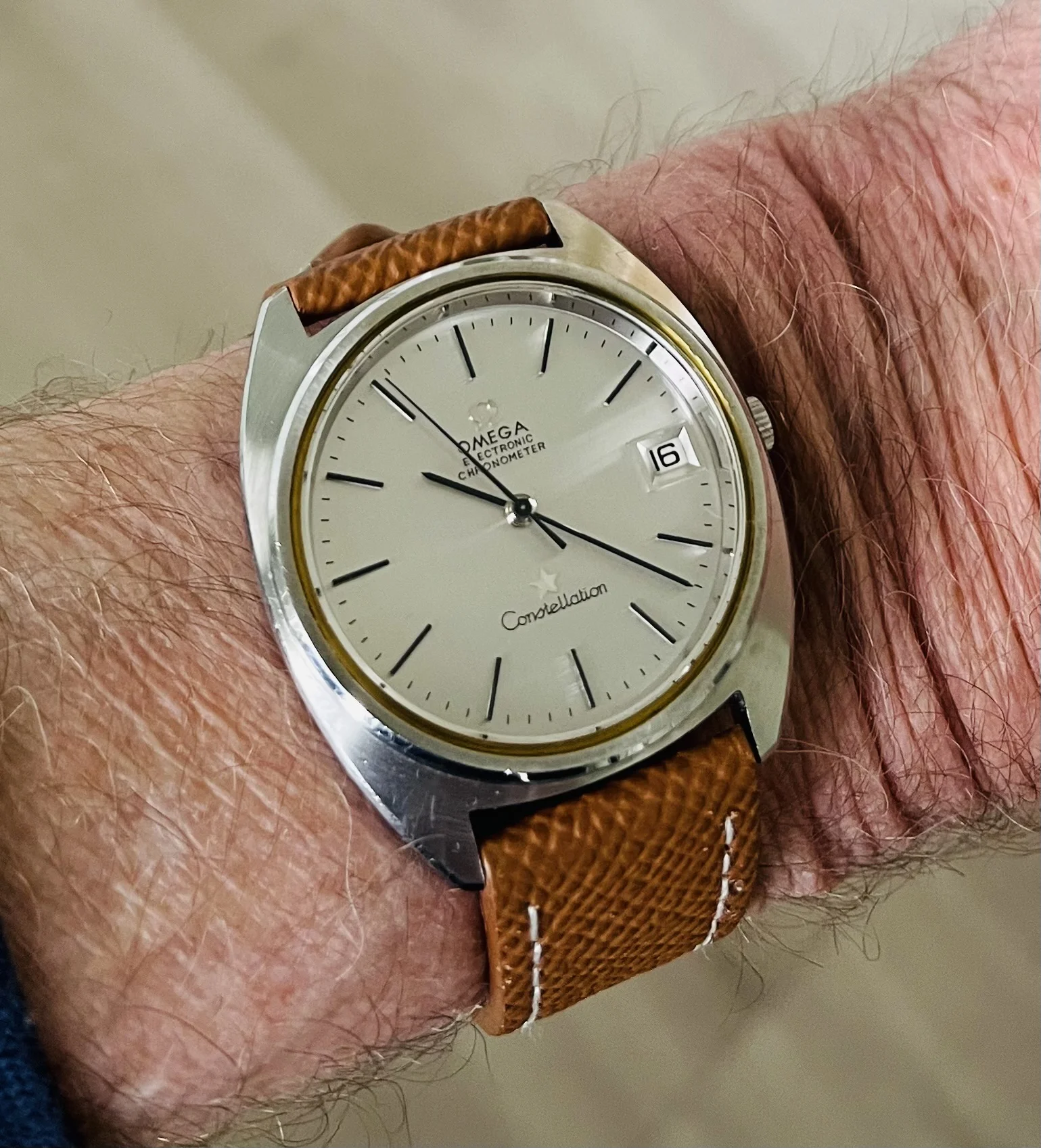

I last used them last year. They repaired and serviced the blue one and repaired and serviced the Connie a couple of years earlier. They charged me £300 plus VAT and postage.
Obviously the problem with your watch may not be the same as mine but you have to send it to be examined and if you accept the estimate, the examination fee is incorporated into the overall fee.
I’ve been entirely satisfied with their services.

It’s not a shop and, given the likely value of the stock, they don’t advertise where they are - like quite a few others.
It’s all via telephone and post.
I’ve never had a problem with them.

I did mine that as a micromotor issues and fully service at Dario Ratti in Bienne , took 12 months the guy is overloaded but they did it perfectly .

That is extremely interesting, thank you. Yours looks fantastic.
Dario Ratti is a new name to me and the fact that they actually managed to deal with a micromotor issue and fully service yours is encouraging.
Do you remember roughly when the work was done? And did you deal directly with Dario Ratti in Bienne yourself?
A 12-month wait wouldn't bother me at all if they are still willing and able to work on these. I'll definitely contact them.
