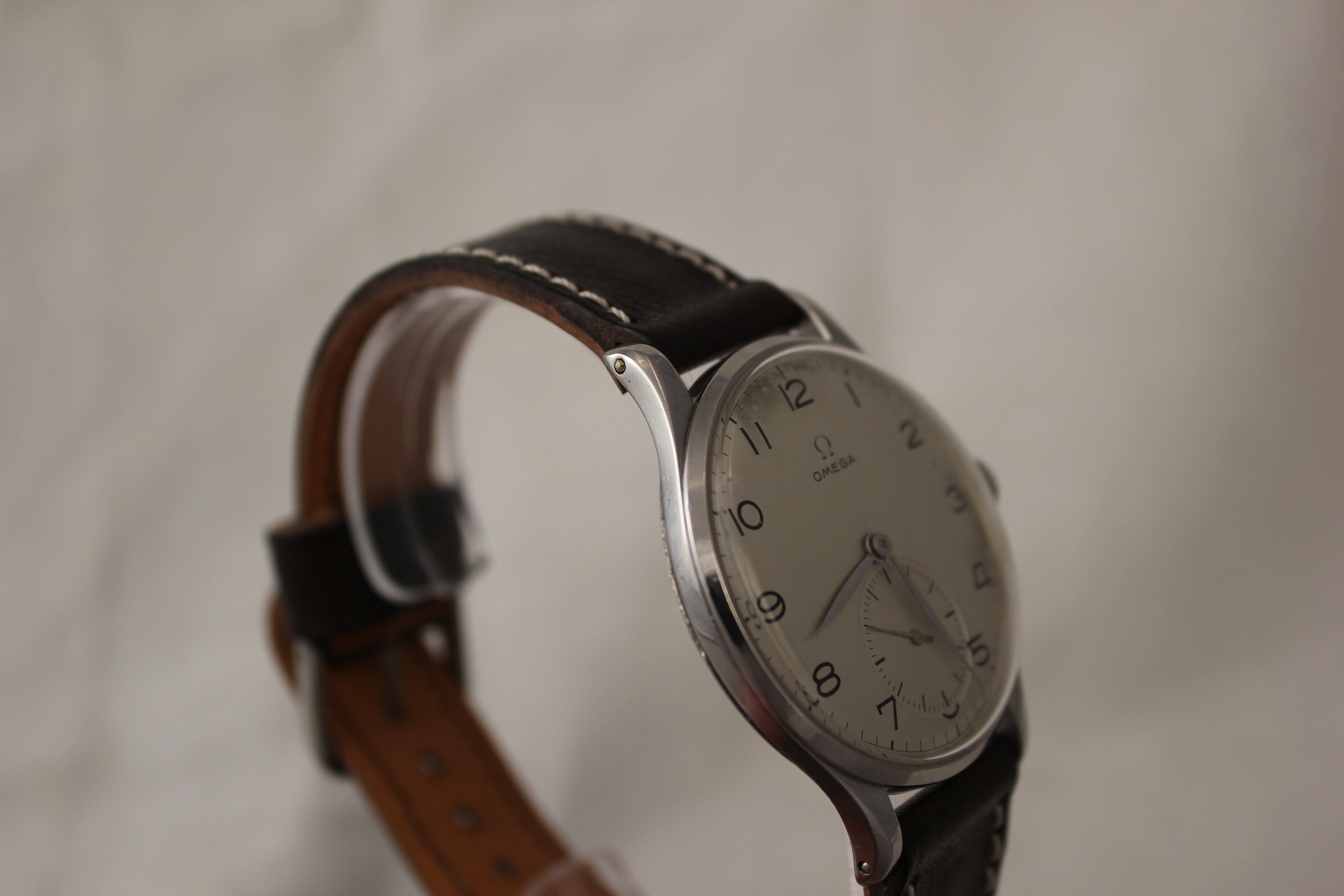

hey guys,
I'm trying to get my mind off other things, so I've been wearing this. It just came in today.
It was sold to me as a 2181 with 30T2 manual wind movement. When I was considering it, I queried some of the masters here on OF, and I got mixed opinions. I bought it anyway, and now that I have it, I'd like to get some feedback and see if we can come to consensus on the dial. Some feedback I had points to the 5 and 7 o'clock markers and how they dip into the subdials as a possible sign of a redial. Other opinion differs and says it's OK. Obviously the dial has some staining around 11 and between 3 and 4.
Other than that, how's the rest? Case OK? Crown original? I haven't been able to find too much about these. OVDB doesn't seem to have a 2181 listed. There is a 2180 listed that appears to match the traits, but there's no reference pics. They also have an OT 2181, but it's a solid gold case. I found a few threads here and elsewhere. Some of those are obvious redials, or much more degraded in condition.
I'd gladly welcome any and all feedback - good or bad. Don't be shy.
On to some pics...

Hi Francois
That dial looks like a redial to me ...
Bill
Could be. The pic is not so good (probably because of me), so hard to tell.
By the way, I have found what seems identical dials as the OP's one. The pics come from the same person (maybe a member of the forum?), ChrisB. Not sure if there are different or the same watch:
So this kind of dial seems to be found in jumbo 30 t2. But I have not found many of them, so maybe not so usual.
In these pics, there is still something which bothers me: the size of the hands. Sometimes (OP's watch), the sec and minute hand seems a little short (juste a little bit), sometimes (pics above), the sec hand is OK, but the other hands seem too short.
Actually, I may be too skepical! Well, I like skepticism in philosophy - but it may be more delicate on other people watches!

Looks like the same dial, but not my dial. Mine has some staining between 11-12, and 3-4. Also different case... but nice to see another dial with the same fonts and layout.

Sorry, I was not clear. I meant: I do not know if the different pics I posted above come from one watch or several - as the owner is the same.

Sorry, but I must contradict - there is no such rule on early Omegas - I have seen even worse (uneven) "overlaps" on vintage original watches of that era.
The "background" area of the dial is so evenly and finely brushed vertically which is near impossible to replicate... and also the rim of the sunken subdial area is so crisp... These are my most significant hints for an original dial.
The print is crisp, the fonts and proportions are exactly what I expect from such a watch.
If this is a redial - I would be happy to find this artisan to have him work on some of my project dials!
I think Mac_Omega really nailed it on the head here. It's really uncomfortable to say that it's original, with the significant overlap over the subdial... but you have to look at the bigger picture. The other aspect of the dial lend themselves to it being original.
Reminds me of an Omega watch that I recently received, which also has bleeding.
1,531
1,086
I agree. And as there are other dials of the same model, I think now there is no longer any doubt it is original.

Thanks guys! Seems we have concensus!
