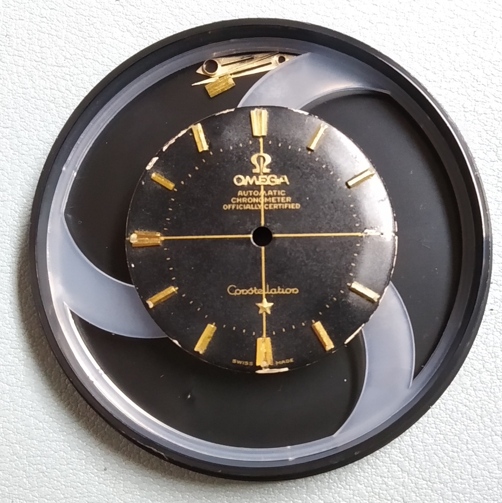

Hi all,

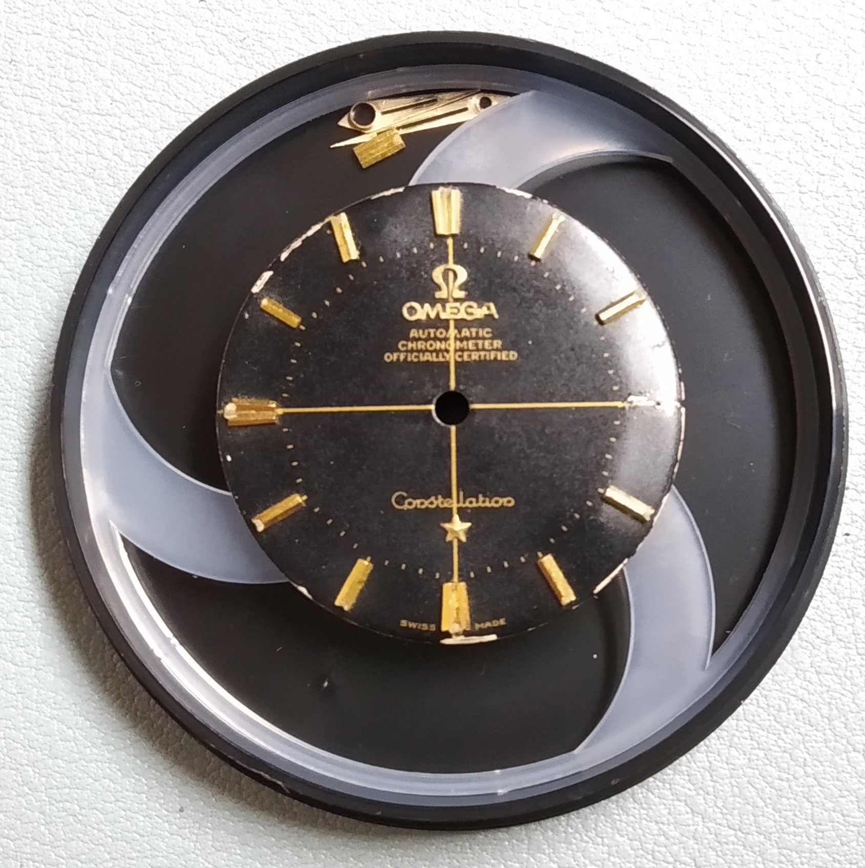

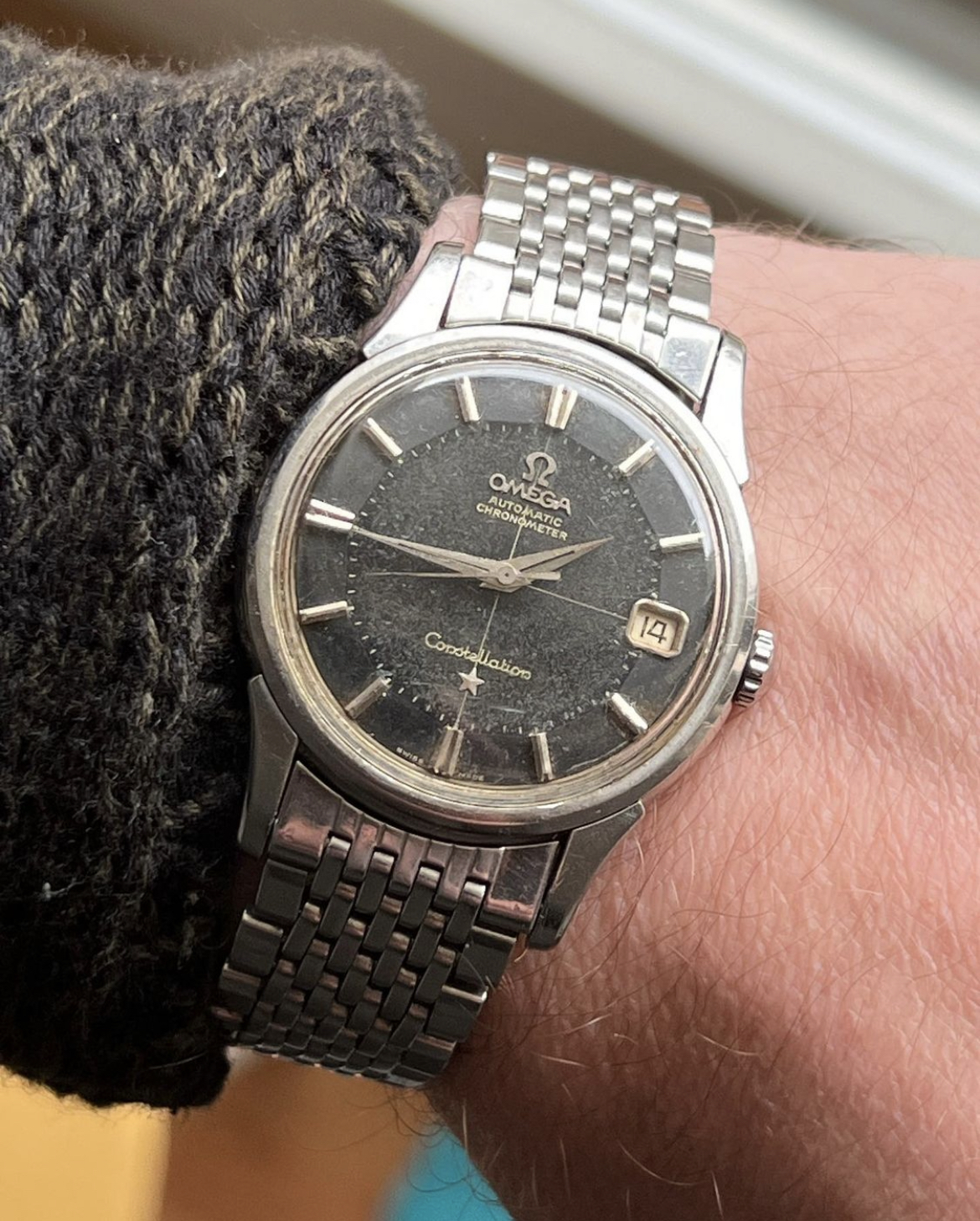

I have this nice Constellation Pie Pan Crosshair, with bicolor case, which I got from ebay. Unfortunately the dial is repainted, and not in a good way. So I want it to be redone again (By Bill&Sons). And I want a "correct" restoration. So I need the experts 😉

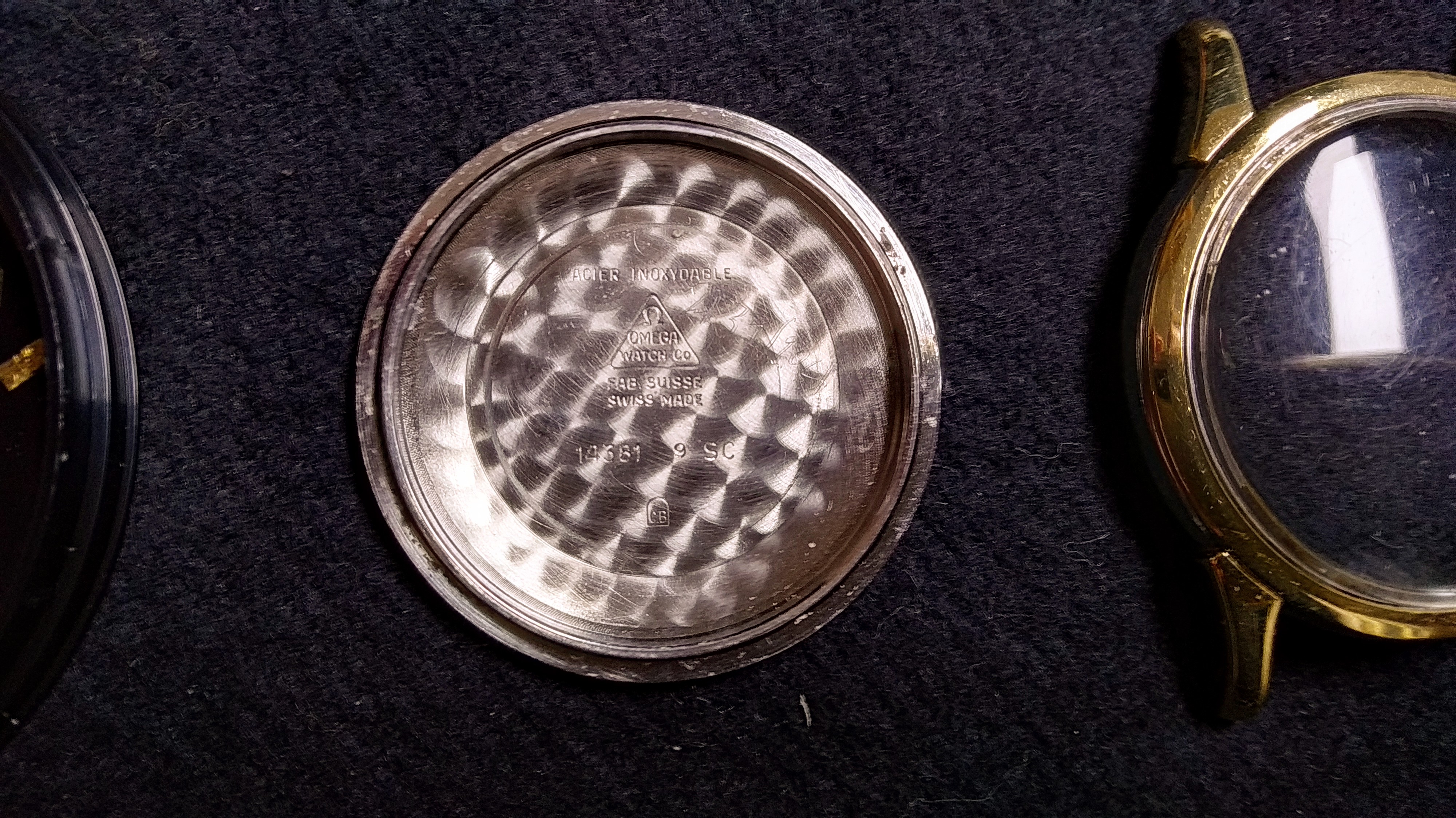

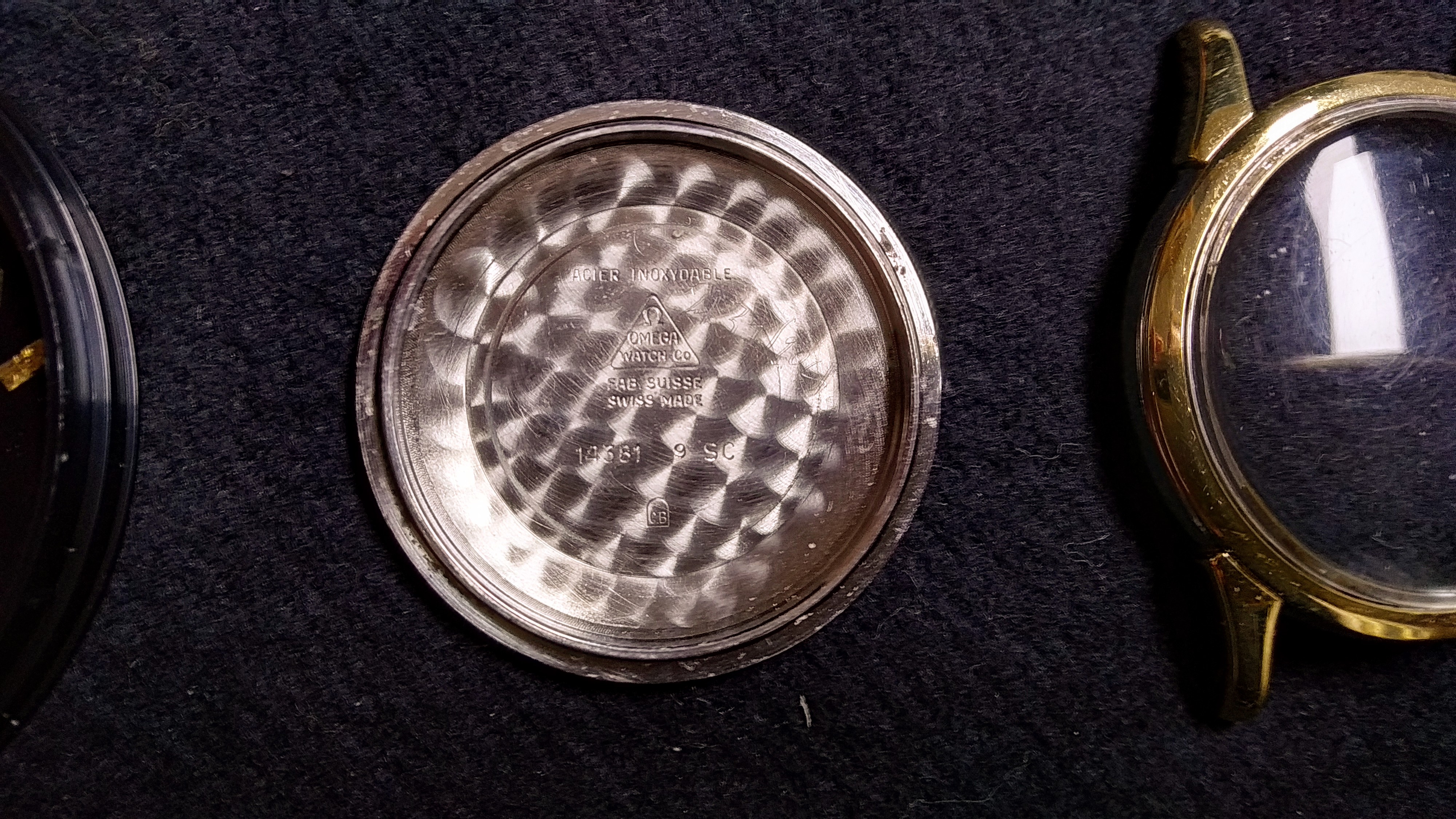

The movement serial number is 17mill, which dates it to 1960.
Case number is 14381.
So the more I search on the Inet, the more questions I have:
- Is the crosshair correct or should it just have a black PiePan? I do not find many PiePan + Crosshair on the Inet. Maybe it was just the fantasy of the previous owner? I didn't find a picture of a second Constellation with that design.
- matt or glossy finish of the dial?
- dial currently has lume on the indexes, should that be? But then it should also have lume on the hands, doesn't it?
- Is the crown correct? Or should it be a 8-sided crown? In silver or gold?
Do you have any other advise for restoration?
any help is welcome.
Tim

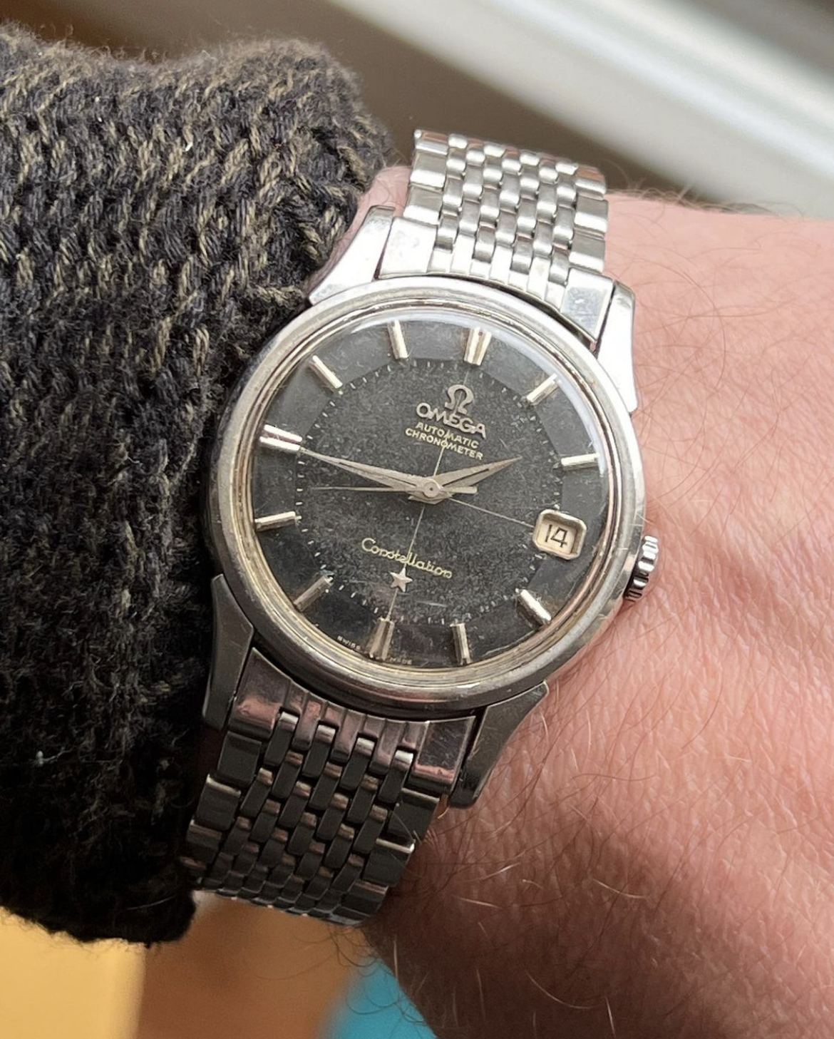

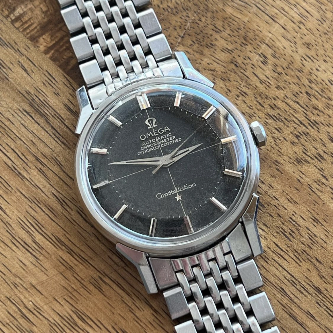

In the order of your questions:

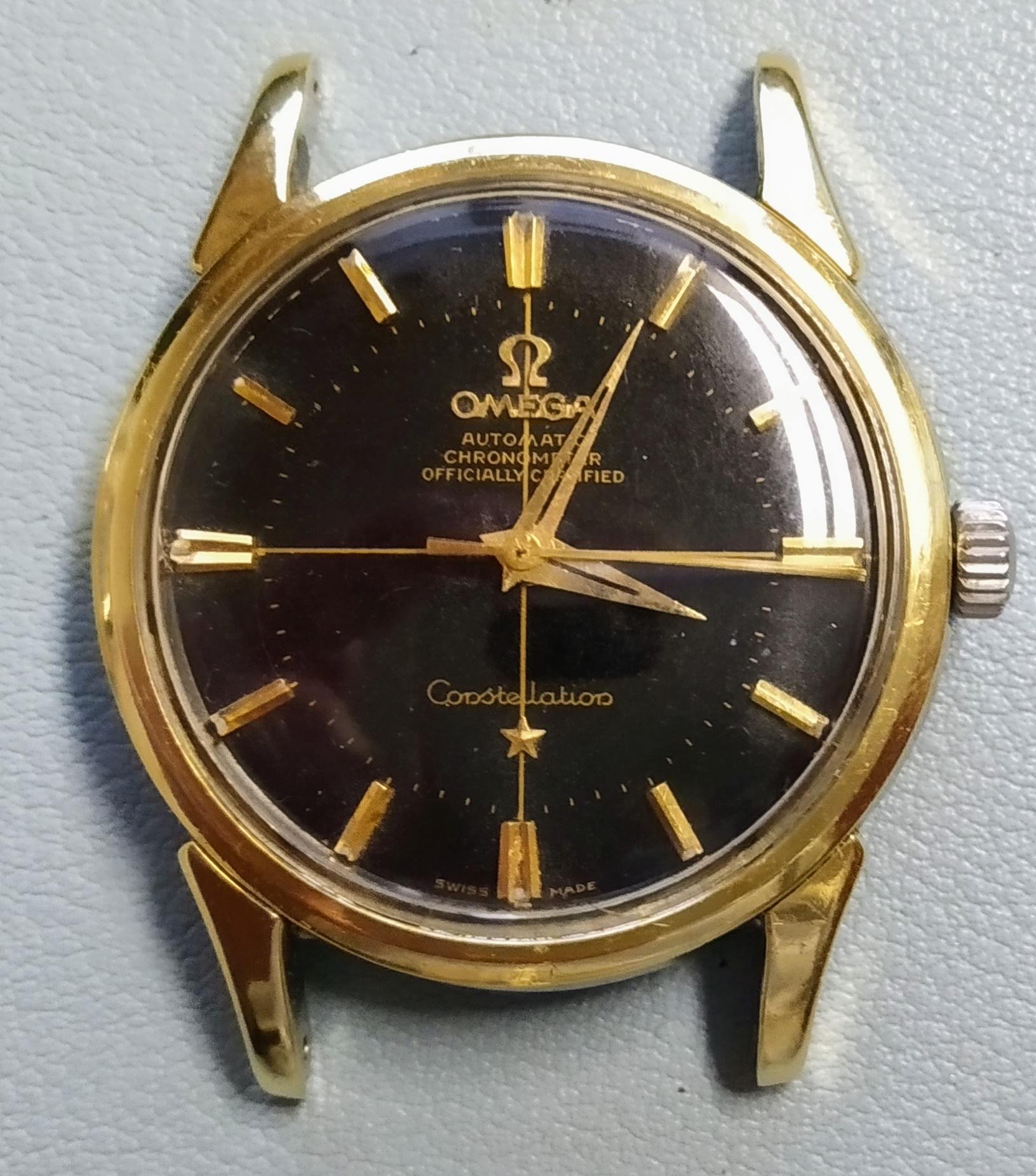

1. Cross hairs do exist on original pie pan dials, also on black ones:
2. Both glossy and matt finish exist.
3. Yes, your watch is supposed to have lume on both hands and on the dial. The openings in the middle of your hands are currently empty, which means the lume was removed. Make sure whoever does the relume knows what he’s doing, eg. no modern, fluorescent neon-green lume.
4. Crown is incorrect, should be a gold-plated example of either style of the pics I posted above.
5. General advise: I’m not sure I’d pursue this, as in the end you’ll still have a redialled watch. It definitely doesn’t make sense financially, should that be a concern.
One last thing: I’m not quite sure this is actually a pie pan dial. Hard to judge from the pictures, but redials often have pie-pan-style minute ticks on dome dials to create the illusion of being the more expensive dial variant. Which would also explain the second hand, as it seems to protrude the minute ticks all the way to the edge of the dial? Some more pictures would help to determine that, though.

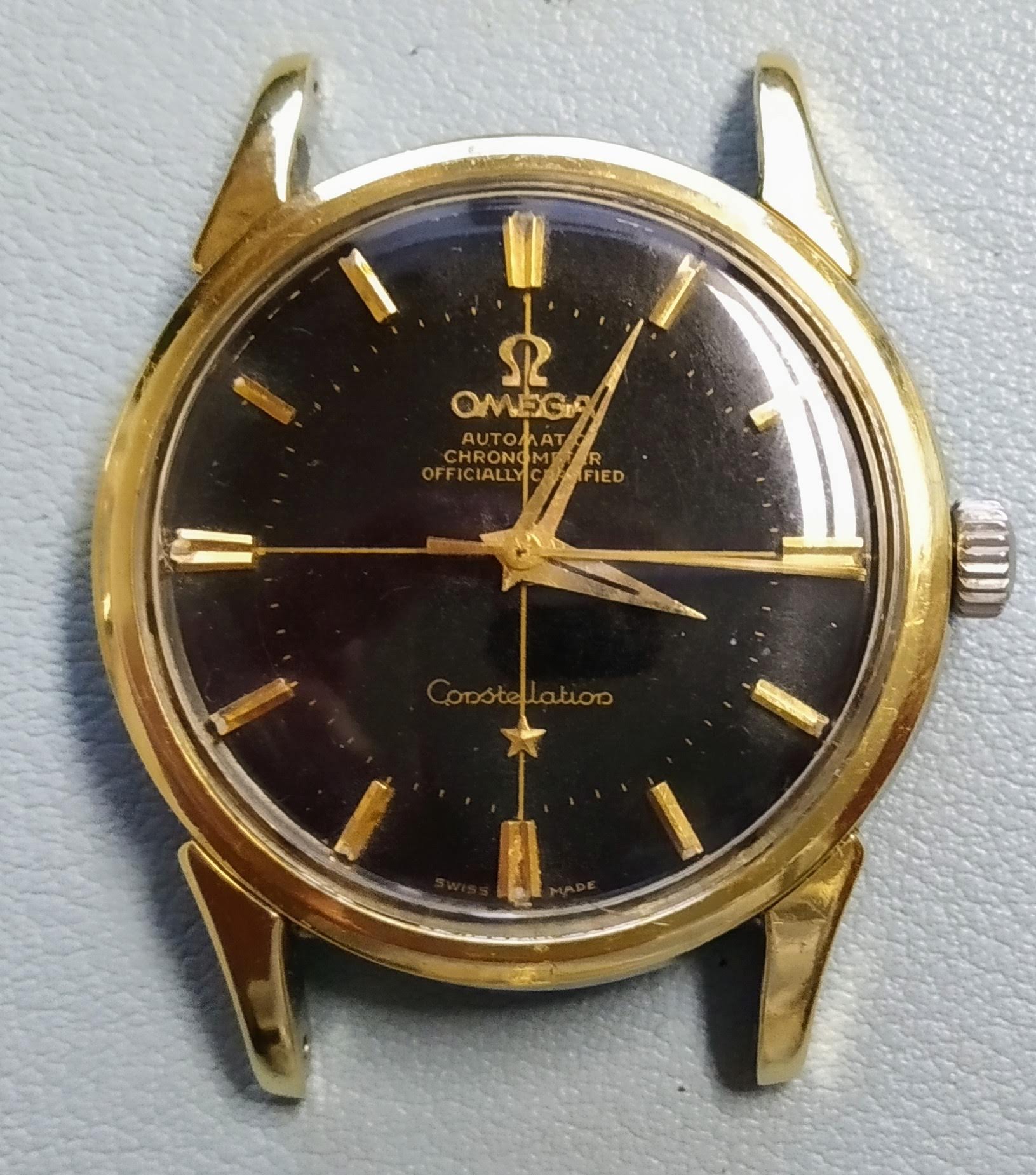

I’ve seen worse! The cross-hair has been applied heavily but the rest of the dial doesn’t look too bad to be fair. I personally wouldn’t bother having it redone as I’m not sure what your going to achieve.

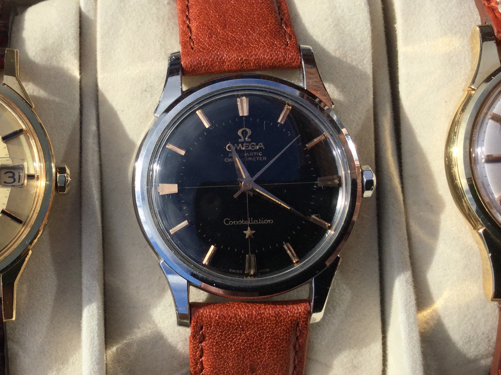

Here’s my 14381 with lume, cross-hair and decagonal crown.

BTW, I agree that I wouldn't bother pursuing a re-dial. It will never be an actual gilt dial, and you might not even get something that looks much better. If the dial is actually a pie-pan (and I'm not sure it is), then the shape has been badly rounded by the previous re-finishing. Maybe just repair the markers and have the hands re-lumed.

Thank you all a lot for your quick and founded answers and the great pictures. This motivates me to go on with that project!
You are right, it might not be worth spending 200-300€ on redoing the dial, ending up with a result is not much better than now. What bothers me most, is that the edges from the pie pan have been rounded up. And yes, it is a pie pan (see from the underside) or better: it was. And the "rough" paint. I can do better paintings with a spray can.
Do all these dials (with golden indices) lack the "officially certified"?
Ok, I think will just accept the dial as part of the history of the watch and do some minor corrections.

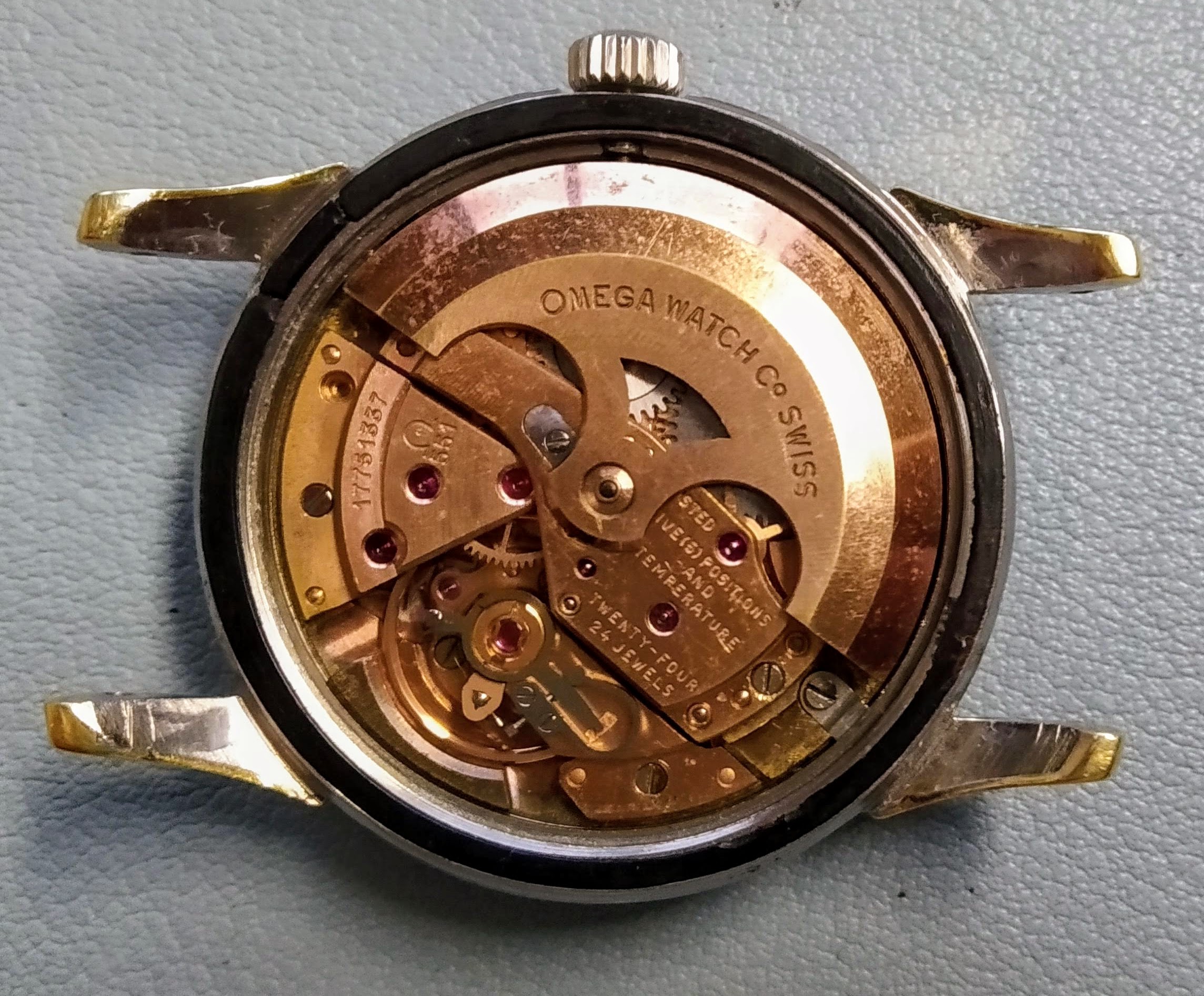

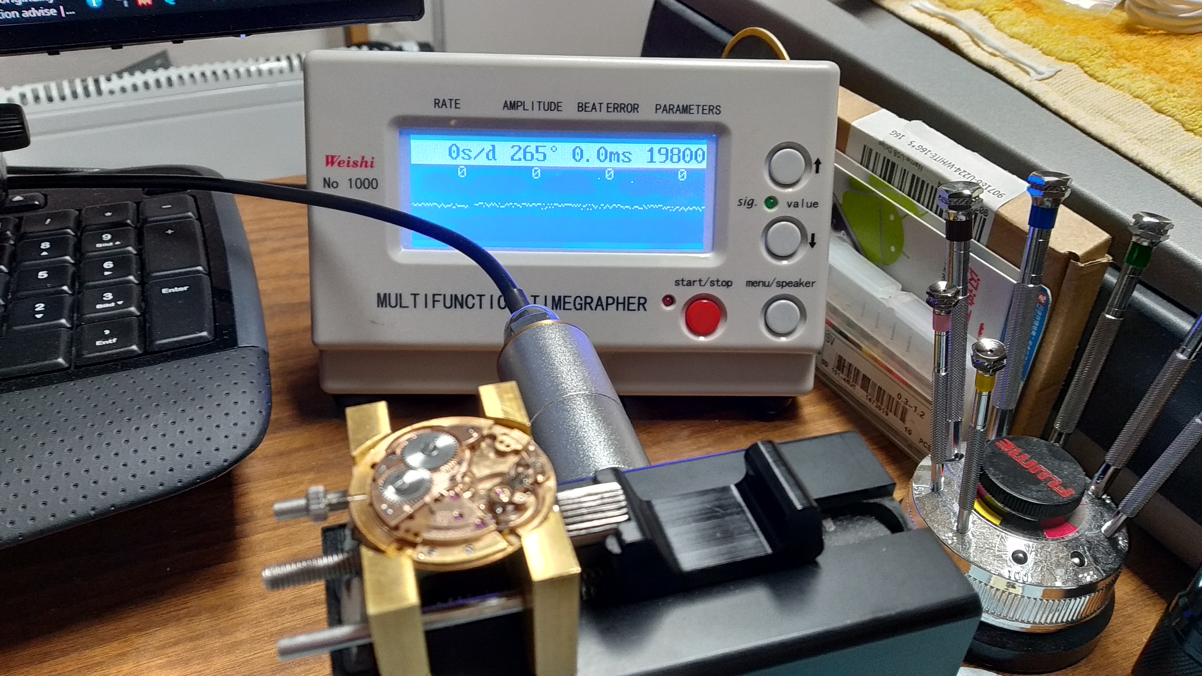

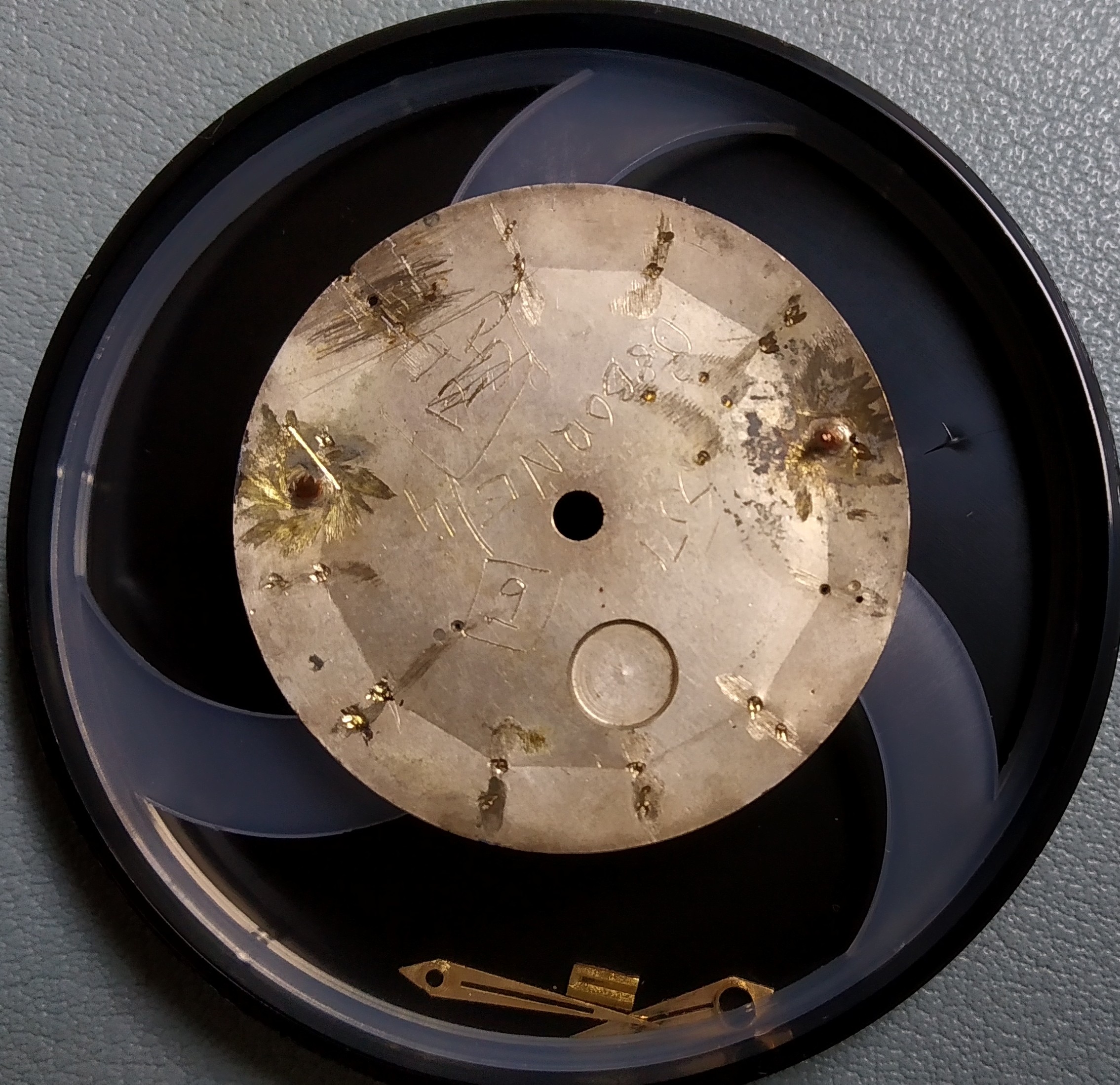

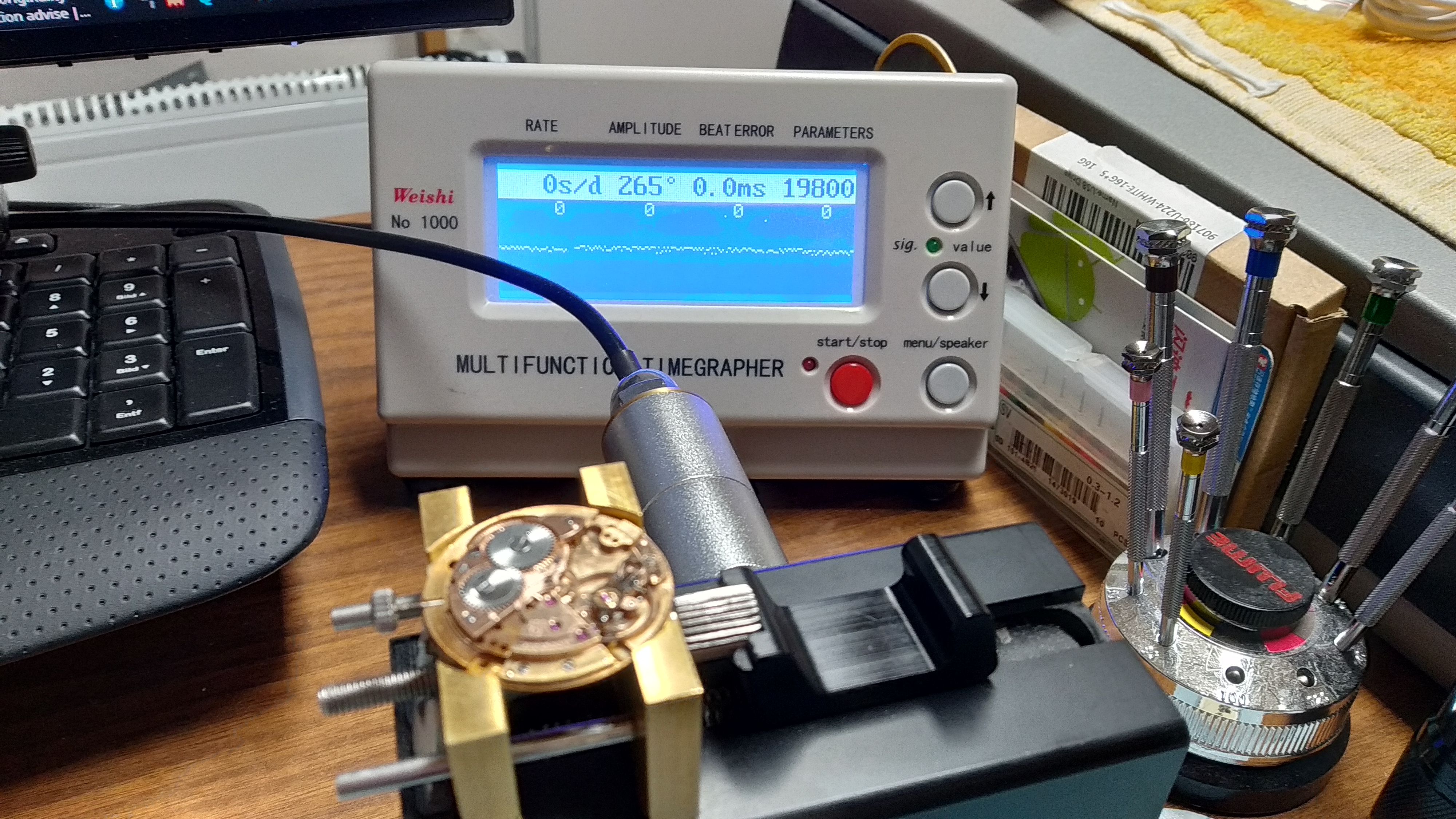

Now the movement is running again...

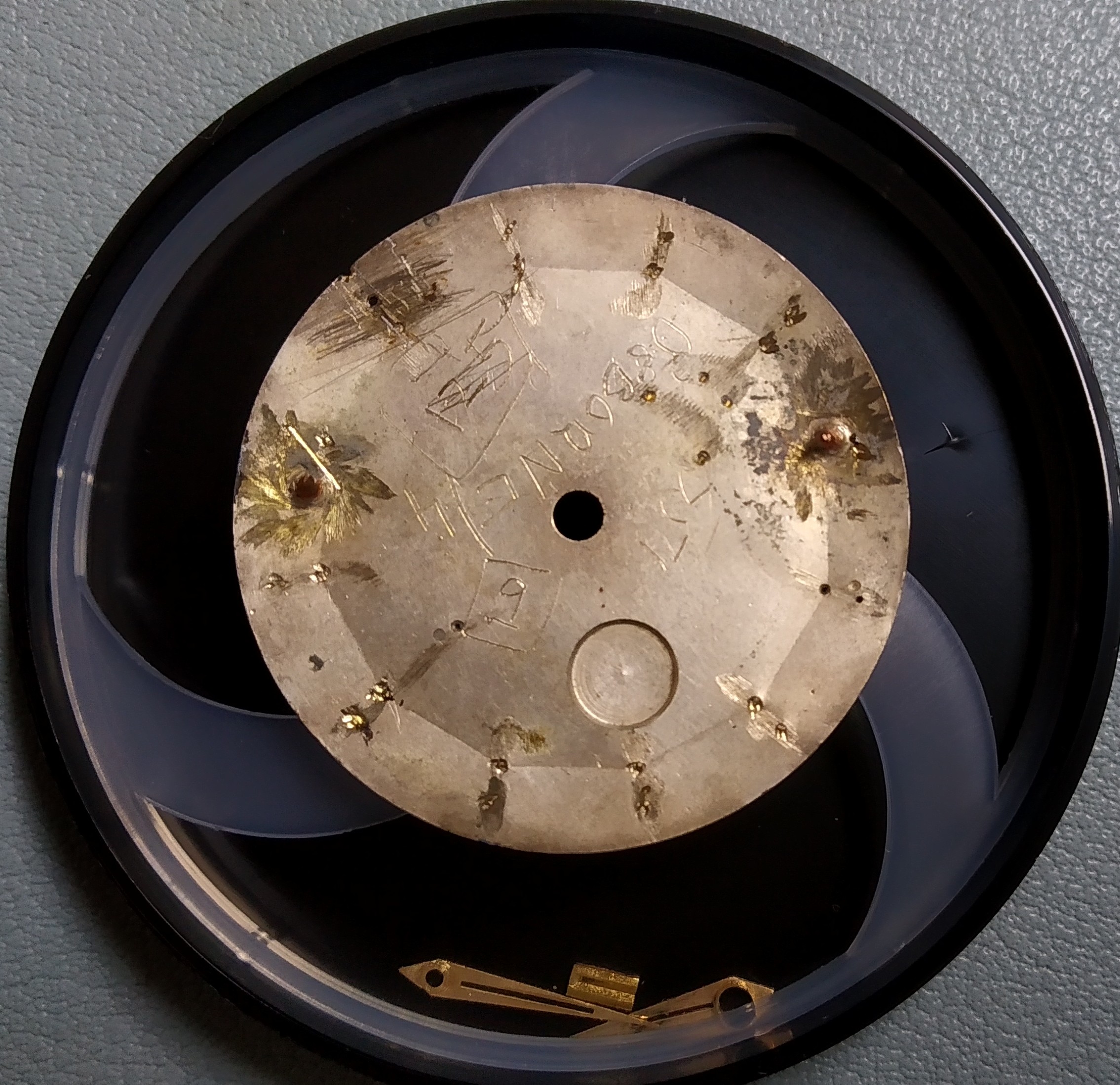

I also fixed that index on the dial - and had to see that the index at 11 is not fixable. They soldered the dial foot beyond it in such a bad way, that the dial is bent and the index is not laying flat. To fix that, you would have to remove the foot again 🙁
Also I realized that the index at 10 is shorter than the others. You can see that at the first picture.
Man, I hate everything about that dial!

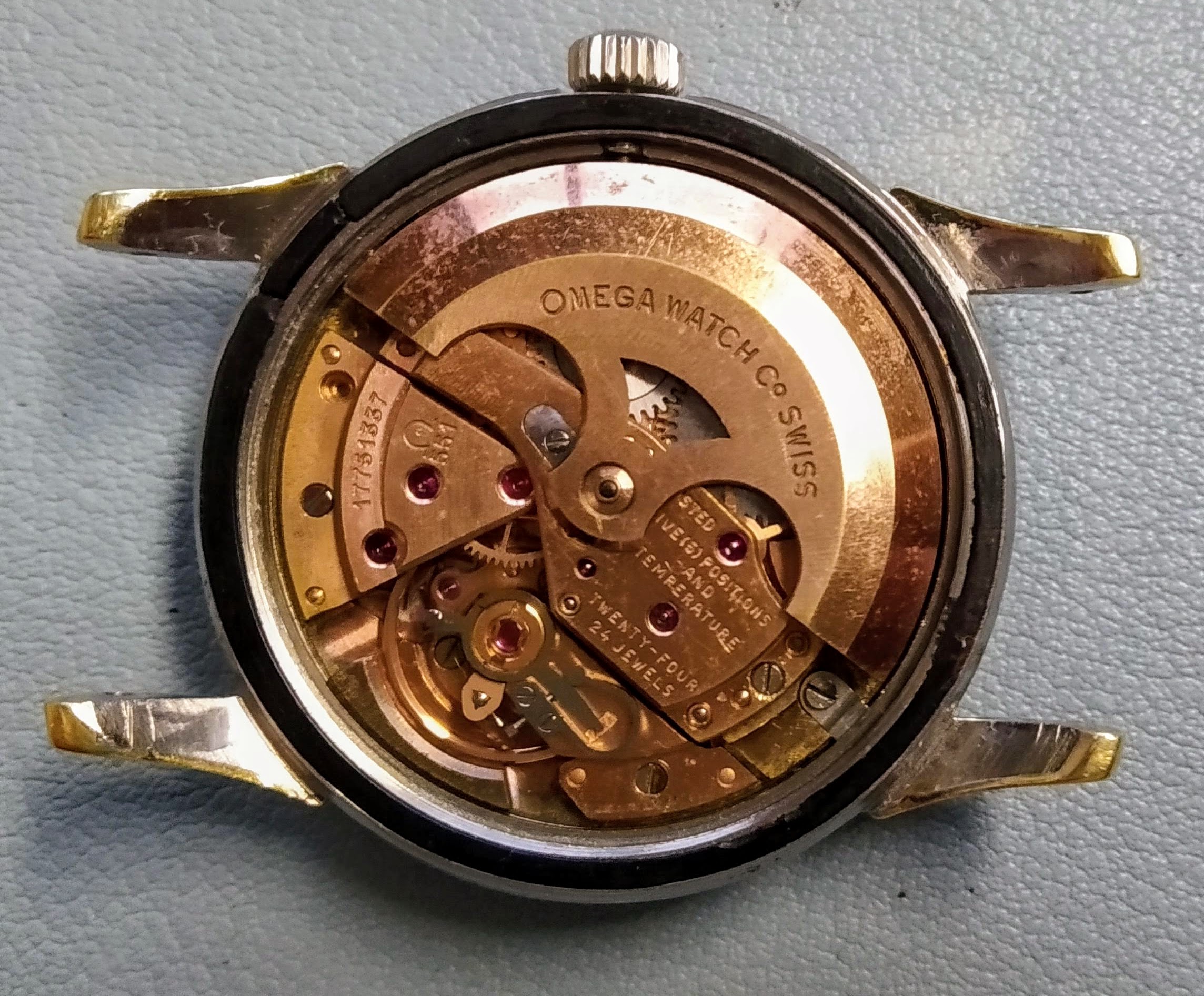

Nice work on the overhaul! Can't ask for too much better than that. How does it do in other positions?
