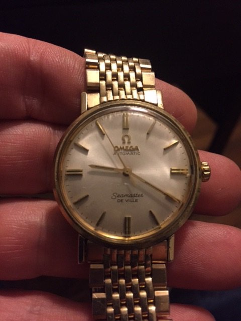

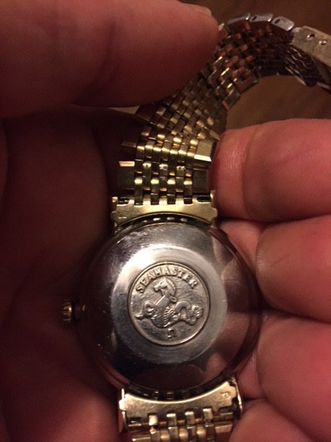

    I also am looking for as much information as I can get on a Seamaster Deville (circa 1965). This watch was a family heirloom and as such I would never sell it (it was given to me by my parents who inherited it from my grandfather, it was a gift to him from my grandmother on their weddingg day - which I think was 1965 or '66). I think the crystal was replaced, Im not sure what else has been repaired or replaced.....
    My questions are this:
    How can I discern exact year?
    Is the bracelet original?
    How much of it looks replaced?

  13. efauser I ♥ karma!!! Dec 4, 2015
    8,644
    14,210
    Take it to a watchmaker and have him take out the movement (it is a front loader). There's a serial number on it that you google the approximate date. There's also a reference number stamped inside the caseback. You can also google that to learn a lot about the watch.

  14. WatchMeWin Dec 4, 2015
    10
    Thanks efauser - I will pursue that
