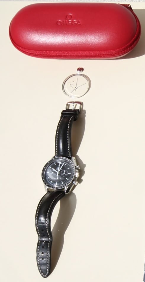

AFAIK, after an Omega service, they returned the parts that were replaced... 2016 post-service with return pouch
(Photo: MoonwatchUniverse)
6,545
22,332
True, you can have the old hands and pushers put back. But you can't undo polish. Omega polished my 2010 Apollo-soyuz Speedmaster 🤬 There was no need for that. I have a hard time trusting that they would leave a vintage watch case alone.

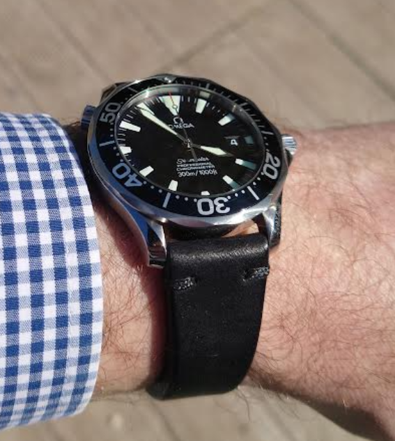

Hello everyone,
This is my first post here, my name's Jerome and I live in France. I have been reading this forum for a long time and would like to take the opportunity to thank all contributors who make this place a very complete source of information.
My message is not about the Speedmaster but about the beautiful 2254.50 below that I bought a couple of years ago.
It has been losing time recently so I guess it is time for a service. I am considering sending it to Omega but would like to check two points beforehand :
- The bezel has a light scratch and i am considering changing it ; do you have an idea of the price for that and will the old one be given back to me as well ?
- I will send it with the bracelet (not shown here), but I changed the clasp to the micro-adjust type. I read a while ago that modded watches (ex: dial change) were usually restored by Omega to their original condition when sent for a service. What would happen to my clasp ? (i wouldn't like them to put back the original clasp !)
Thanks !
10,800
16,810
They will fit a new bezel if you request and pay for it and will return the original. The cost is now something like an extra €250. It’s gone up a lot in the past 5 years, doubled in fact. I doubt they will care about the clasp as it is a modification with a genuine part.
