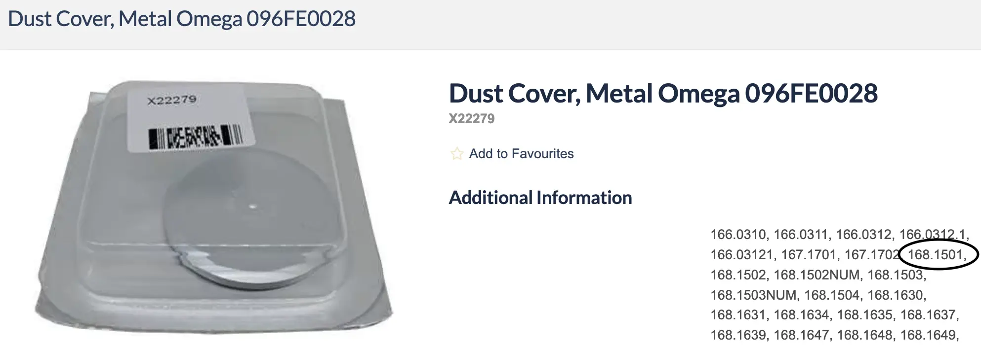

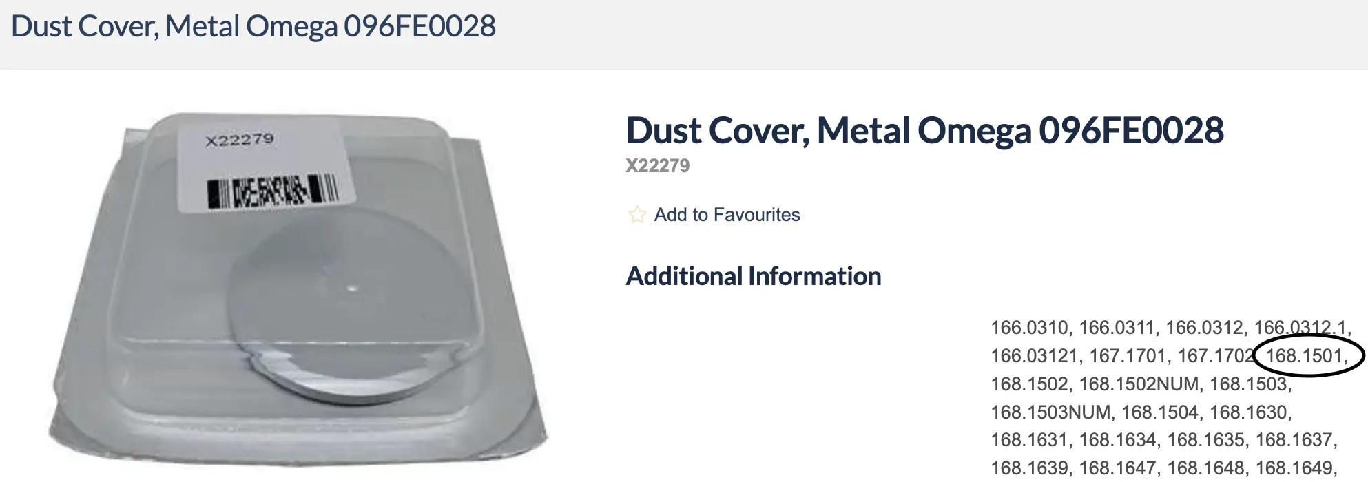

Strange enough when I search for 168.1501 on cousinsuk it shows 096FE0028 and 096FE0041 both as fitting dust covers. And 096FE0028 also shows 168.1501 as a reference (as you can see in the foto). That is why I was hoping I could get the 096FE0032 (which is actually still available btw on cousinsuk) for £17.38.
Maybe a mistake on the cousinsuk site. Definitely confusing for me. Thanks for carifying 😀

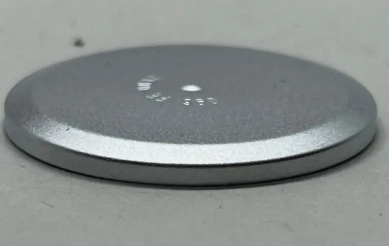

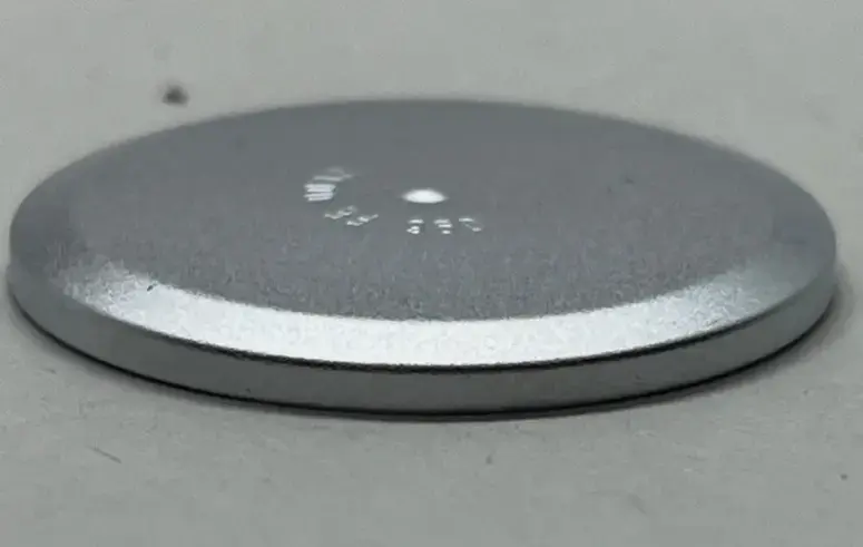

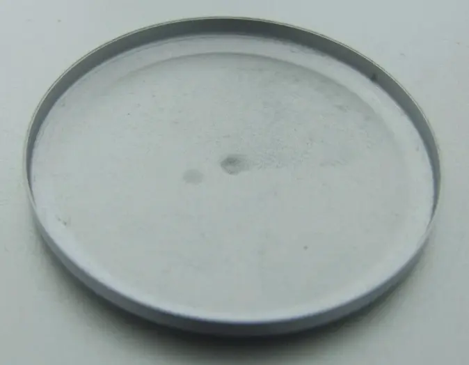

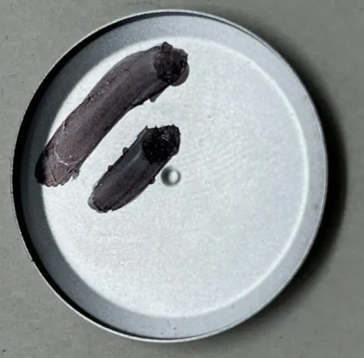

096FE0032 works for Omega 168.1501 (2501.80) - fits like a glove.
Dimensions: Ø Outside: 27.7 mm ; Ø Inside: 22.2 mm ; Height: 2mm
