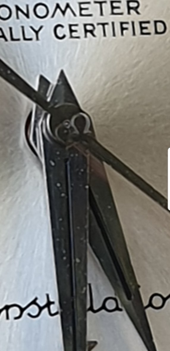

Has anyone seen a picture of the watch with the "no logo" crystal? Perhaps I've missed it?
I don't know @arttie5 as he's new here so, how about he posts a picture of the watch without the logo and tells us who the watchmaker is?
I spend time lining up these flipping logos so, I would imagine other watchmakers do as well. I don't know the real issue here so, reserve judgement until I see there really is an issue.

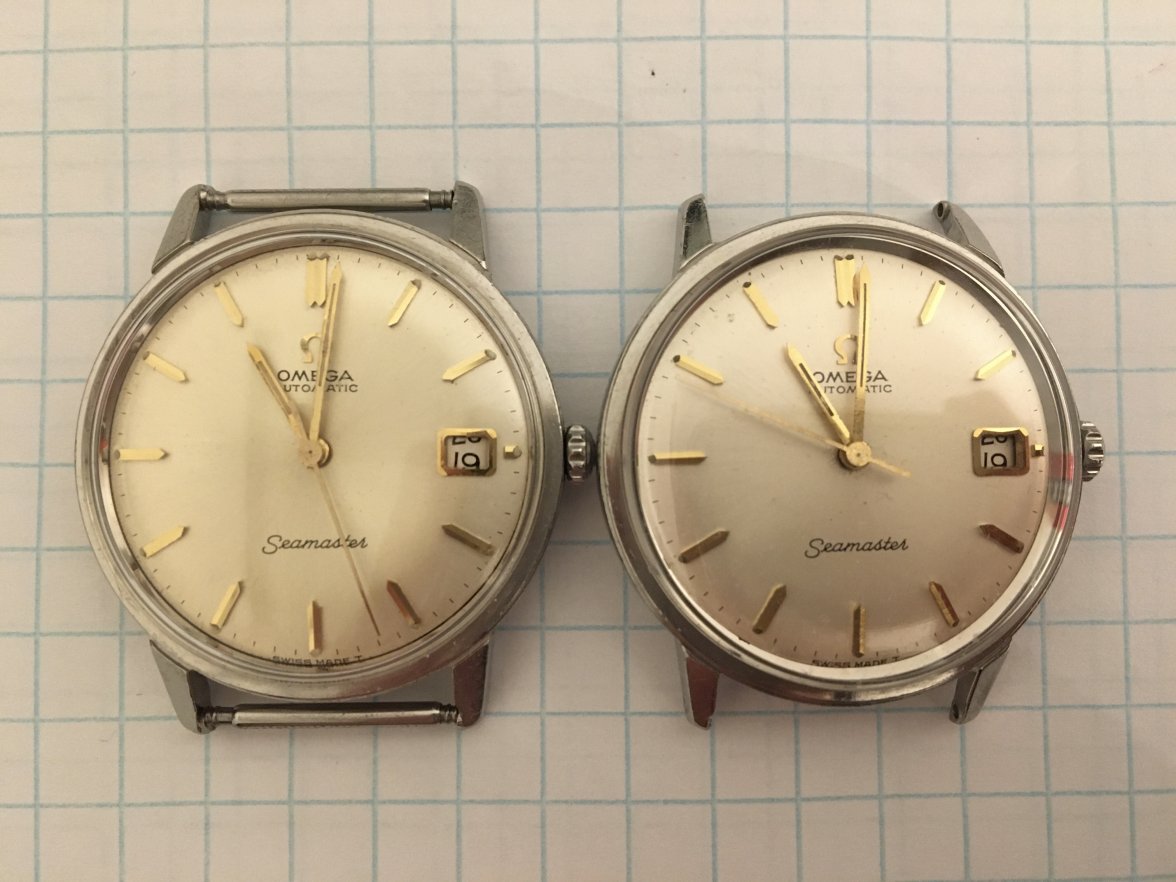

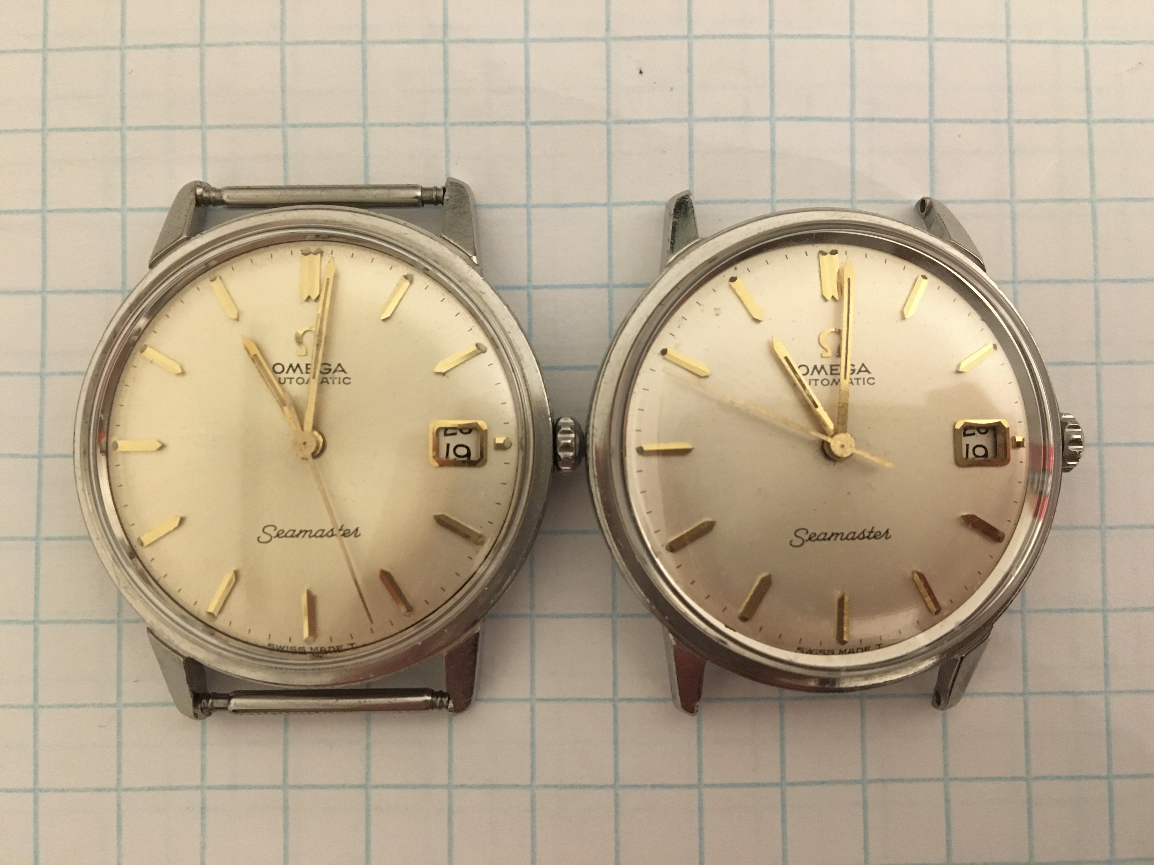

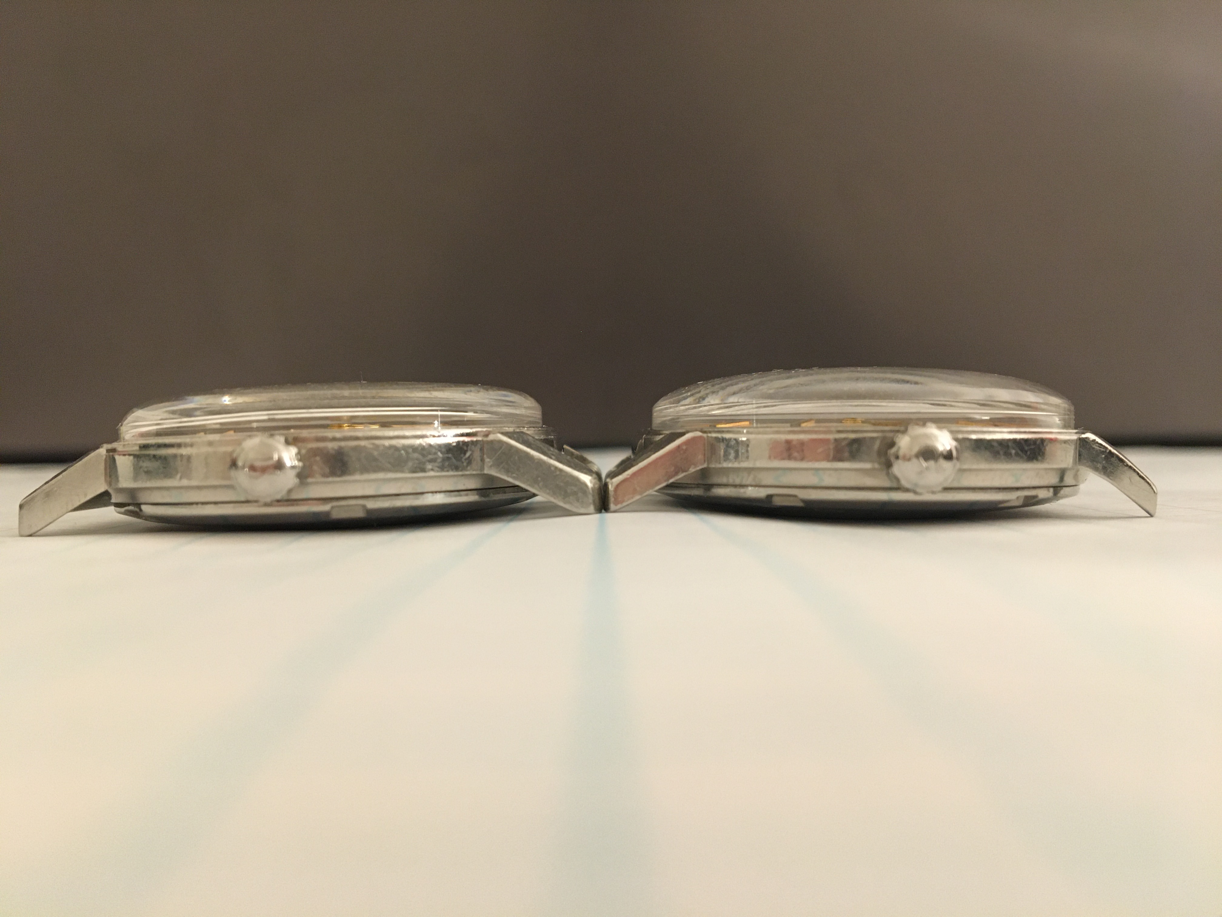

OP, do both crystals have the same profile, do they look the same, or can you detect any difference in finish, clarity or other characteristic?

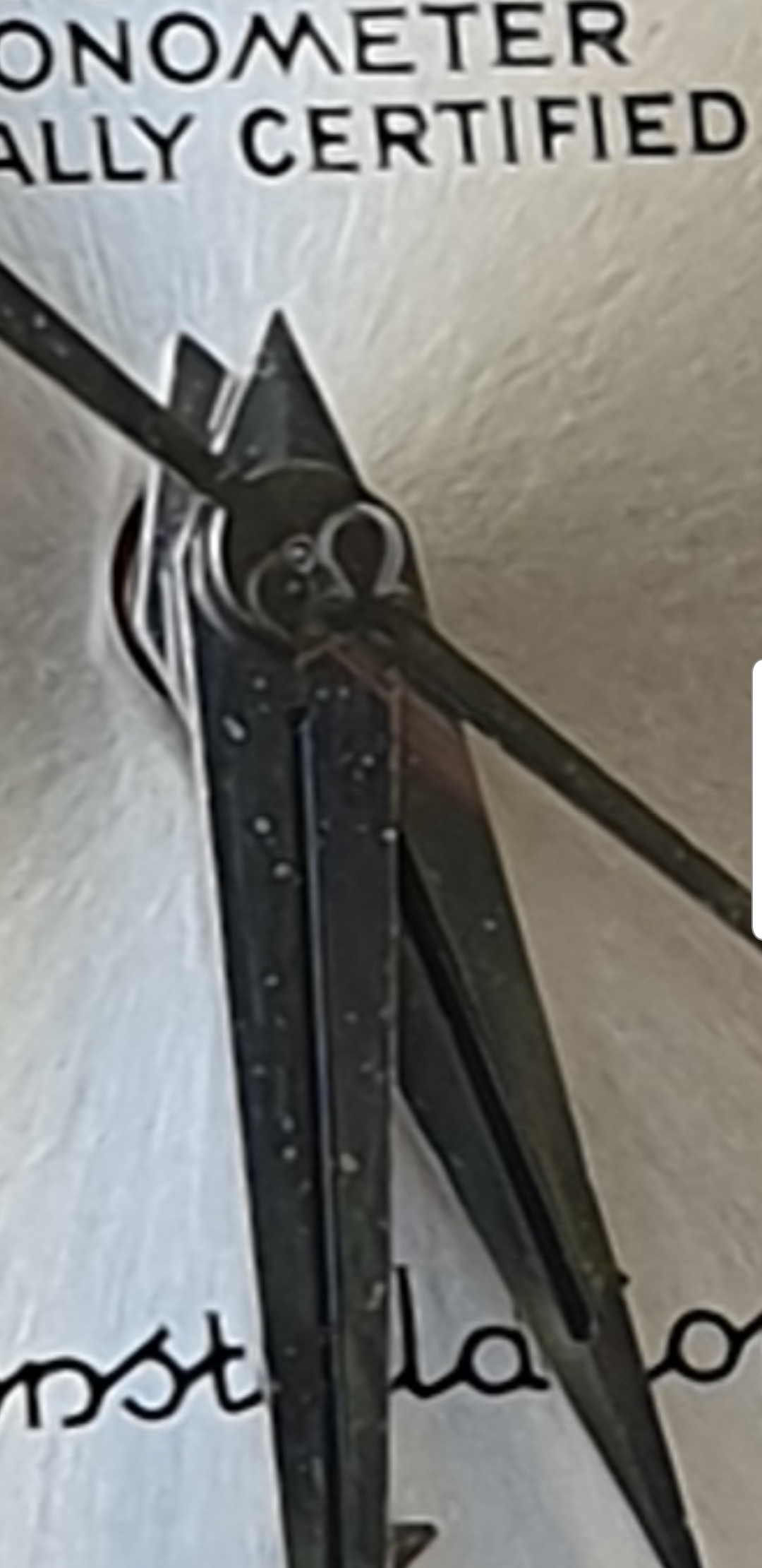

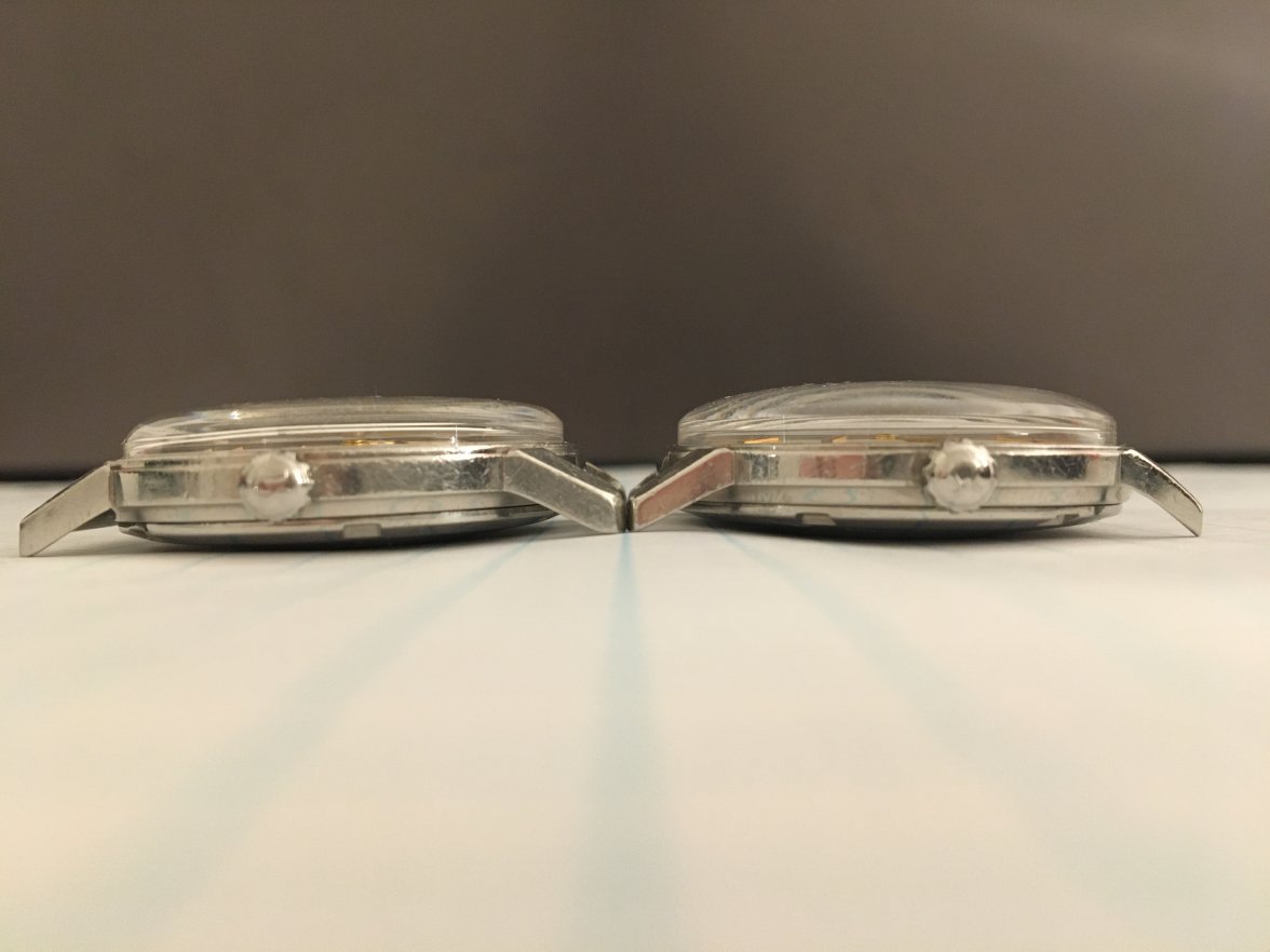

So, I decided to take a closer look and tried my best to line them up on grid paper. Am I crazy, or is the left crystal levelled off more near the top in this picture? (That's the one without the logo.)

Here's a side-by-side comparison; the left one is the one with the logo, the right one without. I don't know what other pictures would be useful, since I don't have a camera good enough to resolve the existence or non-existence of this phantom logo. But hopefully this can rule out the possibility that I'm missing the logo because of a difference in the dials.
I've deliberately not named the watchmaker publicly, in case the error is indeed on my side, or Perrin's, or Omega's; I'd rather not unnecessarily damage a watchmaker's reputation because of something that might not be their fault. But the more I stare at this crystal, the more I'm convinced that it's missing the logo, and after following @Evitzee's suggestion, I think it might not actually be the crystal I asked for. If you're dying to know the watchmaker, I can tell you over PM.
In any event, I don't think that the watchmaker is acting out of malice; they called me today, offering to take my watch to Perrin to see if they have a fitting crystal with logo, or to replace it with a generic and refund the difference in price.
7,797
14,399
The left crystal definitely looks flatter. and not the same as the right crystal. I think you'll have to take your watchmaker's offer and see if they can make it right, or refund the difference. Give them a copy of your first picture for reference. No need to out the watchmaker, it doesn't sound like he is trying to pull a fast one. It's beginning to look like an honest mistake or mixup somewhere along the way.

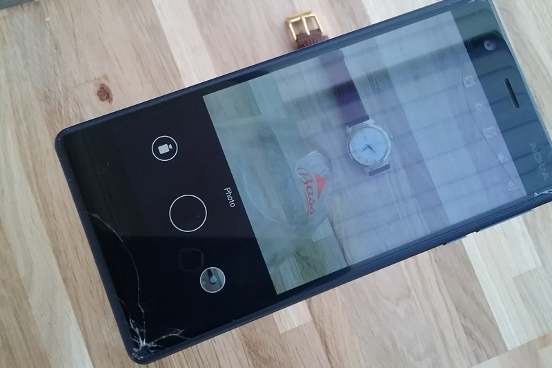

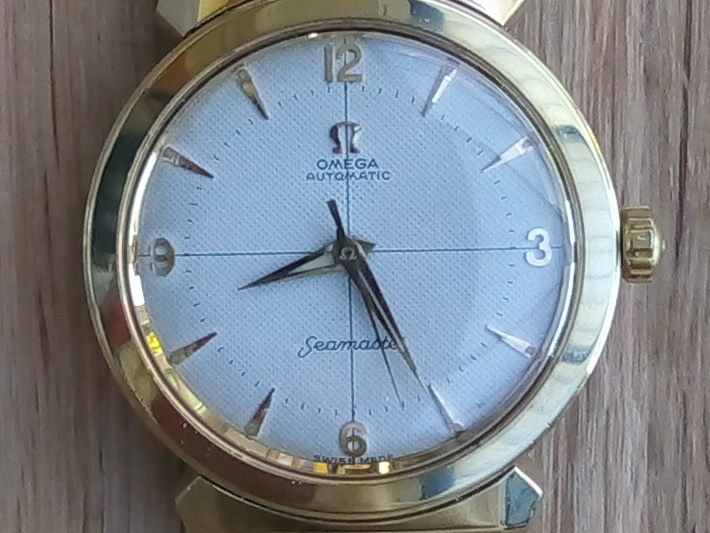

You dont have a smart phone with camera so you can take better pictures? This picture was taken with my phone.

They are different crystals.
The crystals came from the same lot number and if both packages were unopened when received by the watchmaker I consider it EXTREMELY unlikely that they would be different.
When they are made, the Ω is part of the die used for forming the crystal so it's highly unlikely that this one skipped a "stamping process".
I suspect an innocent mix-up by the watchmaker.
That is my smart phone camera. Not all smart phone cameras are equal; mine doesn't focus very well on objects too close, and digital zoom doesn't help much.

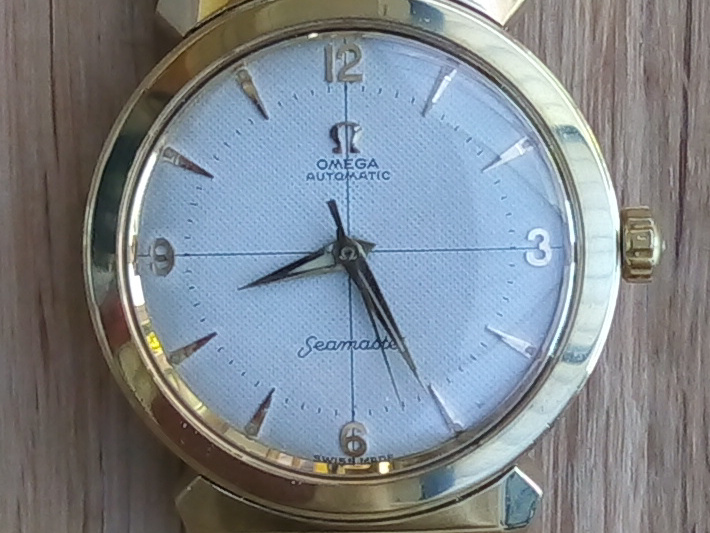

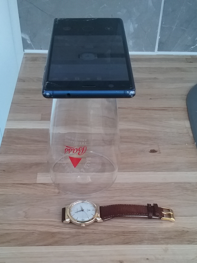

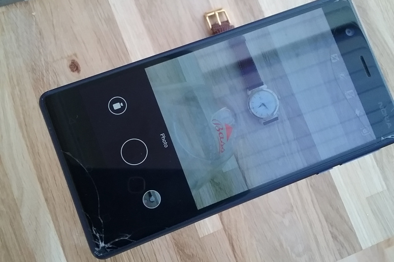

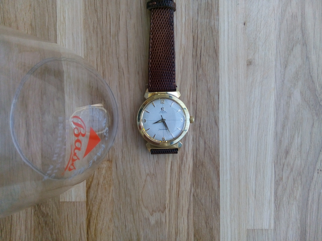

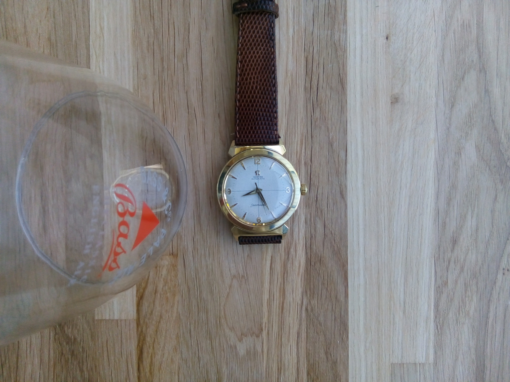

I have a very cheap Nokia 1020 and it is not good for photos either. You can get the best out of these by removing the hand shake. I set up like this using a Bass glass (other beers are available).
Here's the Nokia with the multi cracked screen...
The photo is this (reduced the size).
And cropped.
Sometimes, out in the sun, you can just get a photo using hand held - the key is usually lots of light and steadiness.
I hope everything works out.
