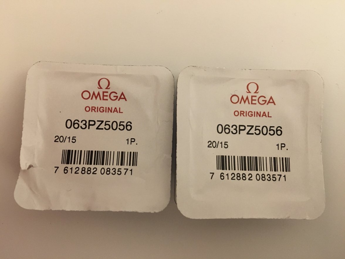

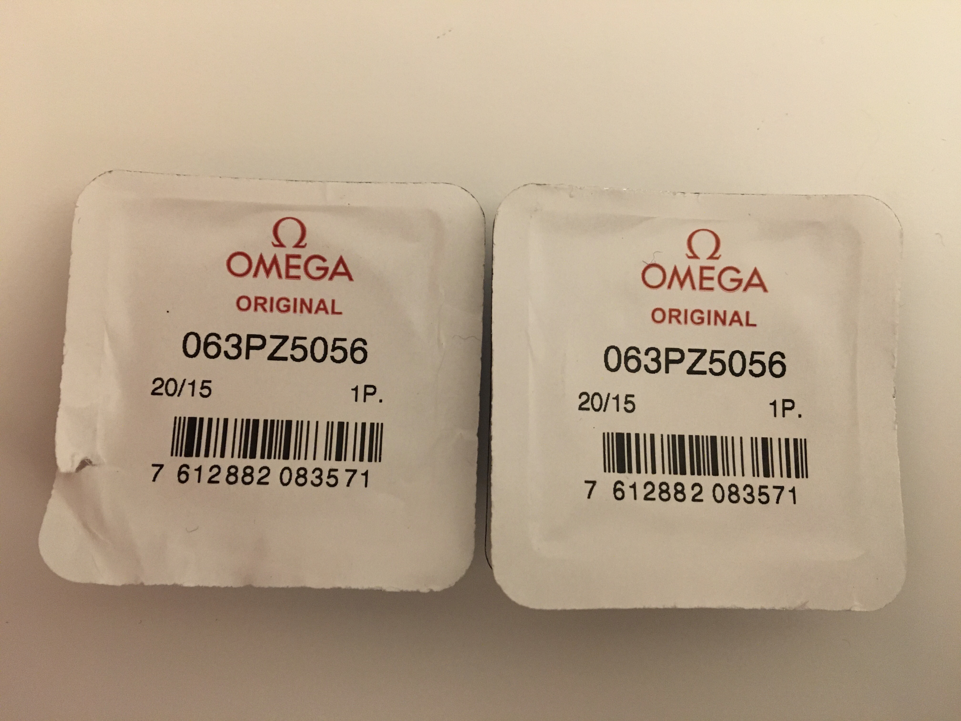

I just had two Omega Seamasters 166.002 cal 562 serviced and paid extra for two genuine Omega crystals matching the original (PZ5056) to replace the fractured crystals on both. I can see the Omega stamp clearly on one of the crystals, but after spending half an hour staring through a loupe at the other, I've determined that either I'm crazy or the stamp is missing.
When I called the watchmaker, he claimed that sometimes these crystals simply don't have the stamp, but I've never heard of this before. I'd like to believe him because 1) he seemed reputable from recommendations on this forum and elsewhere, and 2) he gave me the packaging for both crystals, and they're identical:
Still, I have a niggling doubt in my mind that perhaps I have been given a crystal which is, in fact, not genuine. Does anyone know if a missing stamp is a typical manufacturing defect on these crystals?
I can give you two opened packages too. Big deal. Let's see an unopened package with an unstamped crystal.

I've not seen this before and those two packages appear to be the same batch (20/15) so, it seems unlikely that one has a logo and the other doesn't. However, I suspect you are not seeing the logo - it should be obvious but perhaps the dials are different colours and one is easy to see but, not the other. Do you have pictures?

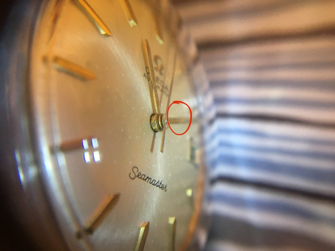

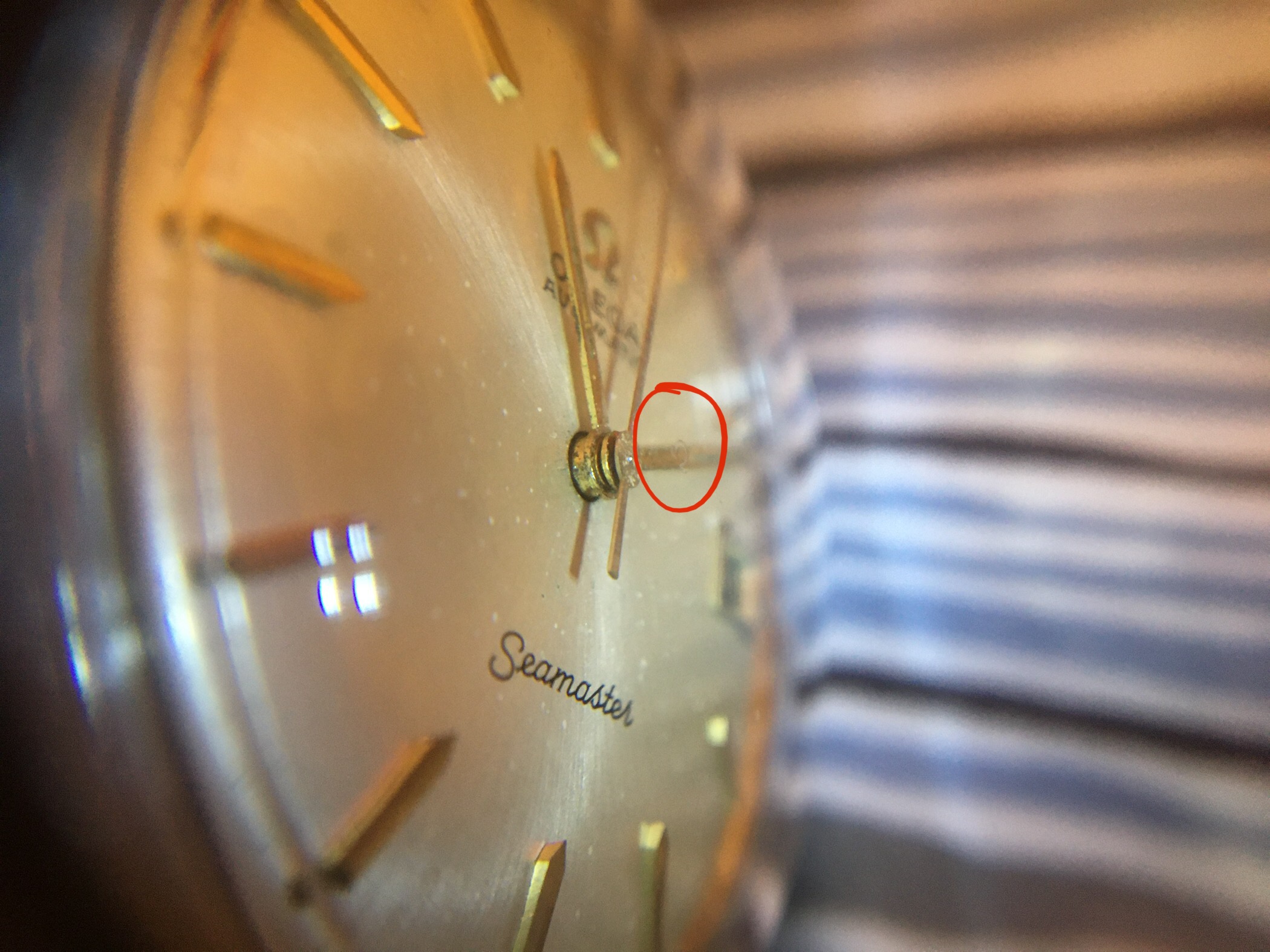

To the best of my knowledge, non-stamped plexis have sometimes been used by factory in 1966-1968 and 1987-1990. Other than in these periods, all the plexis used or ordered by Omega were stamped.

Here's a picture of the crystal with the logo. Unfortunately, I don't have a macro lens with me, so I had to take this on my phone through a loupe, and the side angle was the only way I could get the camera to focus on the logo; sorry about that. I've circled the logo in red:
The dials are the same between the two watches, though the other one is slightly more yellowed. I don't think the dial would make a big difference though; both previous crystals had Omega logos which I could very clearly see, even with naked eye. With the new crystal pictured above, I can still see the Omega logo even with my naked eye, but I can't find the logo on the other crystal through either loupe or eye.

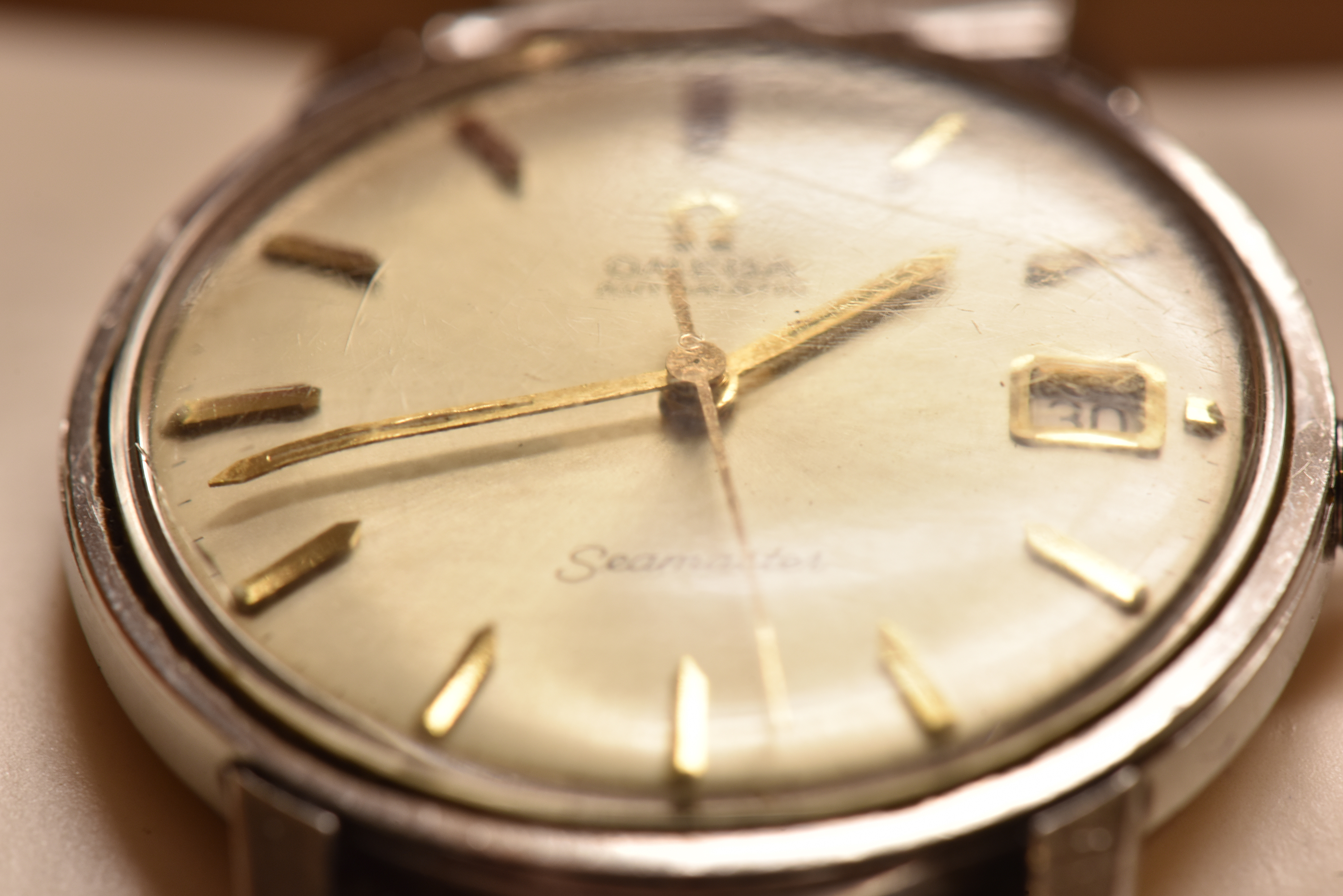

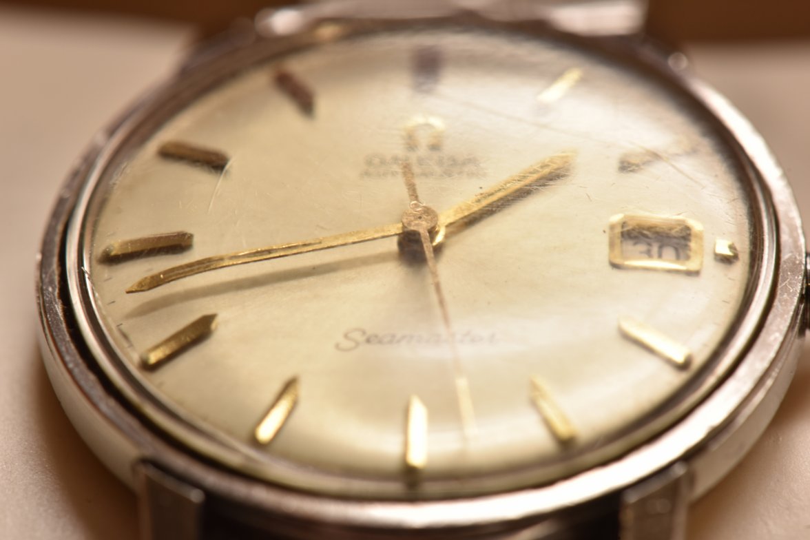

For what it's worth, here's a picture of the other watch before crystal replacement, with the logo very visible.
