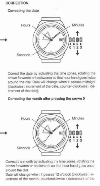

Not sure that anything is really wrong there, as you are moving the hour hand in the video.
If you pull the hands out to the time setting position and turn the hands forward, does the date flip at midnight?
35
53
Setting position does not change the date.
30,292
78,208
Okay, but does the date change at midnight when the watch is running?
35
53
No, only around 12:47~1. I don't remember exactly, but 100% not around 12
30,292
78,208
I would just wait until the watch is serviced to get this corrected.
