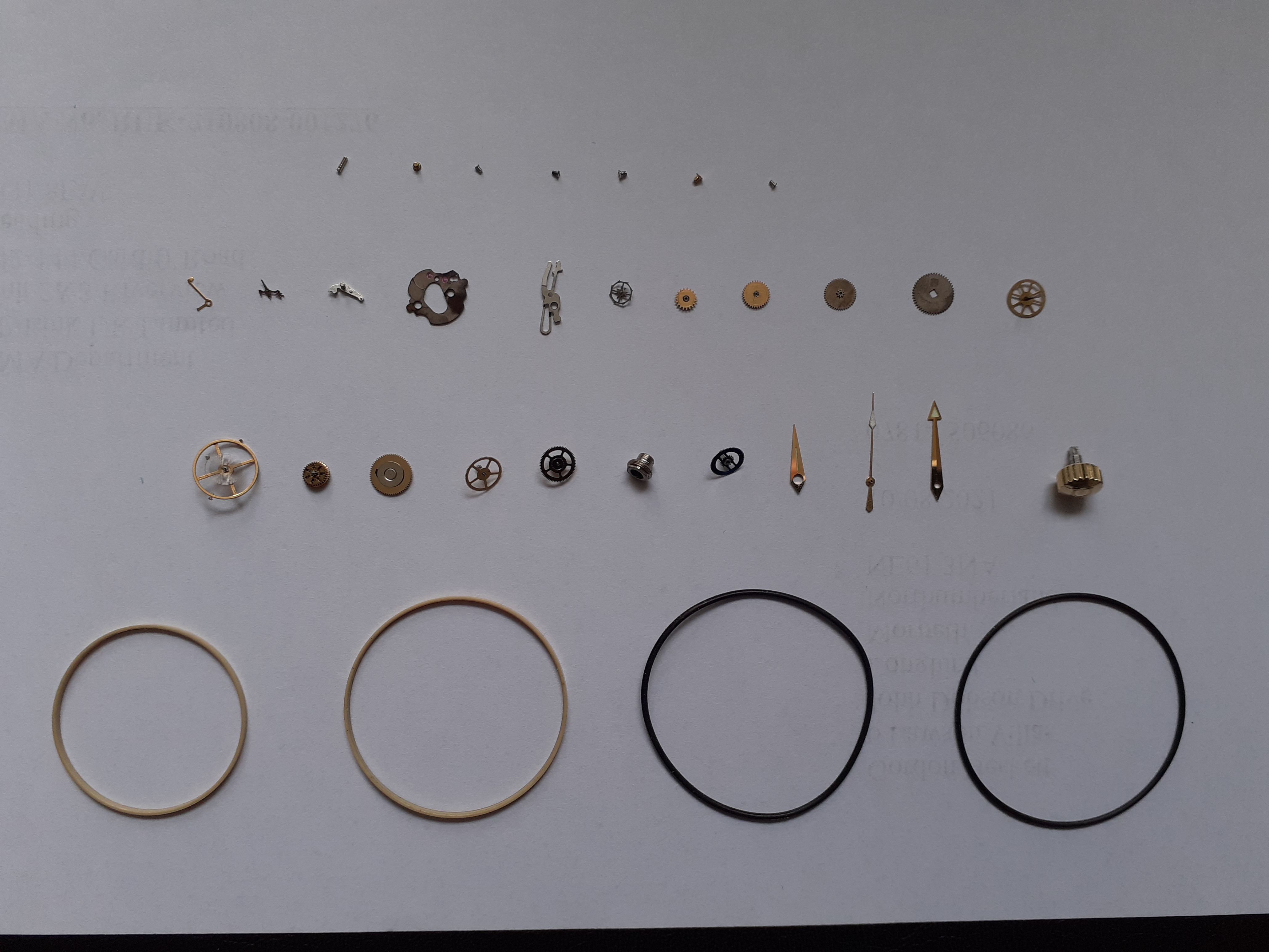

I am definitely using an accurate time source, which is the time displayed on my mobile phone (which is the same as that displayed on my desktop PC). I've been checking the watch every morning, and for the first two or three days after winding it keeps reasonable time, but begins to lose increasing amounts of time after that.
Here are the readings for last week: -1s, -3s, -10s, -20s, -49s, -66s, -83s.
It seems like the watch is running down, as after I've wound it, it is O.K for a few days, but then loses increasing amounts of time.
The watch was definitely serviced by Omega. I received all of the components that were replaced (see attached pic.)
Thanks again for your advice
Gordon
If Omega serviced your watch you would have been given a 2 year guarantee, not 12 months.
I've checked my receipt and it definitely states 12 months guarantee. I'll have to query this with the service centre that I took the watch to!
