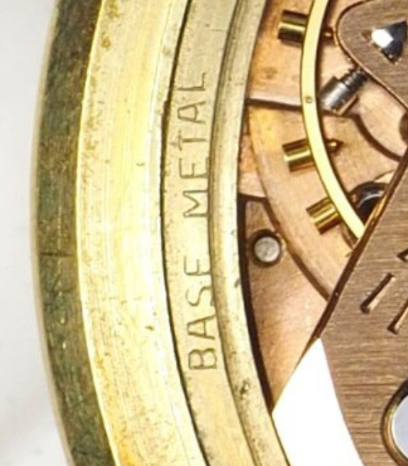

Just stretching my legs here, but if the caseback says 18k gold (750), why does the case say base metal?
3,593
8,210
Dave, I assumed that the "base metal" was pertaining to the movement spacer, not part of the case.

Base metal is the movement spacer. Not the case.
