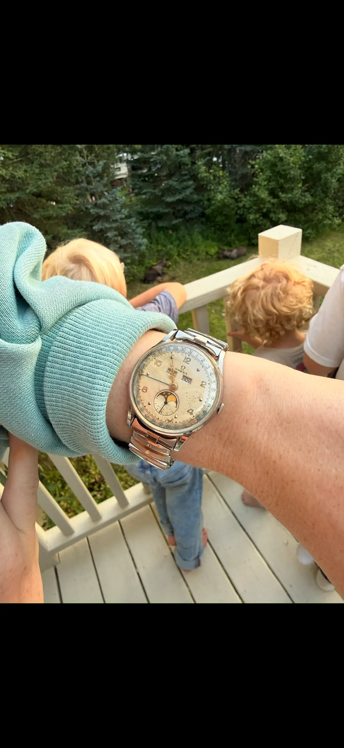

My wife and I were gifted this by a family friend whose father was a watch maker. I’ve looked at as many photos I can find and I haven’t seen any with this hand set. Do any of you know if it is a different reference or where these hands might have come from? To the best of my knowledge it is an untouched dial that has been living in anchorage Alaska for the last 60 years.
Also, it is currently not functioning. I understand it might be difficult, but because of the family sentiment I want to get it working. Does anyone know who I might send it to? Would omega service it?
Thanks for any insights!
912
1,255
Hello. References are linked to cases - so here likely a 2471. Each reference comes with a variety of dial and hands.
The dial looks original to me, although the OMEGA text font looks slightly bold - but I can’t see anything else clearly suggesting a redial. The dial condition is typical for these refs, which aren’t water resistant and dials have aged quite poorly.
They came with various hand styles. The second hand (over the moonphase disc) might be fine (at least it has the correct style and length). The blue date hand looks correct too.
Despite a variety of hands on this ref, I don’t think the hour and minute hands are correct. Likely transfered from another watch.
The crown also looks quite thin (but pairs quite nicely aesthetically). Might have been replaced in the past, as was pretty common during service.
Don’t service with Omega, they could try to restore the watch and touch the dial. It would be best to find a good independent watchmaker. This might be costly depending on the state of the mouvement. You can search on the forum for references based on your location.
Be wary of trying to adjust or test the buttons until issues are identified.

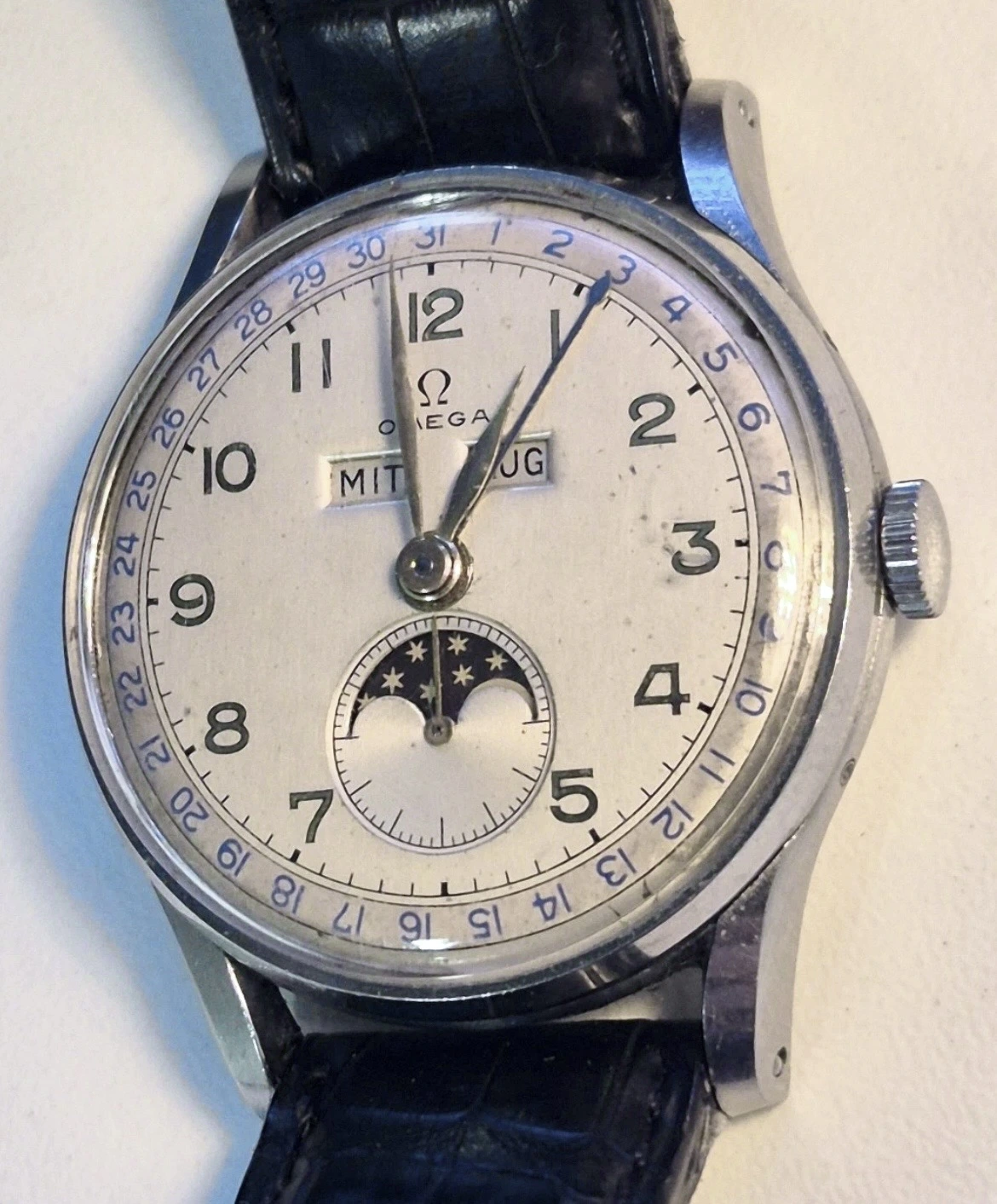

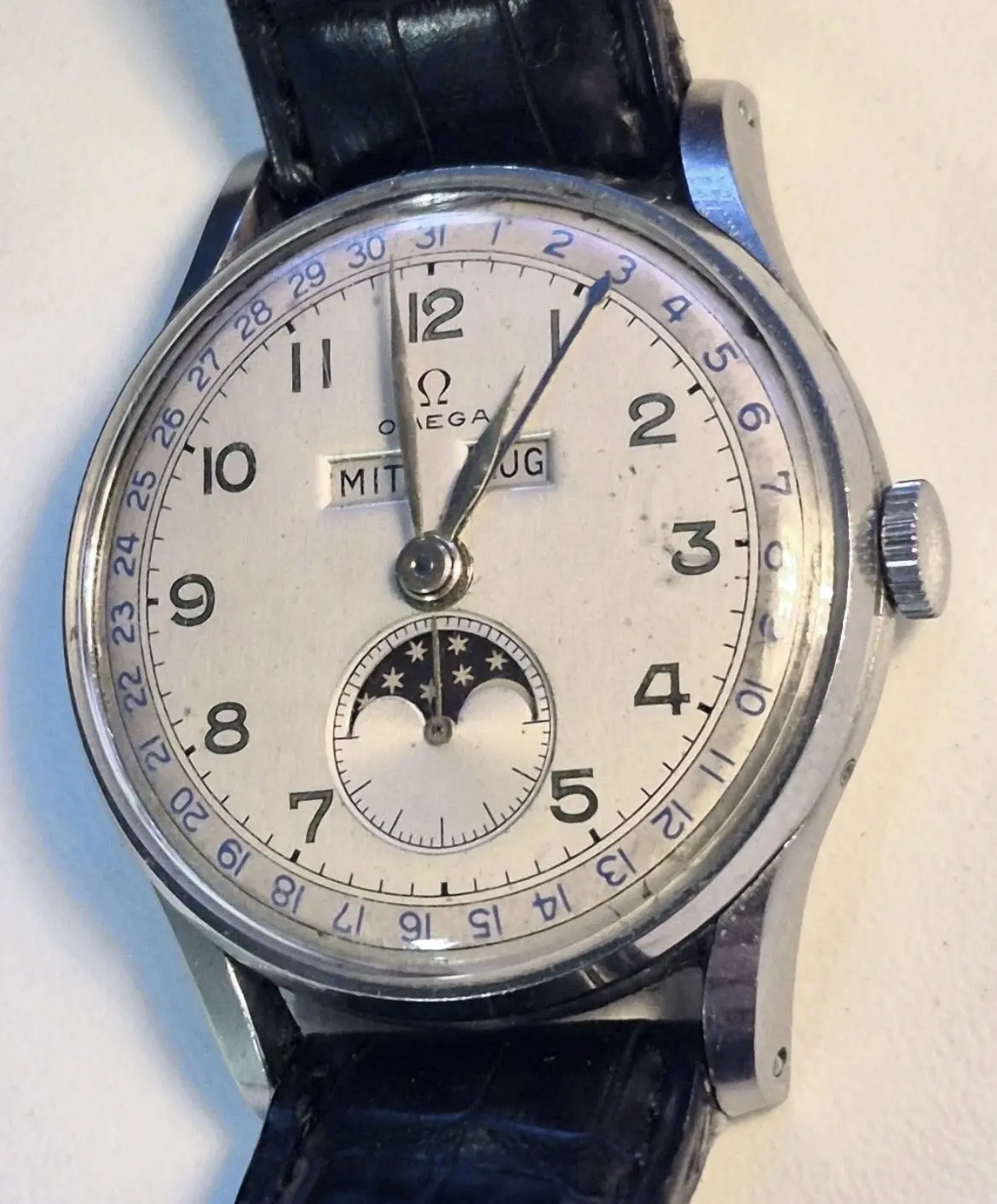

Picture of mine - almost similar layout.

Yeah, I'd generally expect leaf hands on a 2471 with this dial style.
