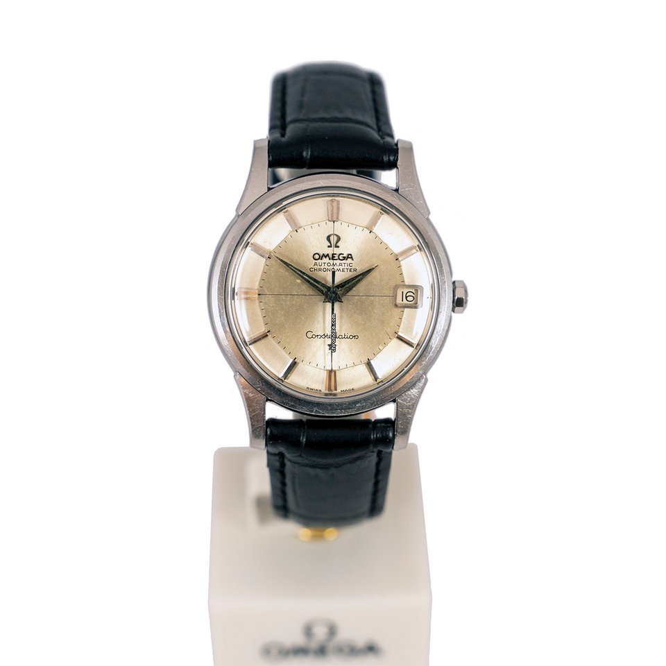

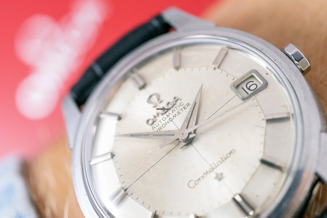

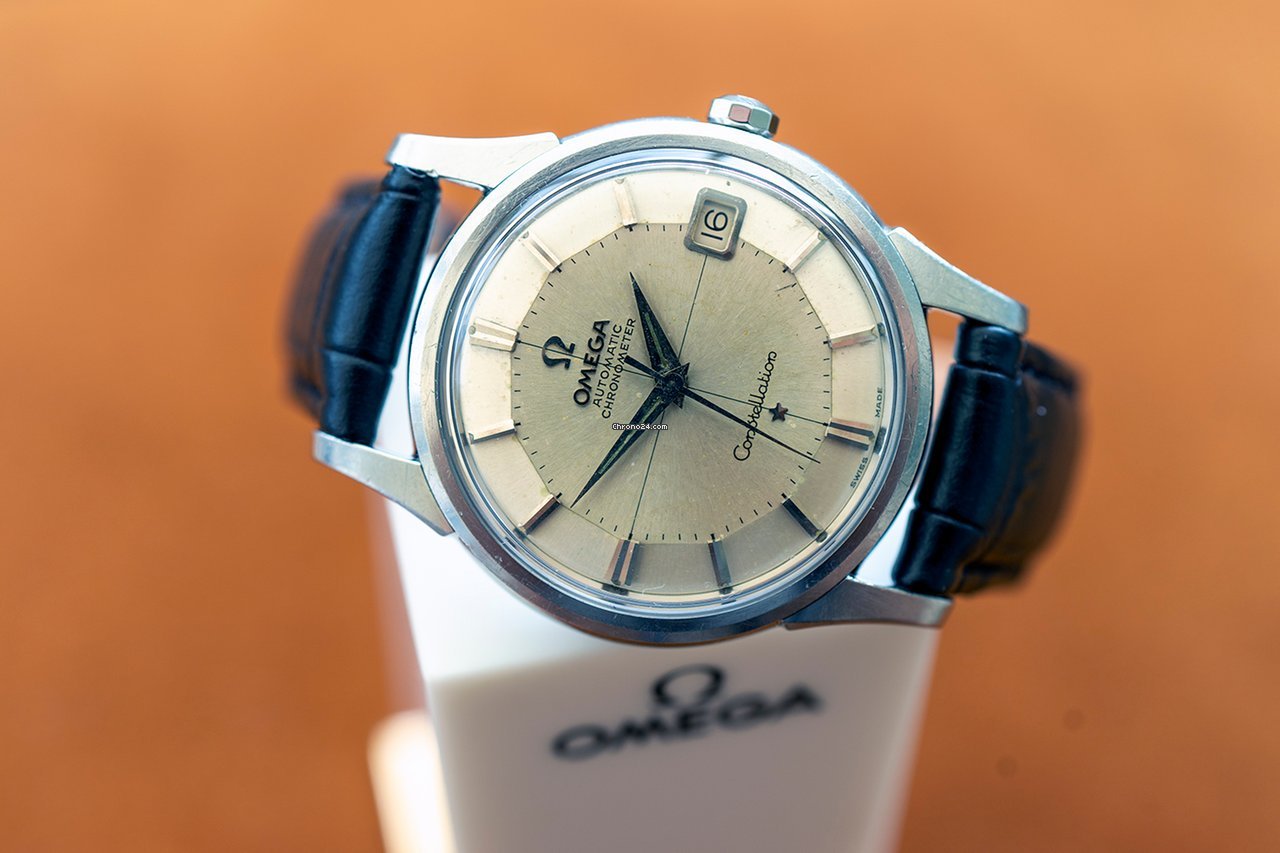

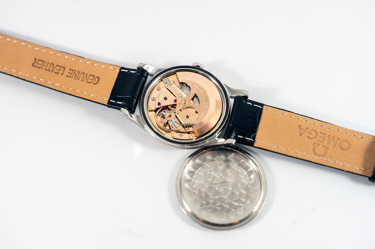

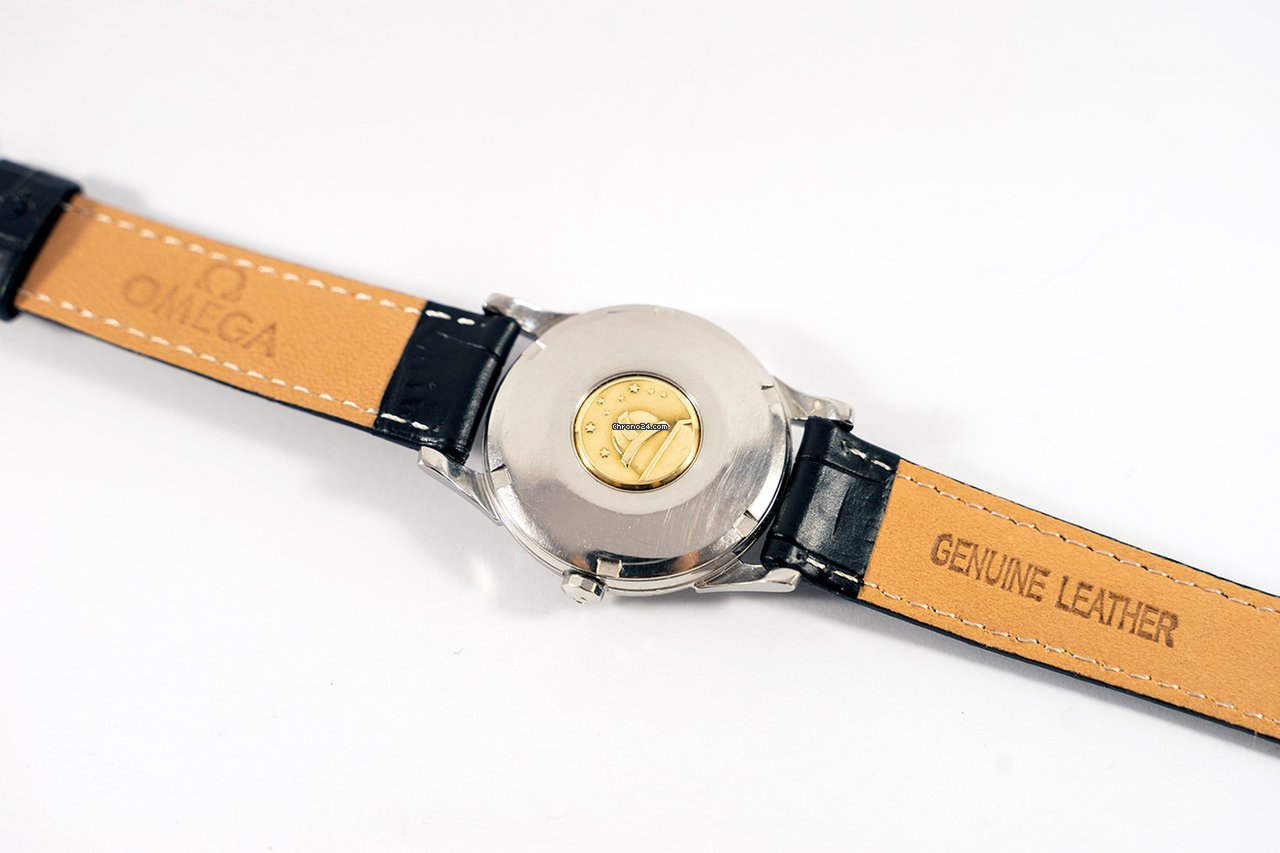

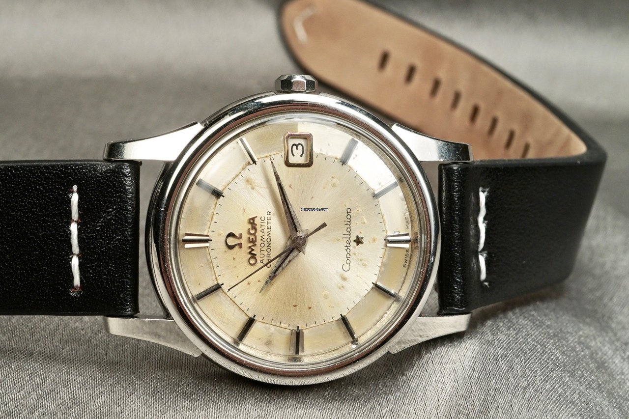

1st one:
Pie pan with cross-hair. All original except for dome (not original) and crown (original). Claimed to be never polished even though the back looks polished imho. Can't say a lot about the clockwork:
Price is quite steep with 2550€.
caliber: 561
accuracy: +5s/Tag
amplitude: 227
frequency: 19800
clockwork number: 19400654
reference: 14393 61 sc
jewels: 24
dome: new perfect condition not original
crown: new crown, omega original
year: ca. 1962
dail: silver with patina
hends: original
case: never polished (supposedly)
service: maintained on 2021-06-30 from professional Omega certified watchmaker

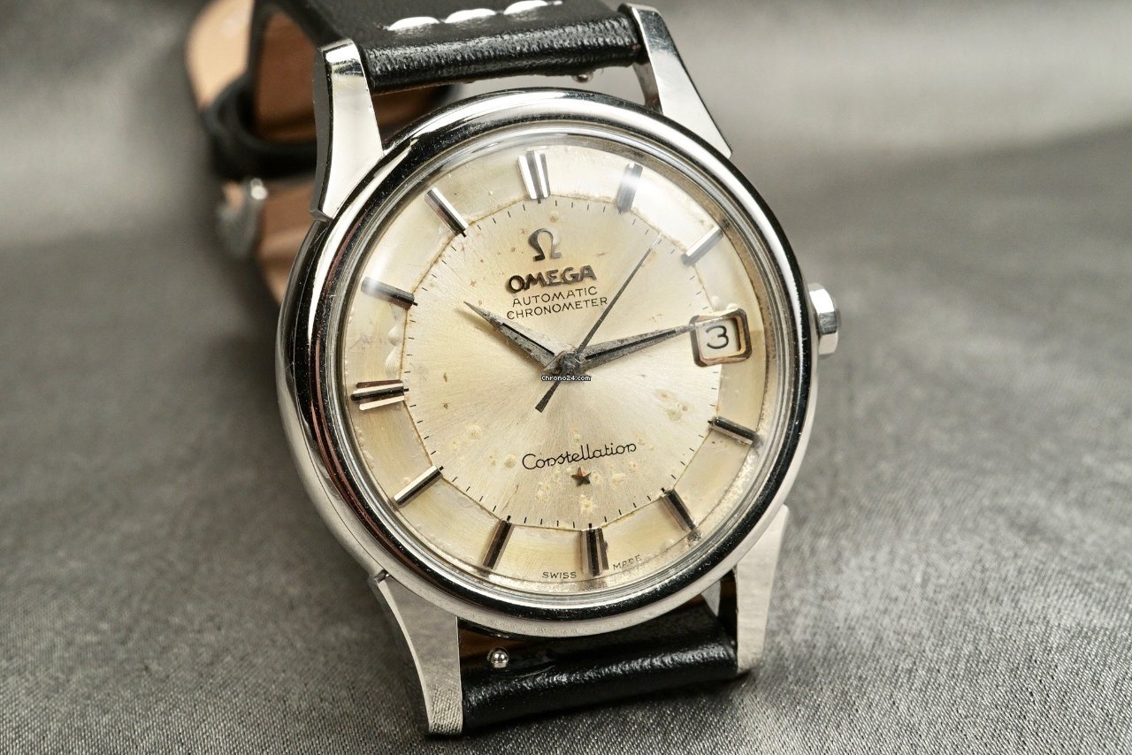

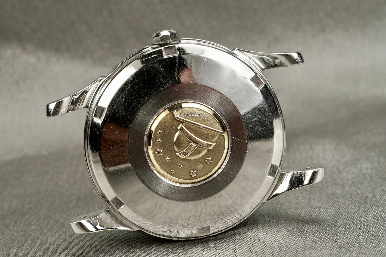

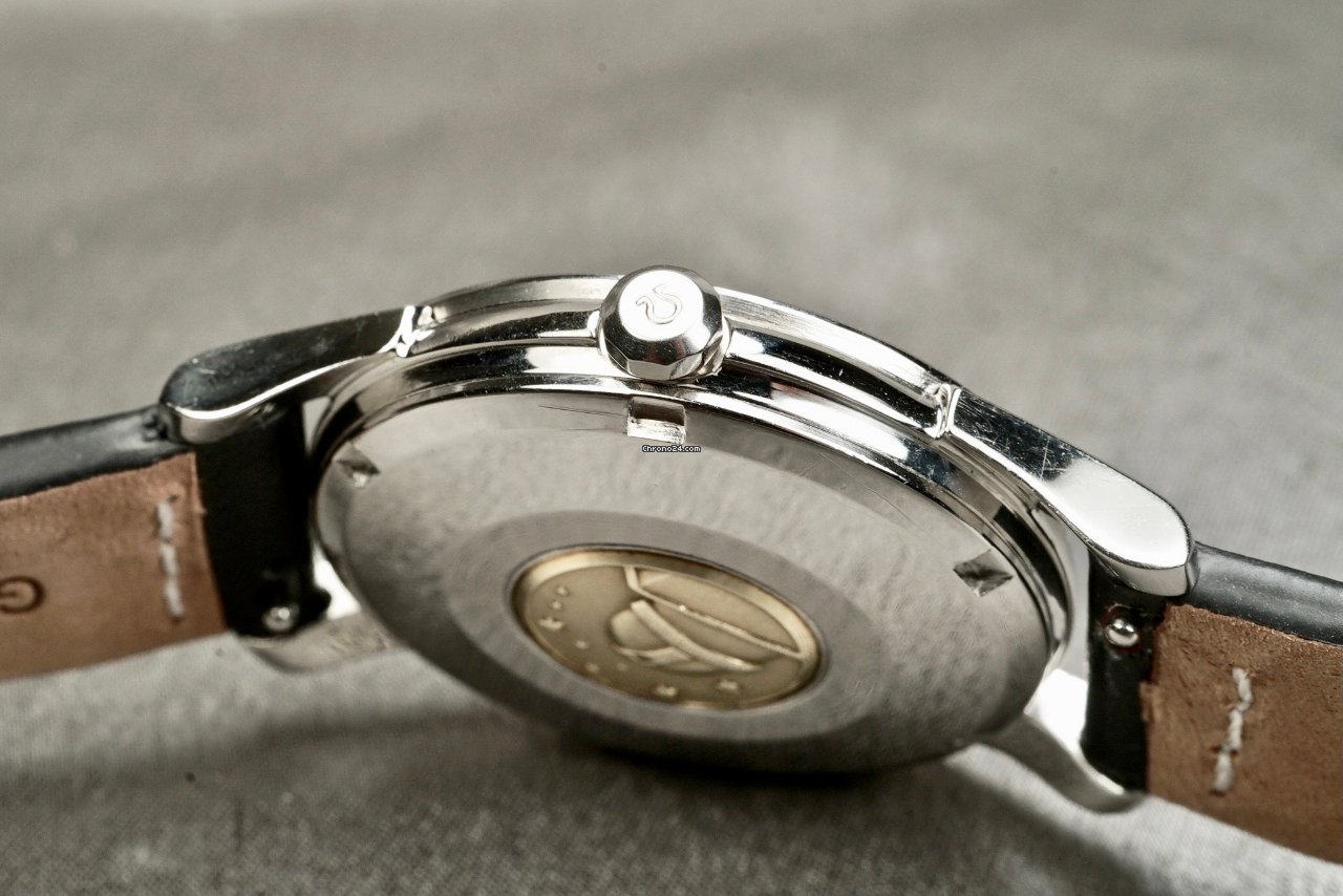

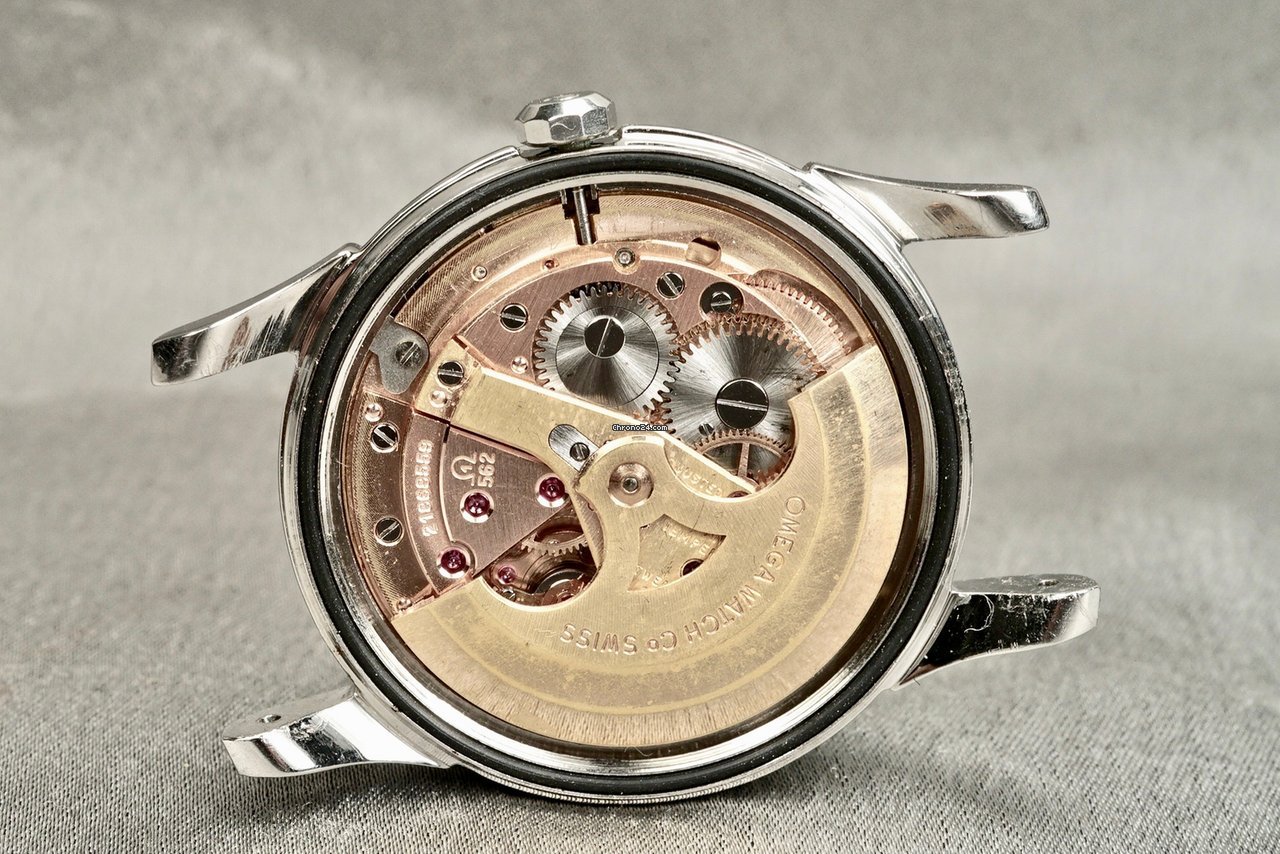

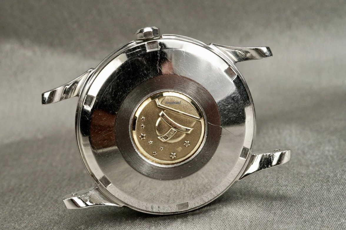

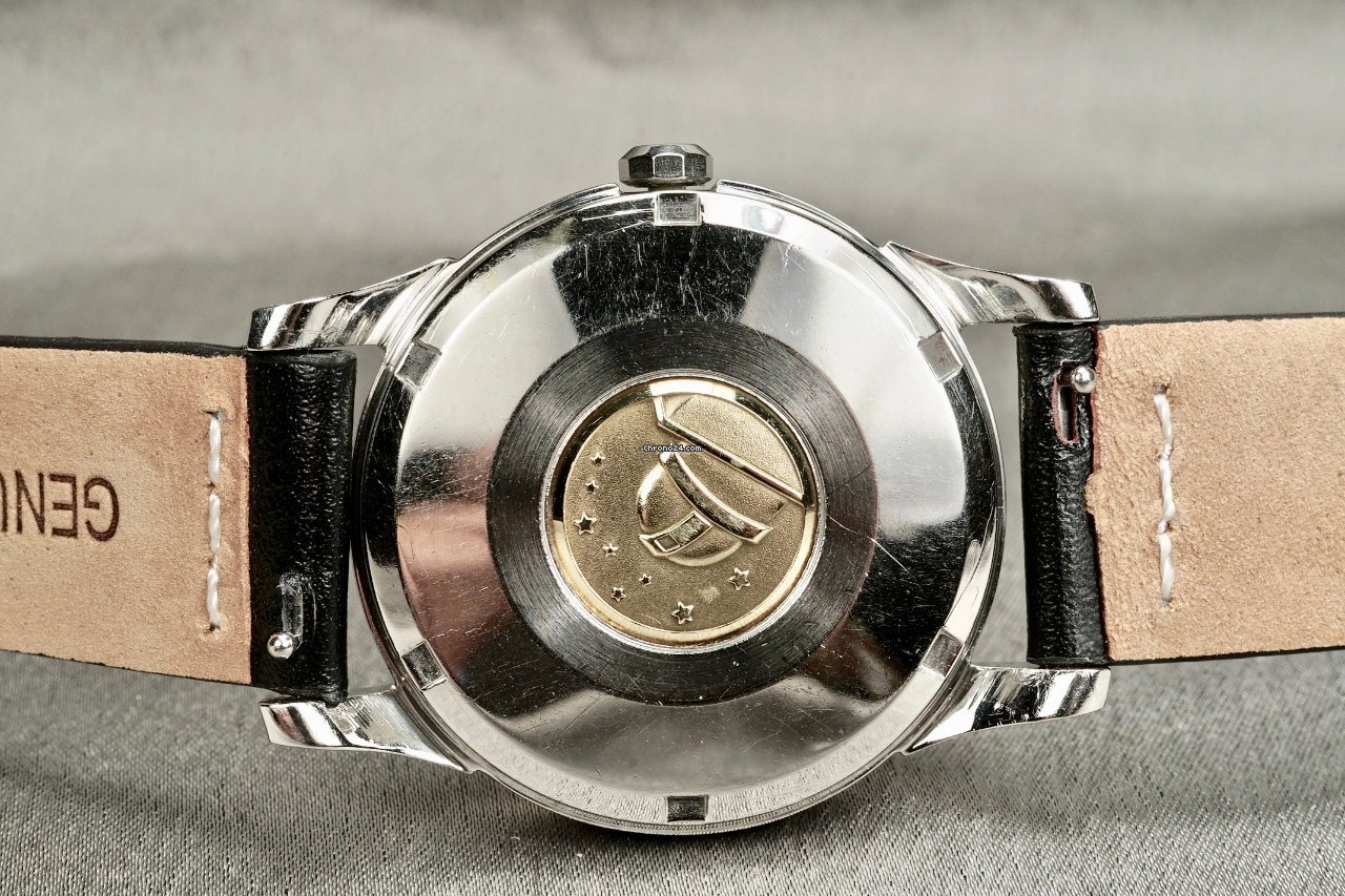

2nd one does not offer too many details but has some serious oxidiations.
Apart from the it looks more crisp imho. Clockwork might have some spare parts which I would be fine with.
Maybe the dial could be replaced for a couple of 100$.
Price 1890€
Ref. 14393
caliber: 562 (1)
3,595
13,551
Both overpriced by 1000€ or so in these conditions…

Yeah I also think they are both overpriced, maybe I could negotiate a bit. I would rather tend to the second one even though the dial is in bad condition and a spare one might not easy to aquire.
6,835
10,503
The second one has the wrong movement in it.
Although there is some evidence that there were some chronometer rated cal 562s, no-one has ever presented one on OF.
And even if the bridge does say ‘adjusted 5 positions’ it has clearly been added to the movt.
edit
And a 21,XX movt is too late for a 14393
