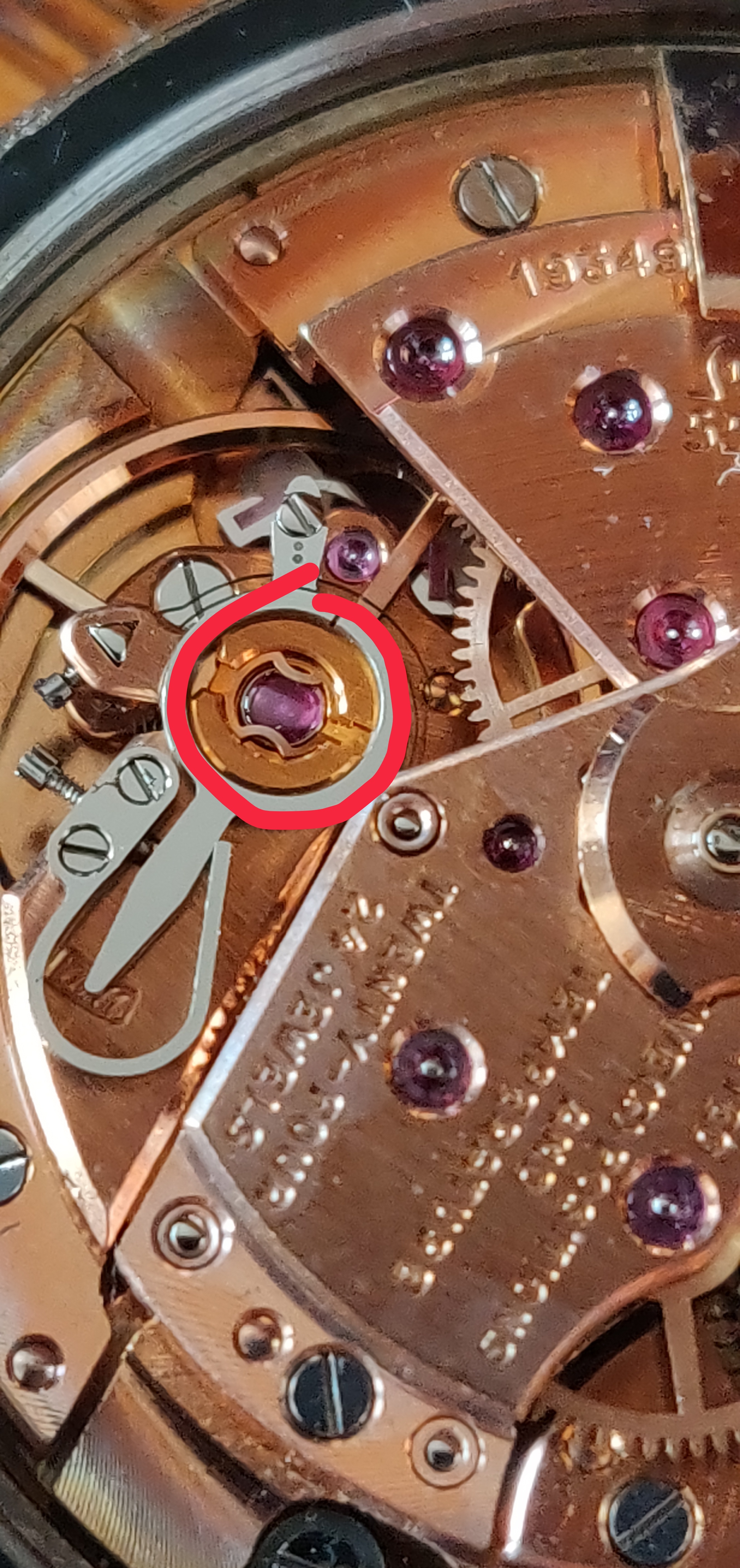

So I have an early 70s Omega Constellation that when I wear, I find it behind in time as it stops working. However, if I'm not wearing it, it keeps perfect time.
More observation revealed that when I'm working on my desk and the head (12 o'clock) is facing down but as soon as I tilt it to face up, it works. I tried doing it gently as to not have movement trigger it and as soon as I begin tilting it, it works.
So basically flat on a desk or facing upwards won't get it to stop. But when the head faces downwards, after a couple minutes it stops.
I took it in for service not so long ago, but that didn't seem to resolve it. Any clue why that might be happening?

Long time ago, one of my watch had same problem, I cleaned the top jewel solved it.

A watch repair guy of any merit should not require you to tell him what to look for. Could be a loose screw or a broken (or worn) balance staff. The quicker you get it back to who ever it is you refer to, the better. Or better yet, find somebody else!

I vote balance staff. I had a trench watch I bought that kept perfect time when you layed it flat, and would stop when you picked it up and rotated it- diagnosis was balance staff.

He didn't charge for the issue. But he did work on it quite a bit. I'll look into the balance. Basically yeah, just happens when the head is facing down. In less than a minute it will stop unless it's rotated or lightly shaken.

I had the same issue on a Vacheron, it was due to the balance staff. Ask him to check that especially the jewel.

Sounds like you have a few watches @phil.kz so, if you wear in rotation is this watch stopped when you pick it up to wear? If so, are you winding it or just relying on the auto to charge the mainspring?
It does sound like the amplitude is low and when you put it in any vertical position (not dial up or down), the amplitude drops further (which is normal) and the watch stops.
