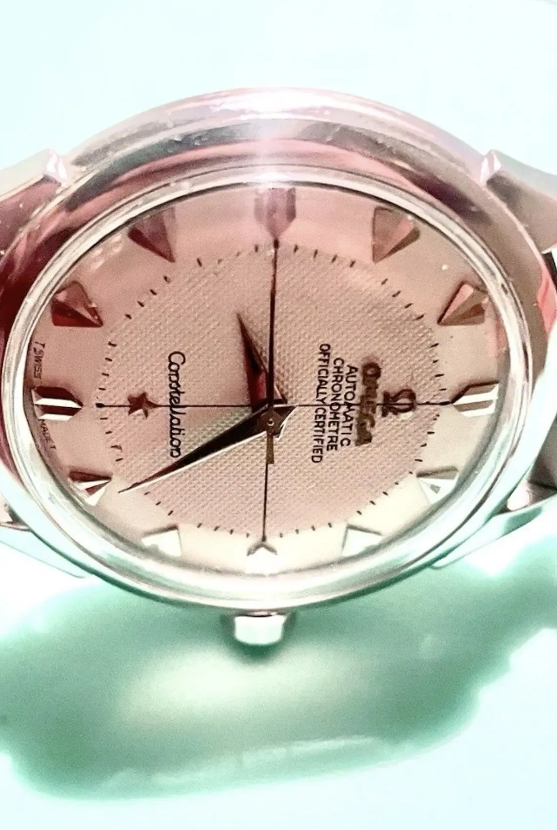

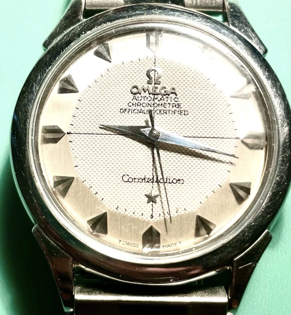

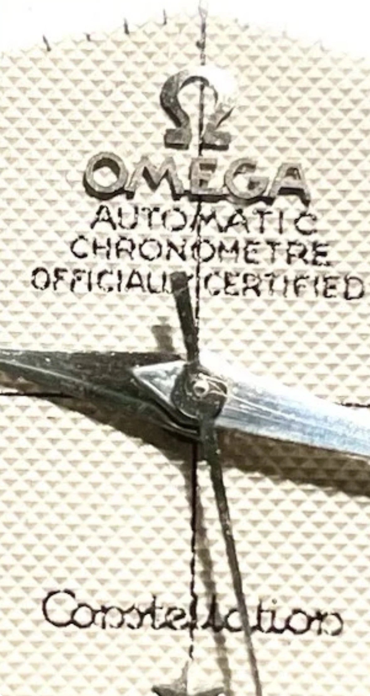

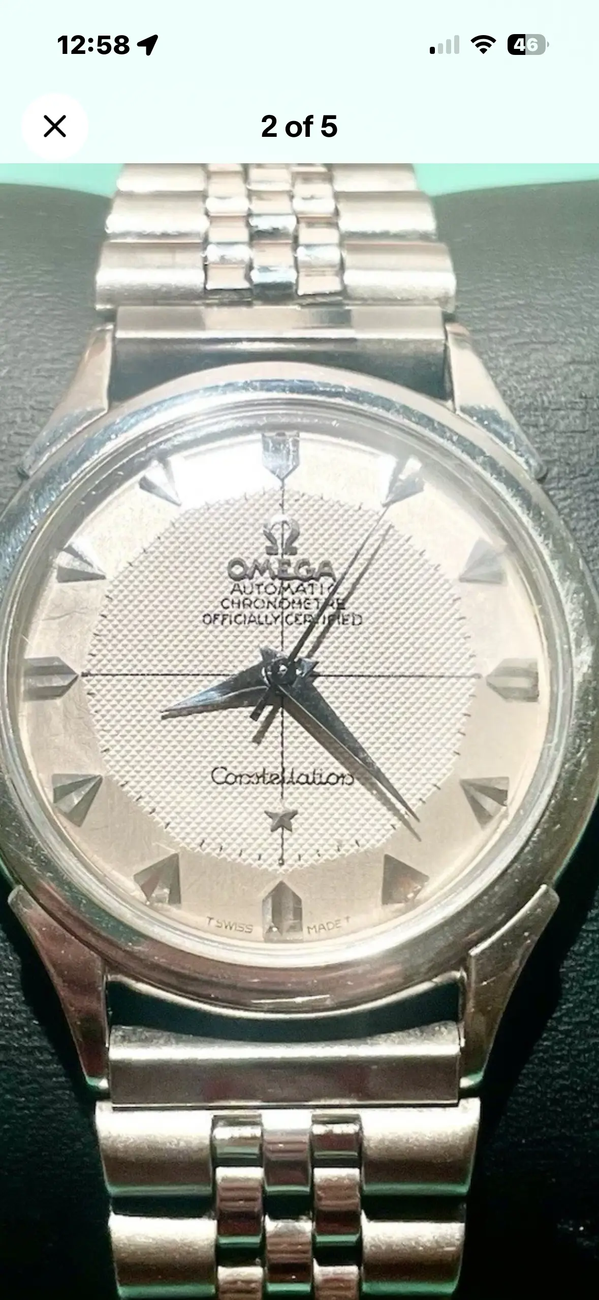

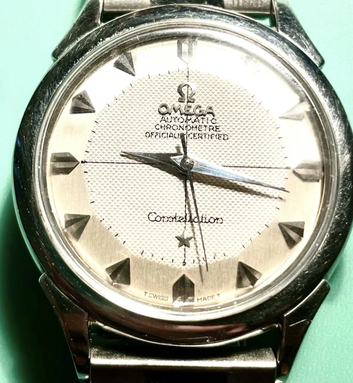

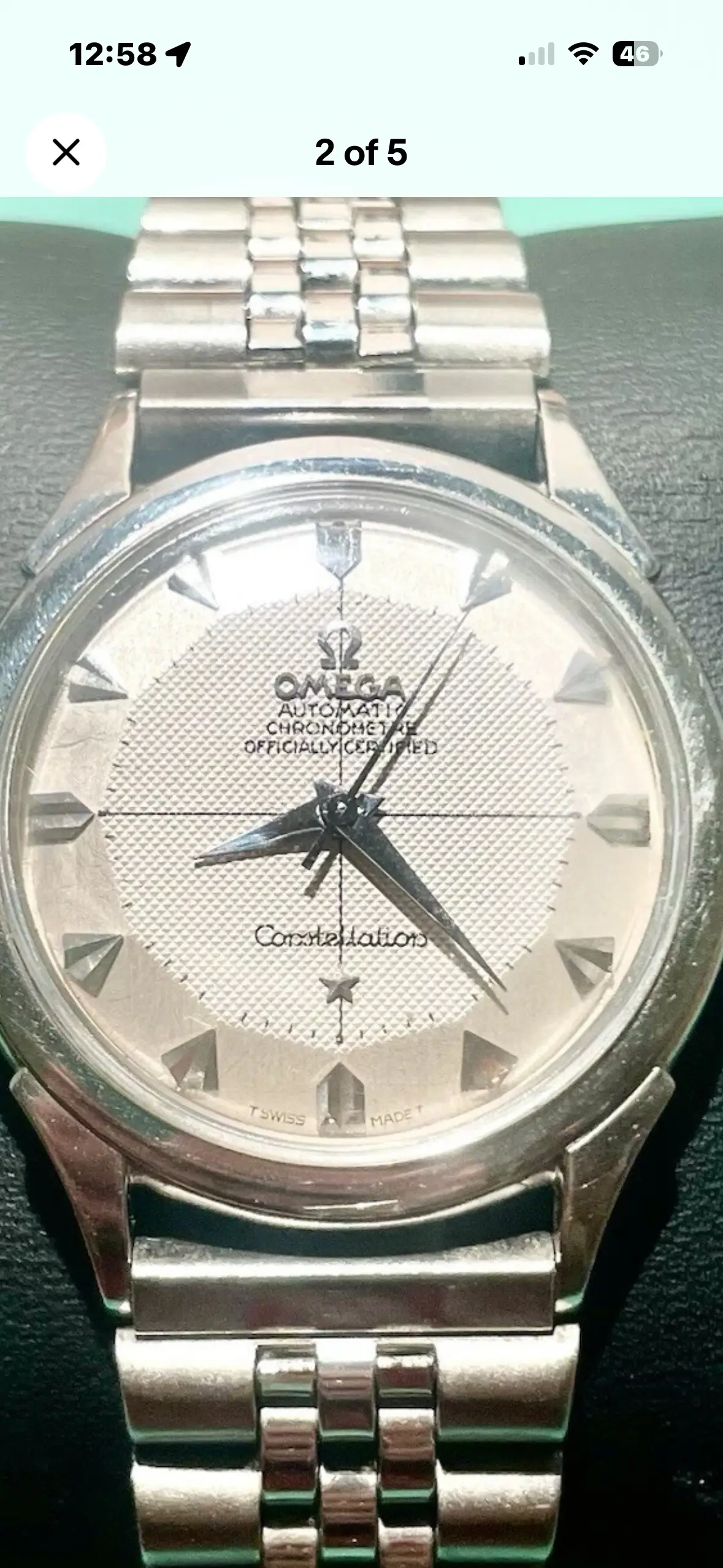

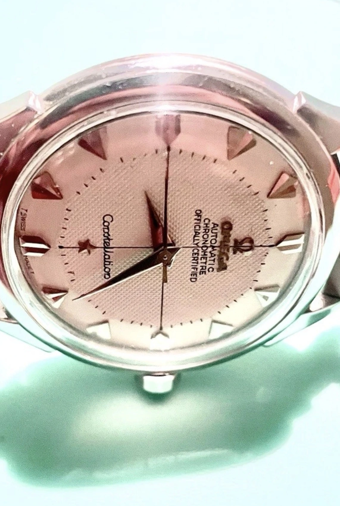

Can you help me with the following Constellation?
1- Are the serifs incorrect? I understand it’s sometimes harder to decipher on a hobnail dial.
2- T-Swiss-T leads me to believe this watch should have had Tritium on the dial and on the hands.
3- I assume the hands are replacement an so it the minute hand.
Thank you for your help and knowledge.
18,837
39,175
It’s a redial indeed, pretty bad one. Many things wrong - and also look at the minute marks which bare all over the place.
I agree, a pretty bad redial.

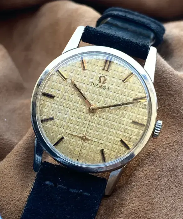

The textured part is waffle (not hobnail).
I disagree, the dial is hobnail texture or "Clous de Paris".

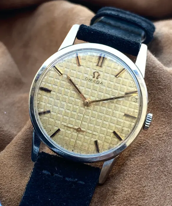

This is a waffle dial:
910
1,253
I don’t know if there is any official naming, so I personally consider this:
Hobnail / clous de paris
Waffle / honeycomb

There are a couple of easy tells for this watch @1972Steve.
Yes, the letters are the wrong shape but that could be the textured dial.
However, the ‘re’ spelling of chronometer which was phased out in the late 50s plus the T SWISS T which didn’t arrive on Constellations until around 1963 is the big giveaway.
