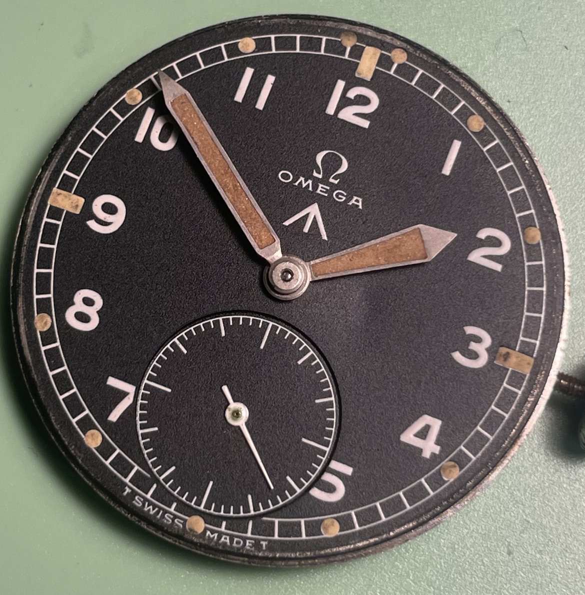

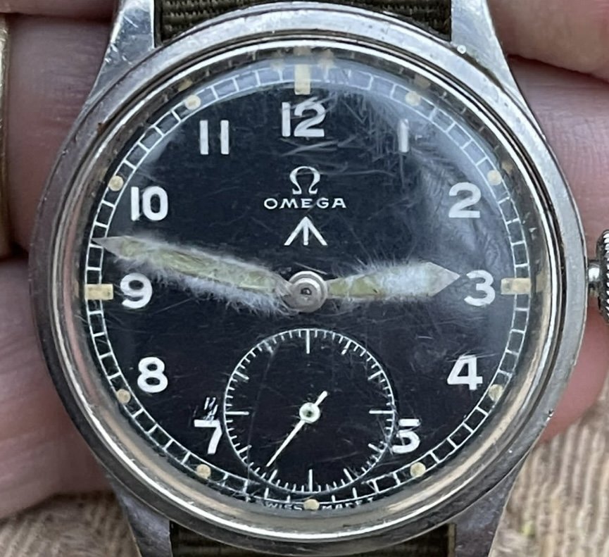

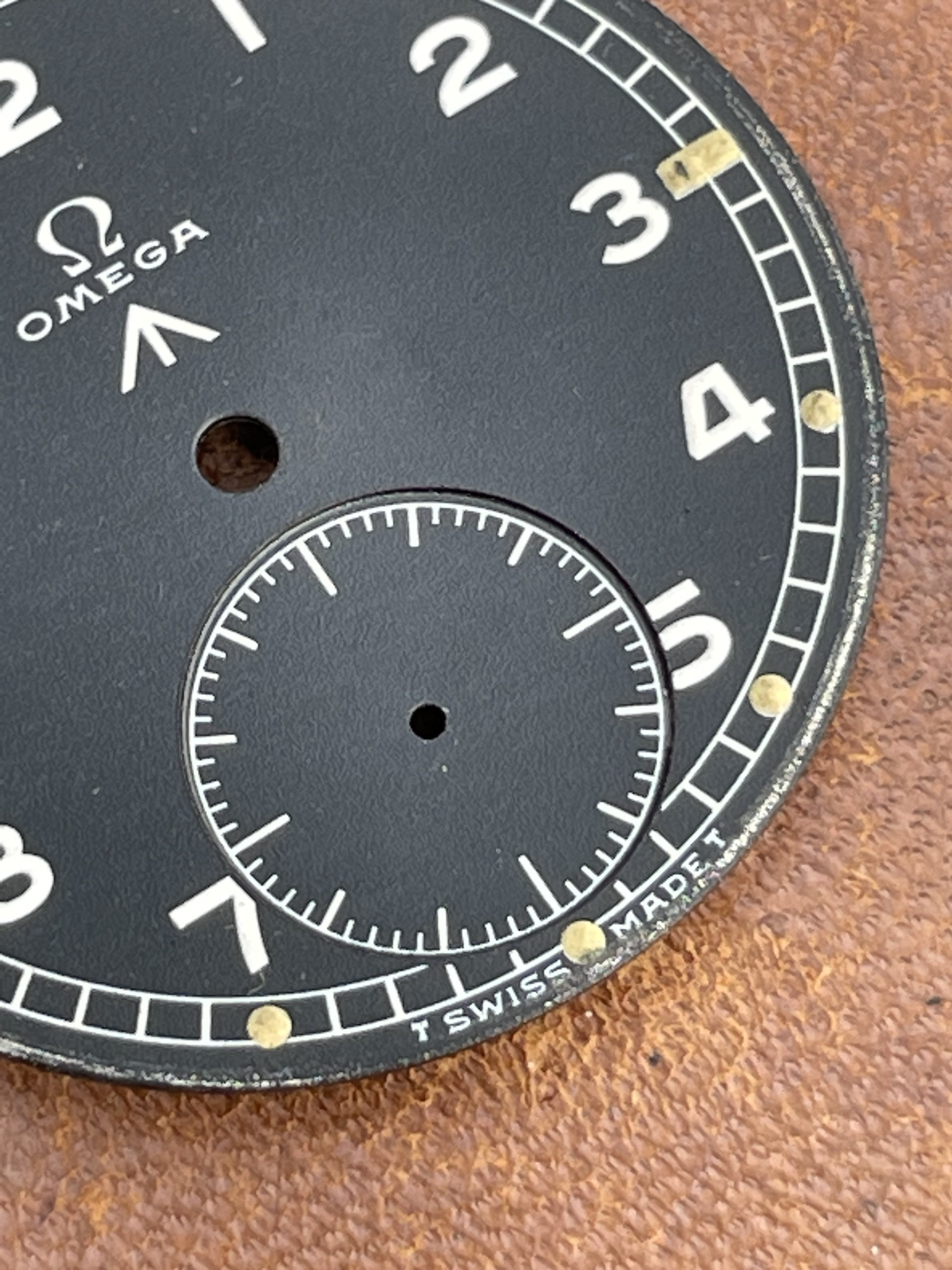

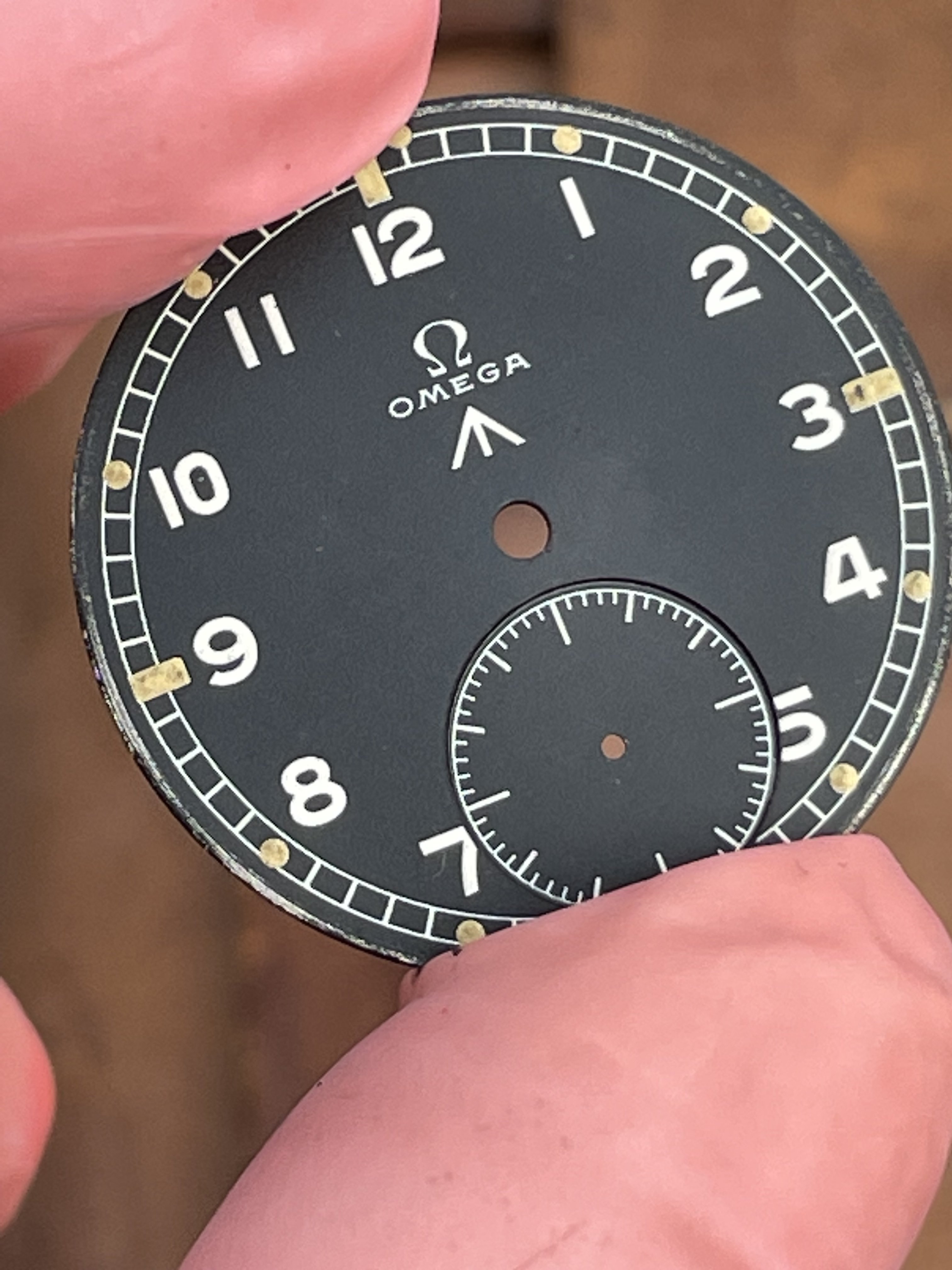

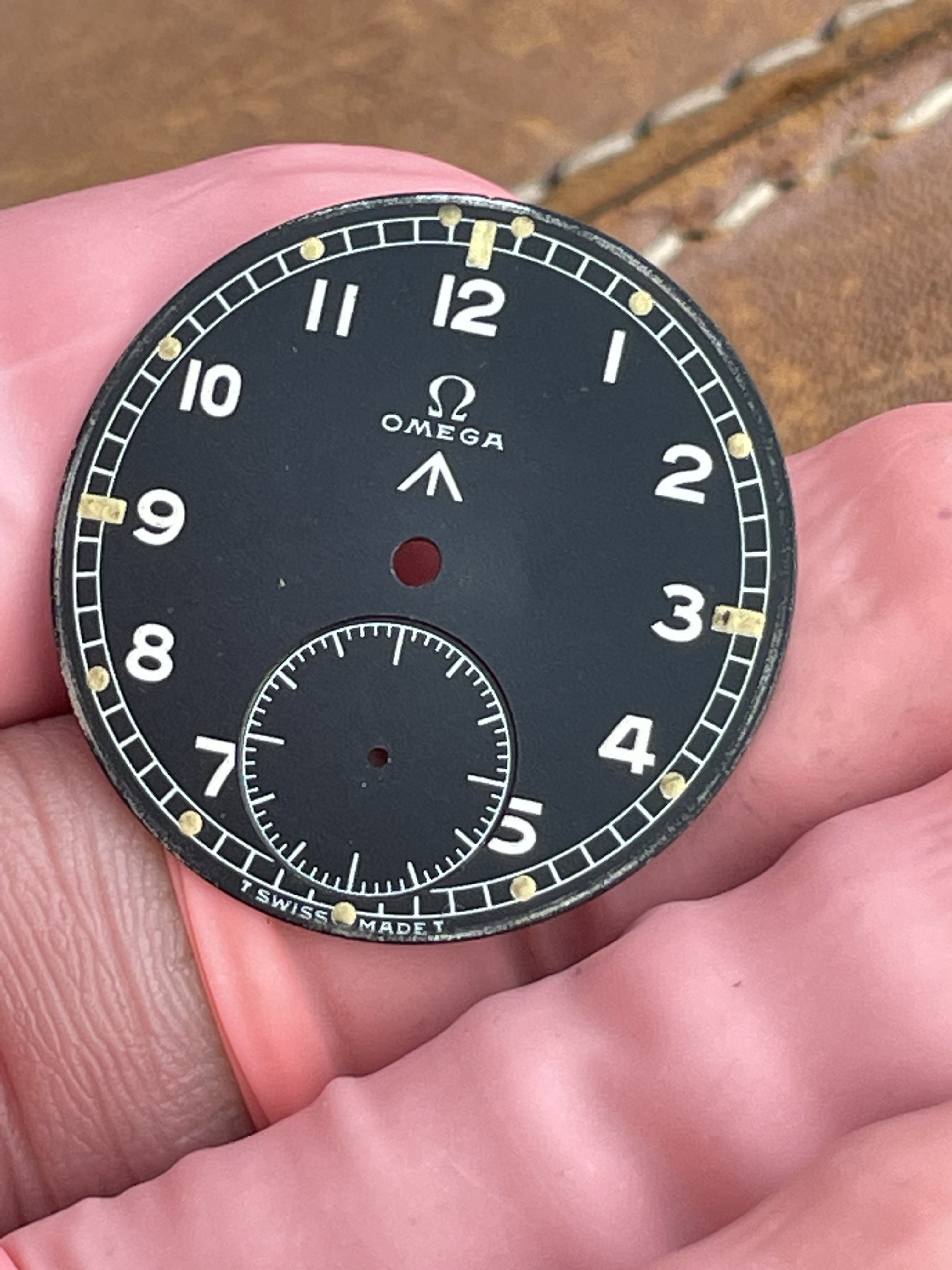

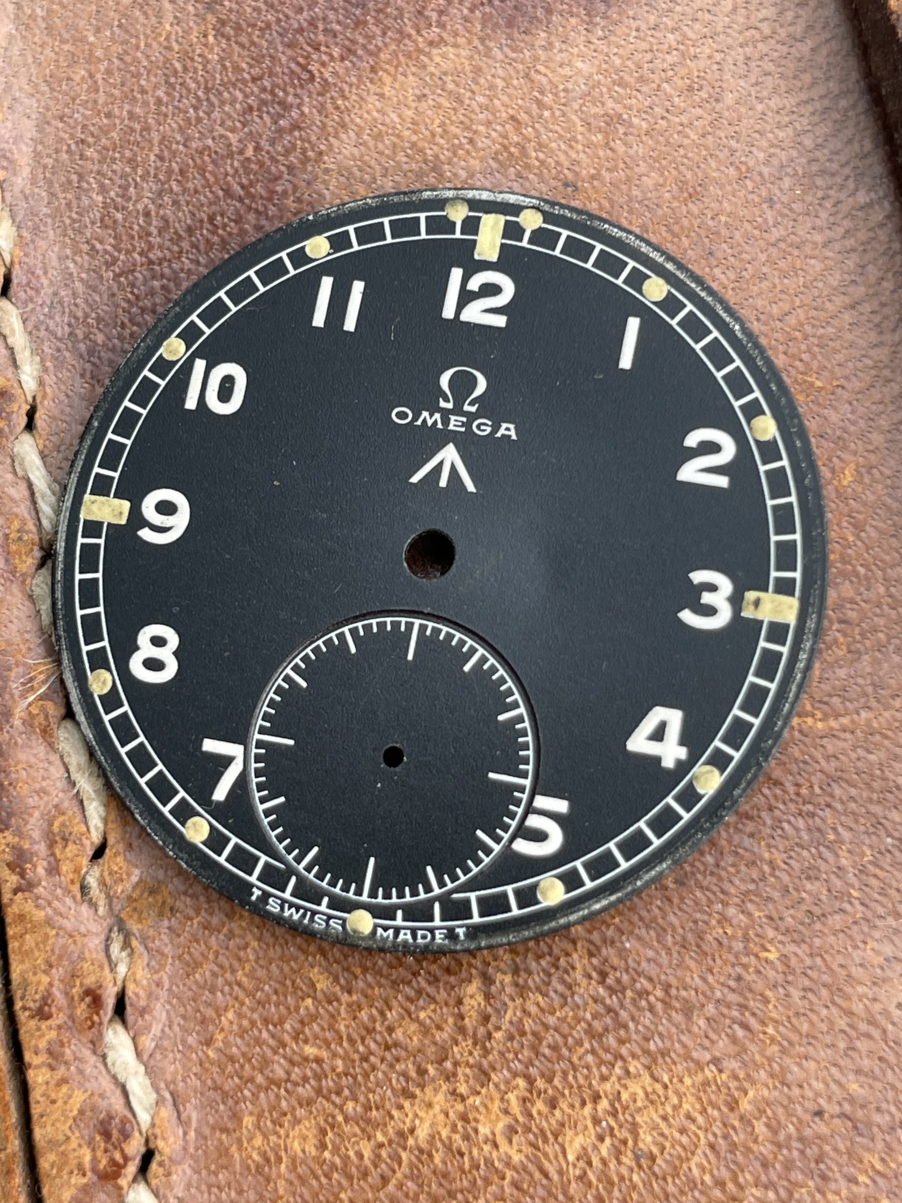

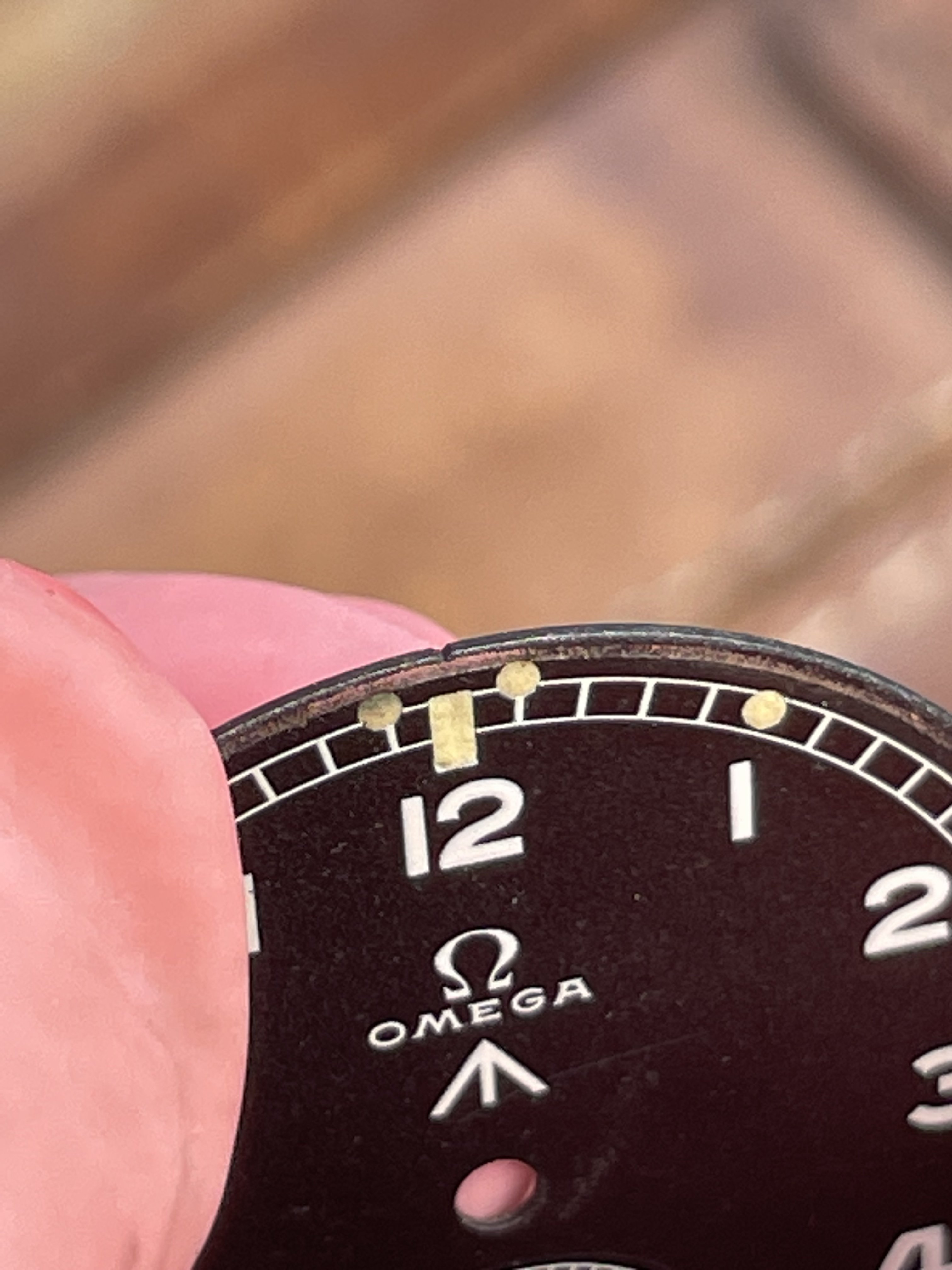

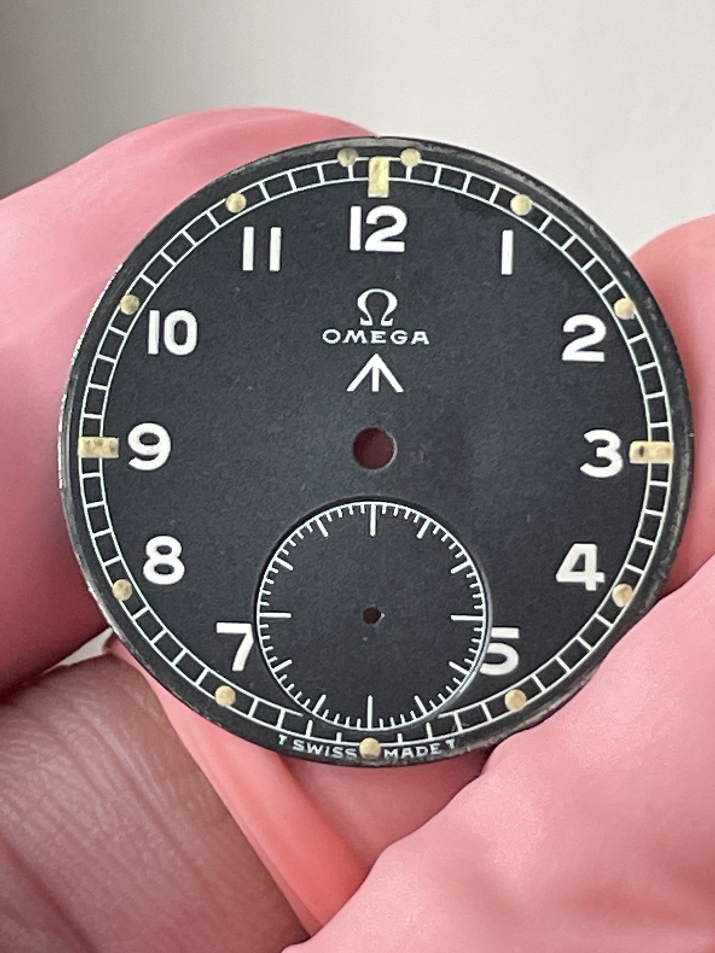

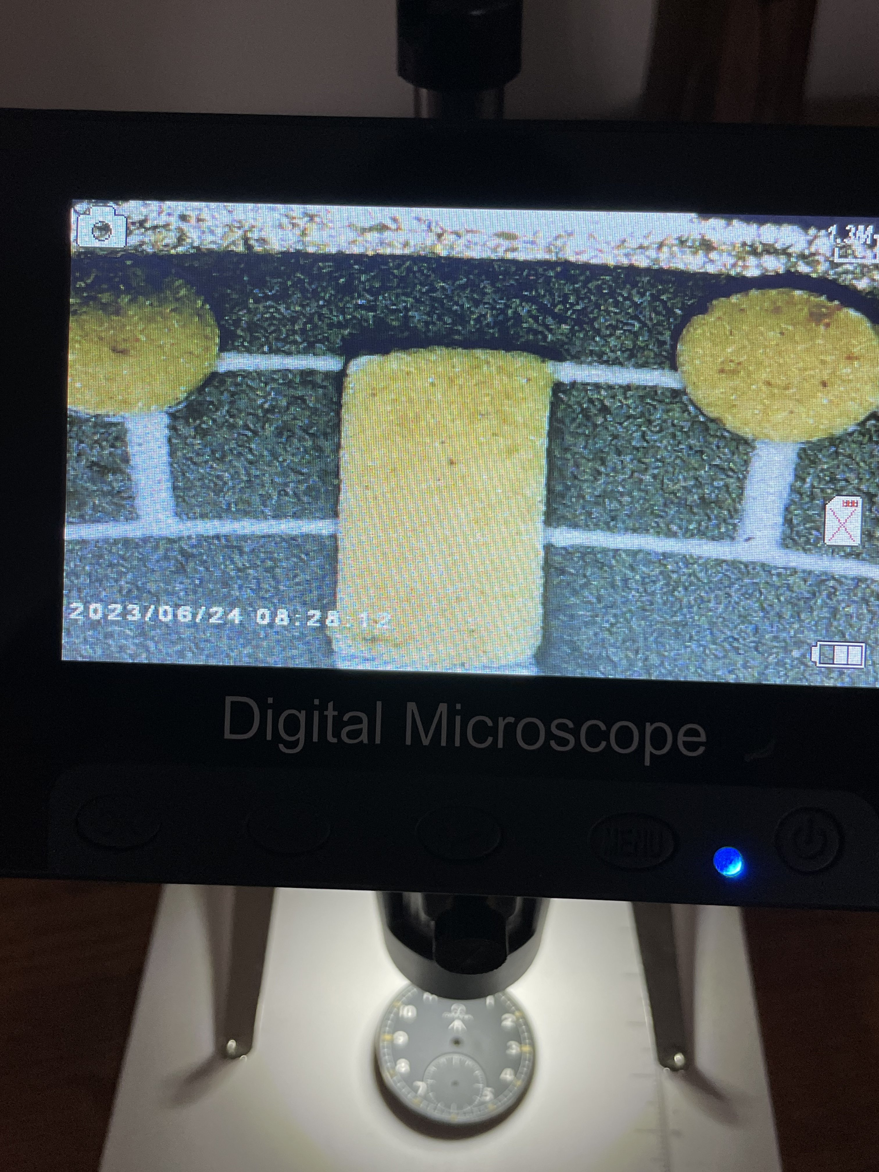

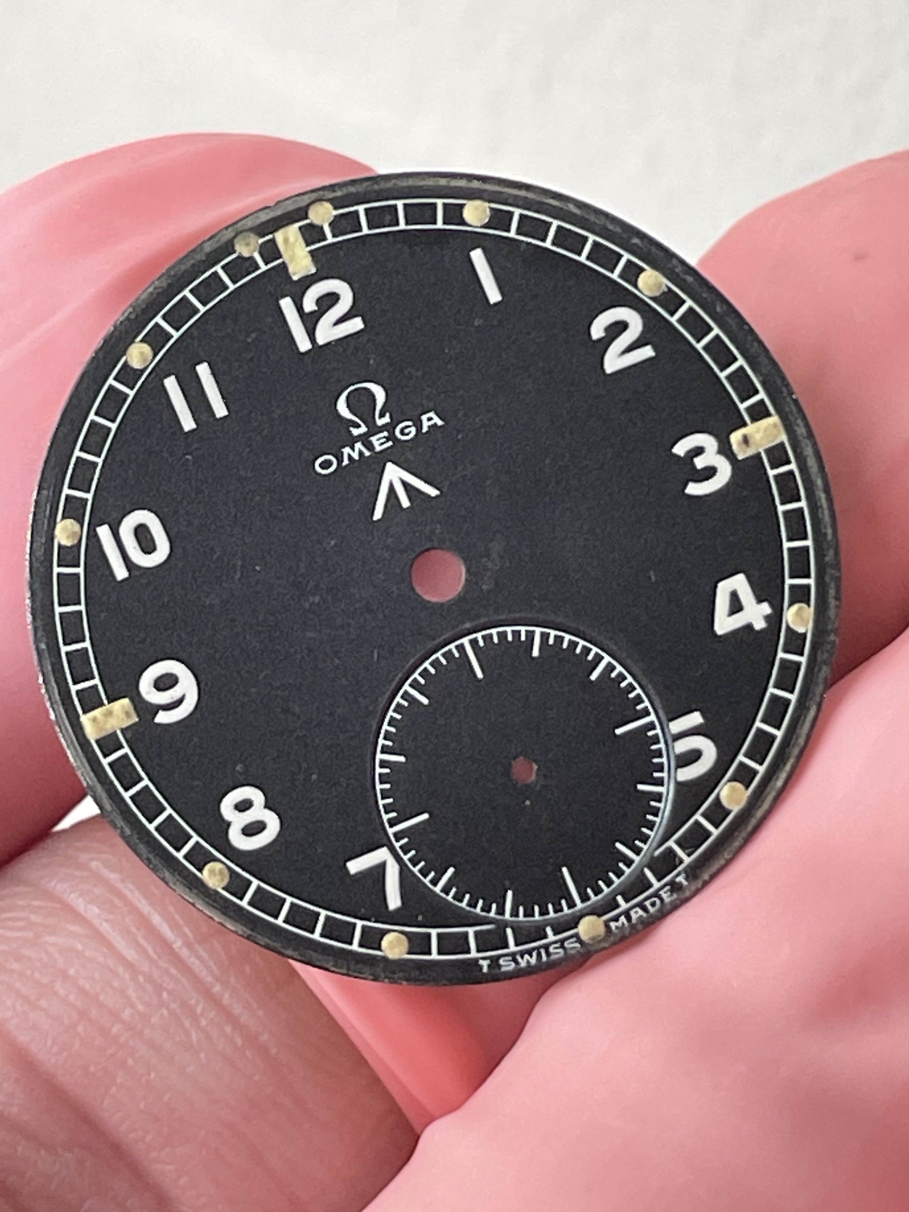

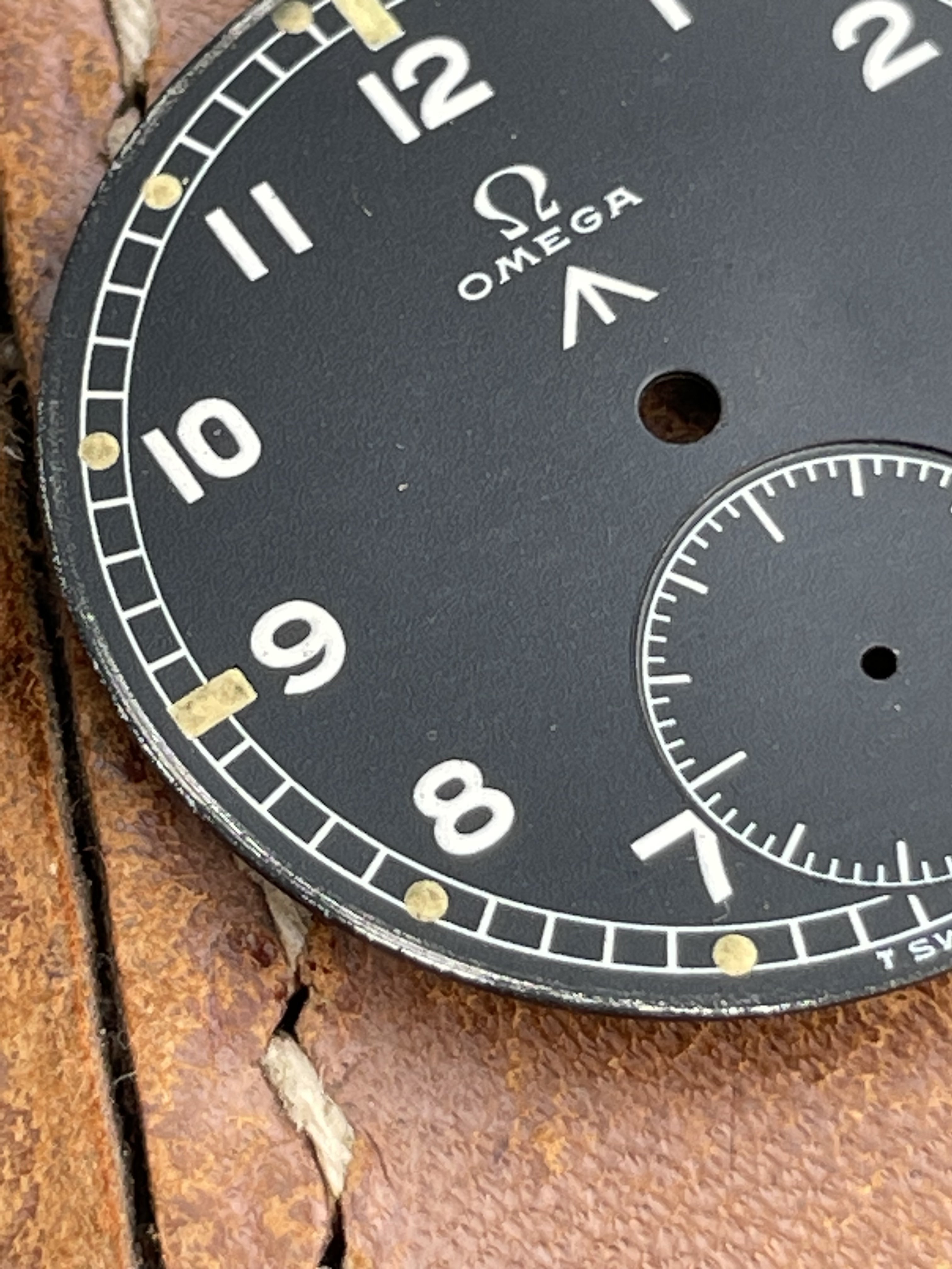

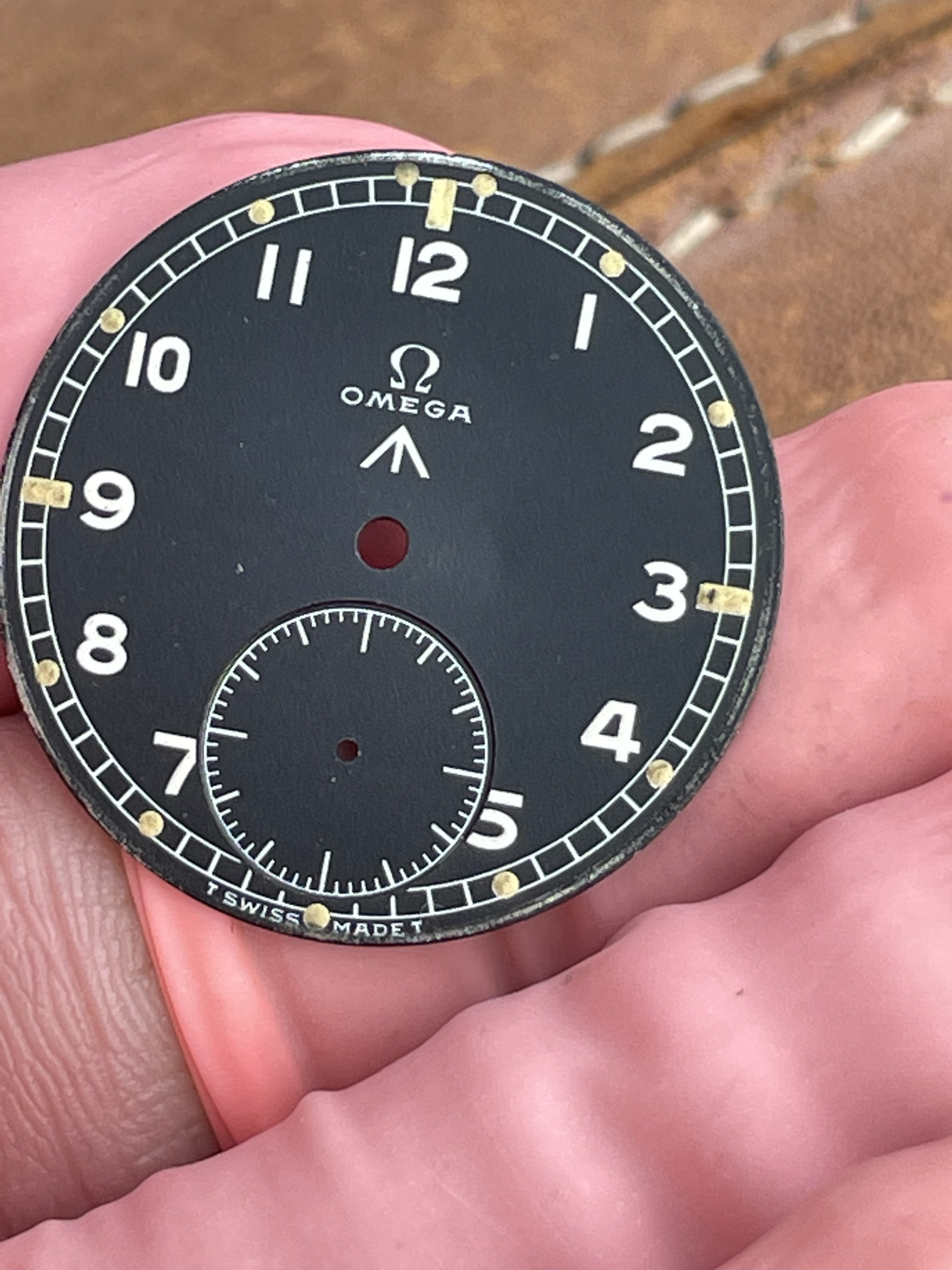

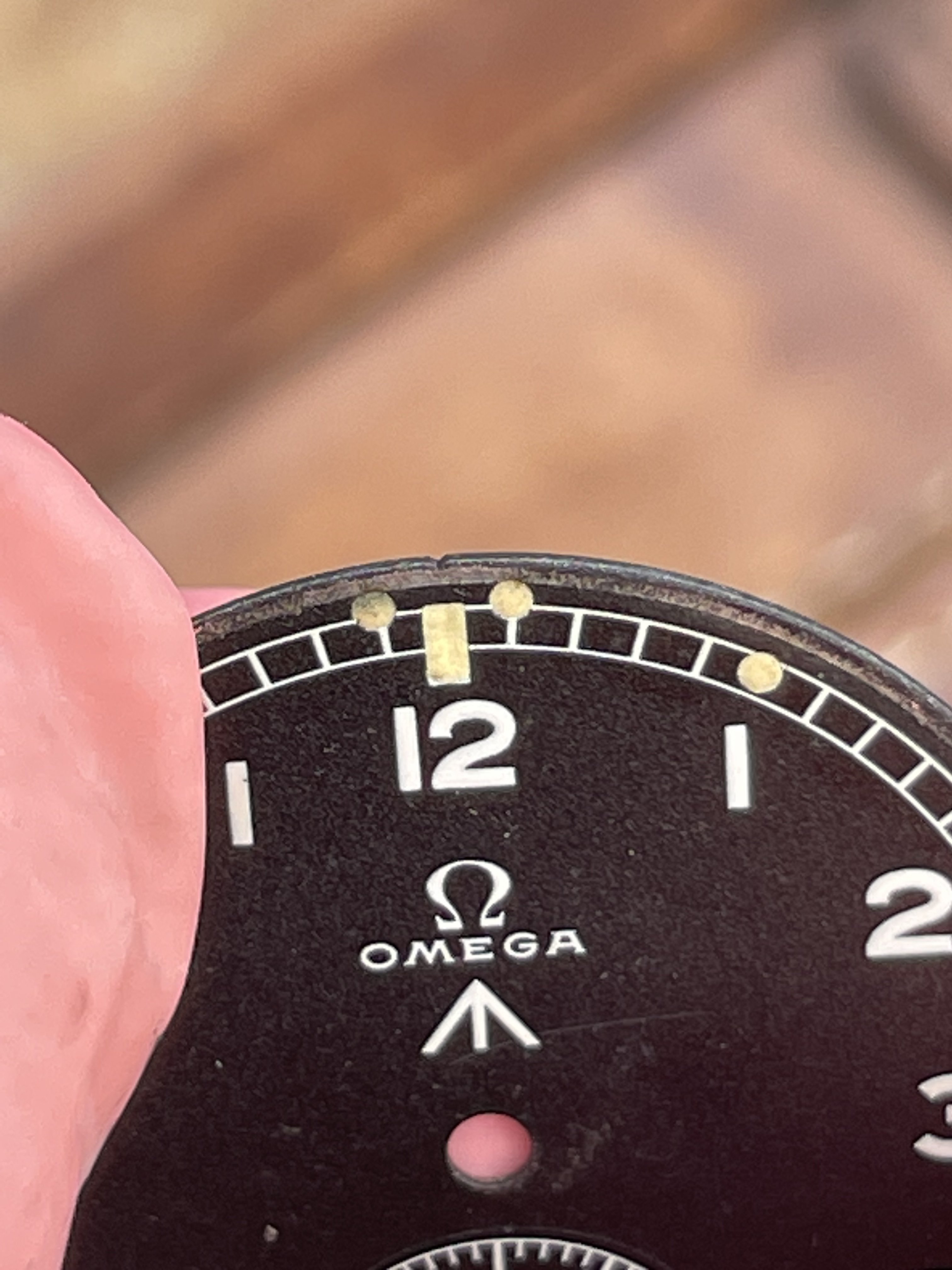

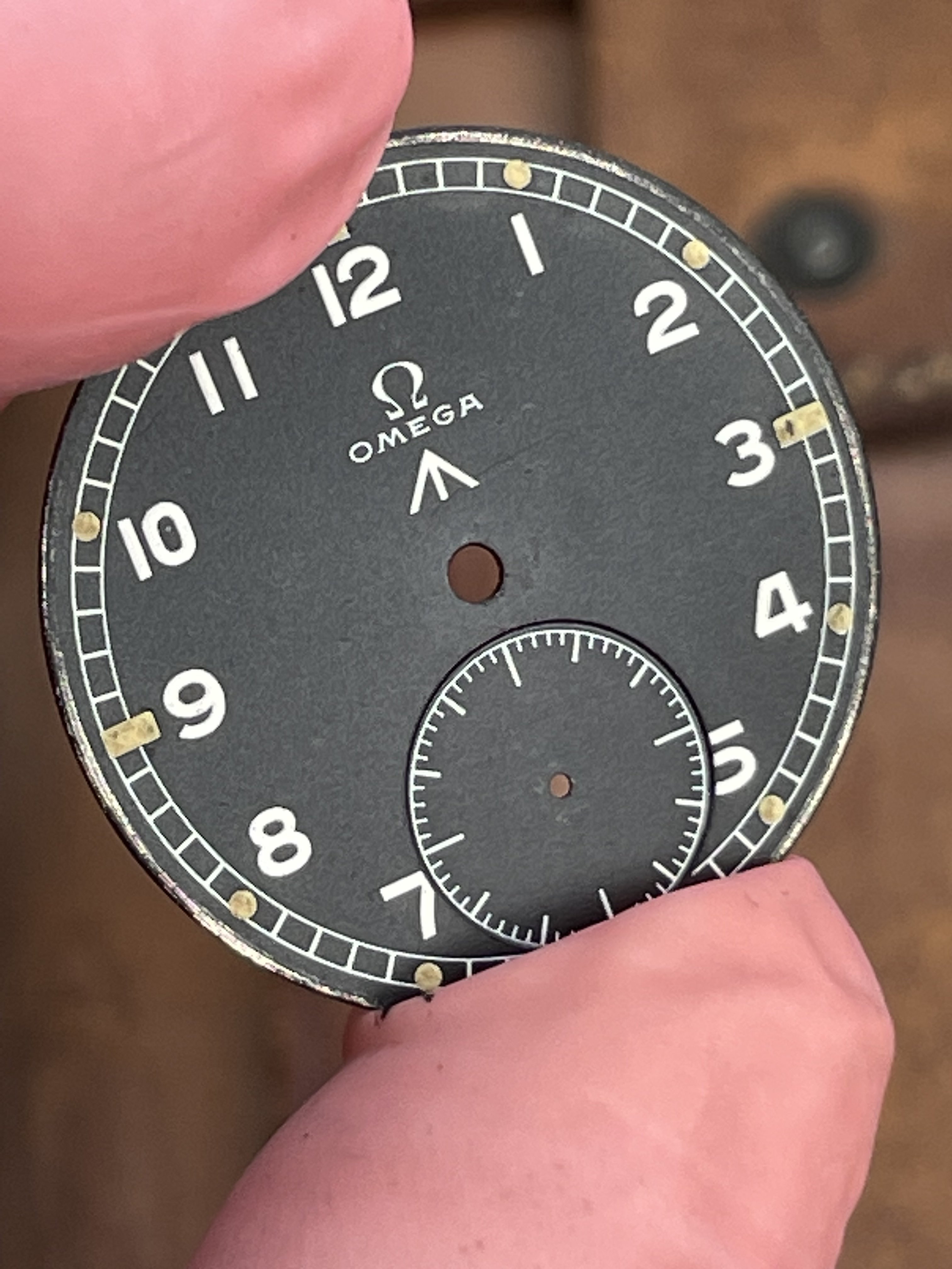

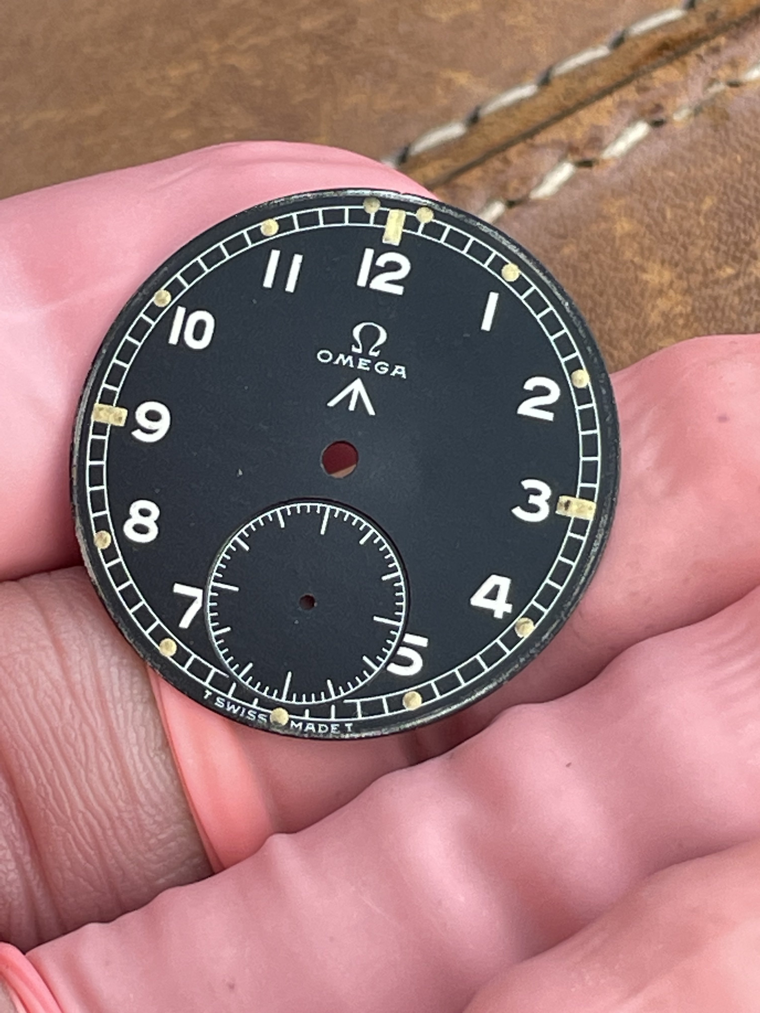

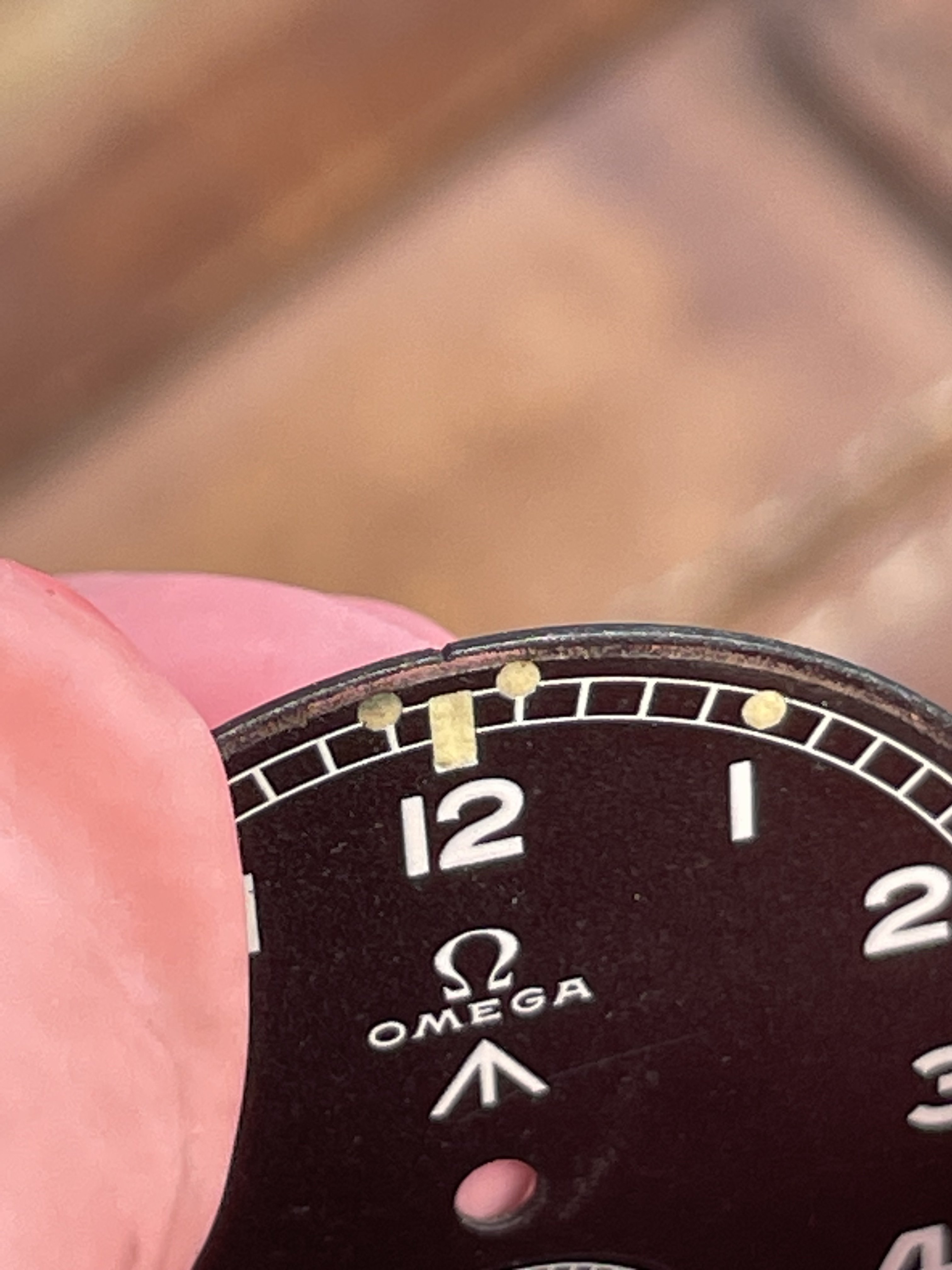

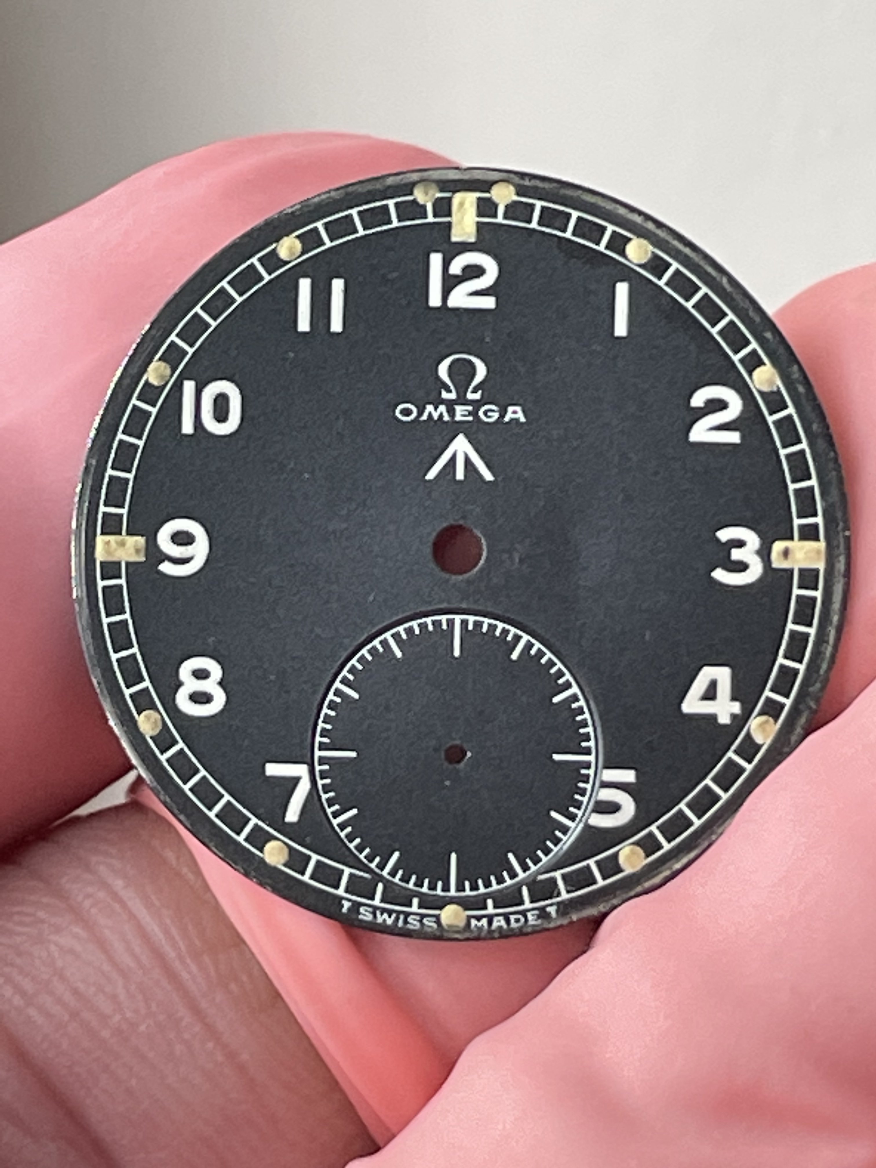

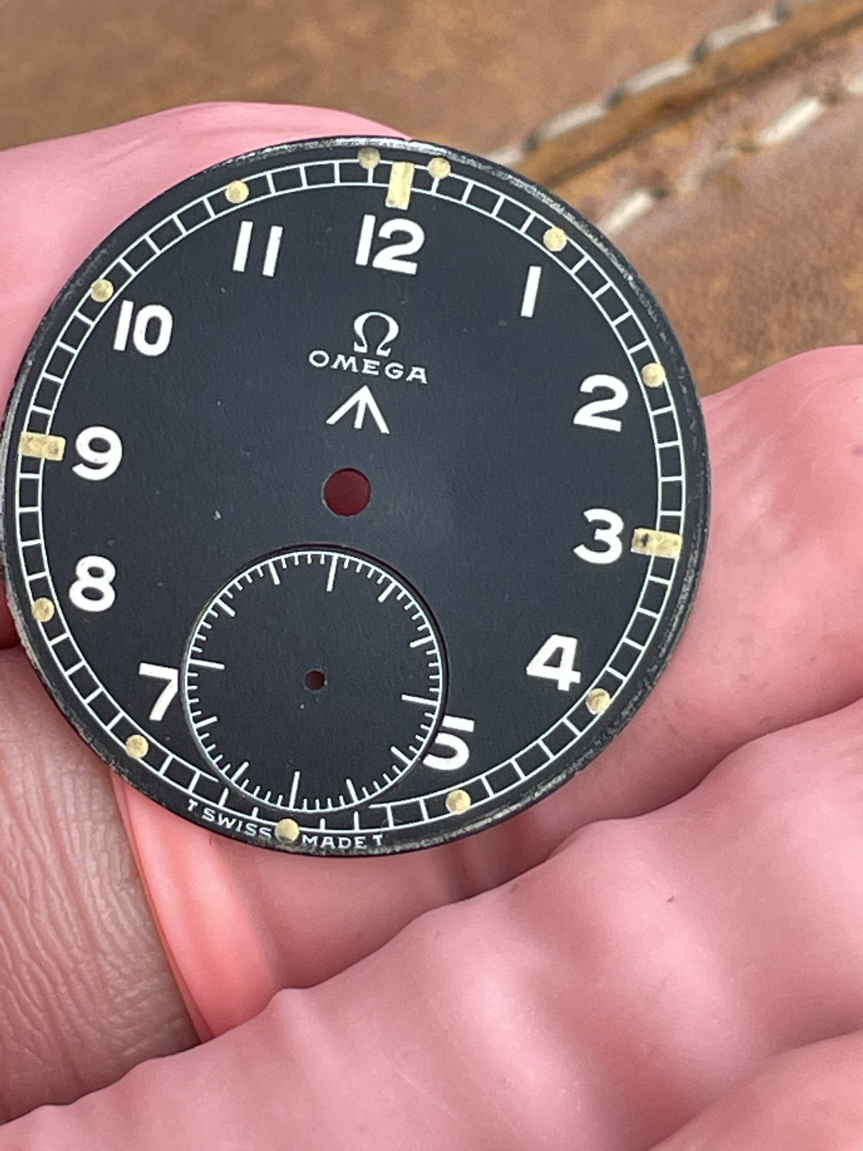

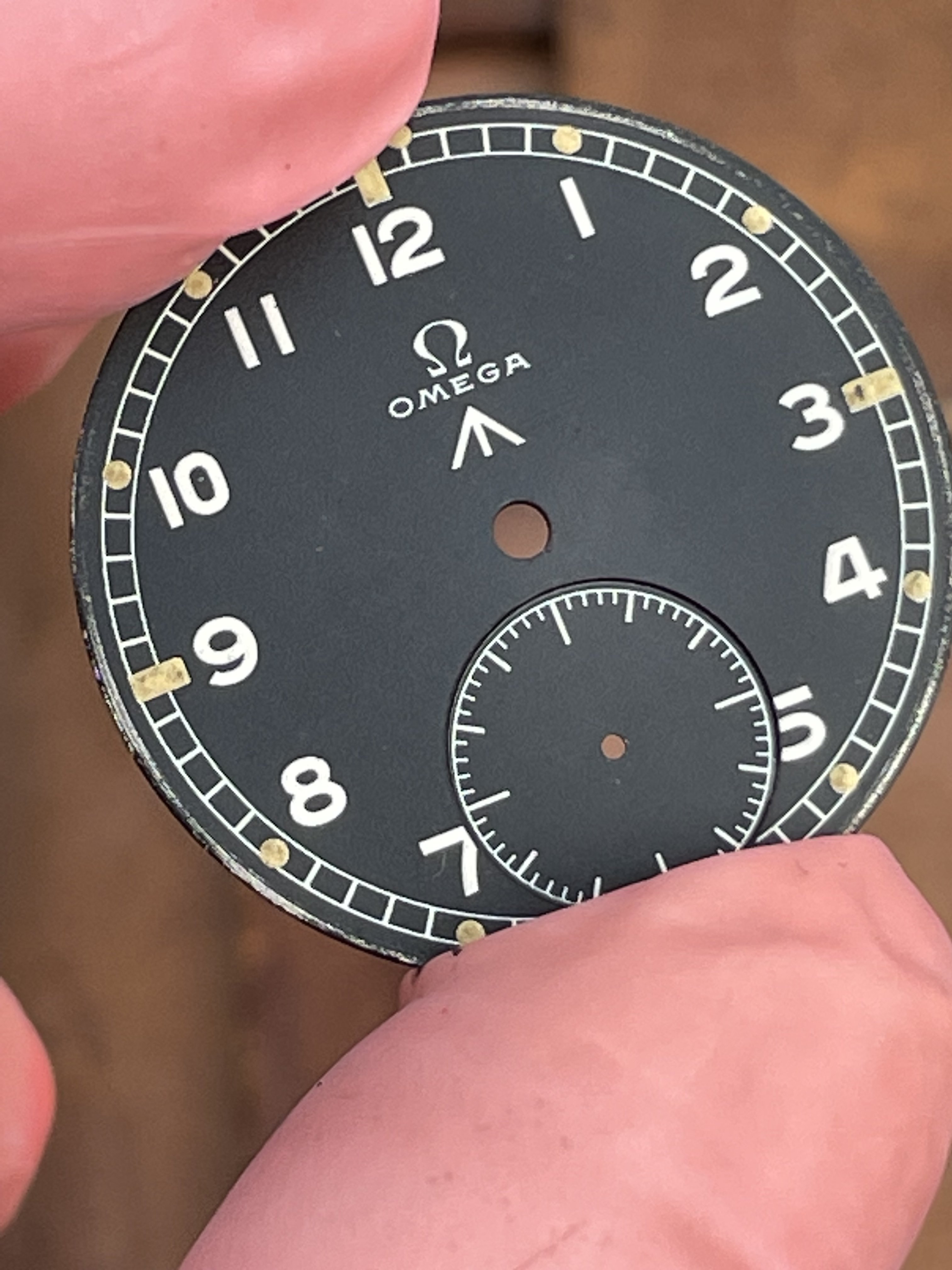

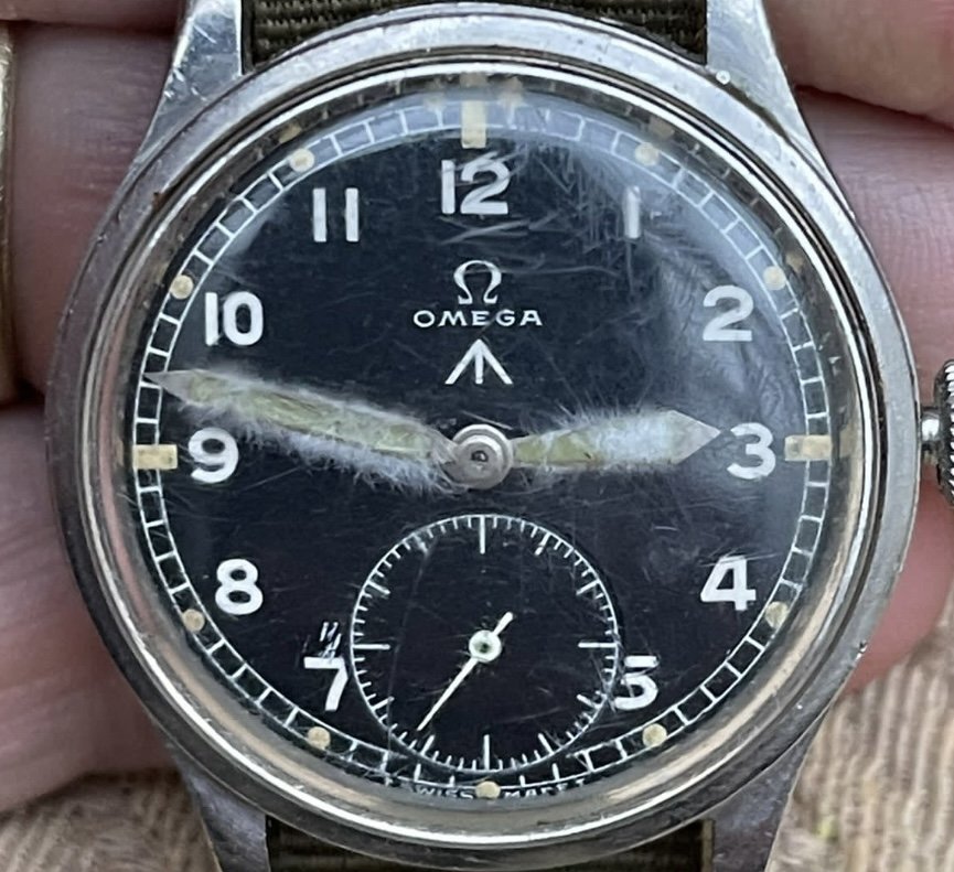

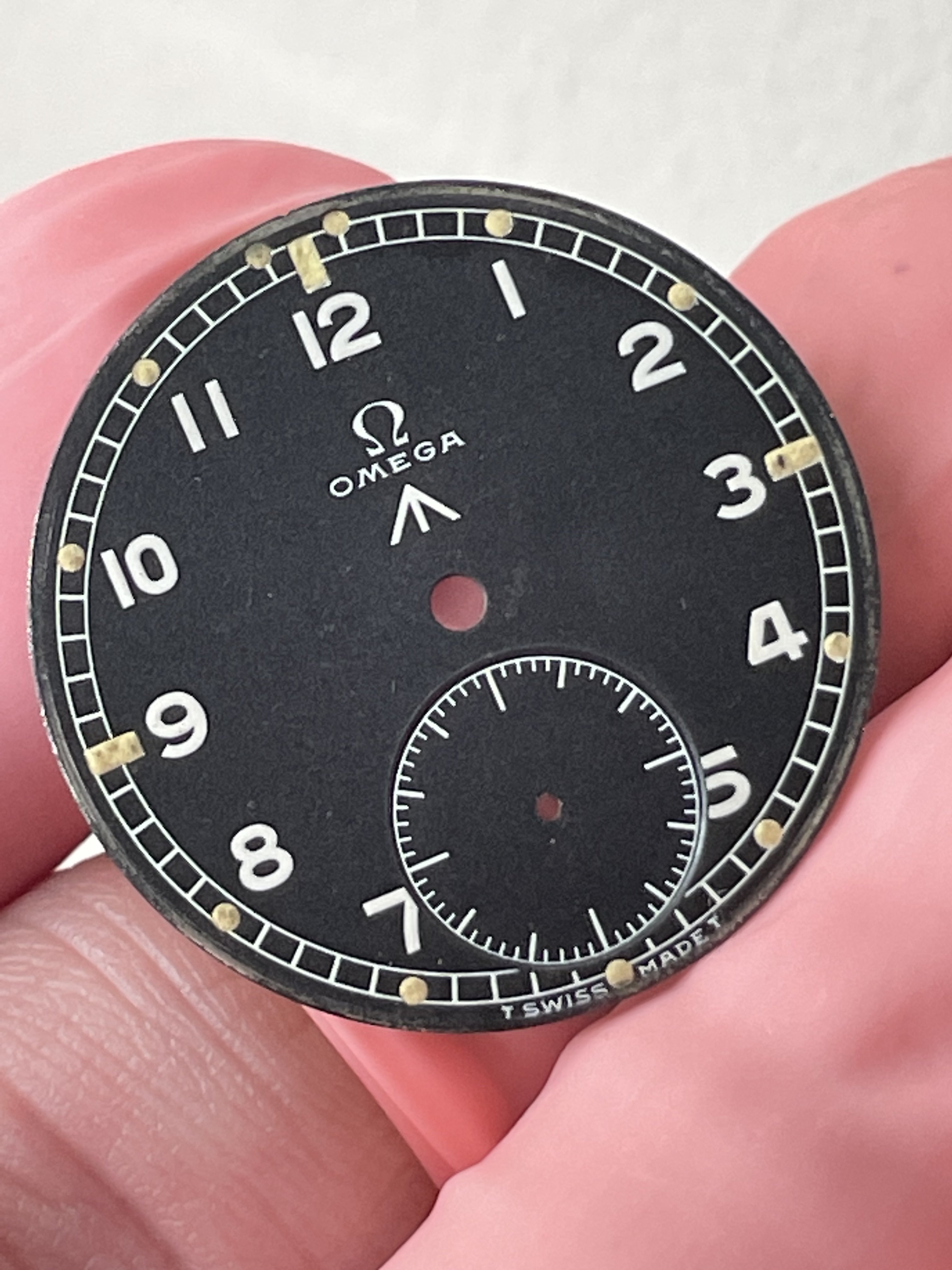

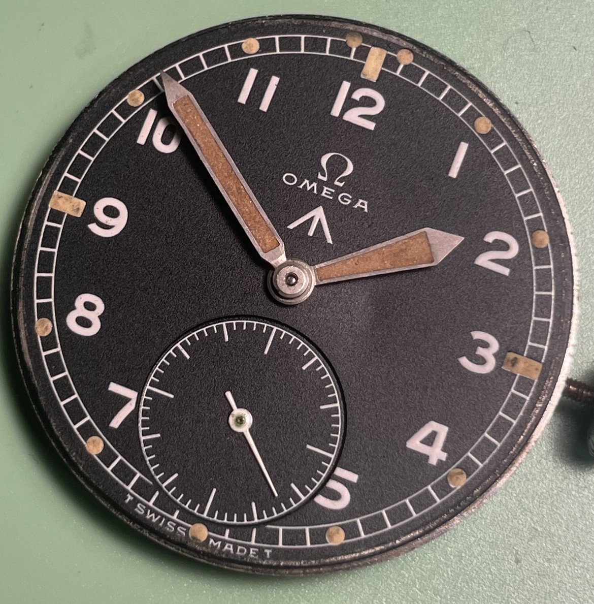

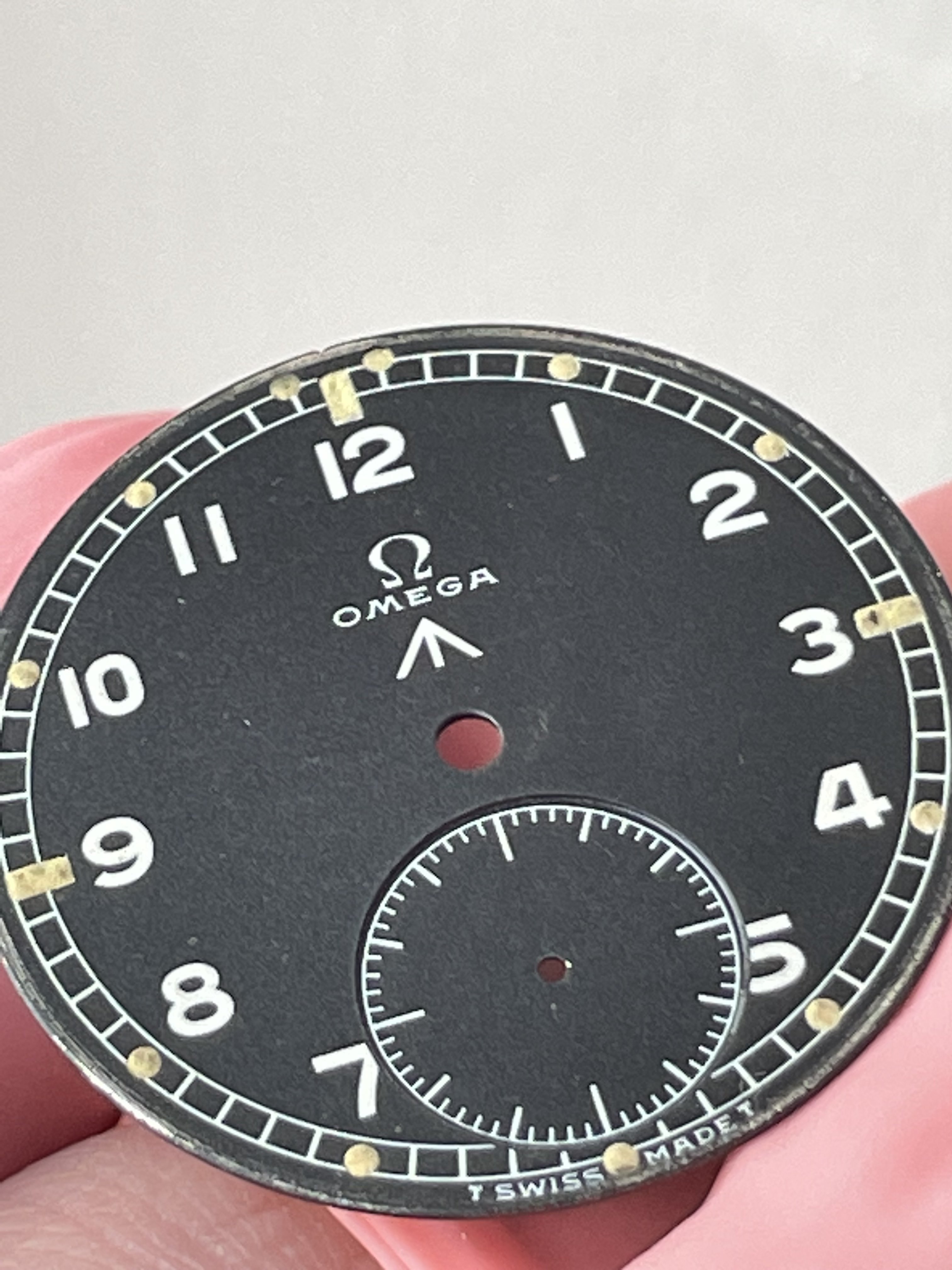

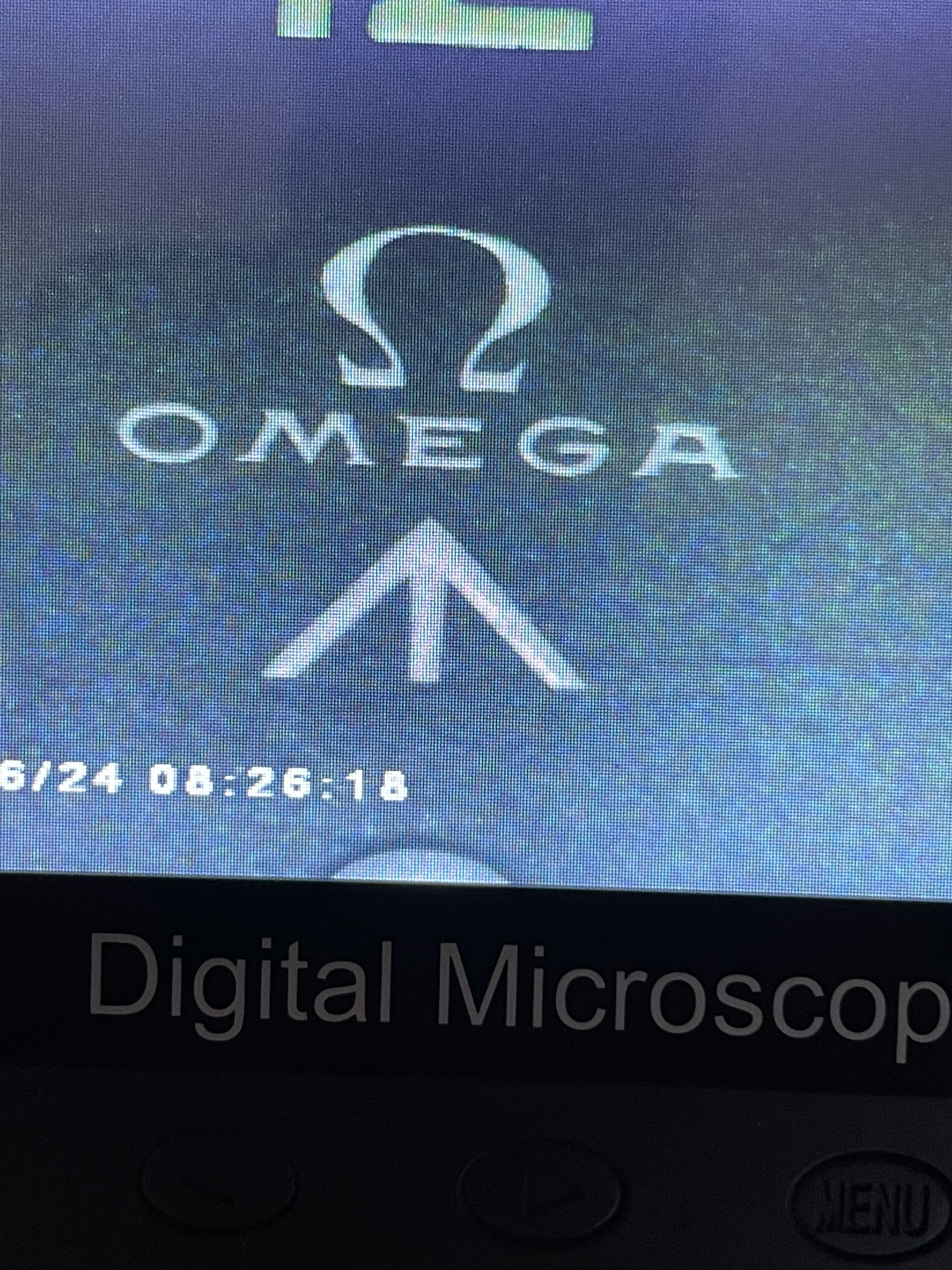

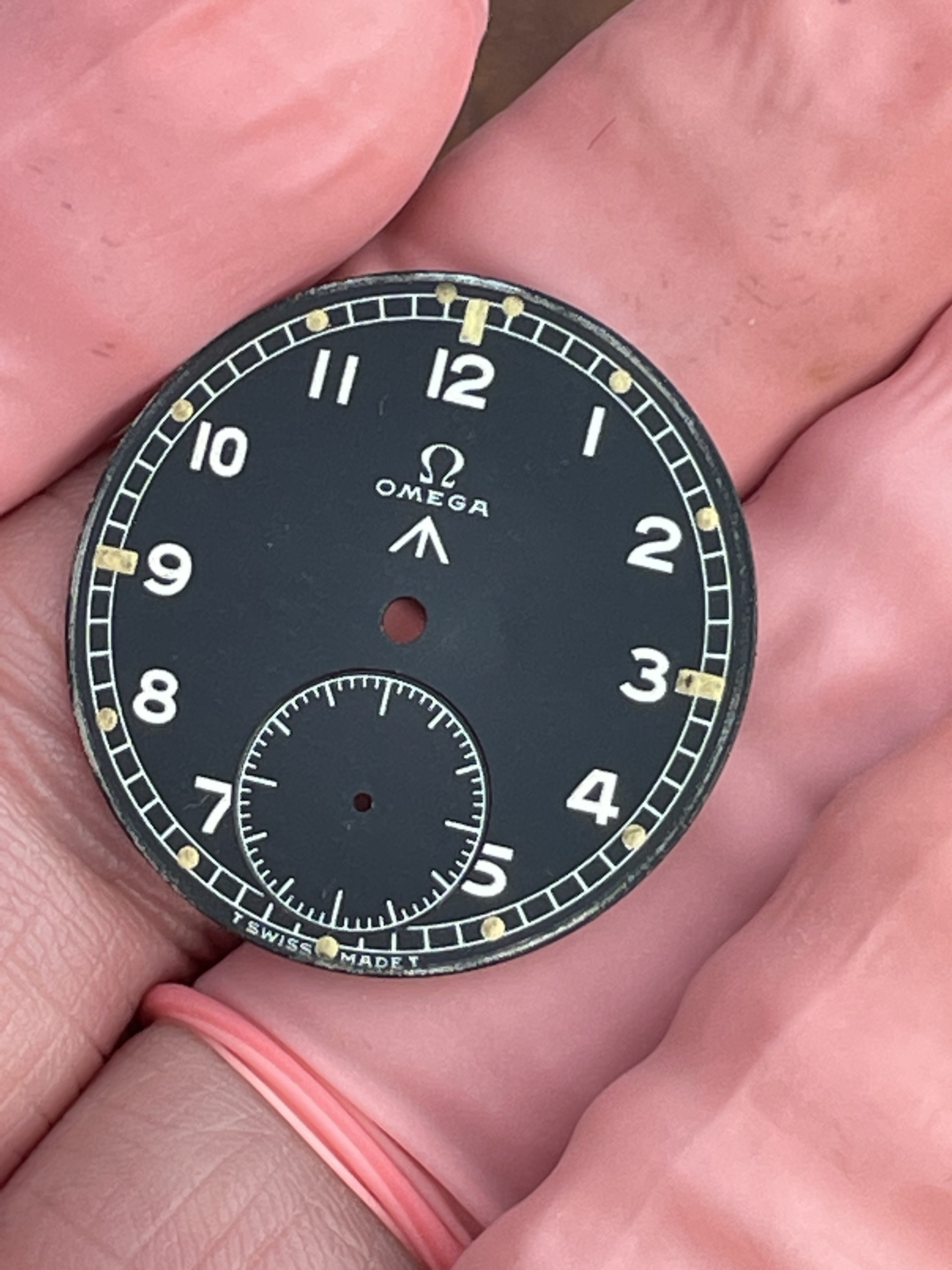

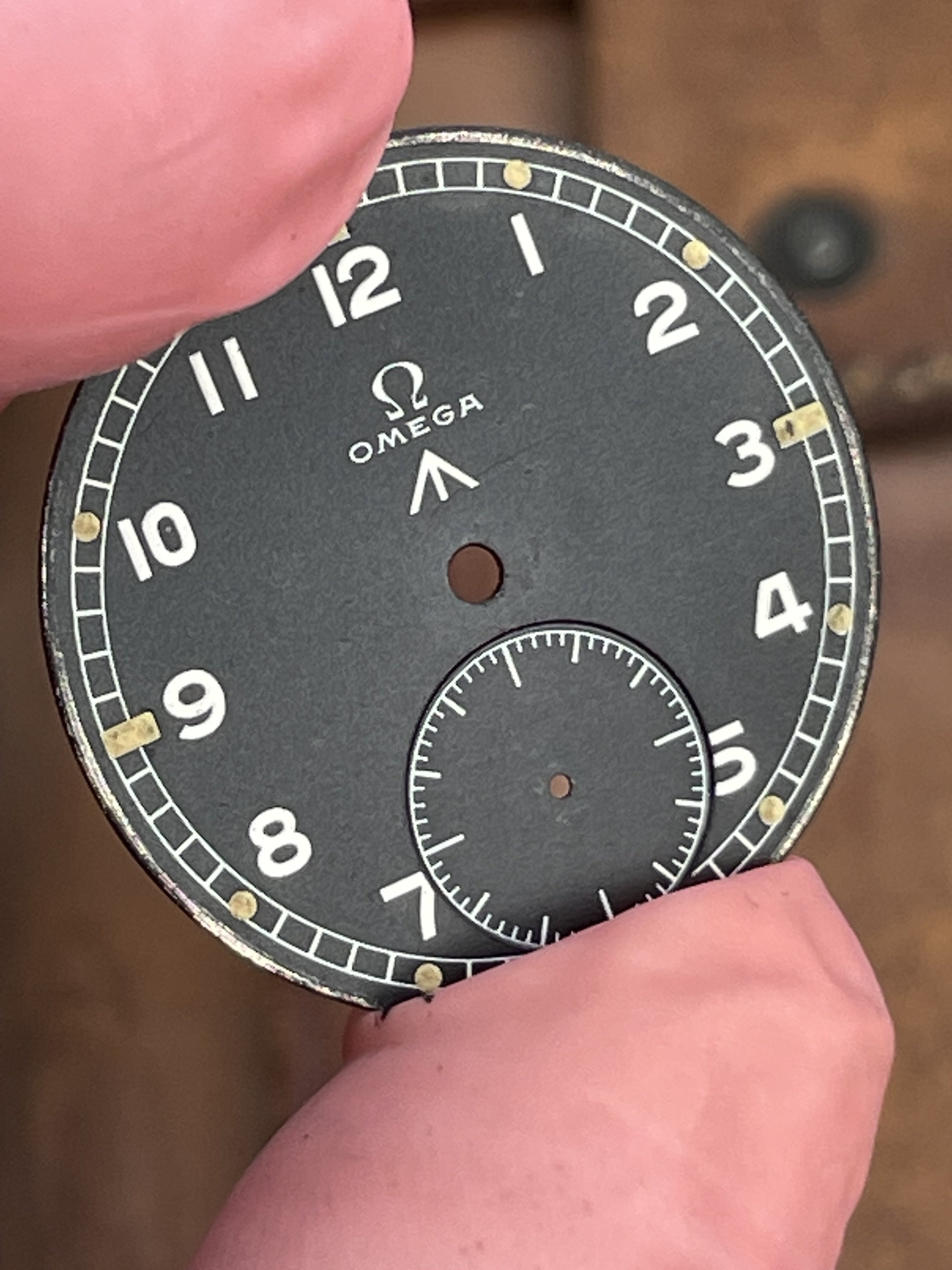

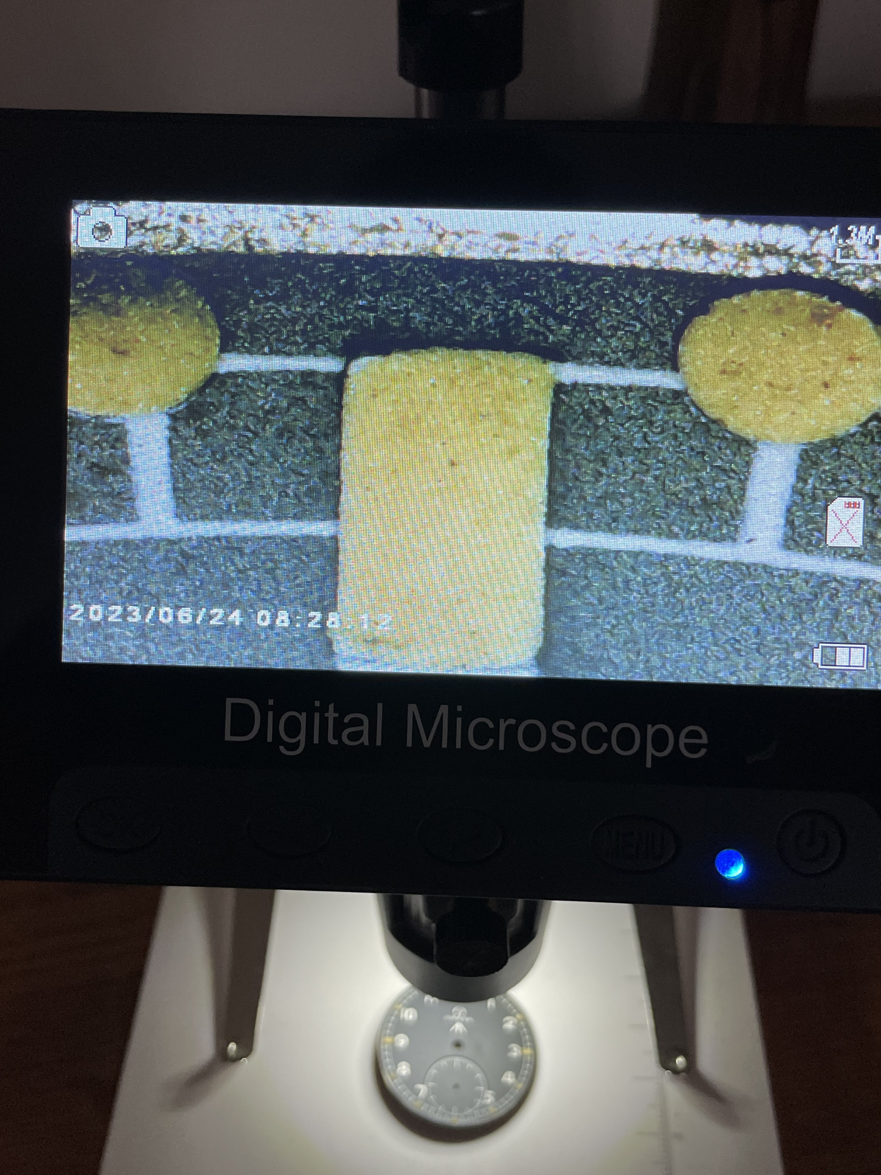

I bought this rather sad looking WWW with furry hands, I have seen this growth on a couple of old dirty dozen watches before and not sure what causes it.

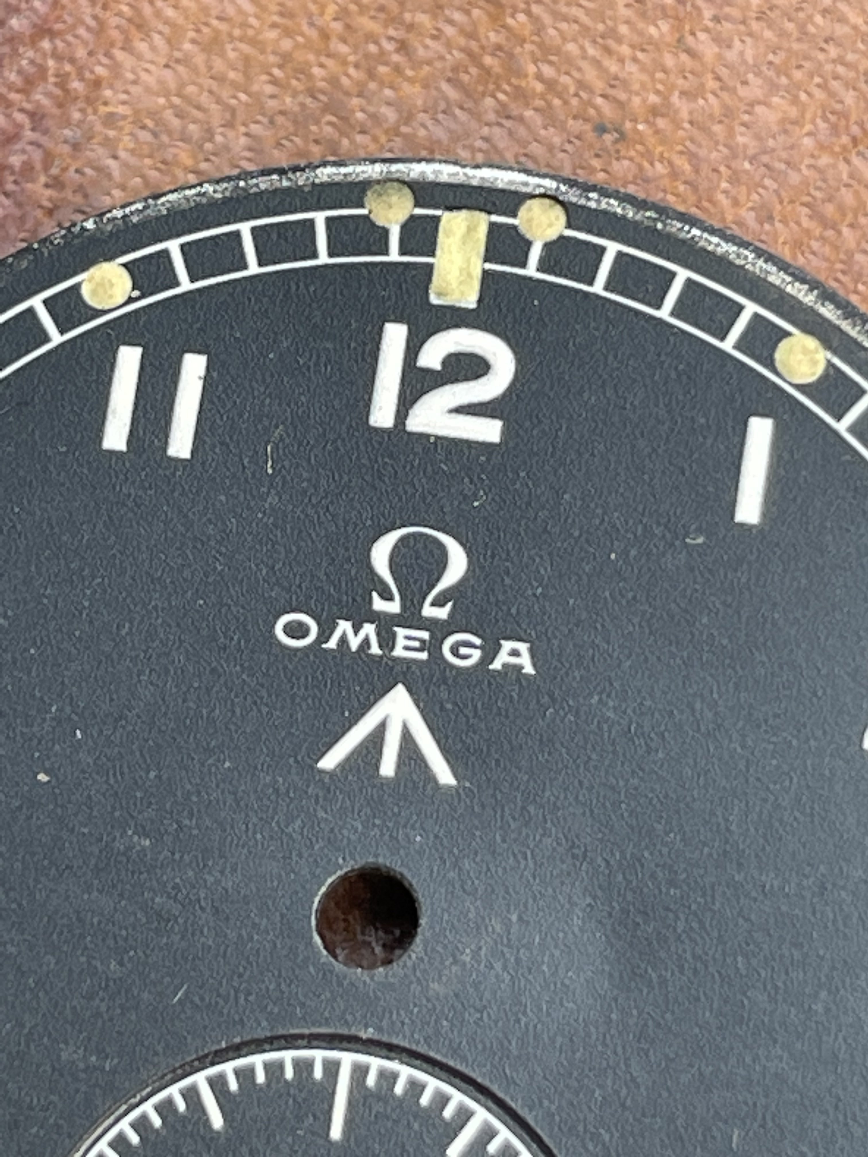

When I uncased the watch I noticed the beautiful factory dial and the T Swiss T meaning it is from after 1962.
I have never seen another only fake dials but this is an original Omega dial.
Anyone else ever seen such a thing?
Obviously I have relumed the hands now.
Thanks

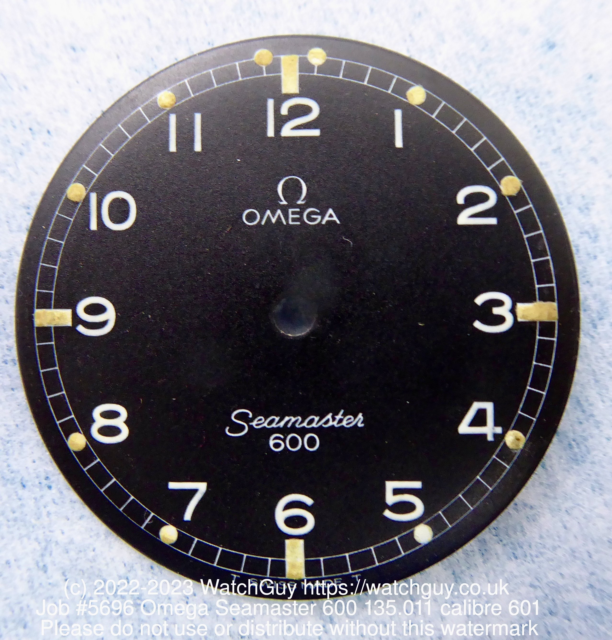

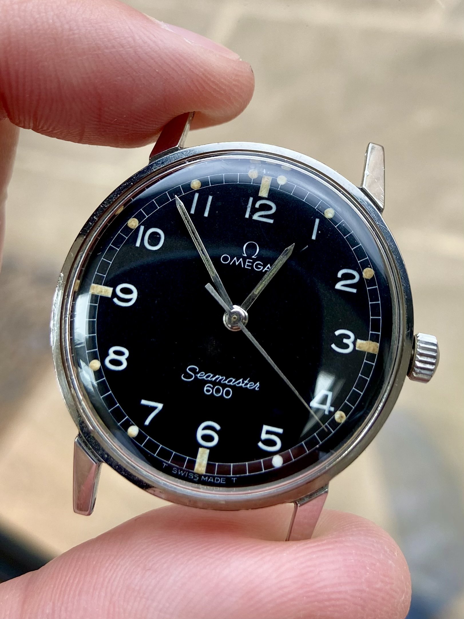

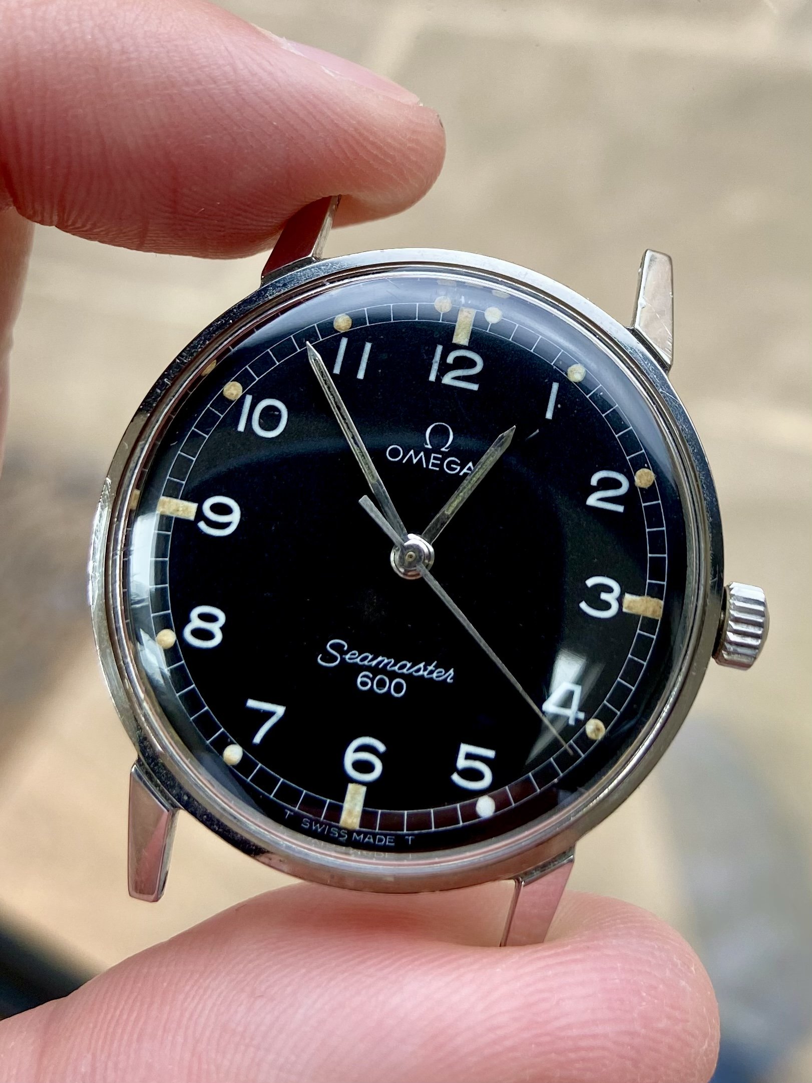

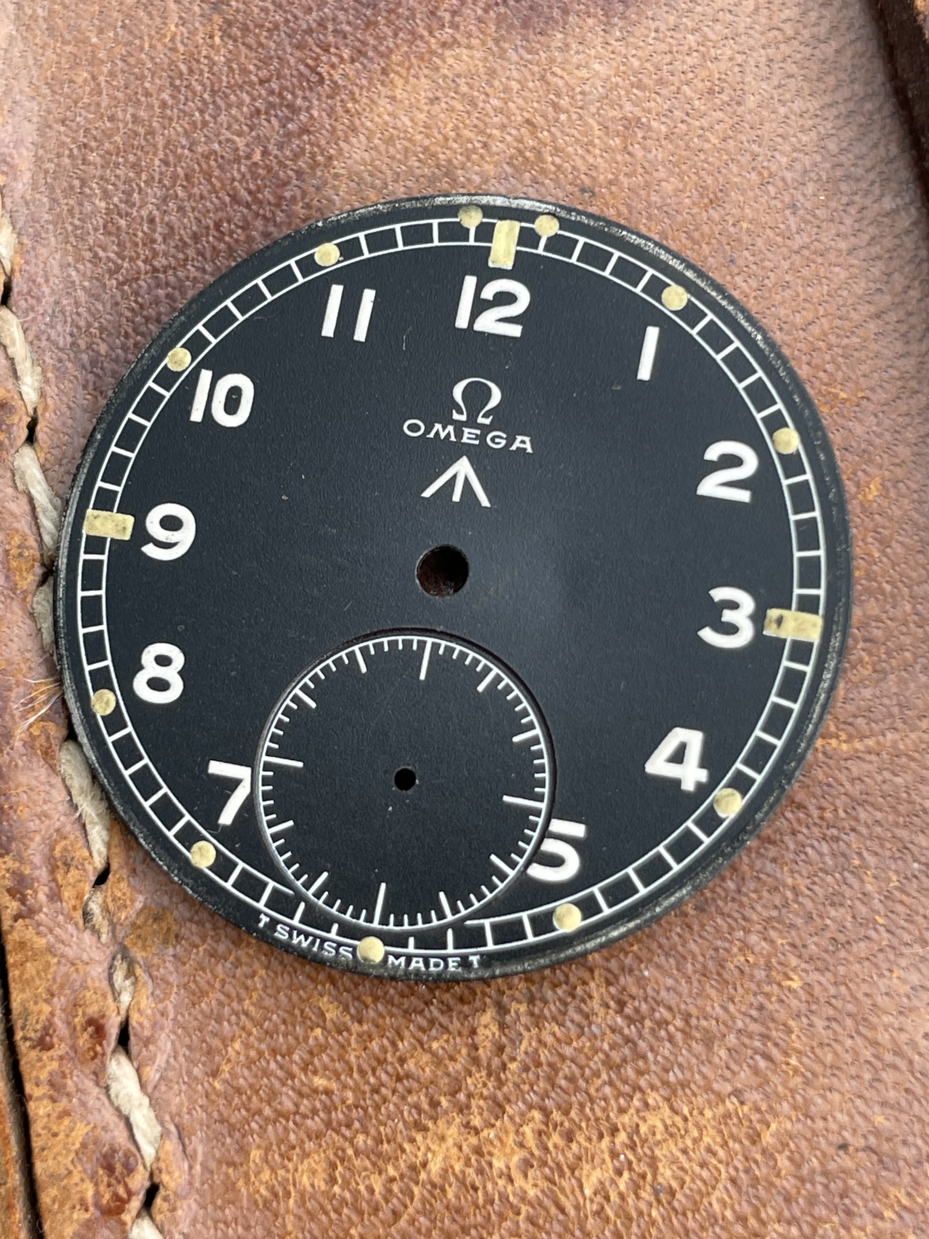

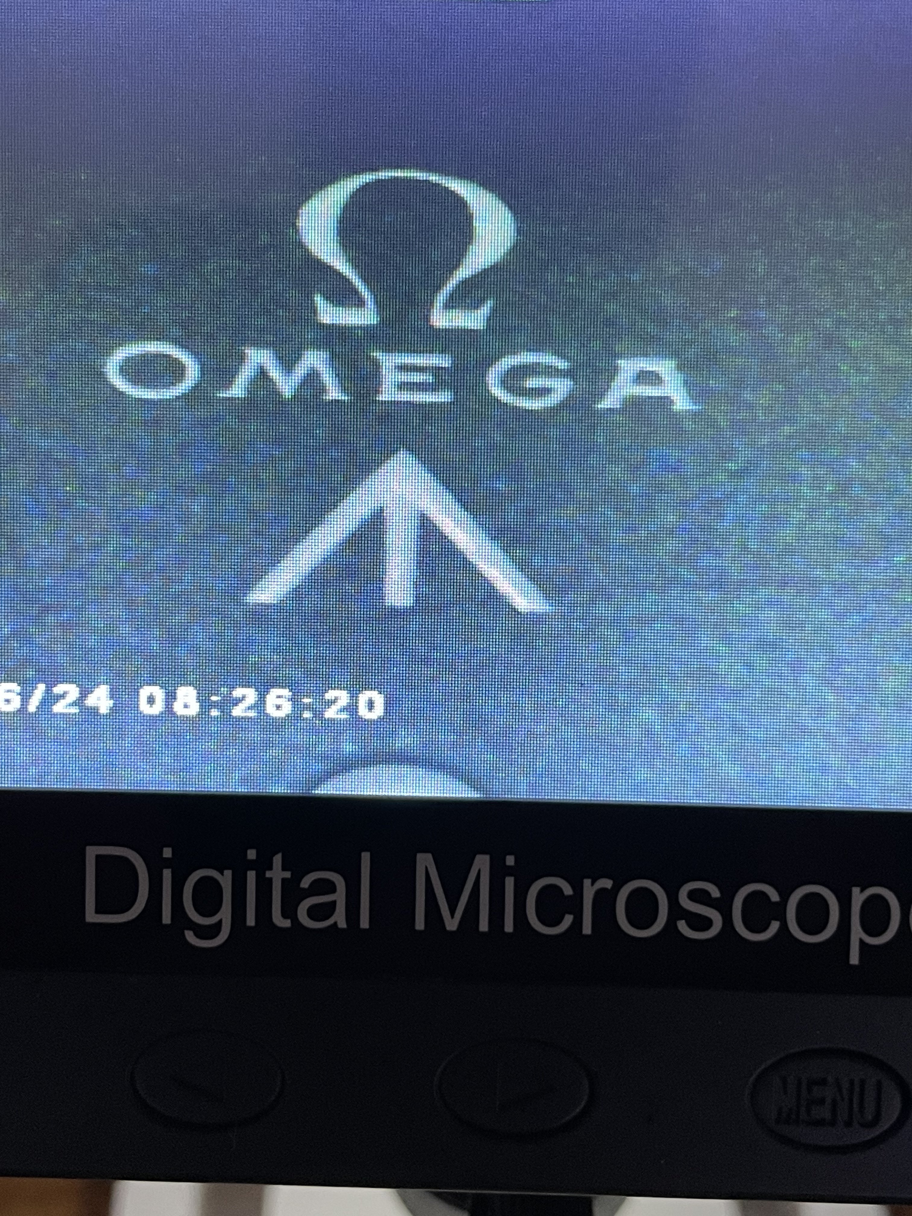

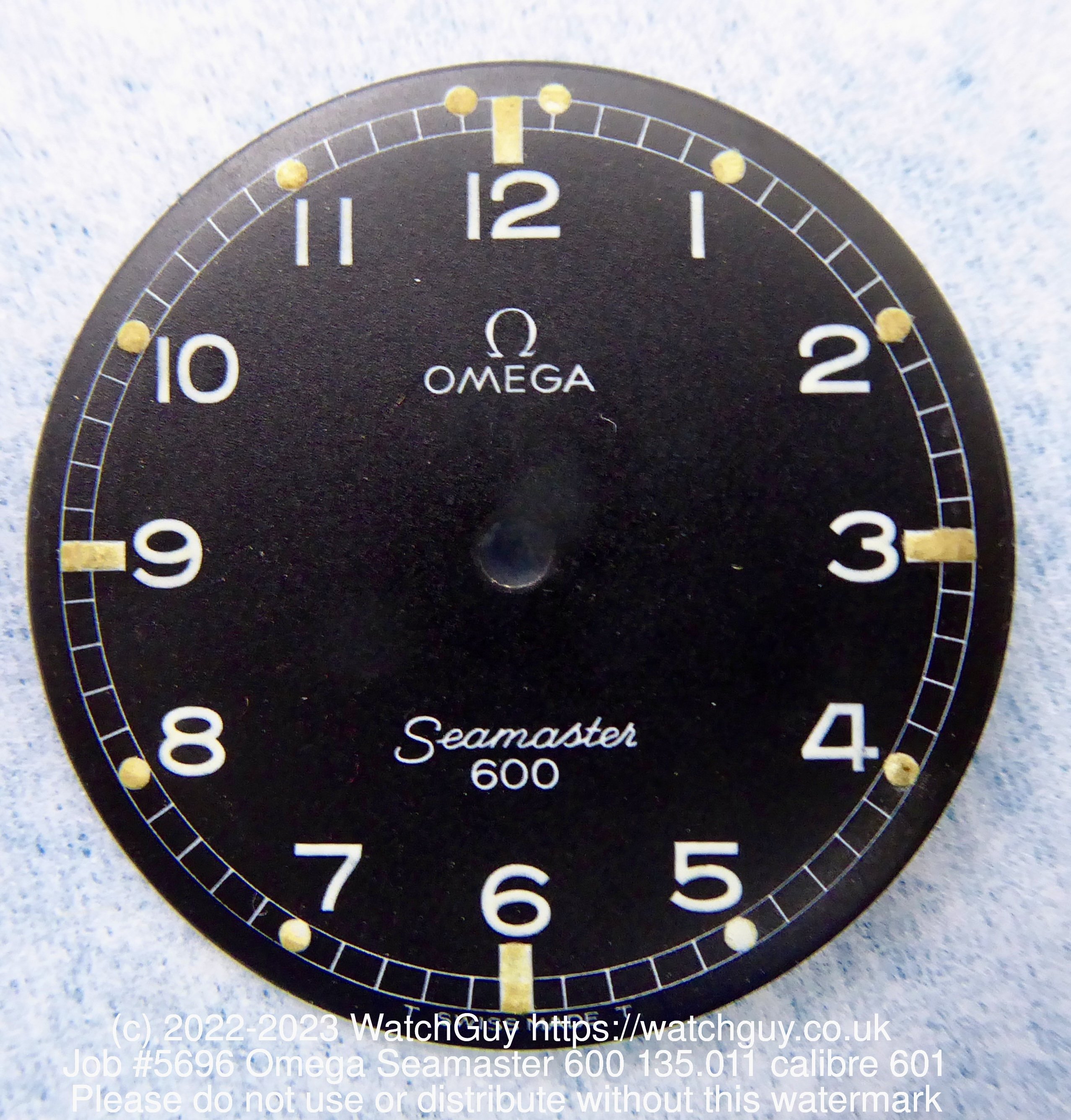

Obviously a different reference and the old logo but very similar to these uncommon T Swiss Made T dials seen on SM30’s and SM600’s.
Does the movement serial indicate the whole watch is contemporary to post ‘62 or is it a service dial?
1,522
4,785
Yes, everything else is what I would expect to find on a dirty dozen, case, case back 30t2 movement in the 10 million range.
Cheers, Michael

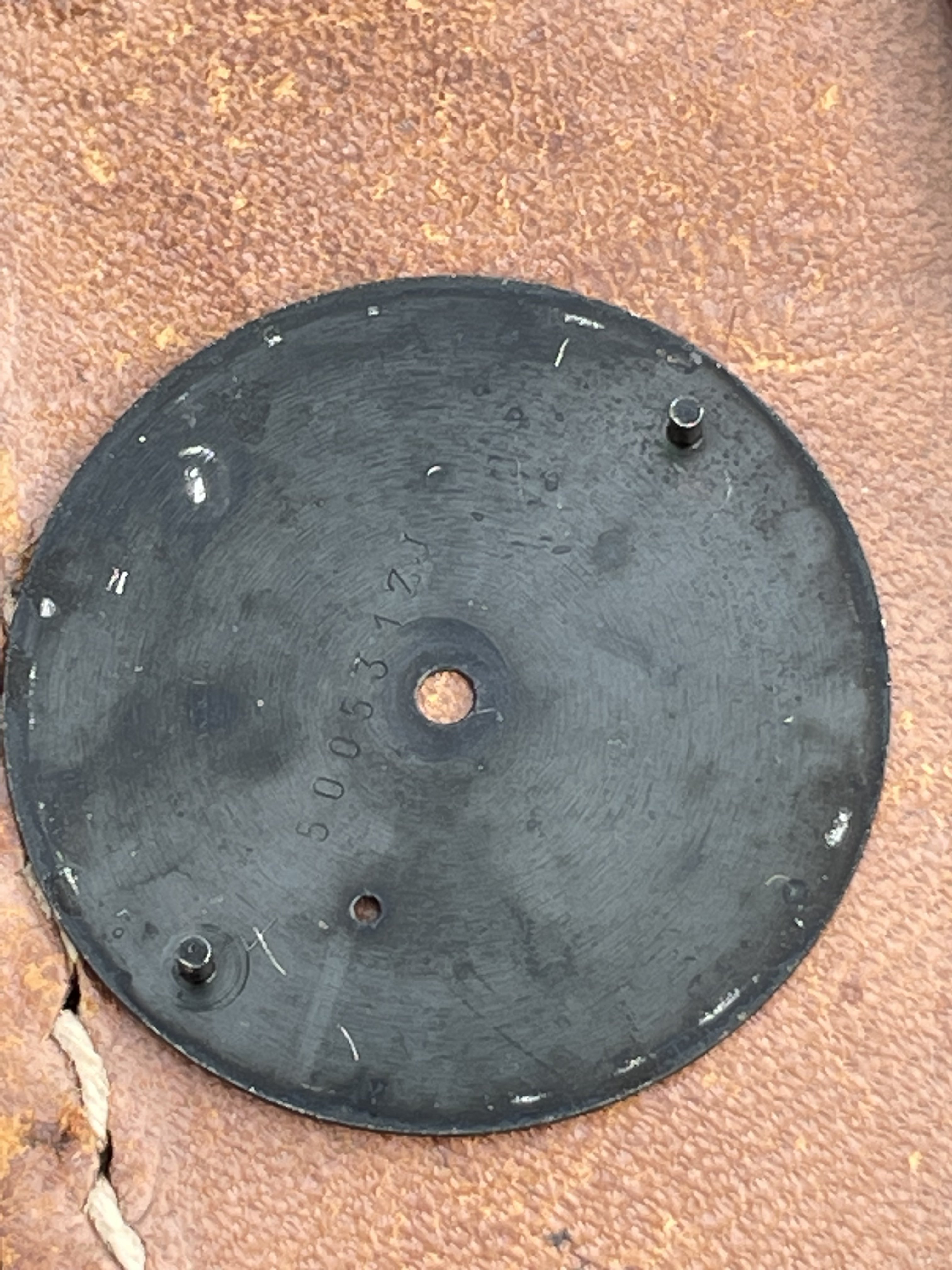

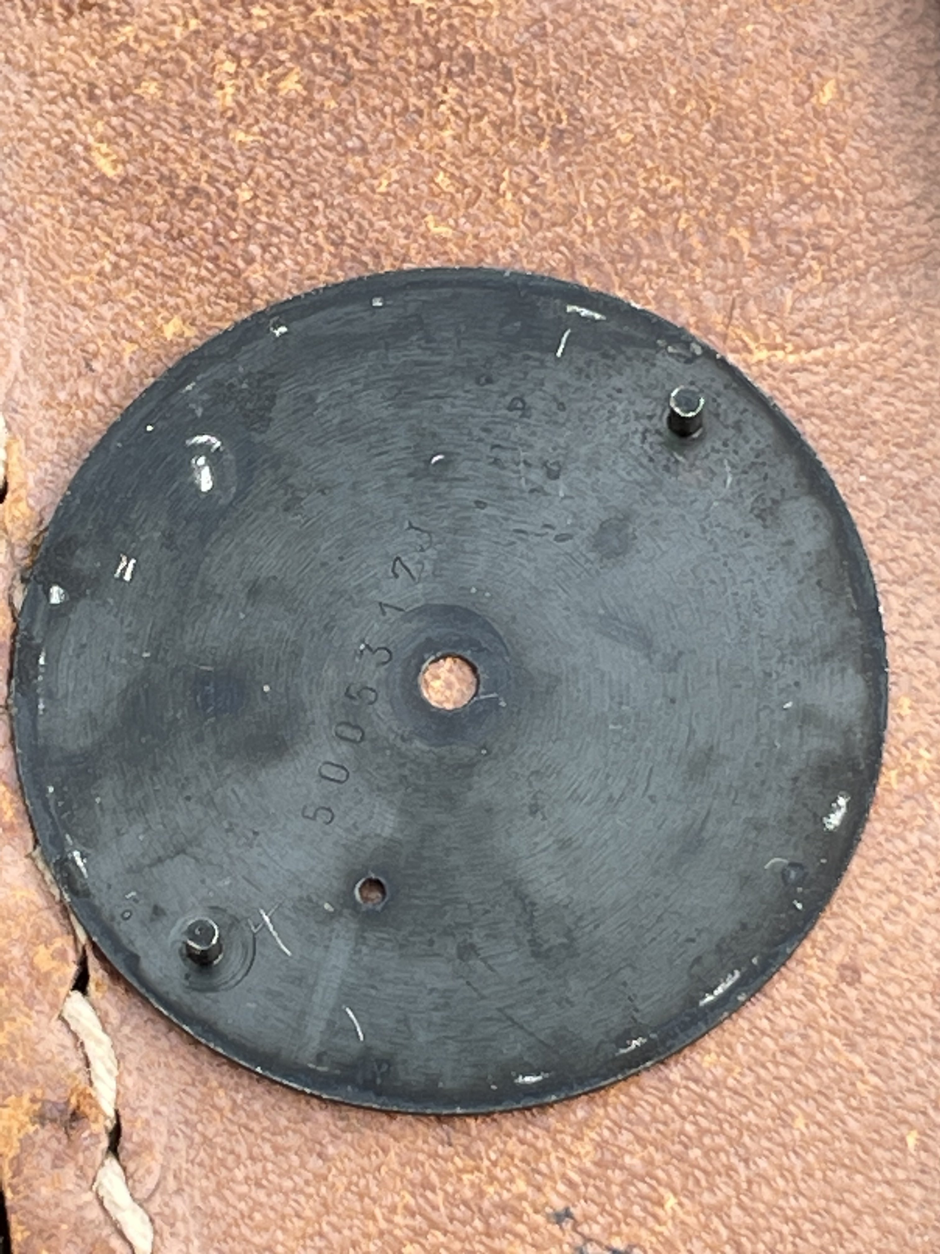

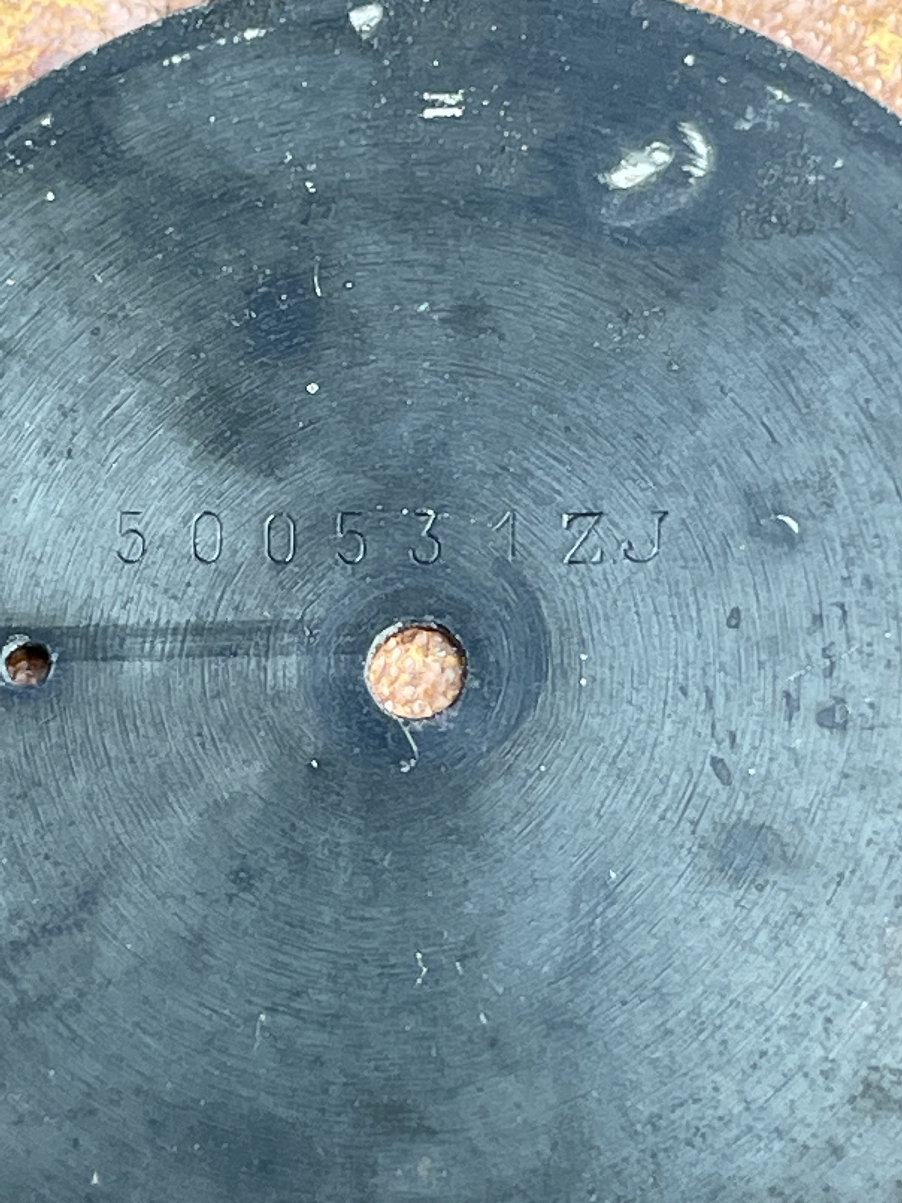

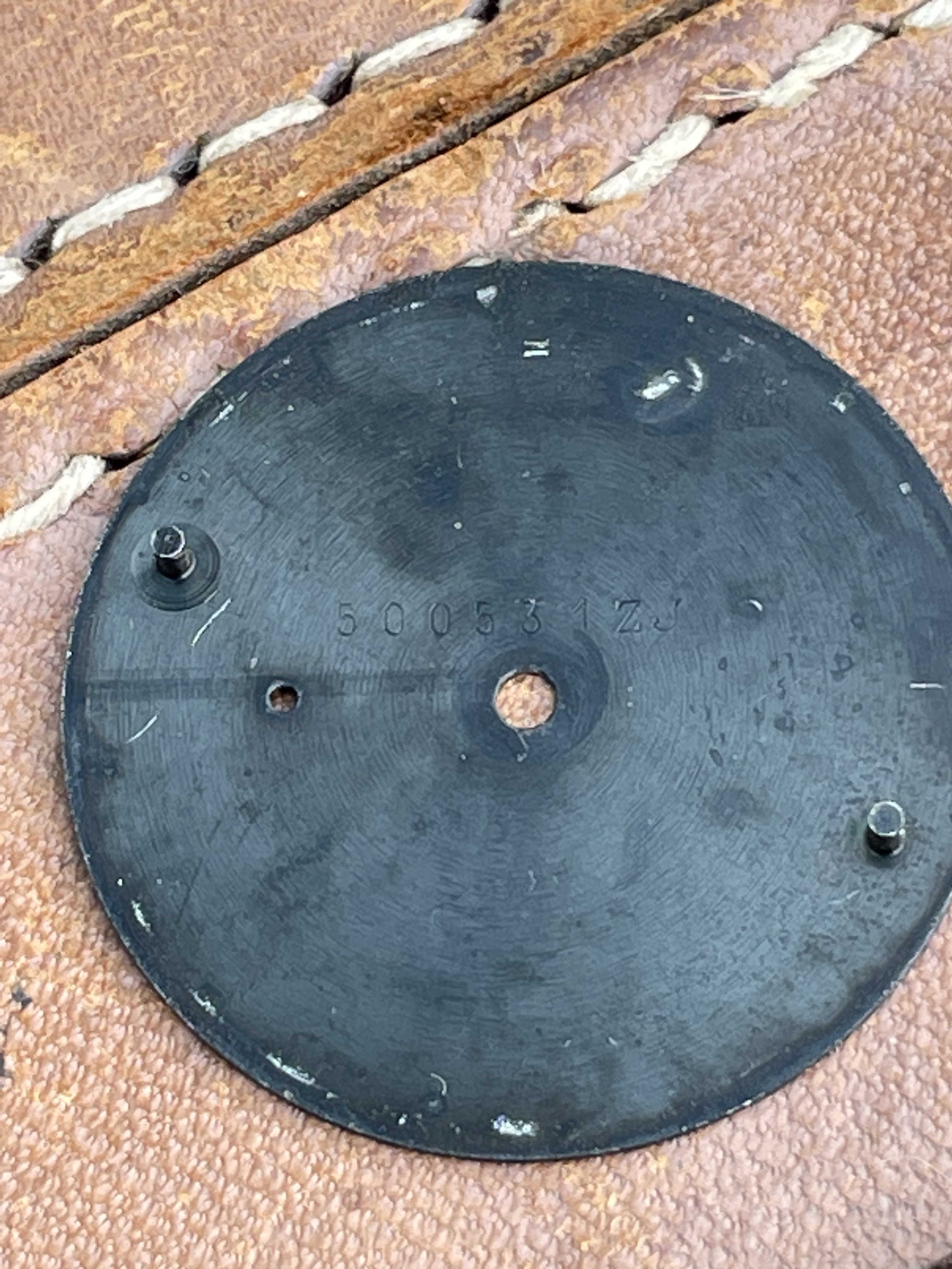

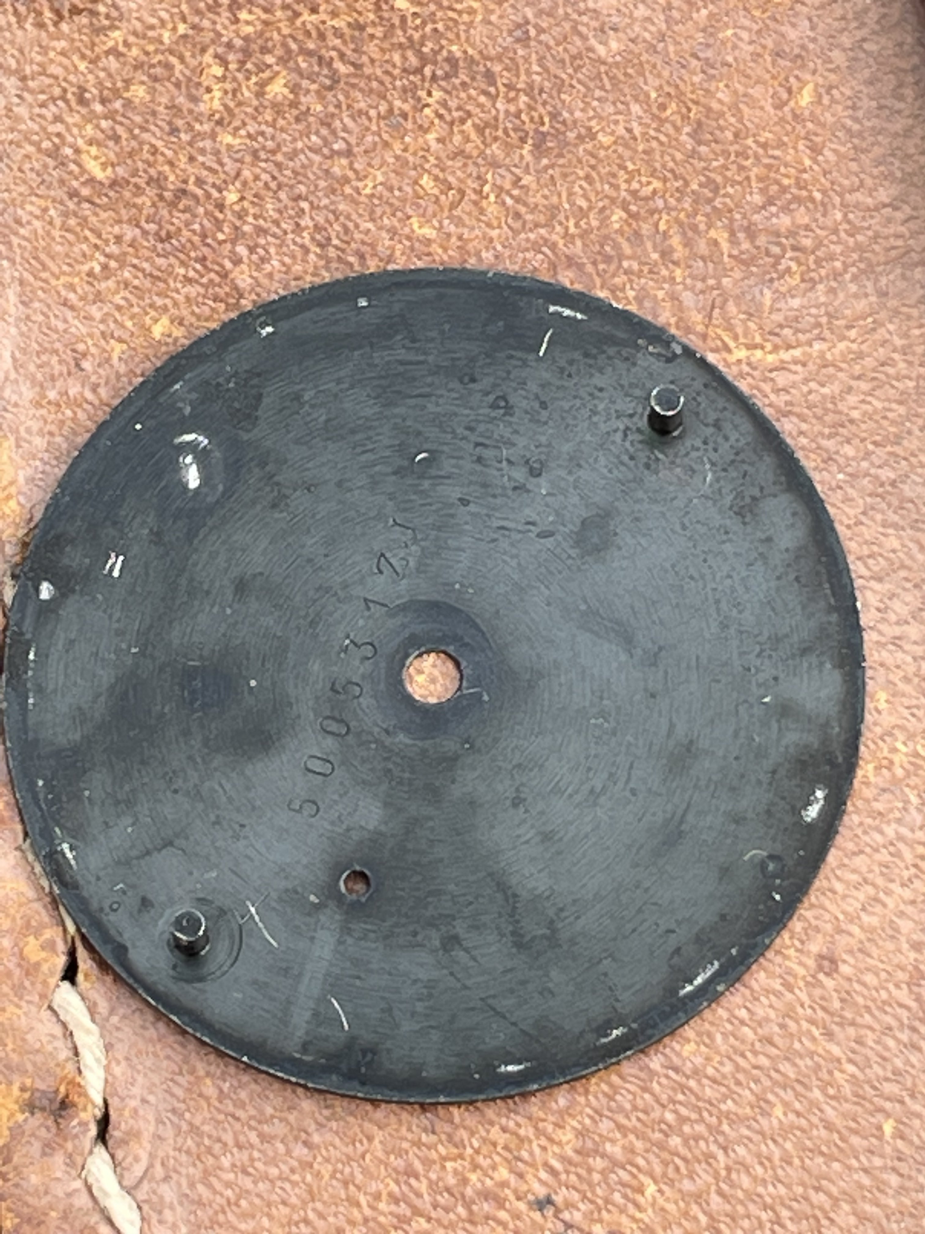

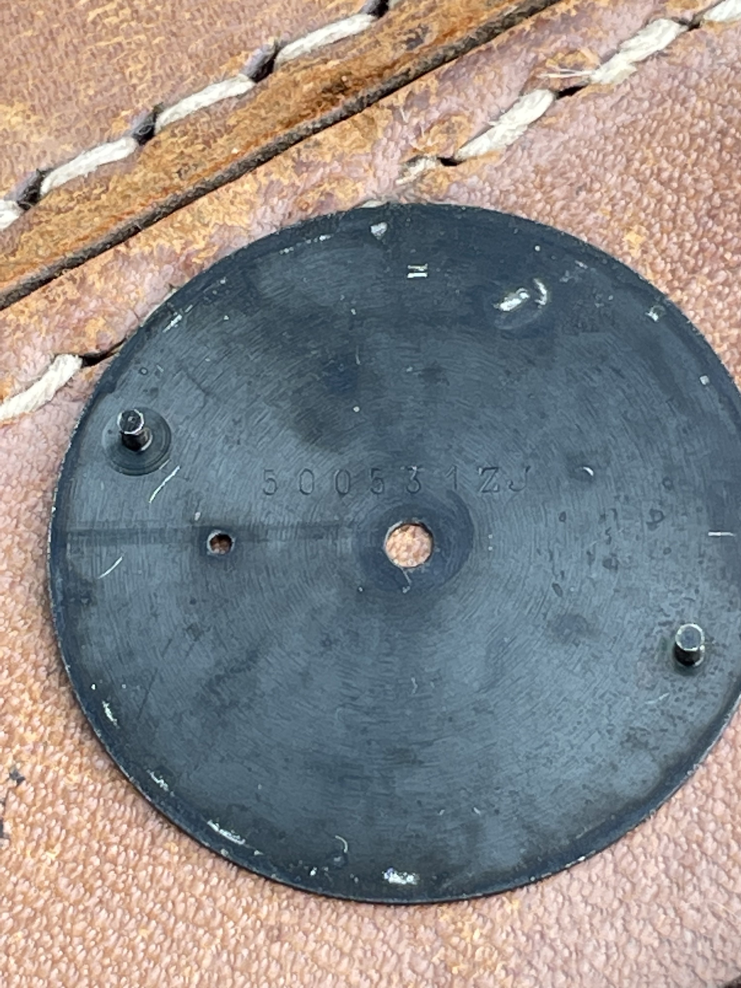

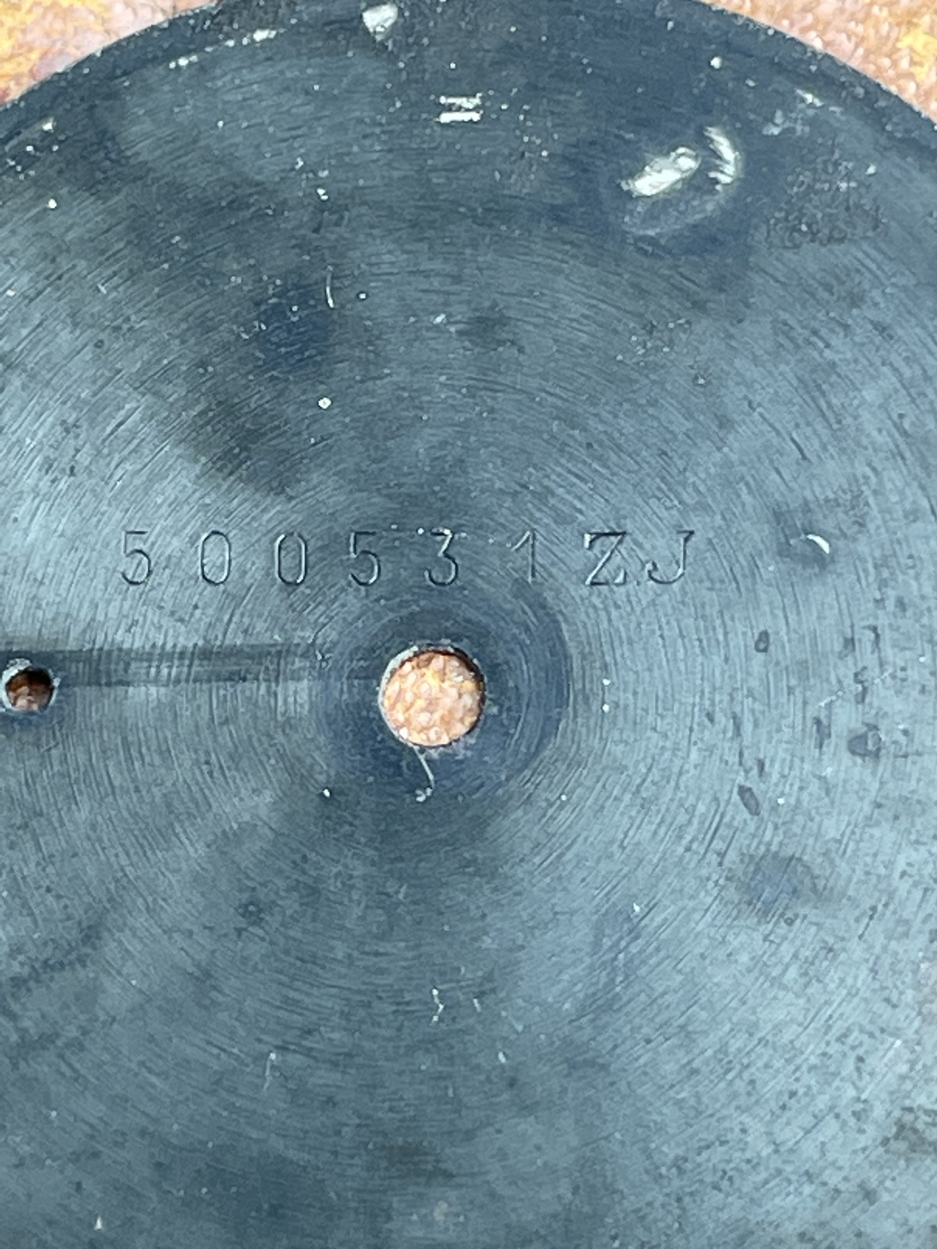

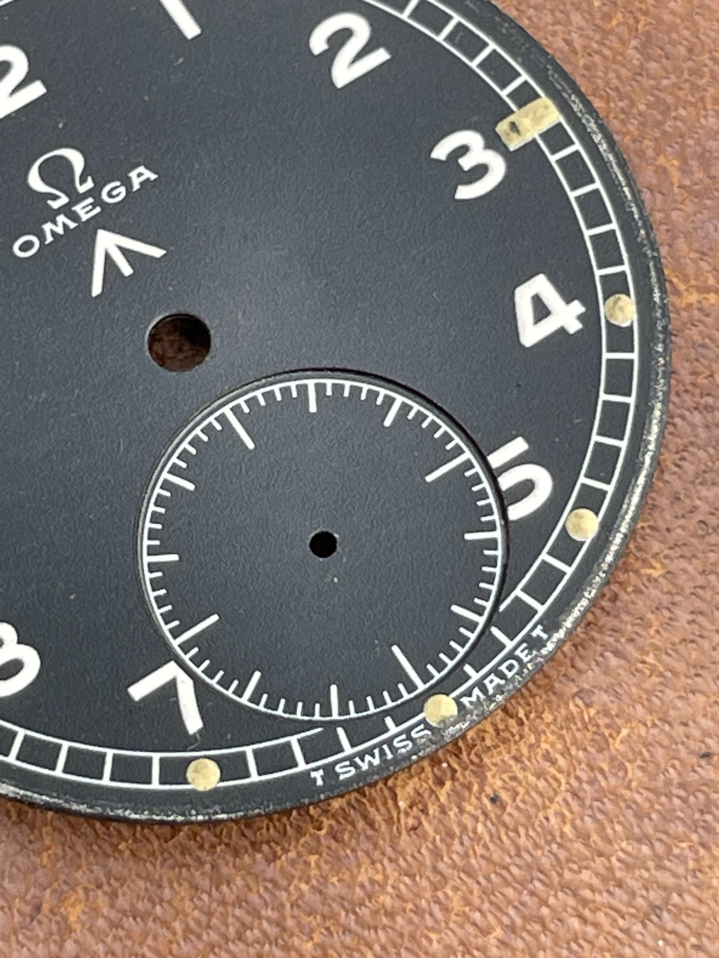

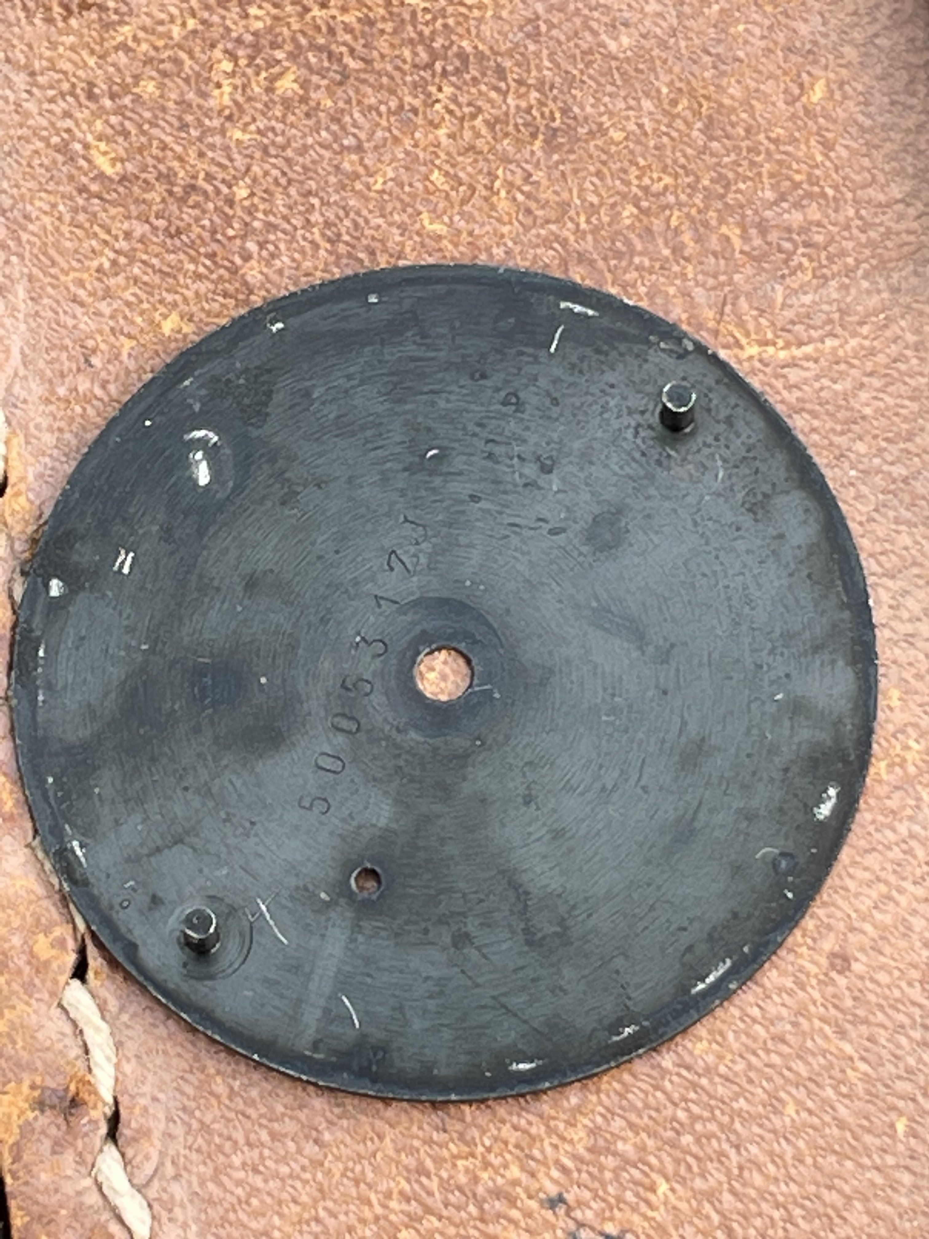

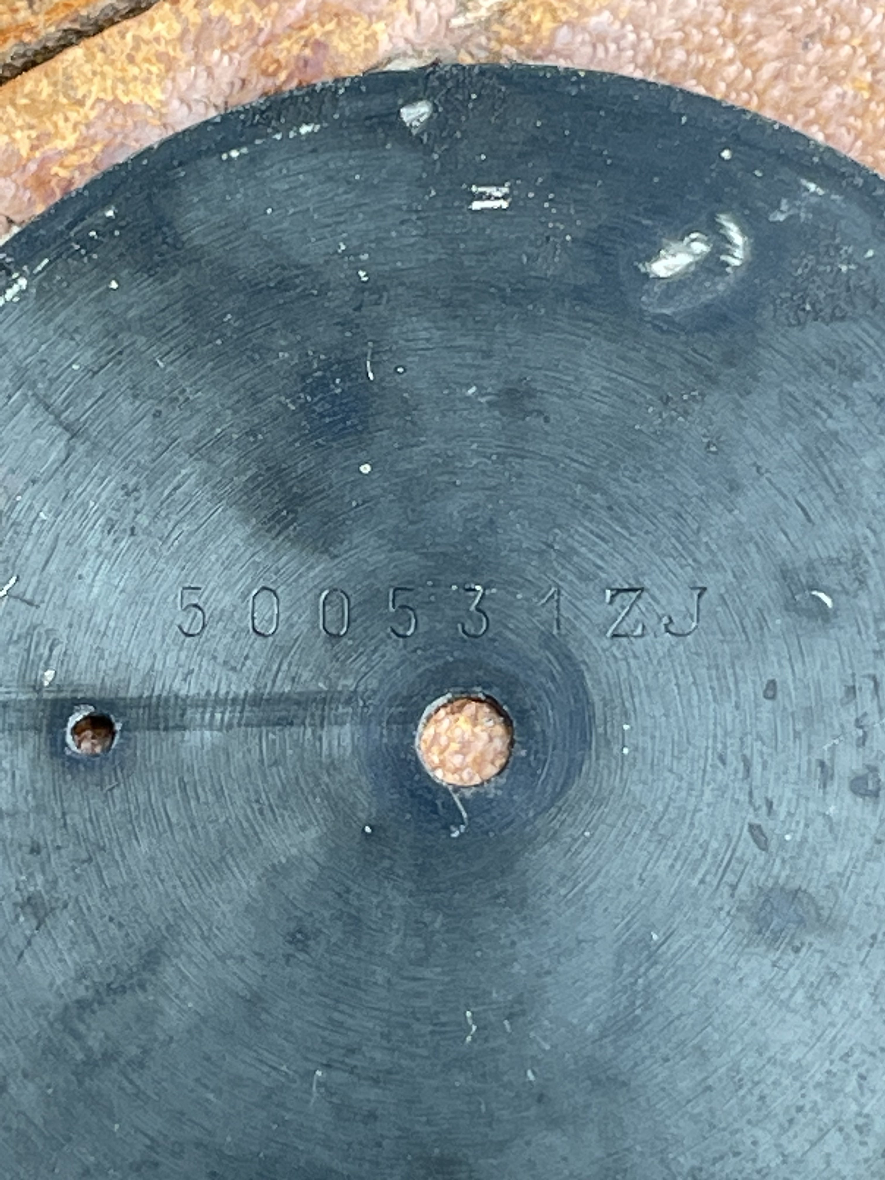

Michael, did you take a picture from the back of the Dial? Would love to see that in different lights .

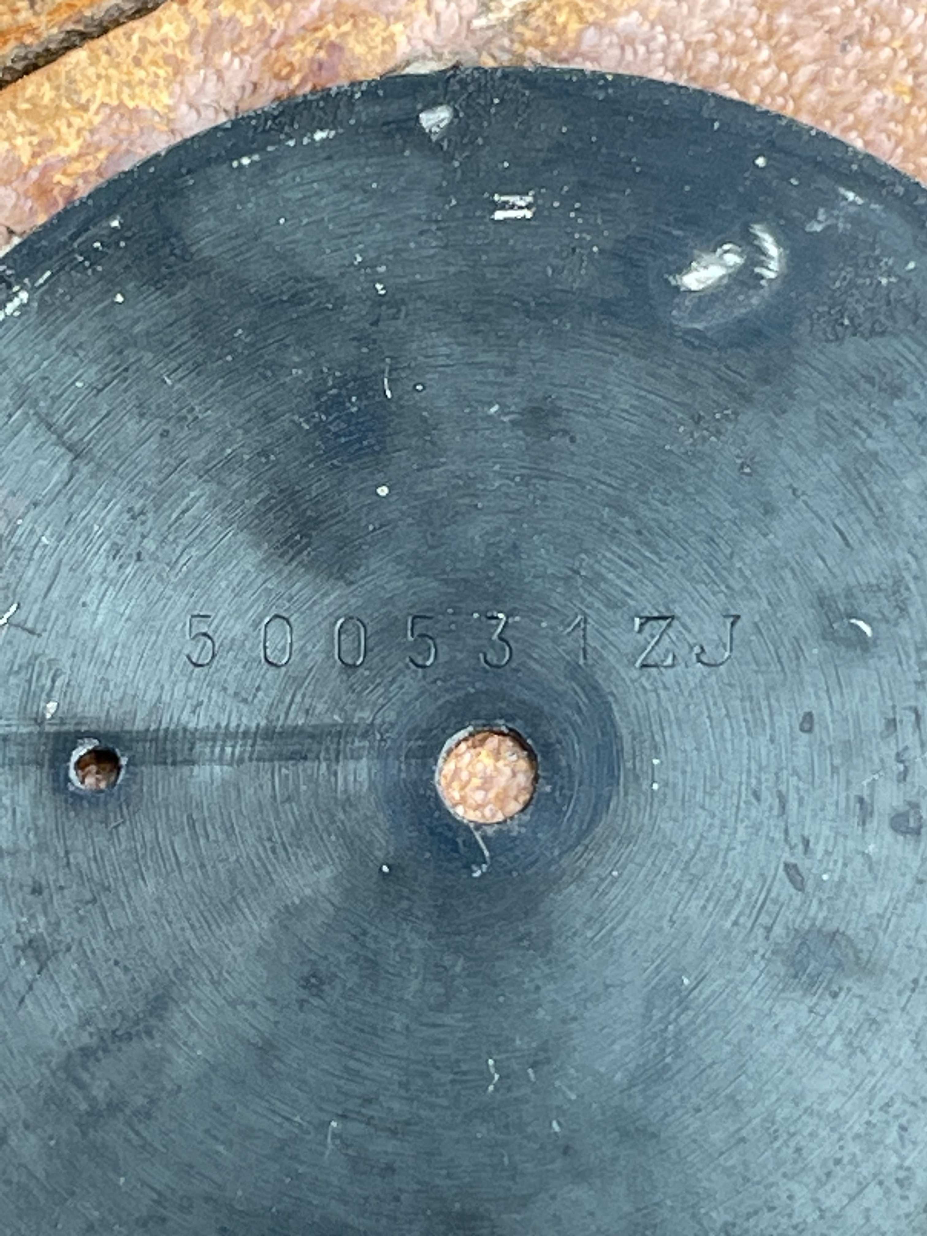

1,522
4,785
Im going to service the movement through the week but will whip the dial off today 👍

5,666
9,496

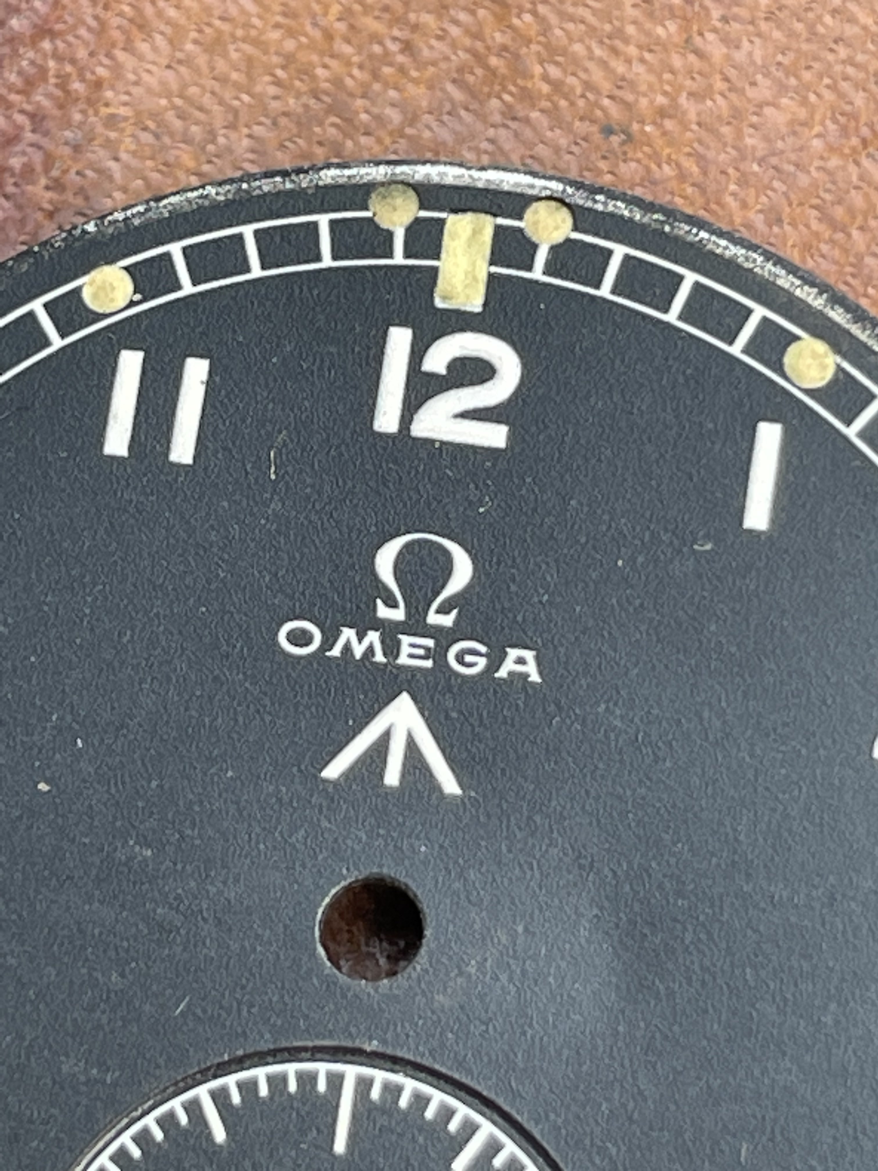

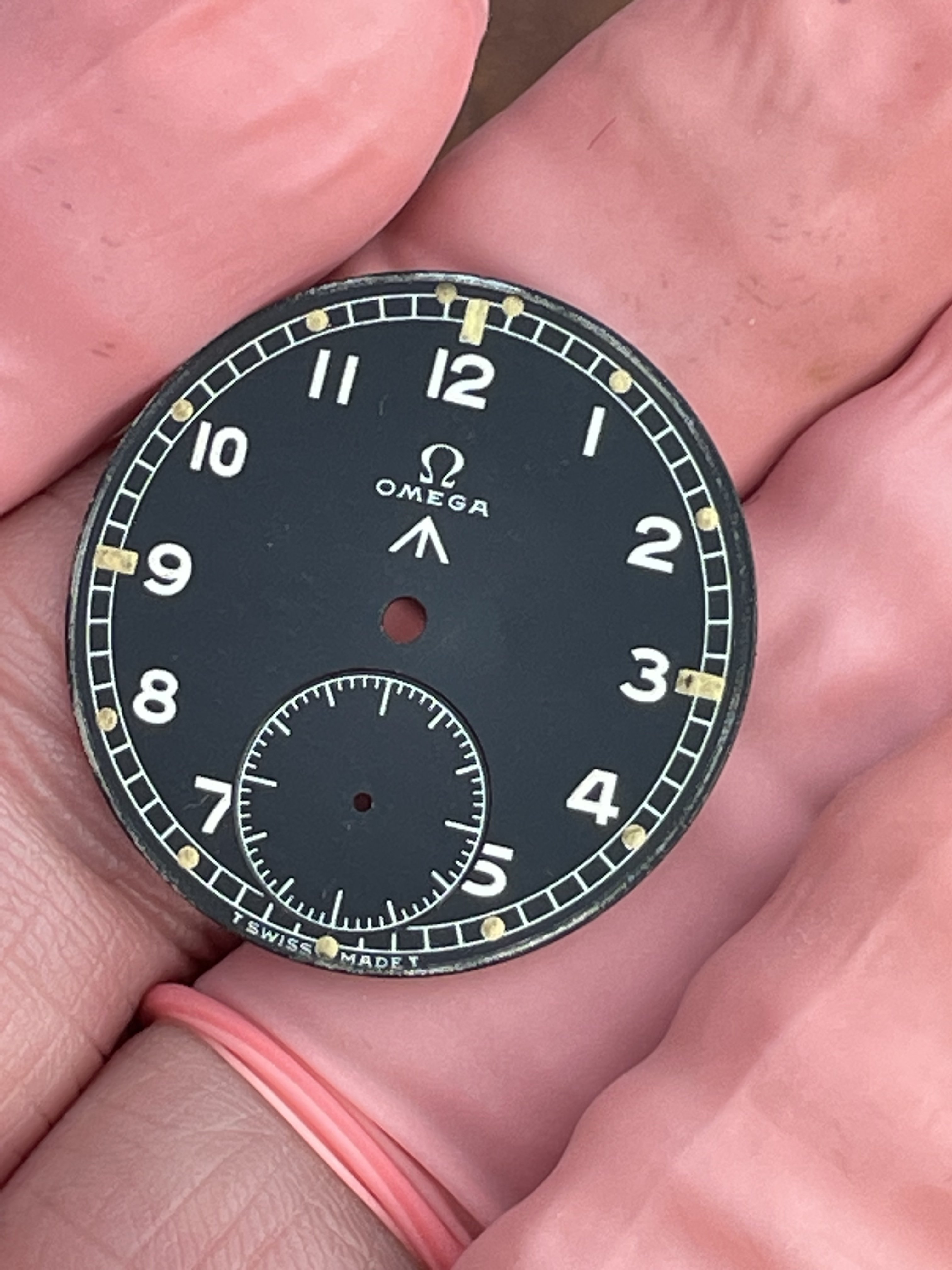

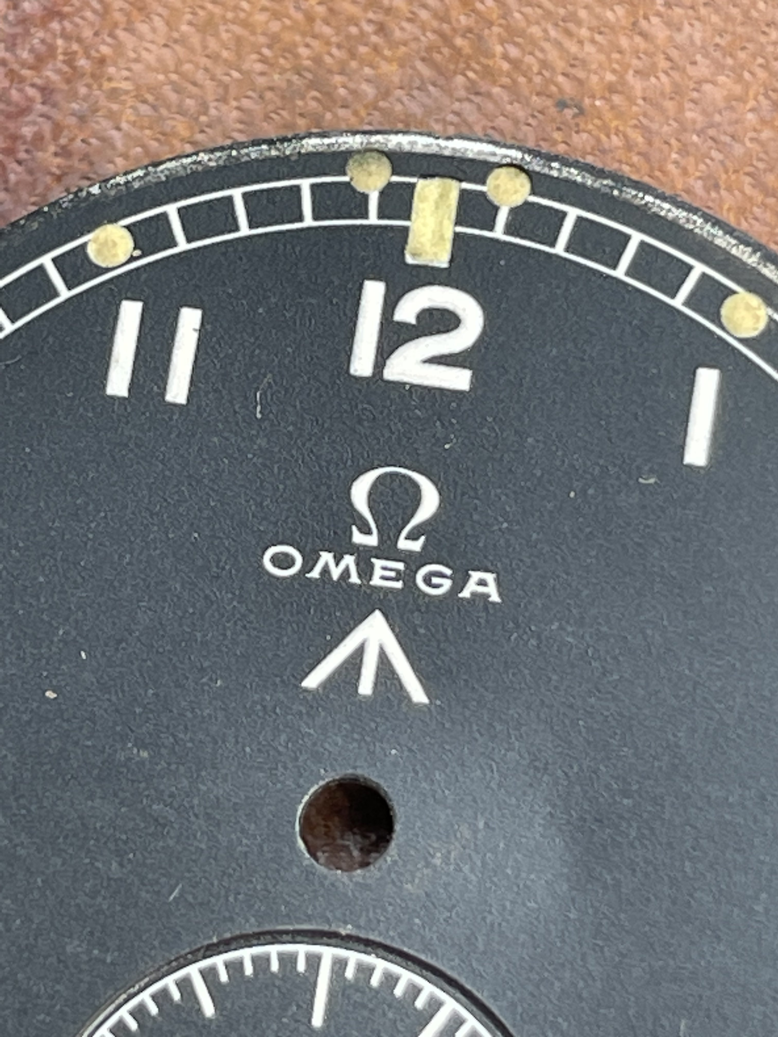

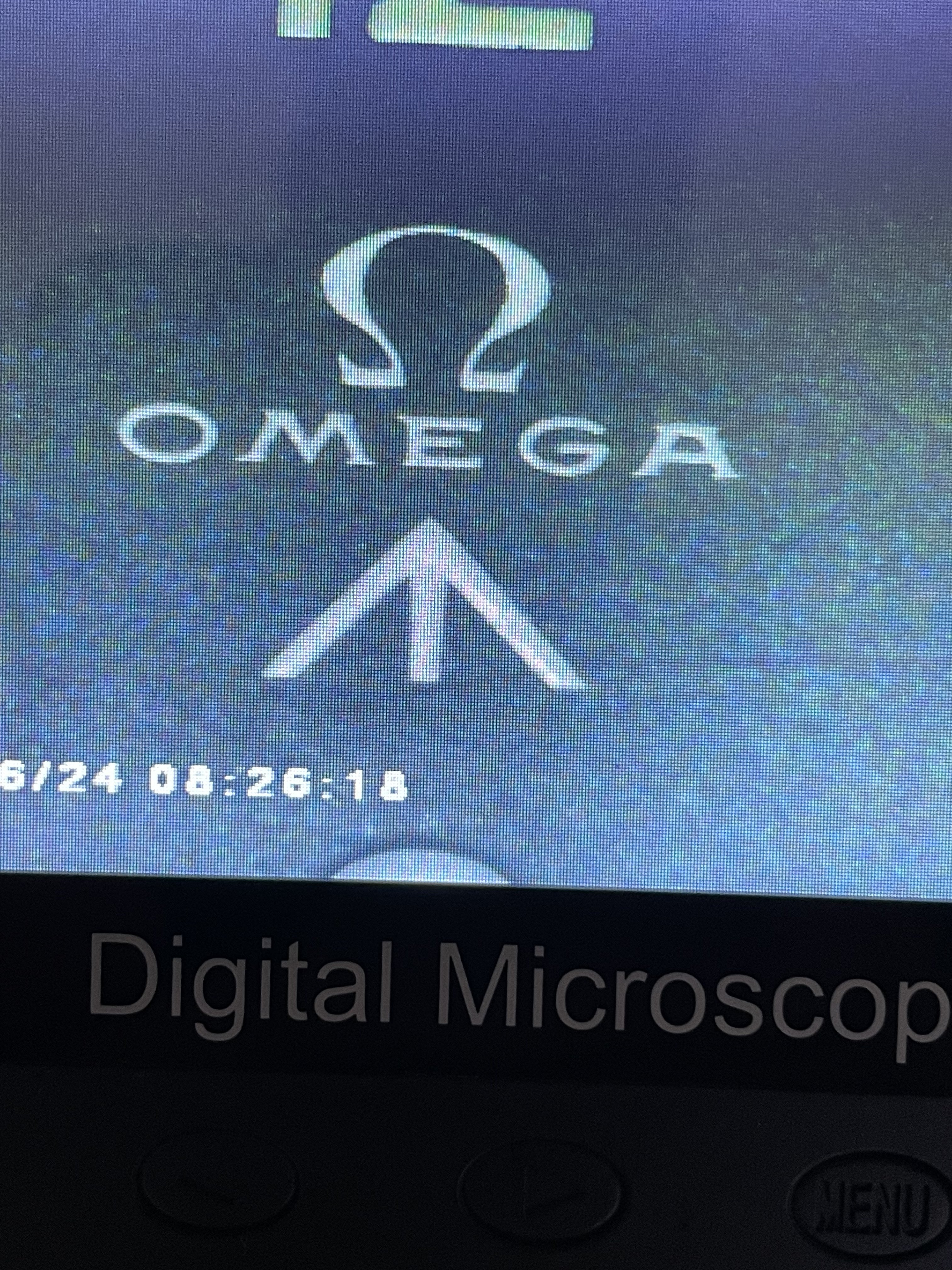

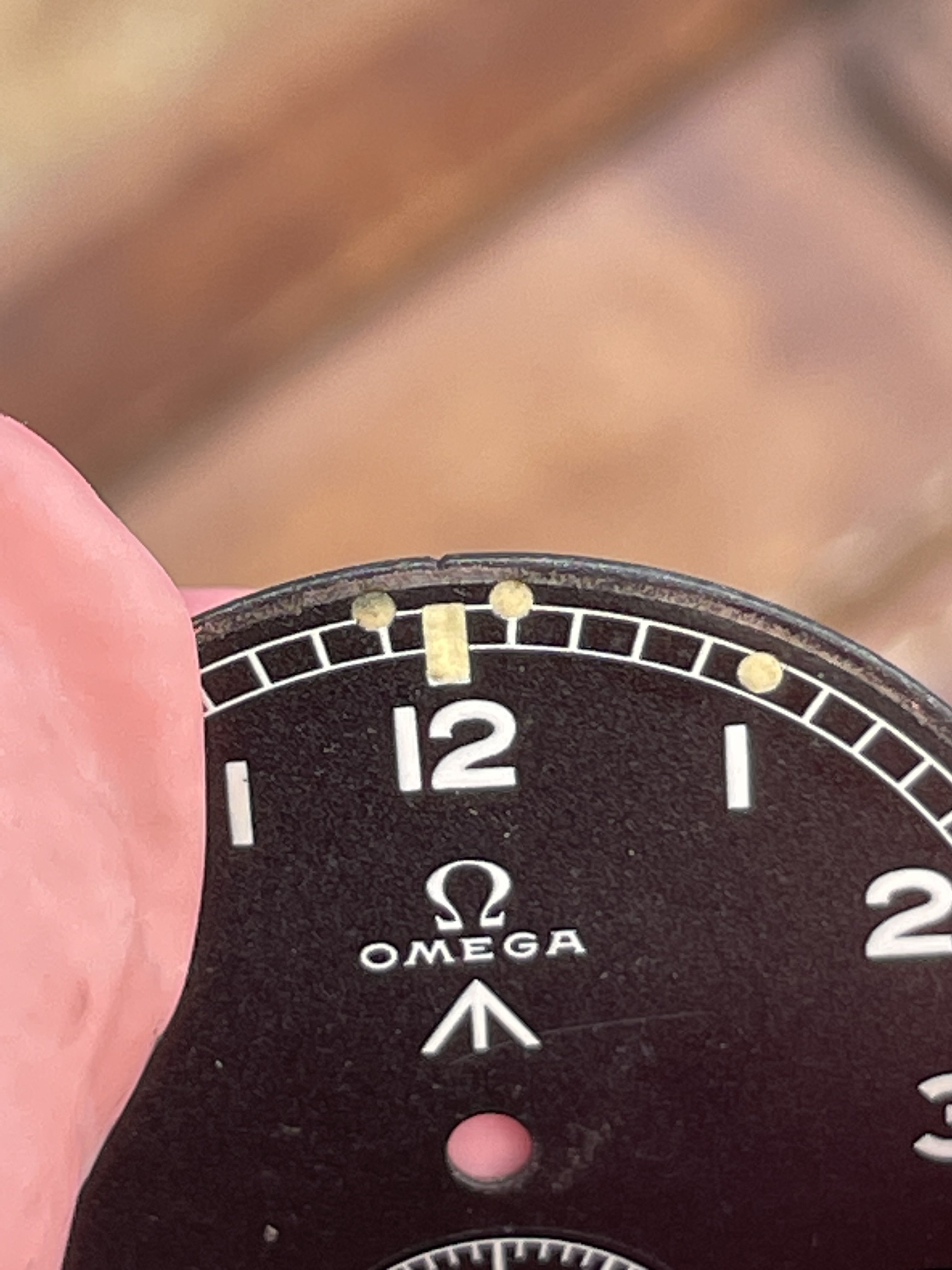

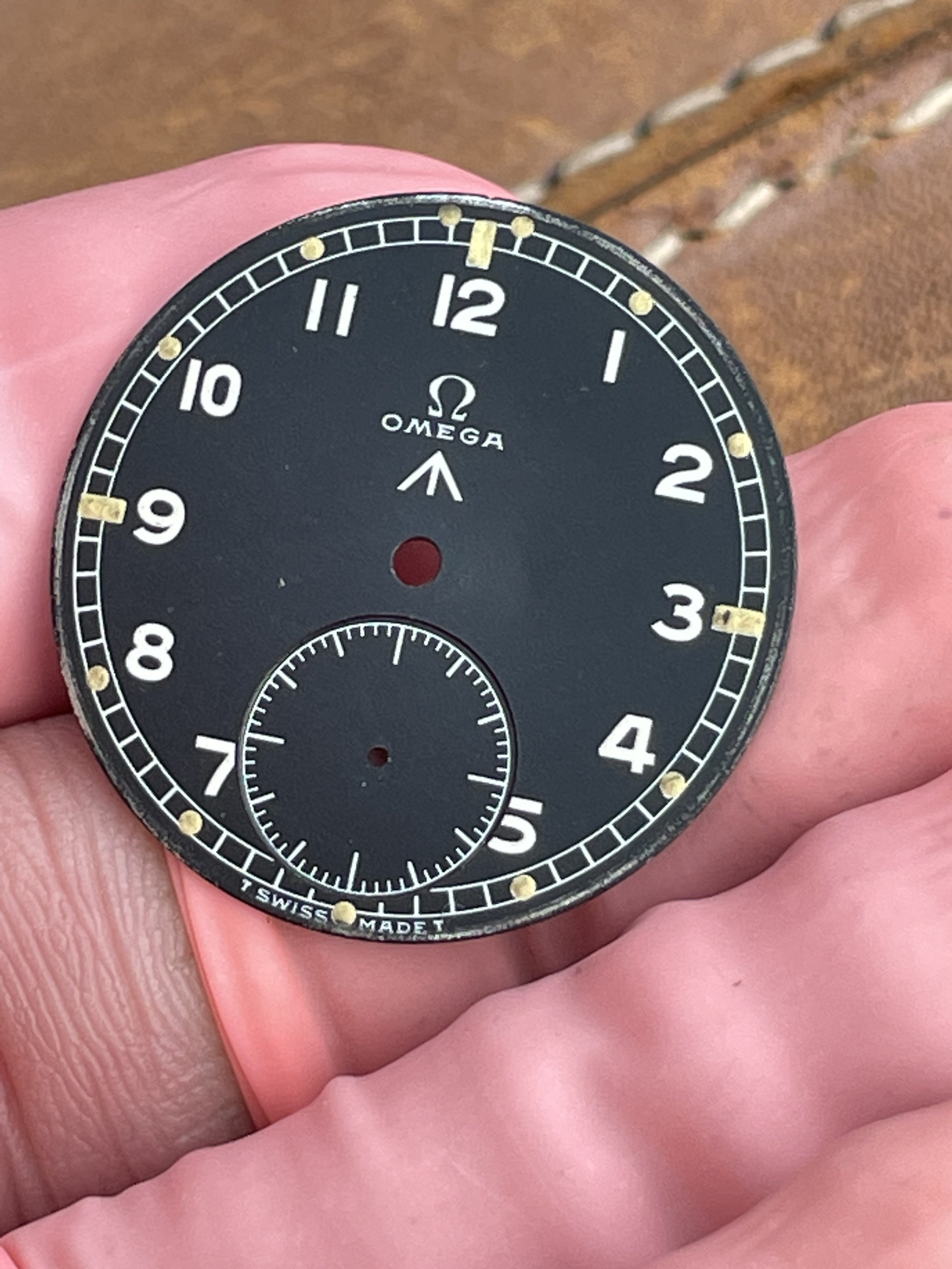

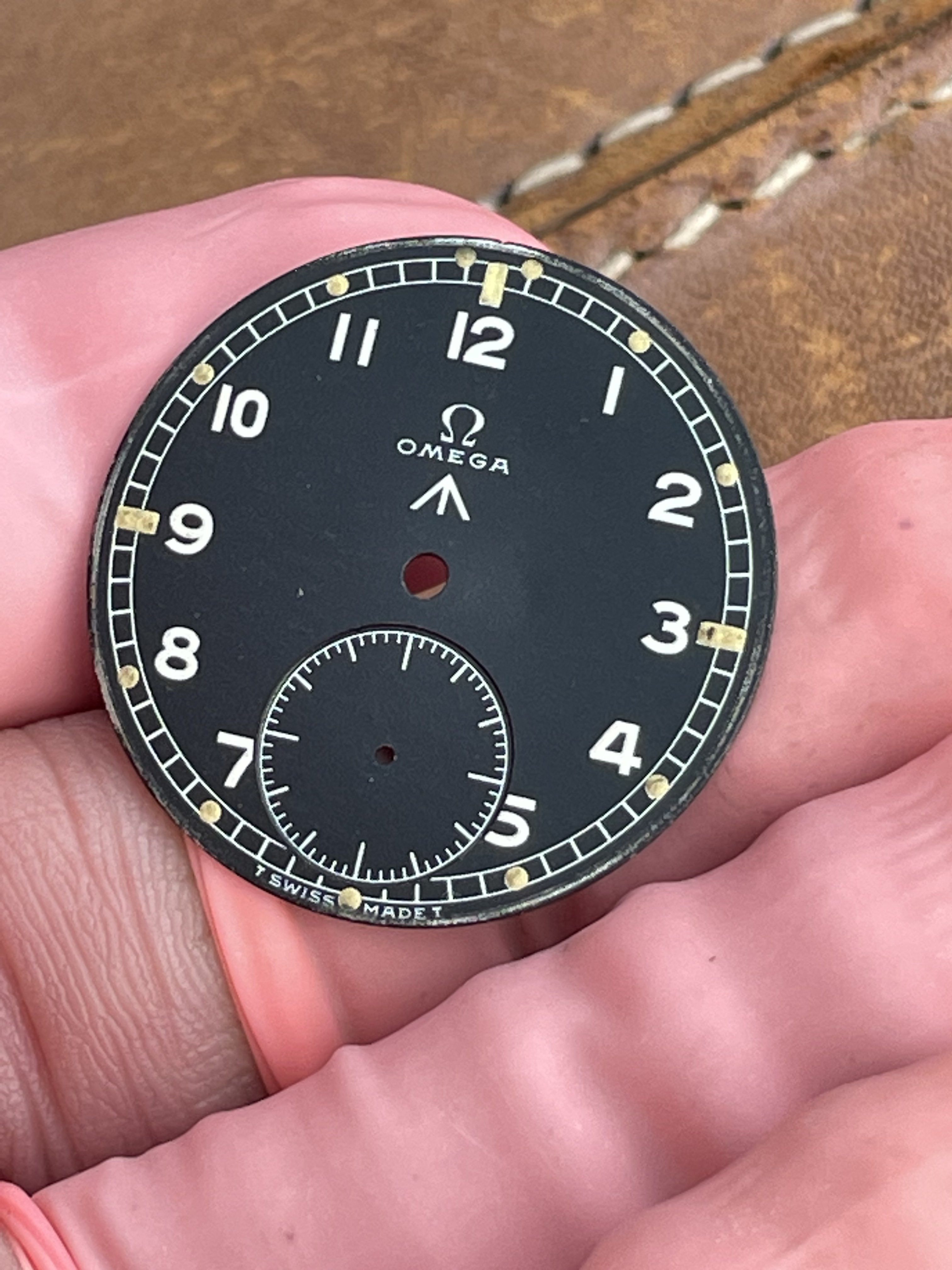

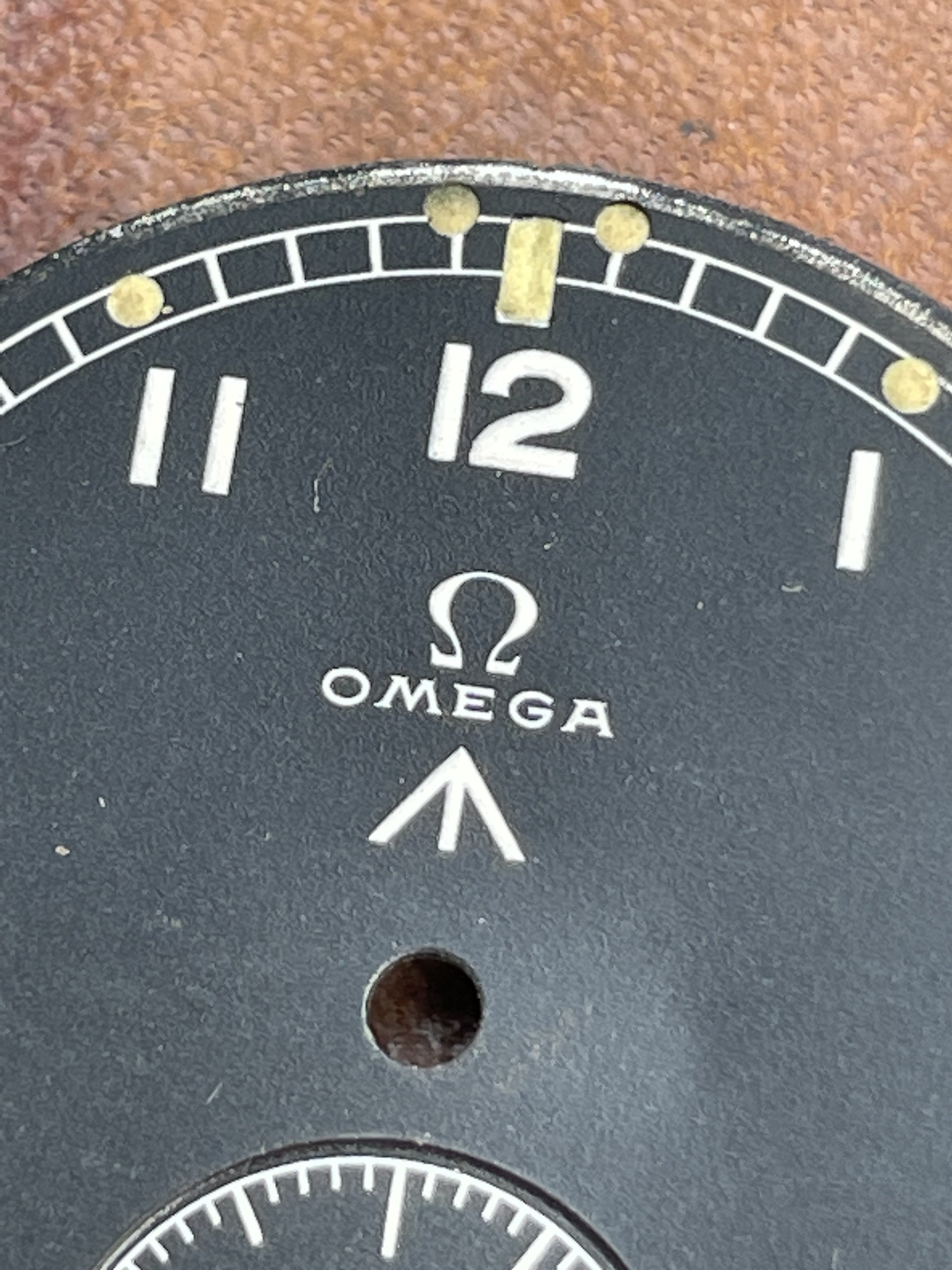

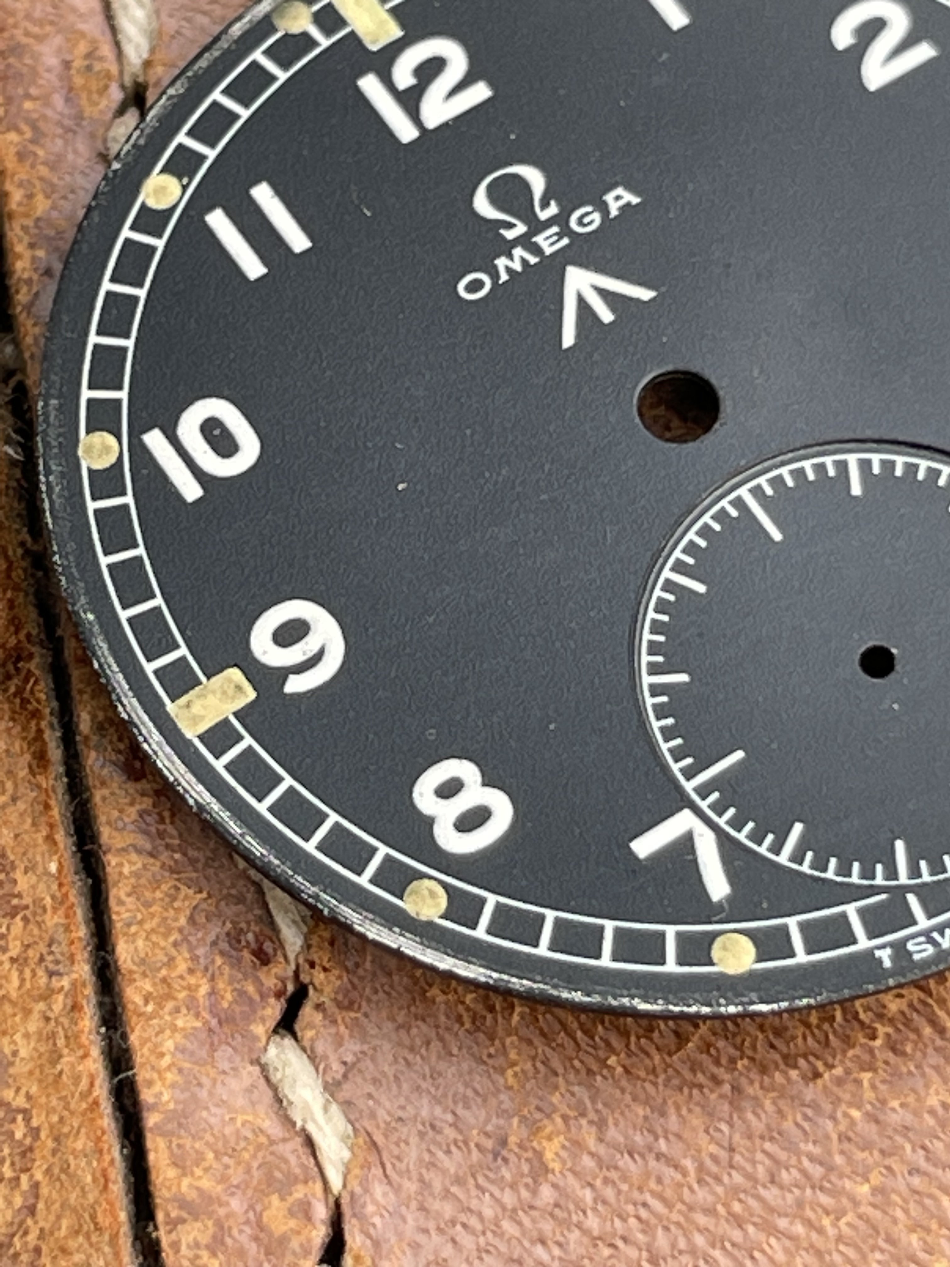

Don`t need MWR for these . Dial is 100% Original. The notch at 12 was for the adding of the 2 x T`s right and left of the Swiss Made.
BTW: very nice hand relume job , michael ! And I have absolutely No Idea , what caused the Fungus to grow on the whatever Lume material , that replaced the Radium....

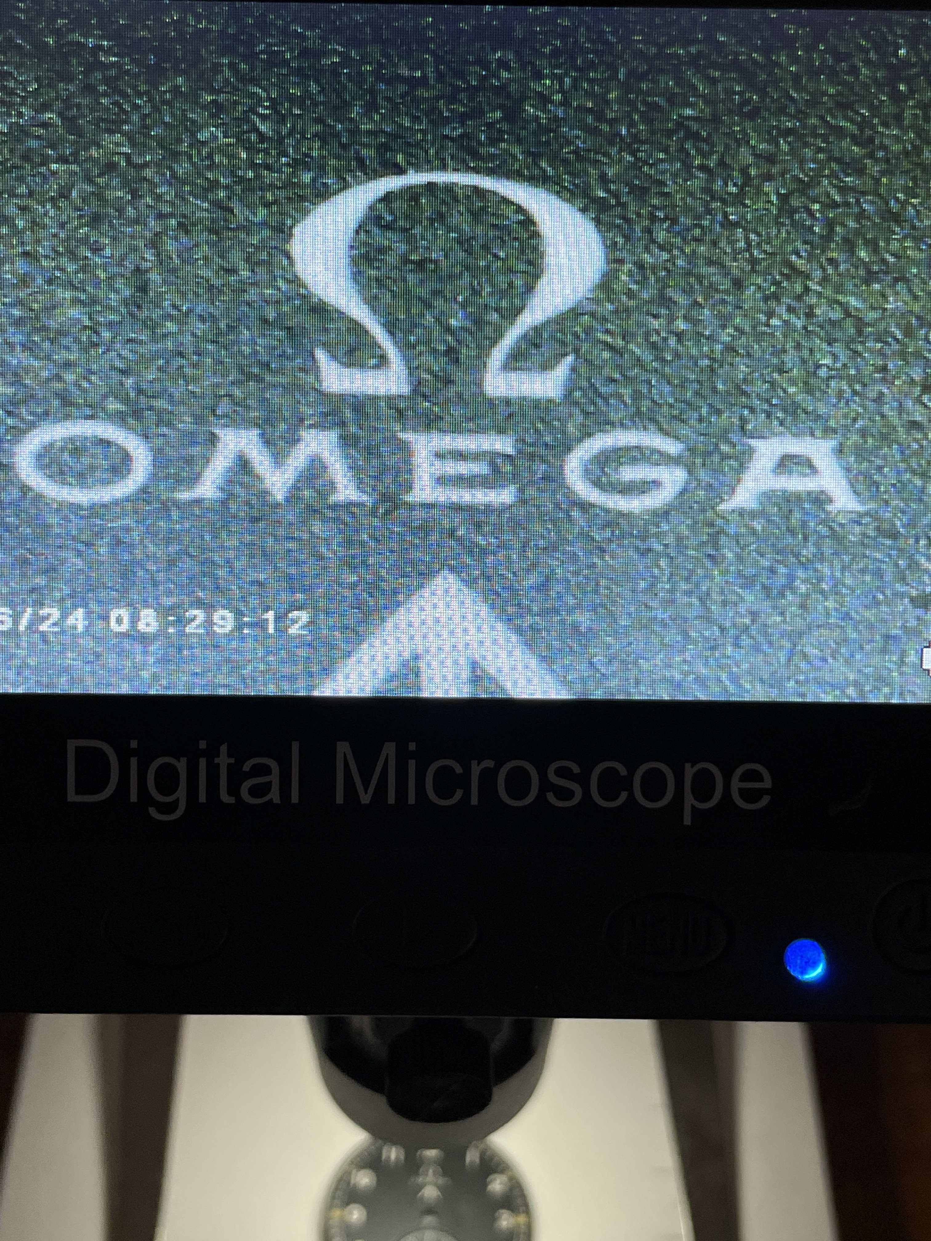

As for the OP's question on the 'furry' -- I believe this is 'metal whiskering.'
https://en.wikipedia.org/wiki/Whisker_(metallurgy)
Silver, tin, etc. can grow this way, though usually in presence of an electric field.
and Zinc as far as I understand? Zinc Sulfid is the main ingredient of lume colors. Makes totally sense, thanks for sharing!
