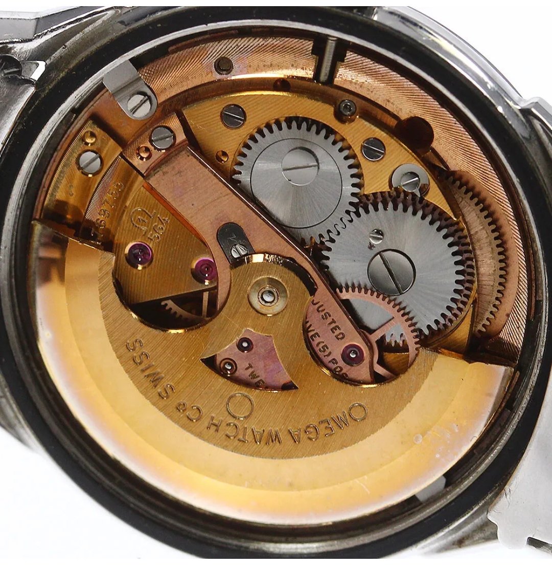

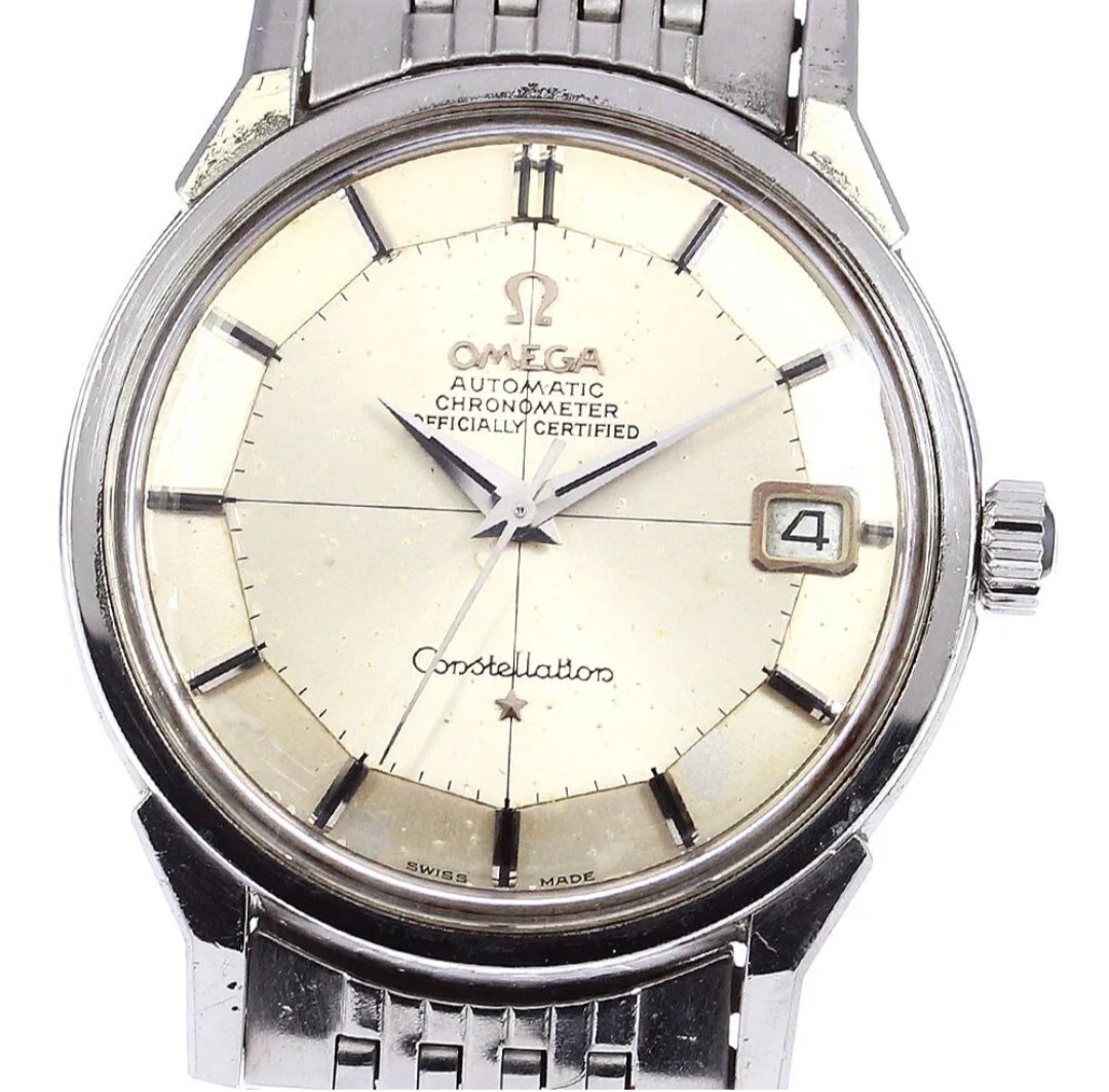

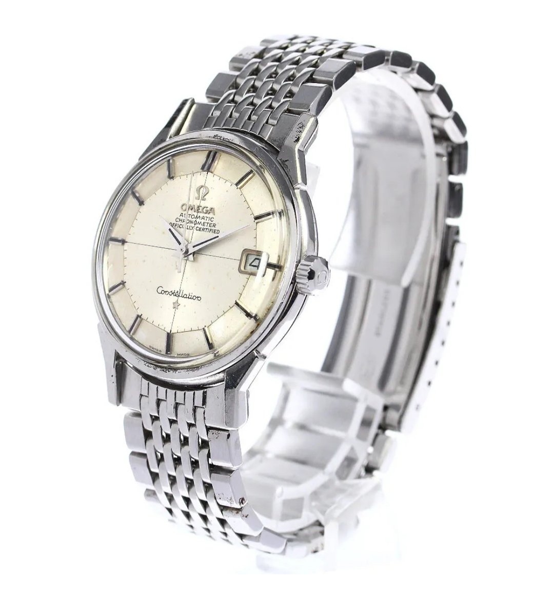

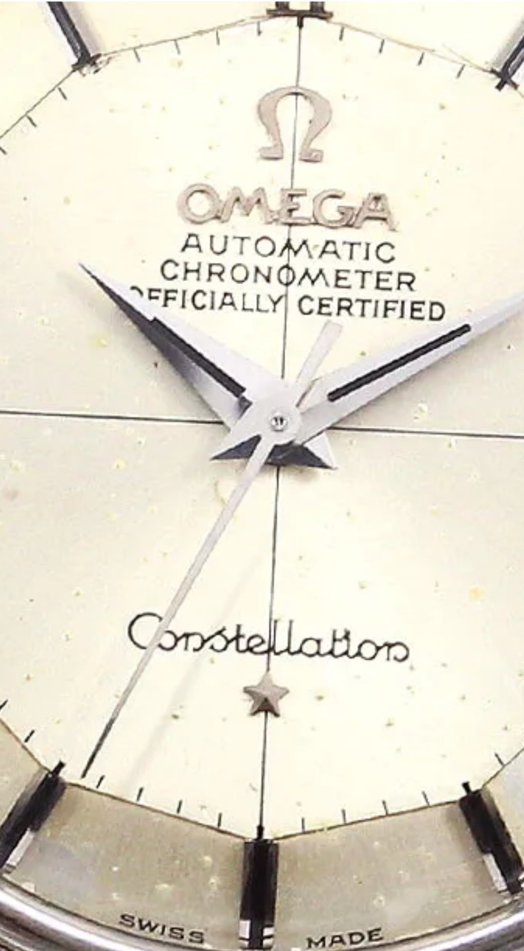

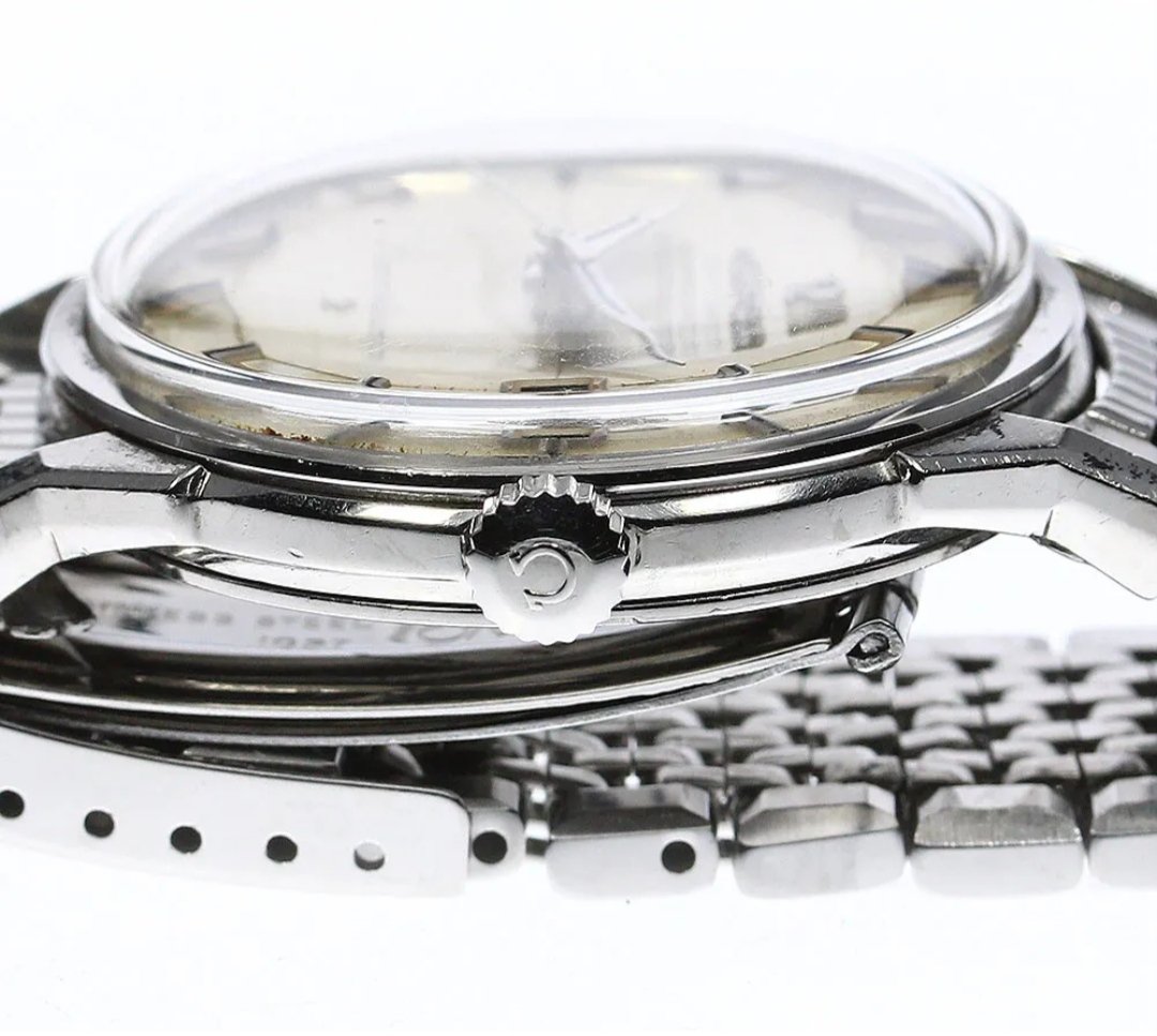

Hi everyone, I would like your opinion on this Omega Constellation Pie Pan, do you think it's all original? The crown doesn't look right. Do you think the dial and caliber are original? Is the bracelet correct? Thank you
500
966
The movement and dial seem correct, the crown has been replaced and a new hexagonal crown has to be sourced. The bracelet might be adapted from another model, I can’t tell for sure.

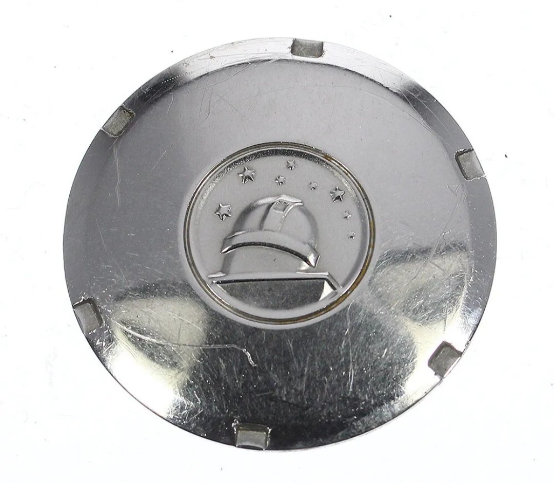

I agree with this assessment. I also don't see the Omega sign on the crystal so I'm assuming it's a replacement crystal as well. Pic below of the one I'm wearing today.

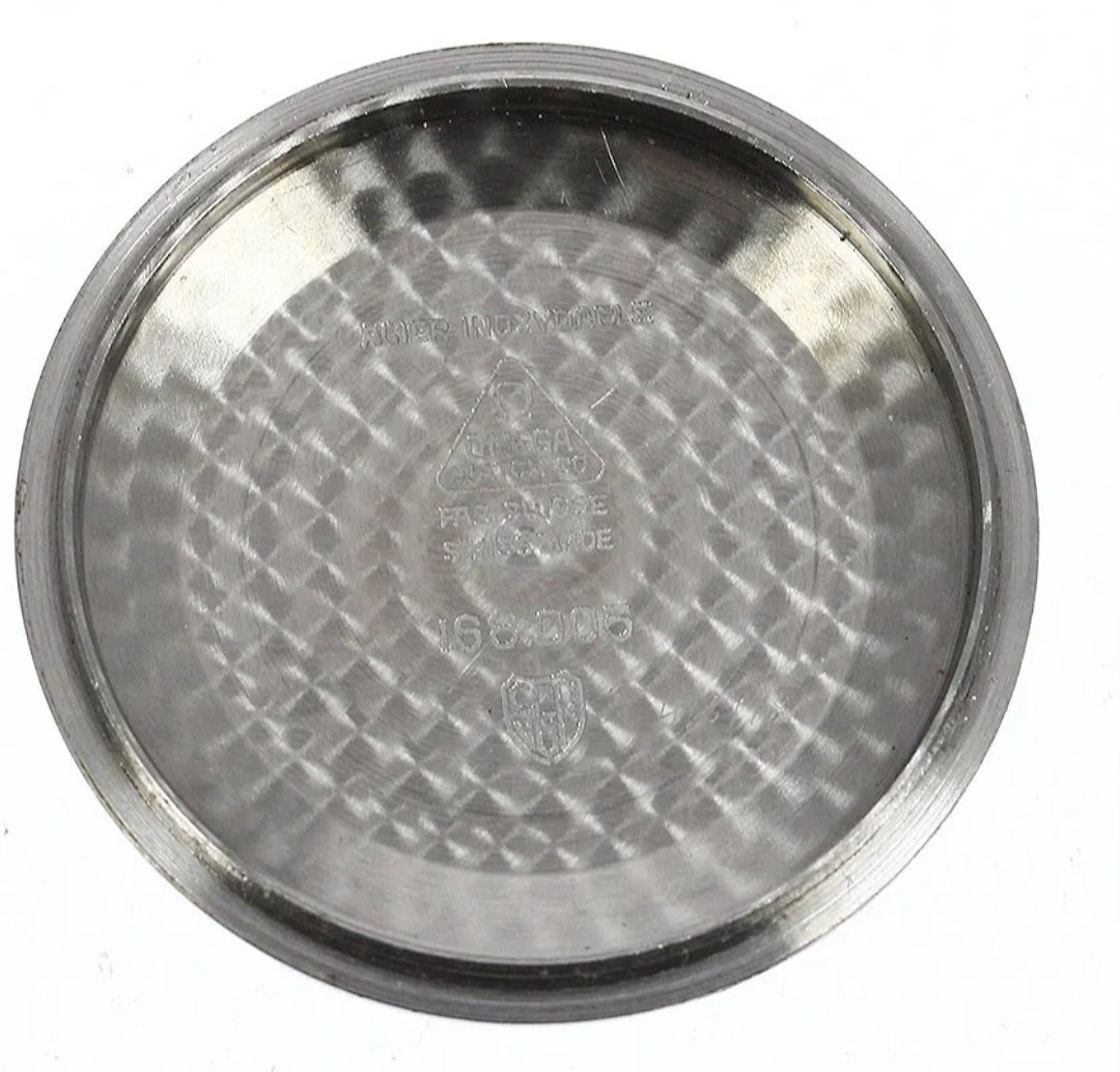

From the photo, I'm assuming it's a Japanese seller (probably Closer). The dial has some spots but I like the watch once it's serviced and cleaned (it's filthy in the photos). The case back looks like it's been polished in the past but you can still see all the stars. Remember to factor in the import duties of you're buying.
Yes the seller is Closer, did you purchase from him? for customs duties and VAT I considered a price increase of 30%, is this OK? What would its value be including duties? thank you very much

Thanks everyone for the replies, what do you think its value would be? Thank you

This seller is large volume seller with a generally good reputation from OF buyers
The watch seems ok but there are dial issues with spotting and yellowing which are not bad, but noticeable. Case has evidence of polishing again not bad

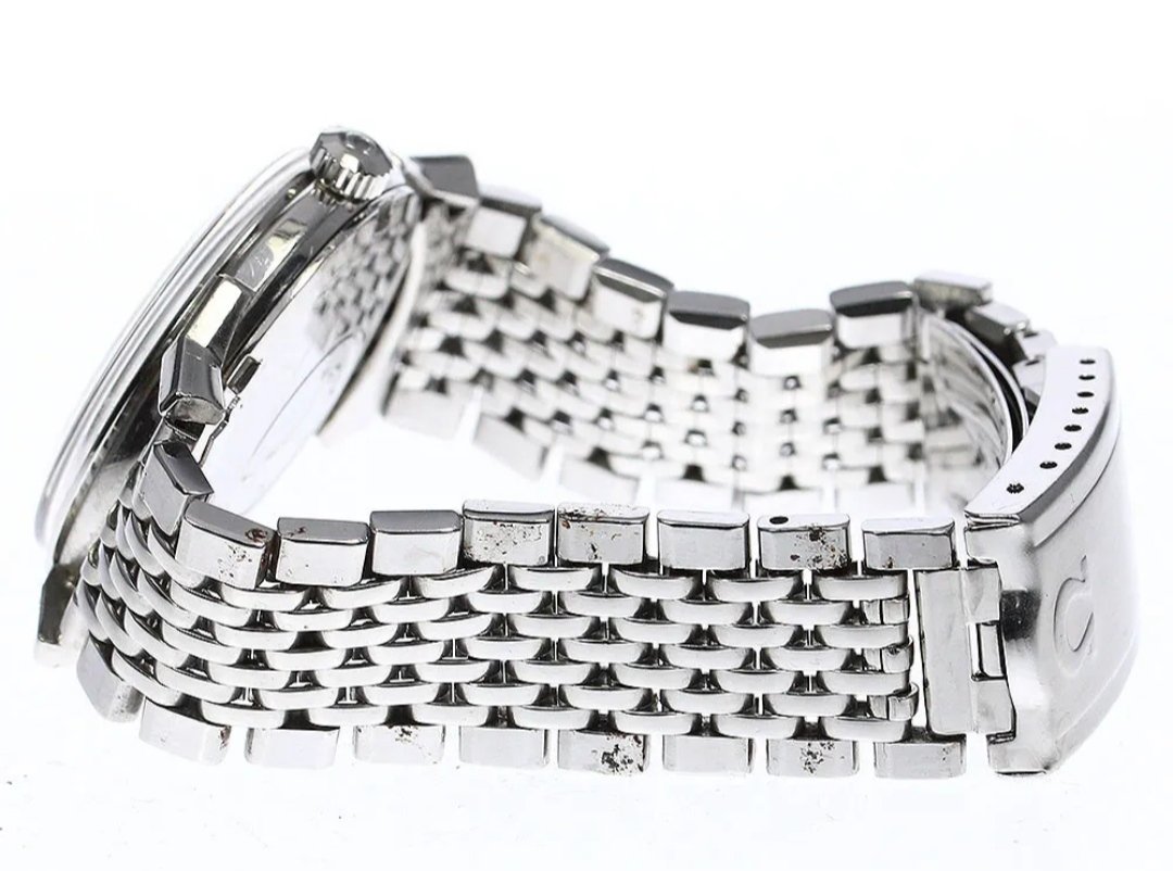

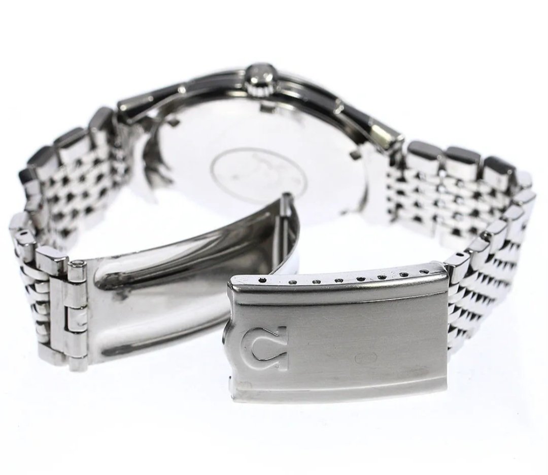

Bracelet may well be correct but can’t see numbers on clasp or endlinks. Quite dirty but should clean up.
I would say fair price for average example but when add import fees to me it would be too much. See what others think.

Is that pitting on the case and bracelet? I'd probably hold on for a better example.
