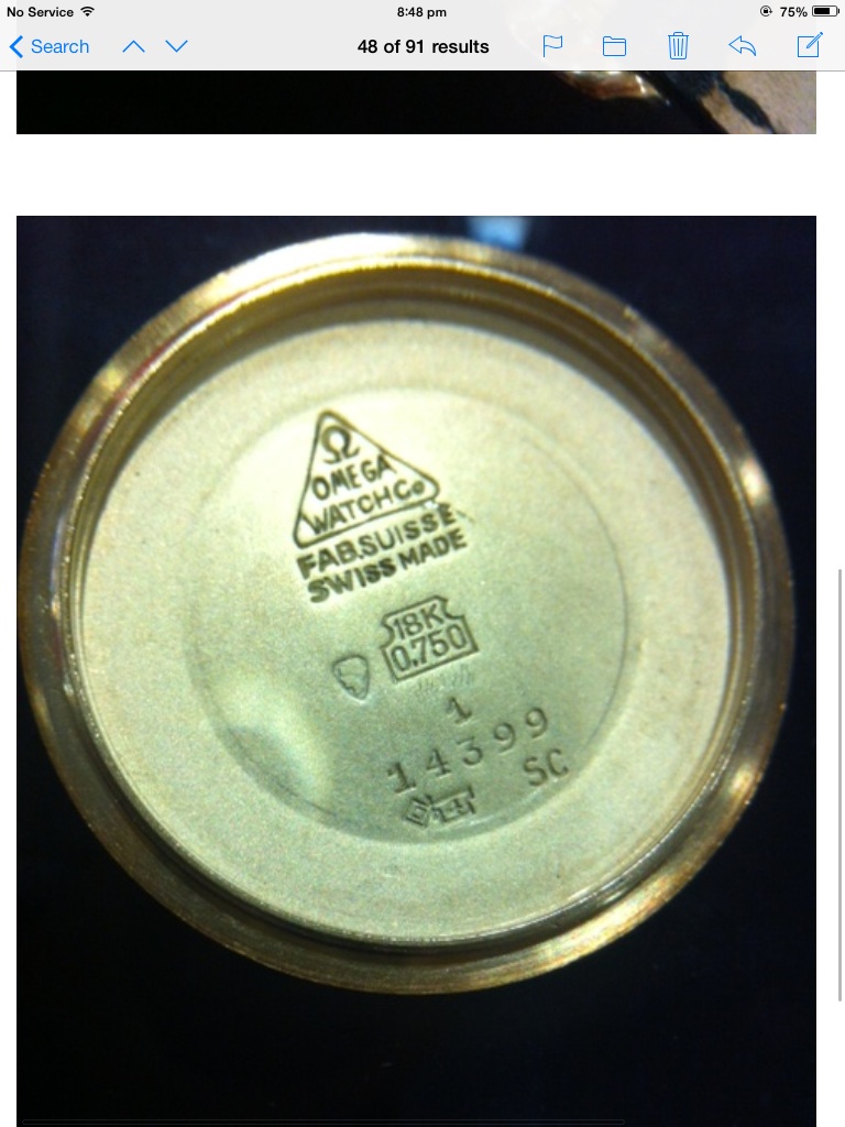

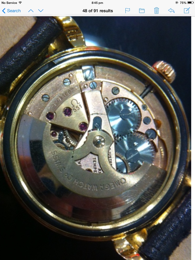

Hi,
Did Omega produced an Omega Constellation Pie Pan 18KT Gold model, Ref. 14399 SC with caliber 551 movement and hooded lugs?
I also wish to know that is it normal NOT to find the Serial number of an Omega Constellation on the underside of the case-back cover?
Please comment. Thanks!
33,531
38,207
Can you post some pics? The serials are on the movement, not inside the caseback, only the reference number and in some very early models the case number is on the caseback.
That ref is a Grand Luxe but do be careful though as there are fakes around, and having a real 551 movement in it doesn't make it real.

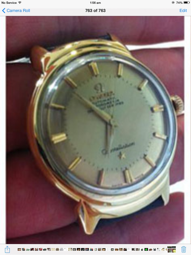

That watch has had it, its just so badly polished down that all of its edges, detail and facets on the lugs are gone, dial looks like its been refinished as well. It was a nice watch once upon a time but there's nothing left that's worth owning.
