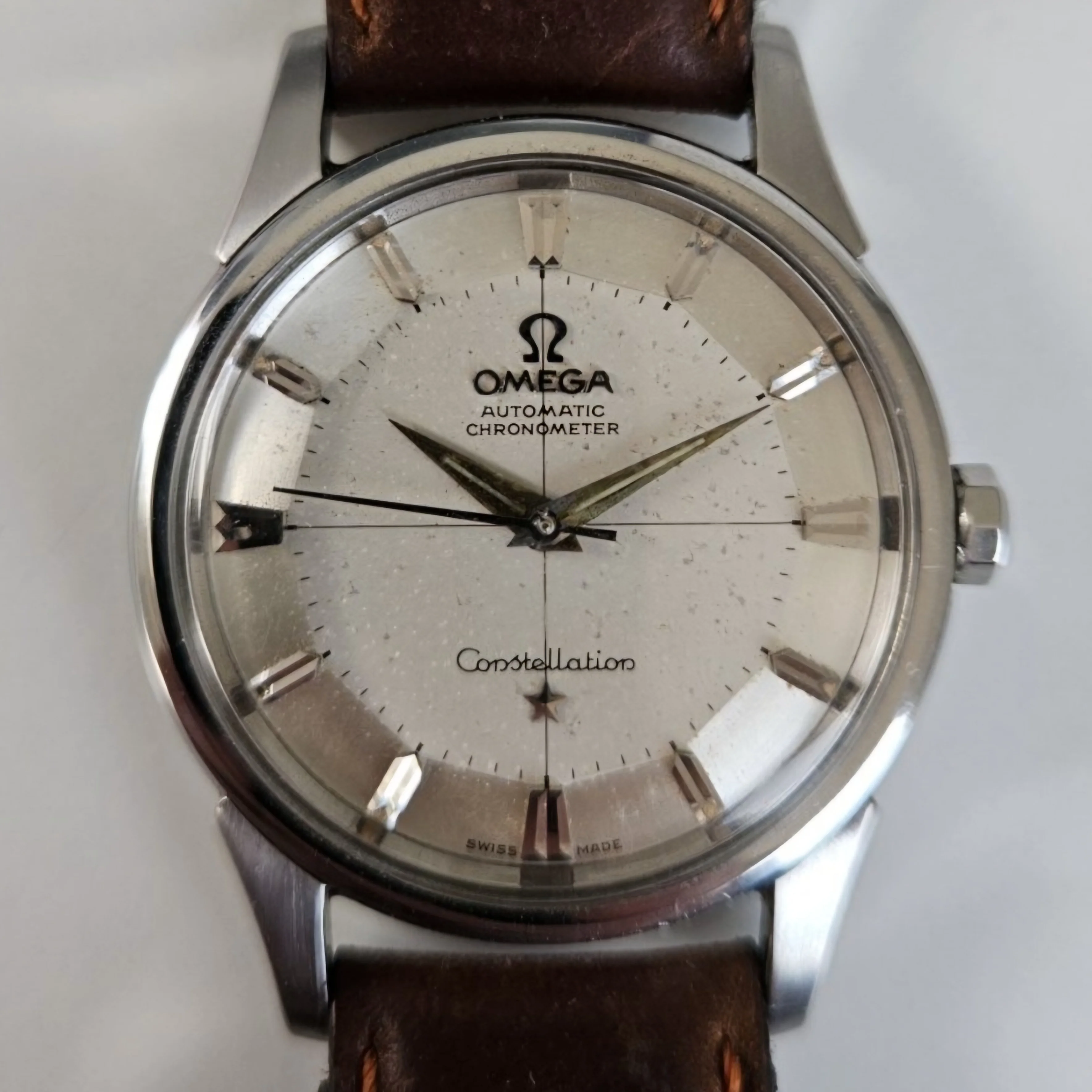

Dear Forum Members,
I am casually looking for a pie pan Constellation and found this ref. 14381.
I would appreciate if you could help me with the following:
  • dial authenticity and originality?
  • reference correct hands and crown?

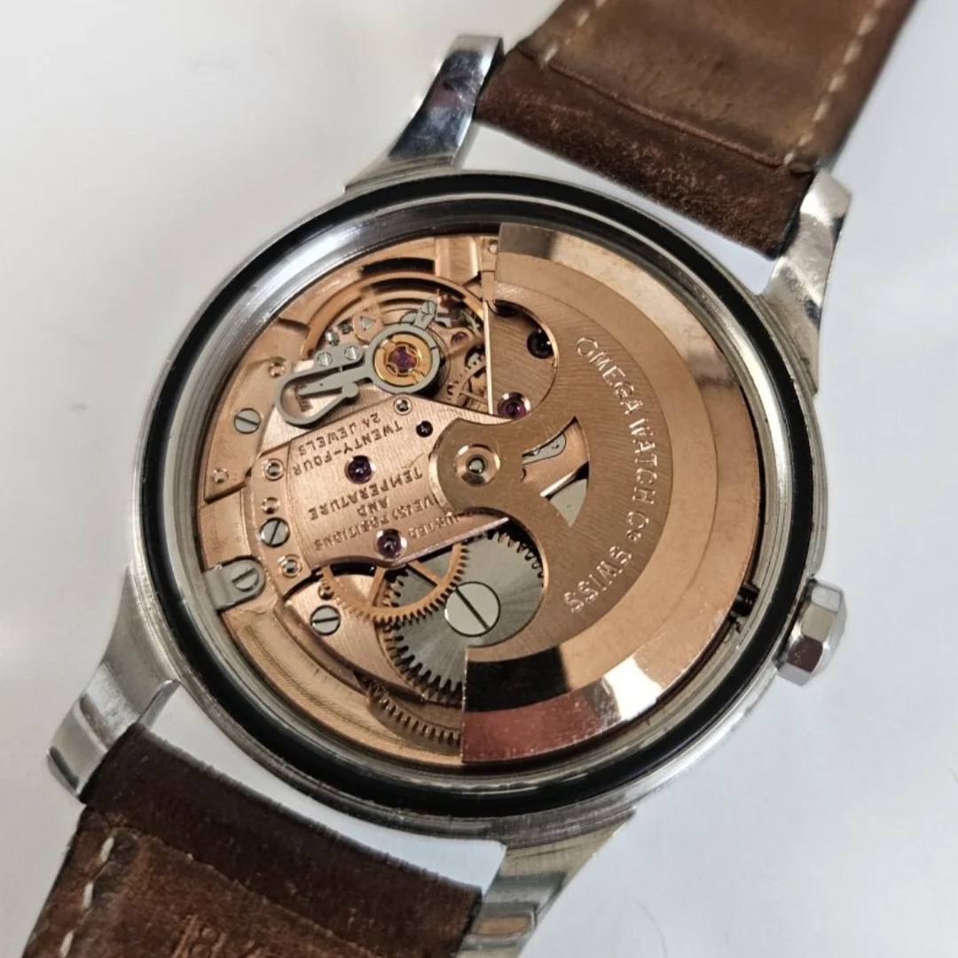

  • any obvious issues with the movement?
Thank you already in advance.
8,174
36,709
The dial is correct. The seconds hand looks too long to me. it looks like a longer hand for a non-piepan that's been shortened. The movement looks correct but I can't say more than that.
24,836
55,255
I'm not sure it's an Omega sweep hand. 14381 is a nice reference. As long as the price reflects the condition, you would probably find a correct sweep hand.

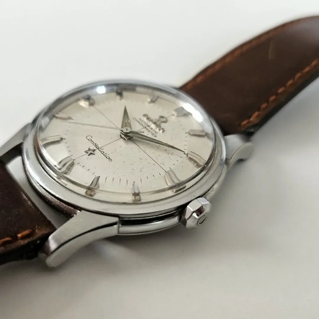

Need to see a side photo, but I suspect the crown is a later replacement and probably aftermarket.
79
169
Thanks for the replies so far.
Here from the side:
The seller mentions originality of hands and crown.
