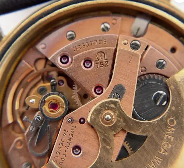

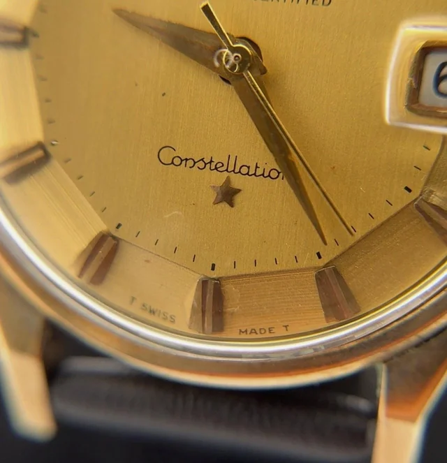

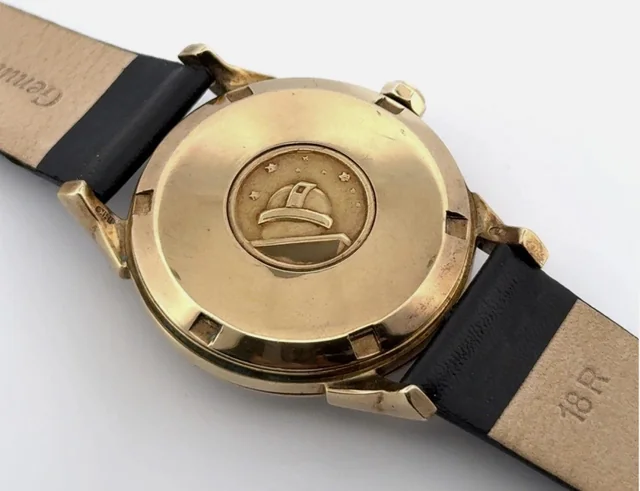

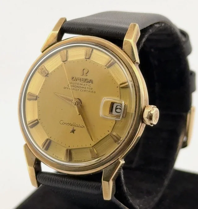

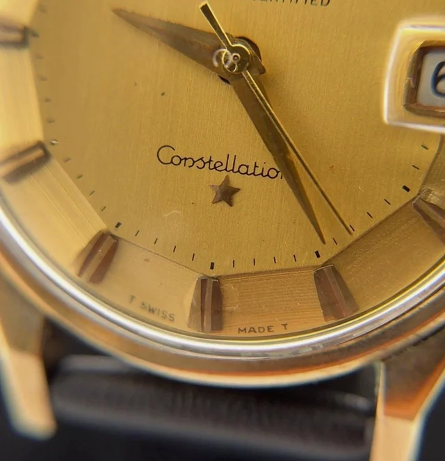

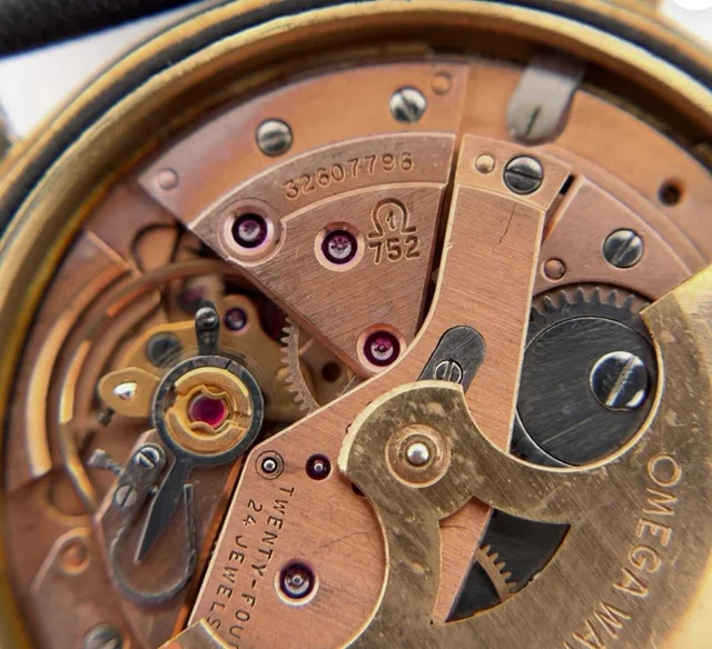

Ts on the dial but no tritium, Cal 752 which is a Day-Date calibre and non-chronometer in what should be a chronometer rated watch, all very wrong.
6,380
9,872
What he said ^
Plus

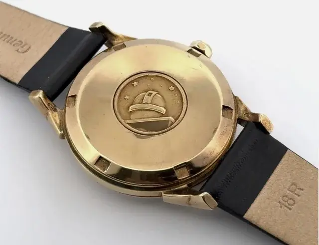

No brickwork on the observatory.

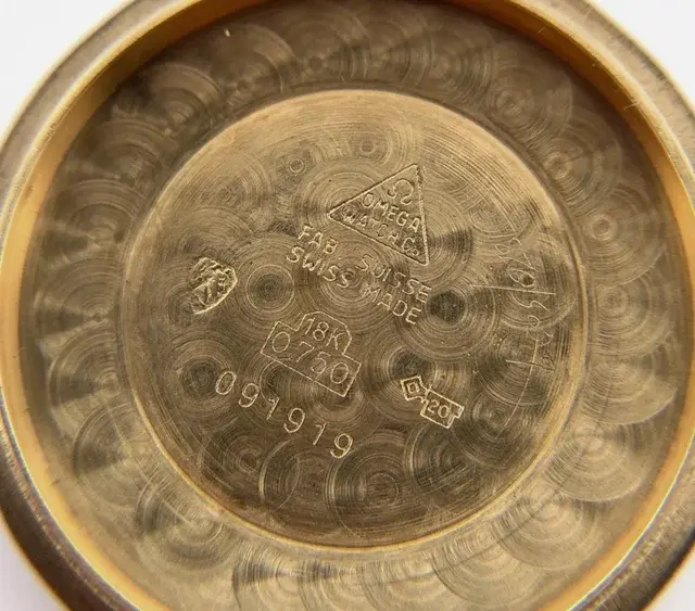

Perlaging inside the caseback.
That odd 091919 reference.
No side facets on the lugs.
Peculiar striations on the dial facets.
As fake as it gets.
Good job you asked @omegaguy123 👍

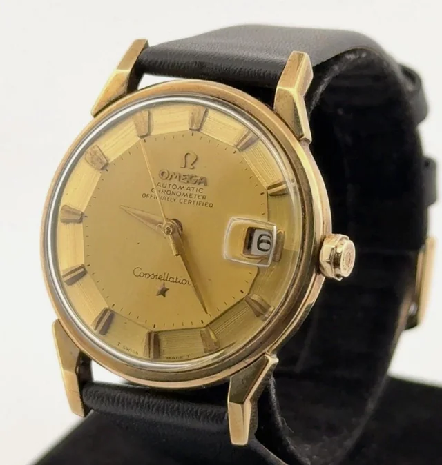

One more question, I found a Constellation with same reference/cal. from a fairly reputable watch company.
Thoughts?

The question really should be - who says they are reputable?
They can’t be that reputable if they are selling fake watches.
- and you could say anyone can make a mistake but this seller has called itself vintage gold watches.
This watch is from the same stable as the one you first posted.
Classic fake dial (just look at the script)
Classic fake case.
Mismatched movt.
Same unknown case reference.
