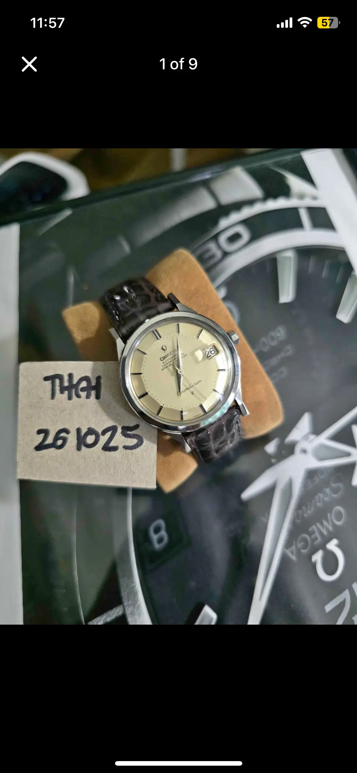

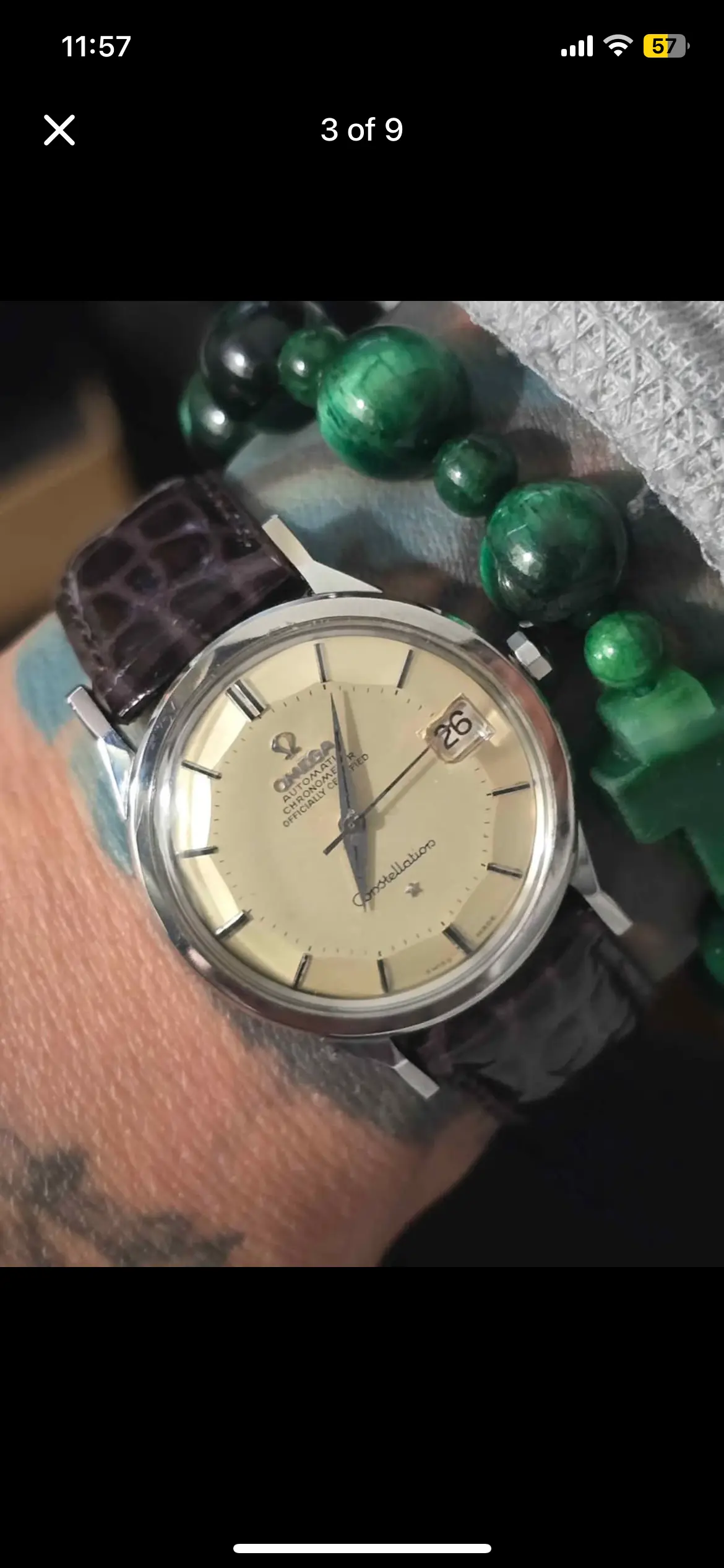

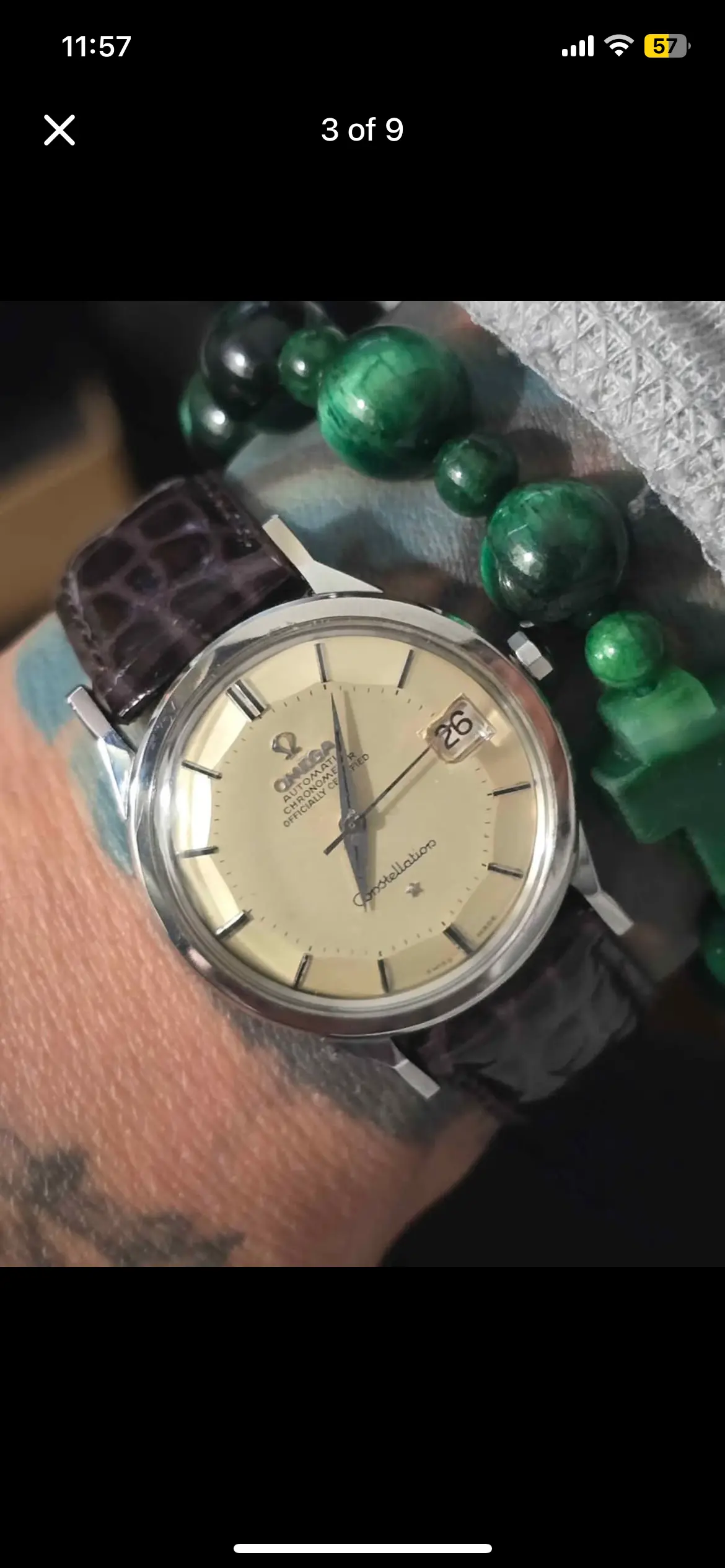

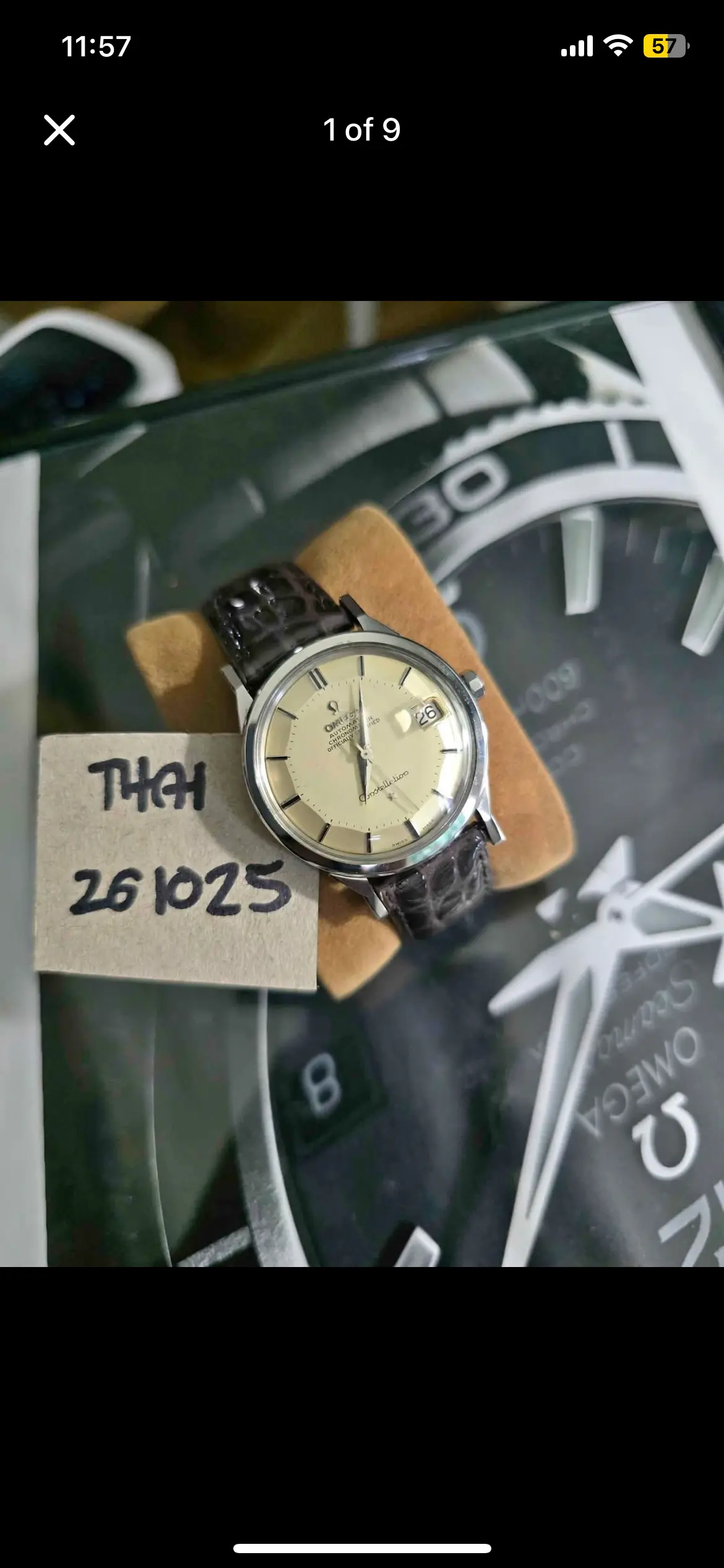

Hi guys looking to purchase this constellation 168.005.
Just wanted to check because most of these I’ve seen don’t have cyclop but this watch does but it does have a signed omega crystal. Far as I heard apparently some come with cyclops as an option?
It’s for sale at $1750 aud just wondering if it all looks legit and if it’s a reasonable price

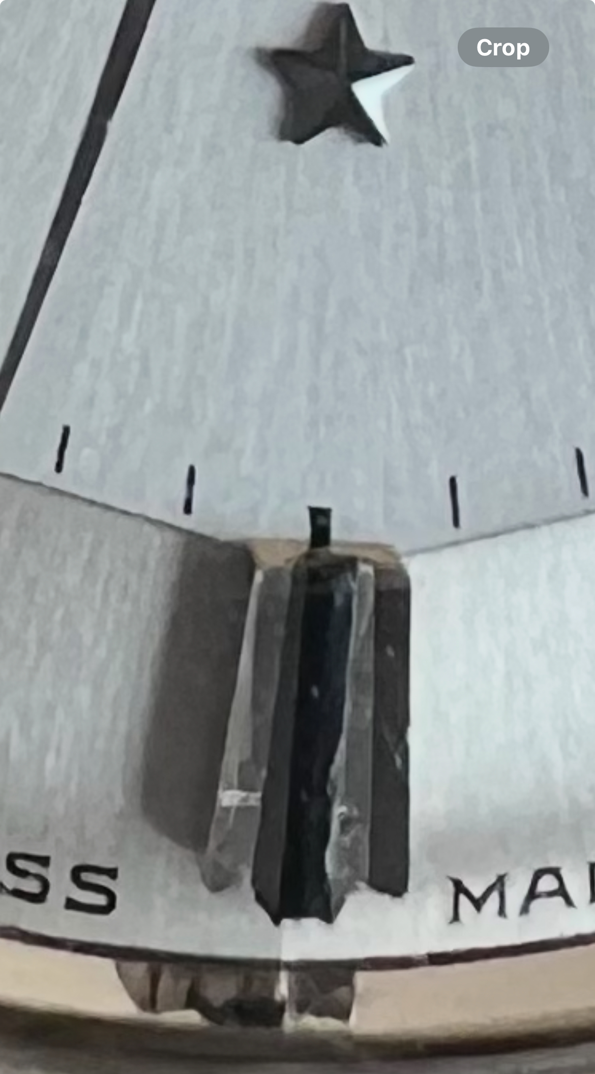

IMO it’s not the glass you should worry about, but the dial itself. Ask the seller for more high resolution photos so we can have a better look.
2,642
5,327

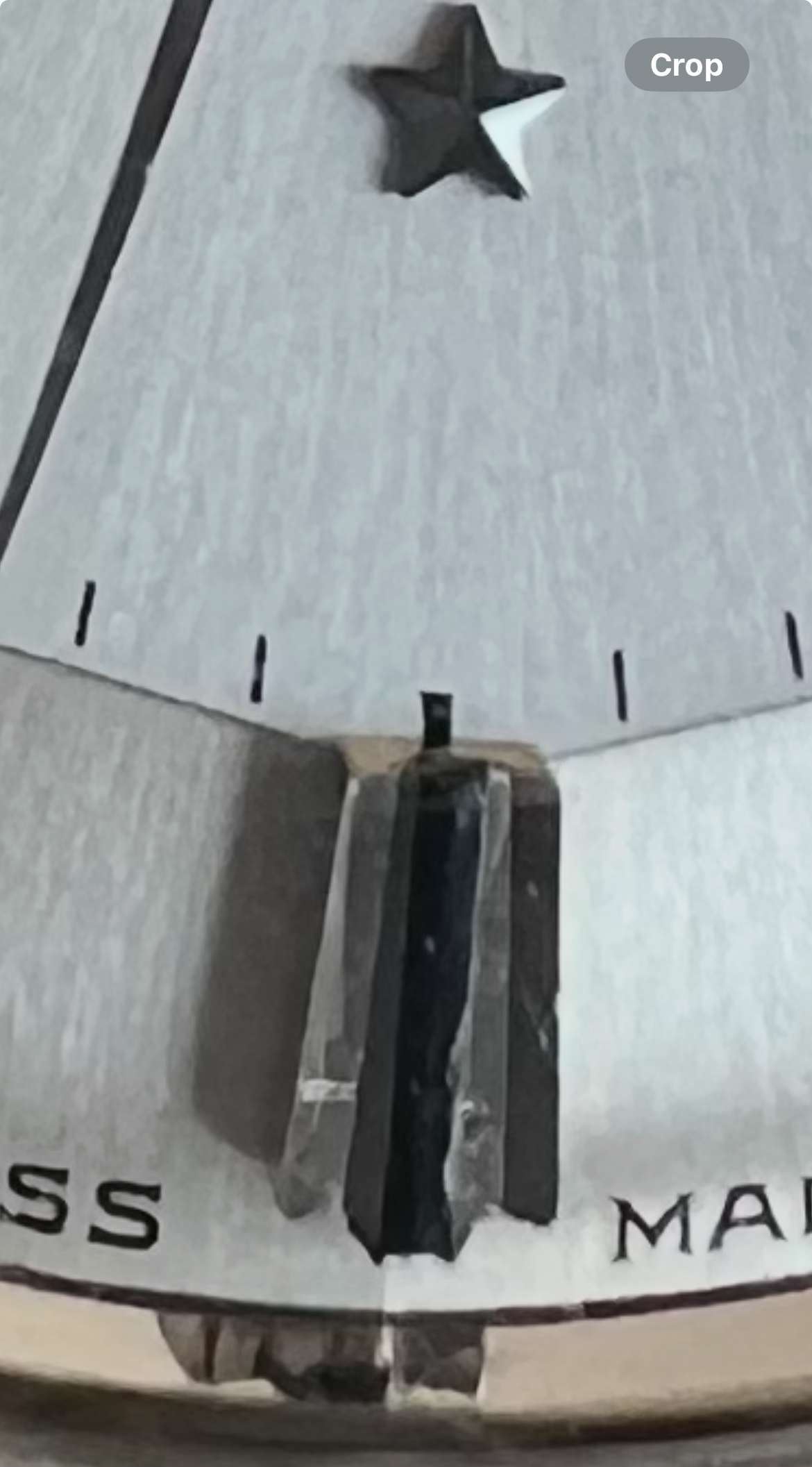

The marks on dial at the hour indices should touch the marker, be shorter than the minute markers, and have serif you can see on this photo. Also the minute markers should have a uniform proxicity to the dial edge, and should be uniform length and spaced evenly.
Need better focused photo of dial straight on to be sure, but looks to me there are issues on this watch. Need closeup photos of text with hands moved off text.
7
Thanks a lot guys looking at the photos the hour indices definitely don’t touch the markers and no serif as well. So this would be a redial then?
Thanks guys appreciate the help
2,642
5,327
Better quality photos needed to be sure, but that’s my impression. I would not buy it with info avail so far.
