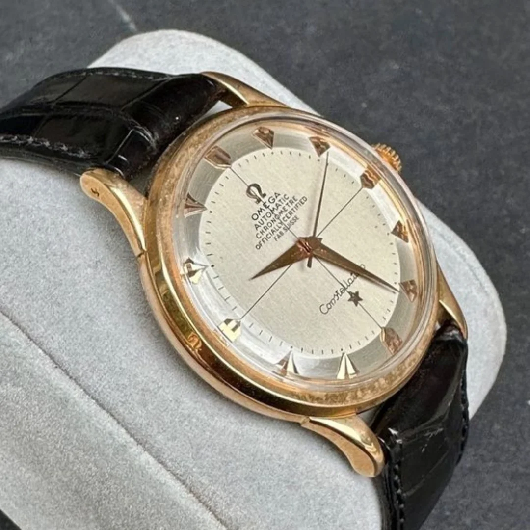

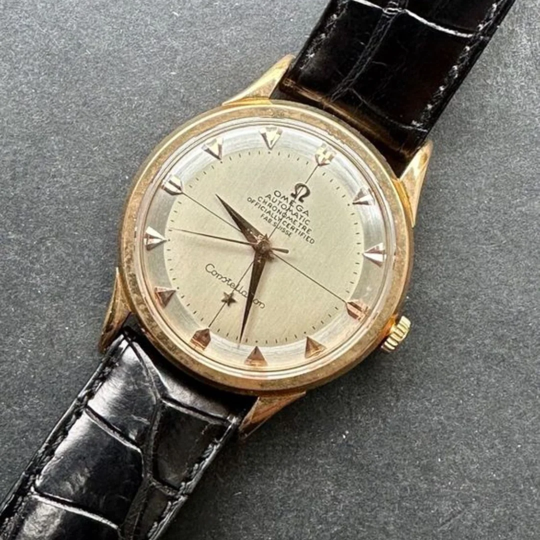

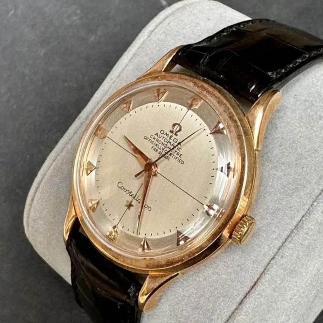

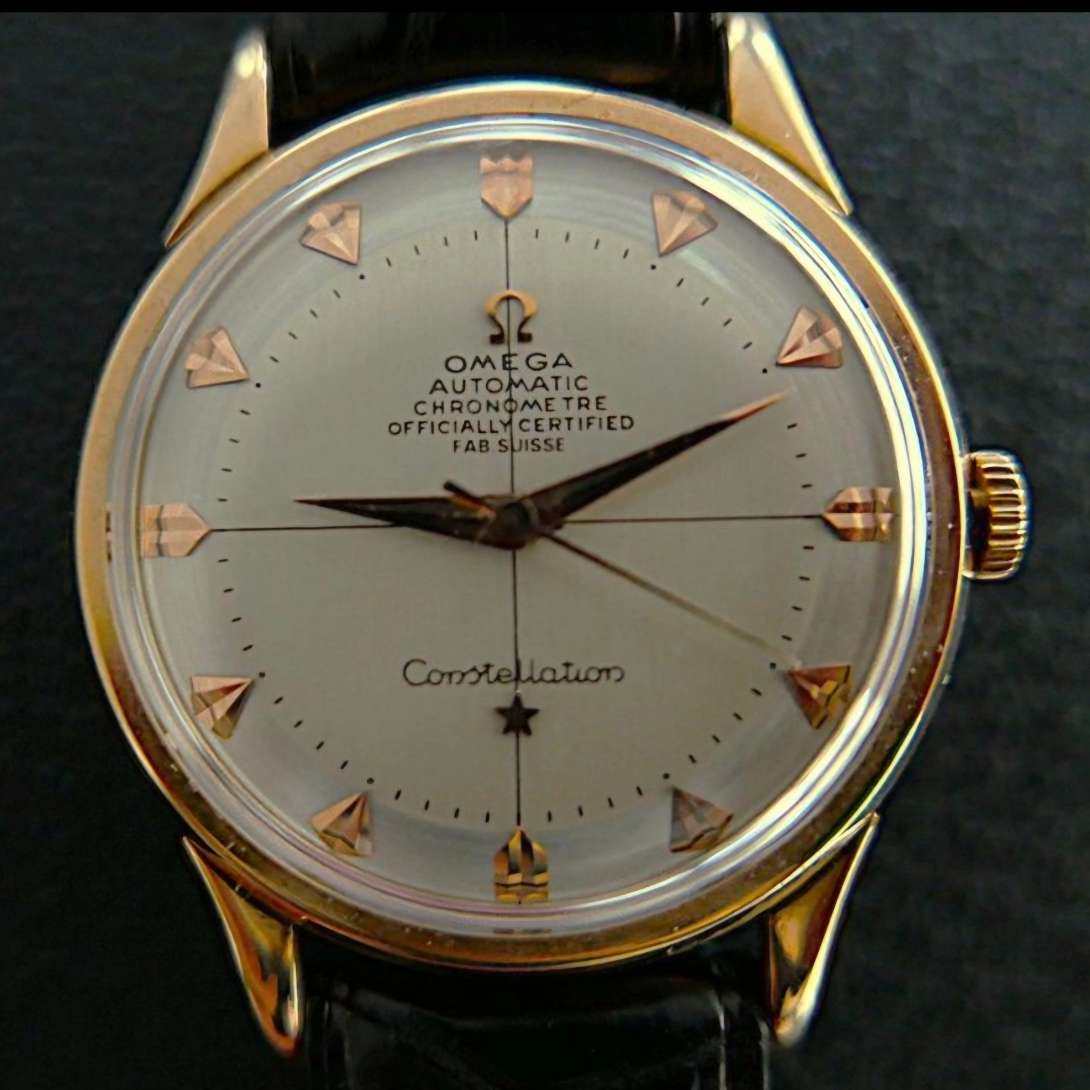

Dear OF members and Pie-Pan experts,
I am casually looking for a nice pie-pan Conny to add to my collection and came accross this watch. Do not want to argue about price etc, but some question marks arose. Here the data that was shared by the seller:
  • Ref 2648 from 1952
  • 18k Rose Gold
  • French case
  • original Omega crown
My questions:

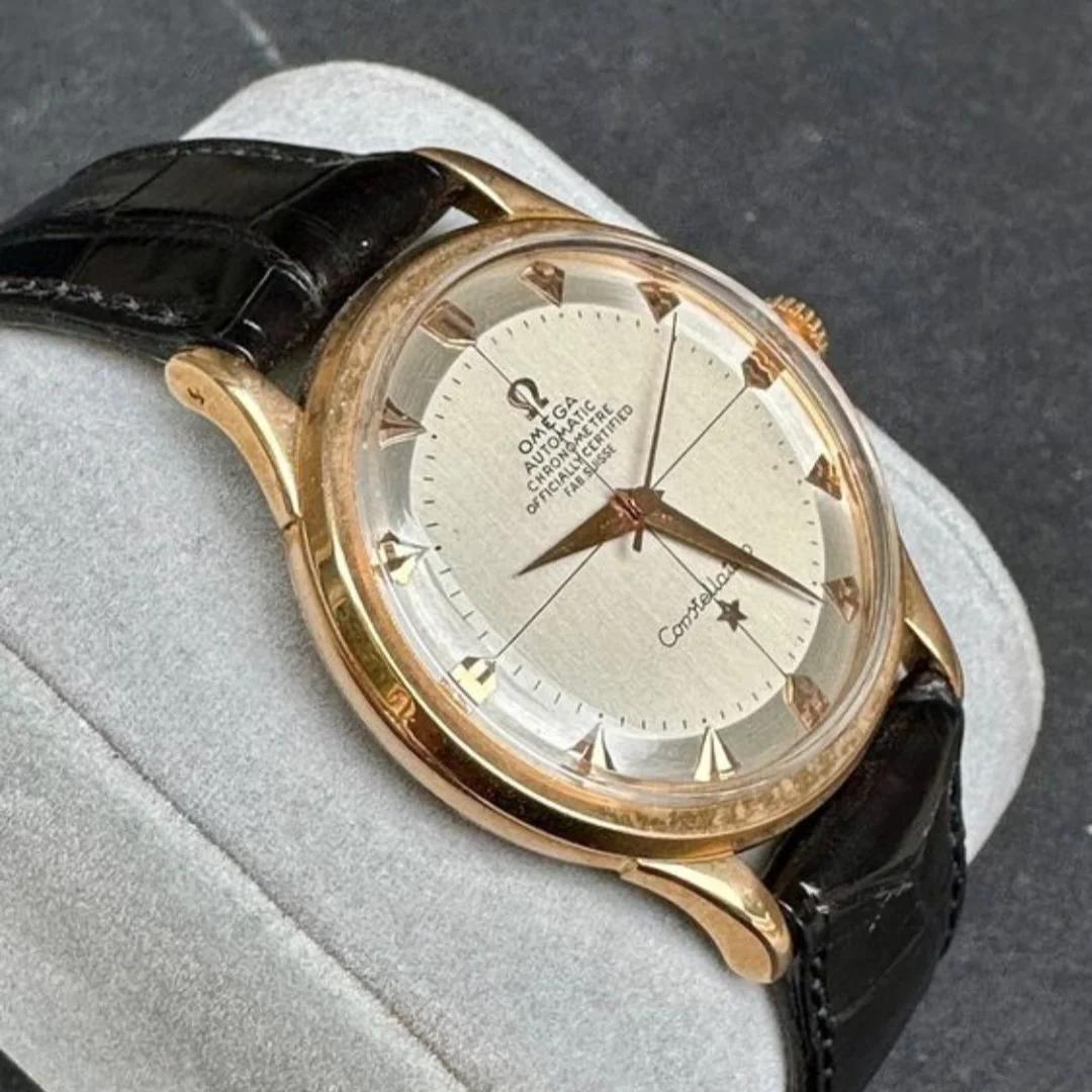

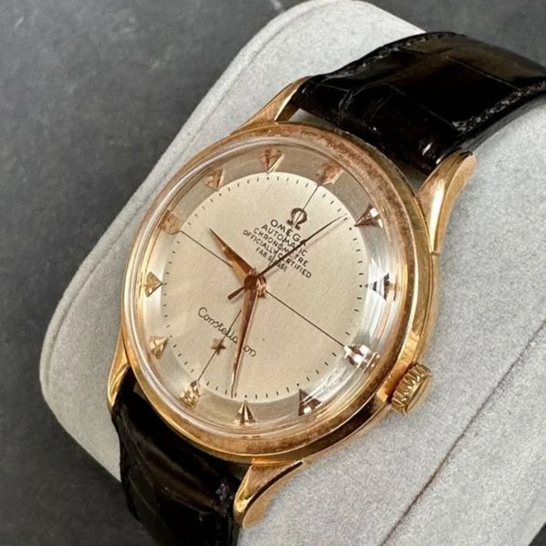

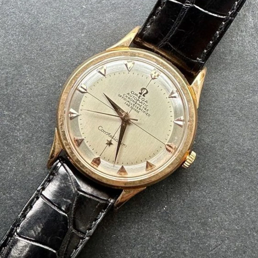

  • On the pics provided I cannot see an Omega sign on the crown, even though the seller mentions it was original. Is that possible or are maybe just the pics not clear enough?
  • dial origonality or is it a re-dial? the vertical line does not seem to cut the Omega logo in the middle but slighly further on the left side.

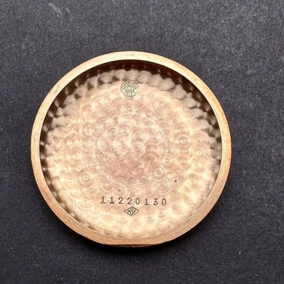

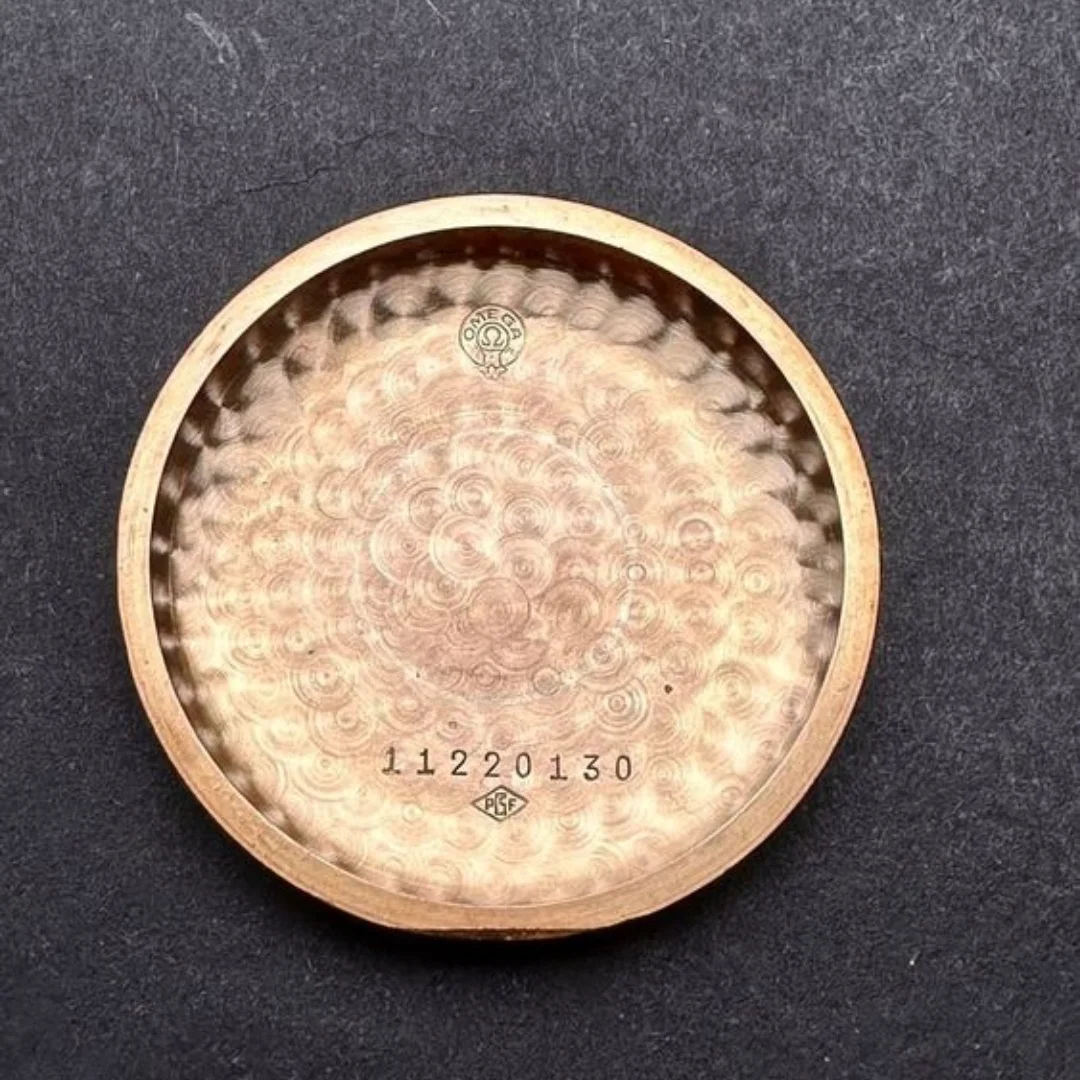

  • 18k rose gold: shouldn't there be a stamp 750 inside the case back?
Any other noteworthy details my eyes missed?
Thank you for your help already in advance.
13,521
23,458
Yes it’s a redial. If the seller isn’t being clear that this watch has been redialed they’re either dishonest or incompetent
6,772
10,425
For future reference - a French 18k case would have an eagle’s head stamp on the outside of the case.
70
125
That is, why I love this forum. So much accummulated knowledge and in so short time. Thank you all for your helpful comments 🙏
Will not consider this watch any further...

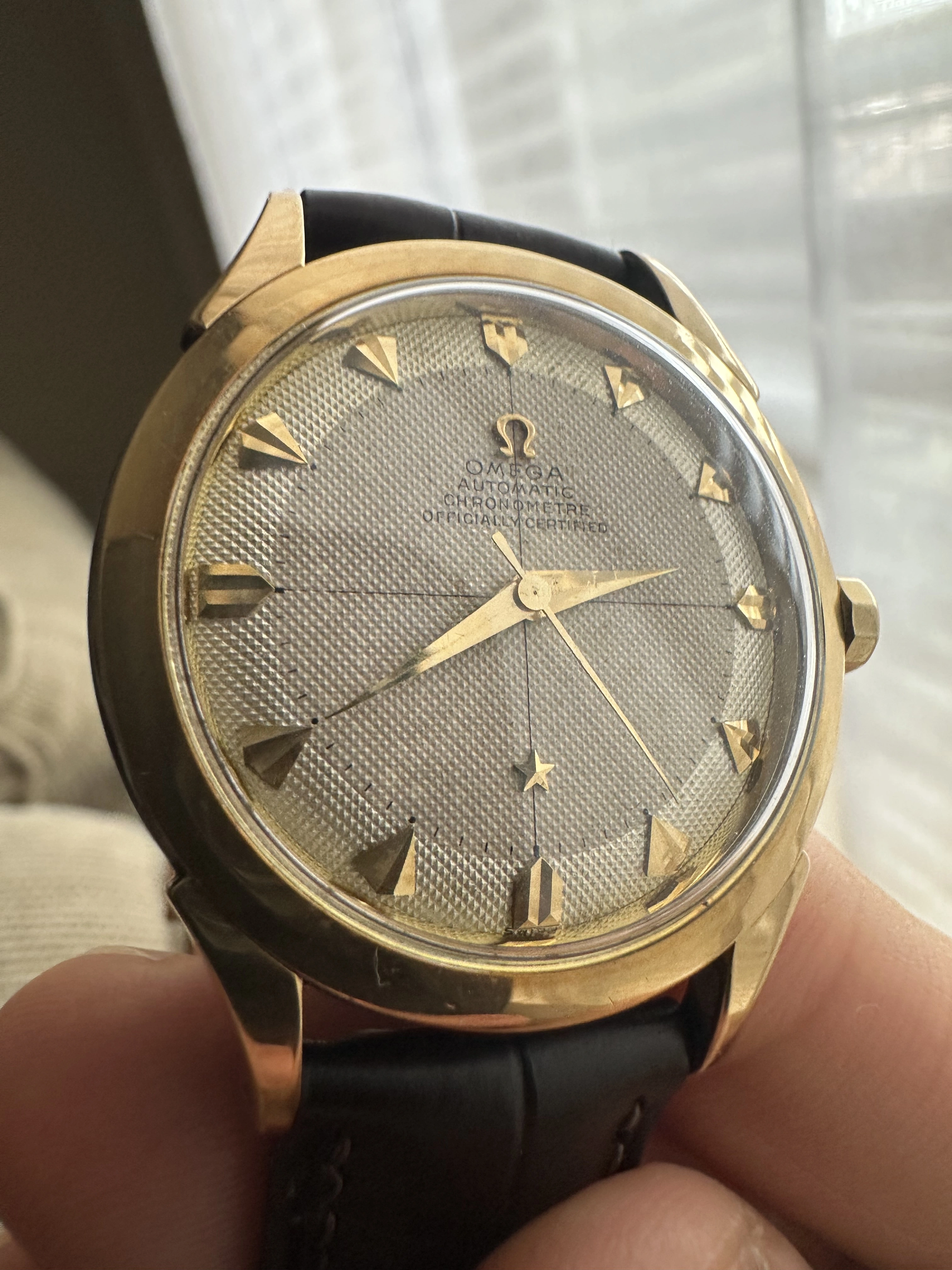

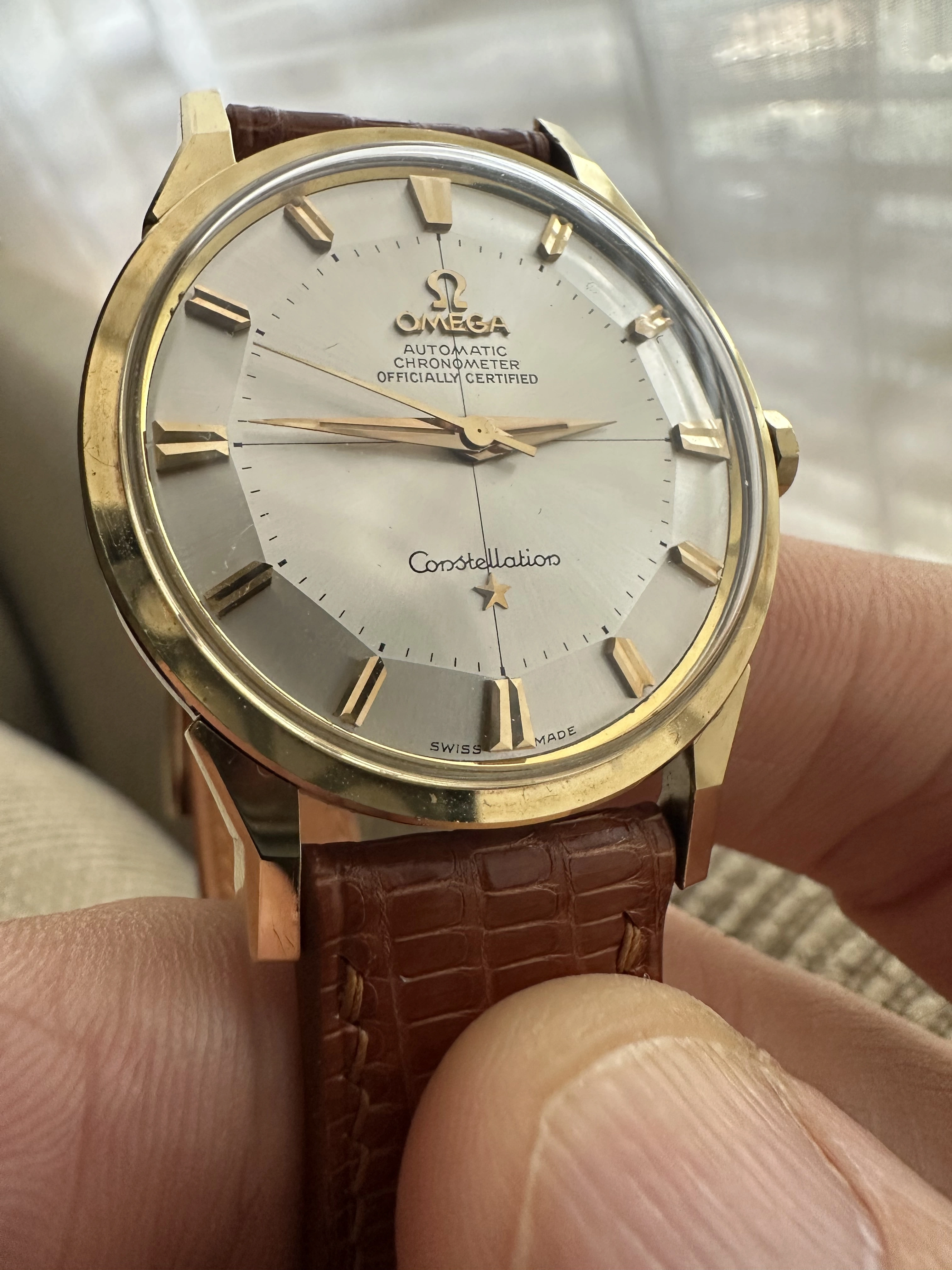

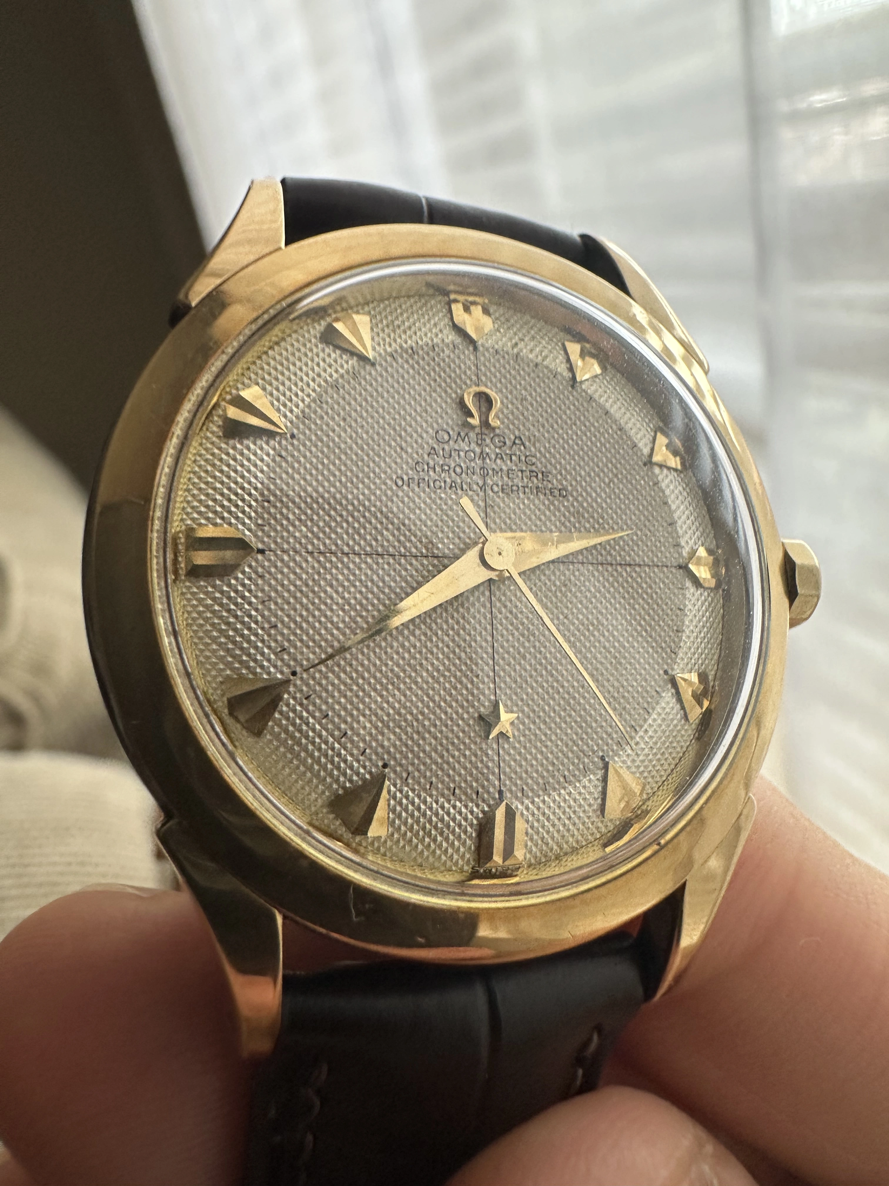

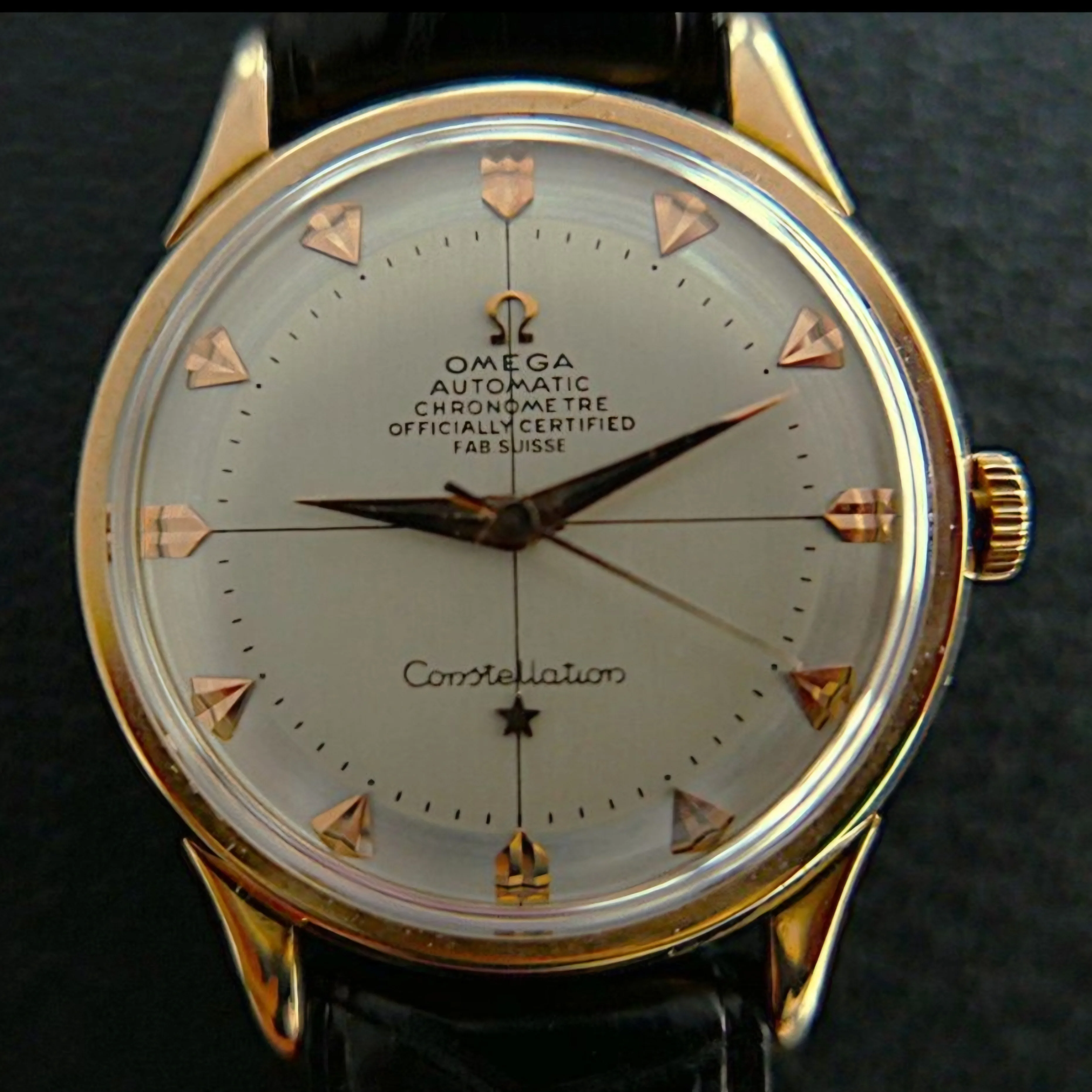

Here’s a pie pan dial:
And this one is not a pie pan dial:
Both are very attractive, but you can see how they are different.
