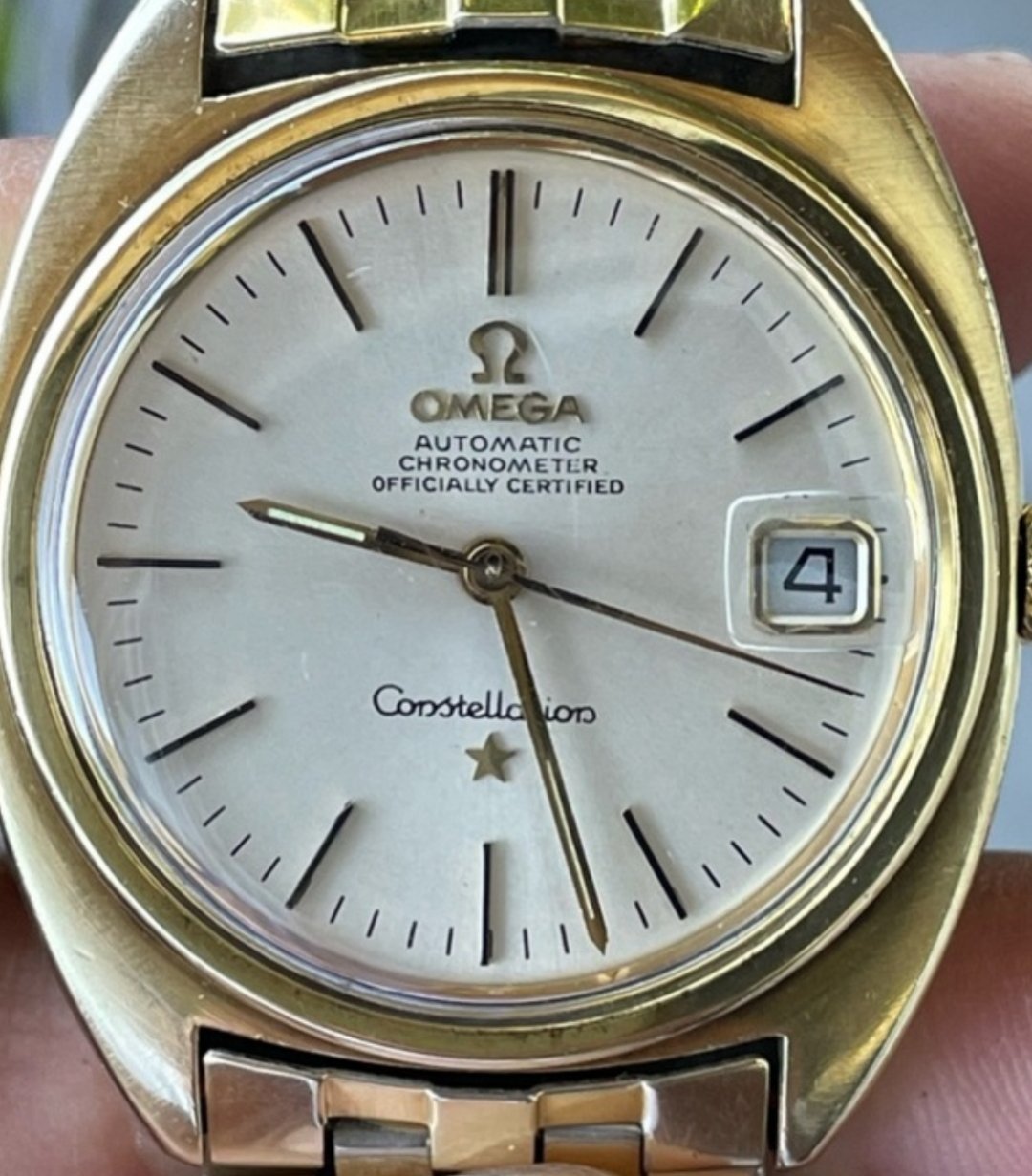

Posts 203 Likes 370 Spartcom5 ·Jul 8, 2024 I want to make an offer on this but I want to make sure the dial is original. It looks good to me but I've been fooled before, Thoughts?
Posts 13,492 Likes 31,811 X350 XJR ·Jul 8, 2024·Vintage Omega Aficionado You have been fooled again... And the case is really soft.
Posts 13,555 Likes 23,503 Davidt ·Jul 8, 2024 Look how heavy the printing is, the absence of Swiss Made, the mis-alignment of the minute marks (eg at 24 and 26, the lack of serifs on the text. Redial.

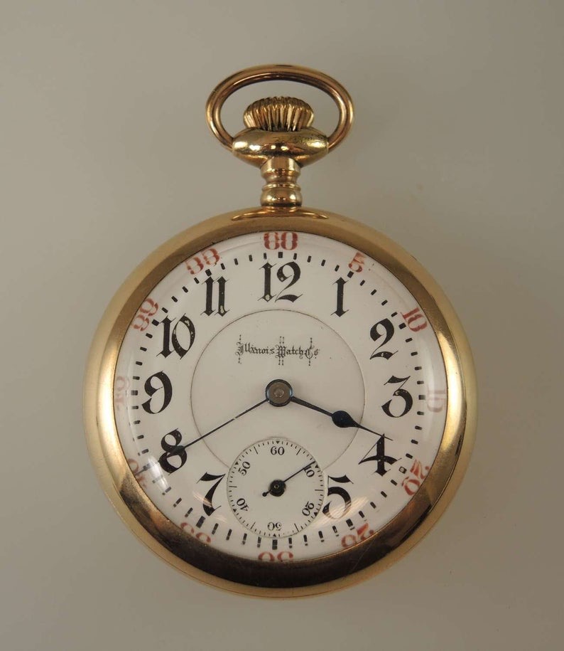

Posts 3,675 Likes 8,002 SOG53 ·Jul 8, 2024 At least you got fooled for free! Btw love your Illinois PW avatar. Mine says hi
Posts 203 Likes 370 Spartcom5 ·Jul 8, 2024 I never noticed swiss made was missing, cant believe I missed that !
Posts 907 Likes 1,742 Bruce235 ·Jul 8, 2024 First thing I saw was Constellation is not level. Then the 30 mark is peaking out from the index.
