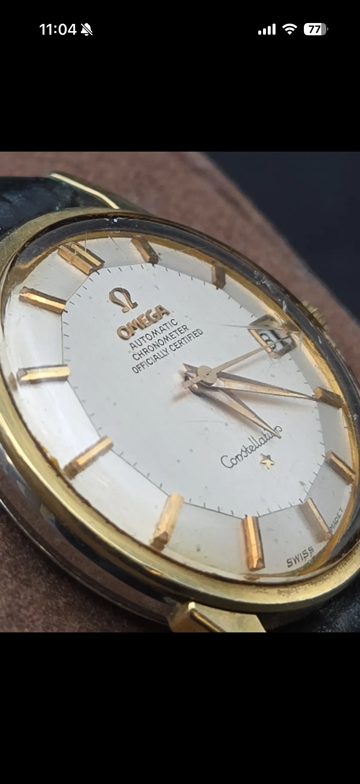

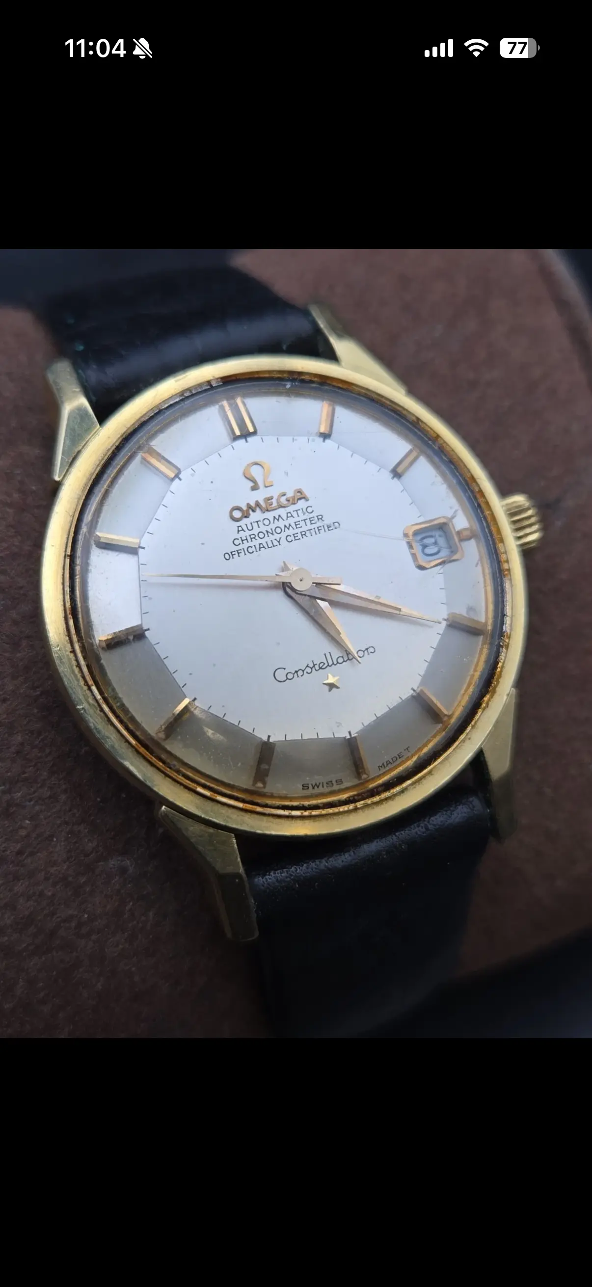

I have been searching for a good 168.005 for some time and if I can get this one for a good price I think it would be worth it with a new/polished crystal.
Im hoping someone with more experience could sniff out any red flags if they exist and what its worth spending, its an auction currently at $1000.

what about the piece concerns you enough to doubt it?
The dirt/corrosion on the edges worries me a little that it could be a sign of more issues but I don't have the experience to know if its uncommon/more than what should be accepted. While it does look scratched up it doesnt look overly polished which is what I like about it and could just need a cleaning.

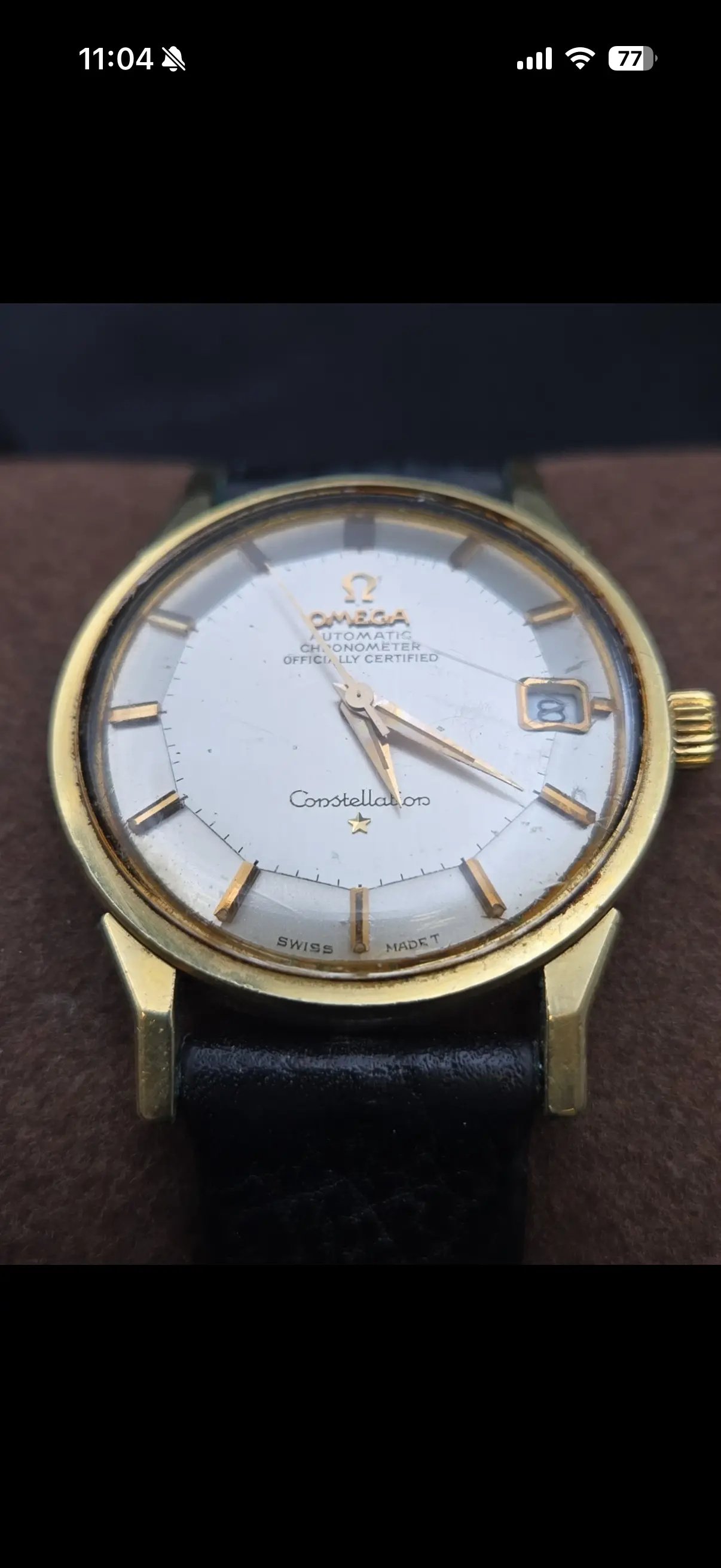

Question is: If you want a good 168.005, then why go for this one?
Or do you want a cheap 168.005? That’s a very different thing.
I believe that most of the dial will look nicer under a fresh plexi - some of the dark dots are not on the dial itself. However, the discoloration around 6-8 or so on the edge of the dial looks like moisture damage. I’d say it’s unlikely it can be removed or at least a massive risk.

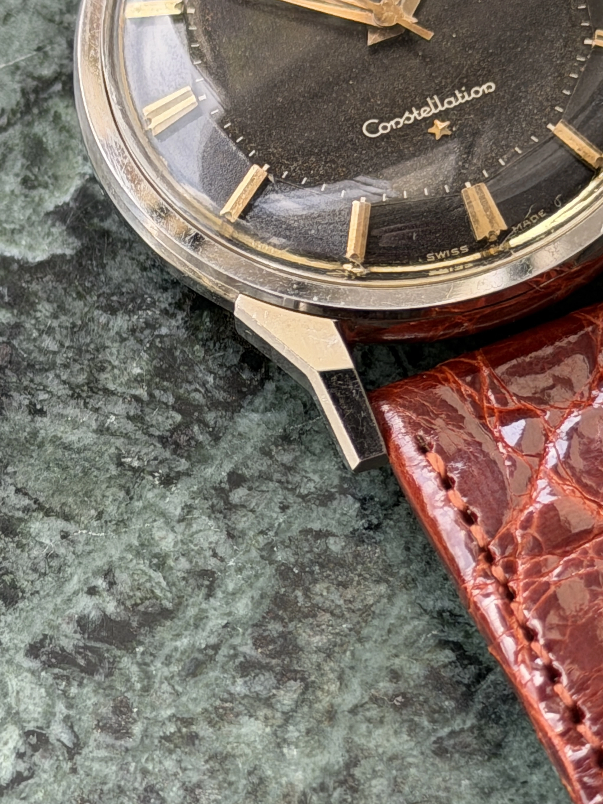

Then there’s the case, which is heavily polished. Yes, you can still guess where the edges are. Compare to this lug though, that’s about what an unpolished (or close) one looked like:

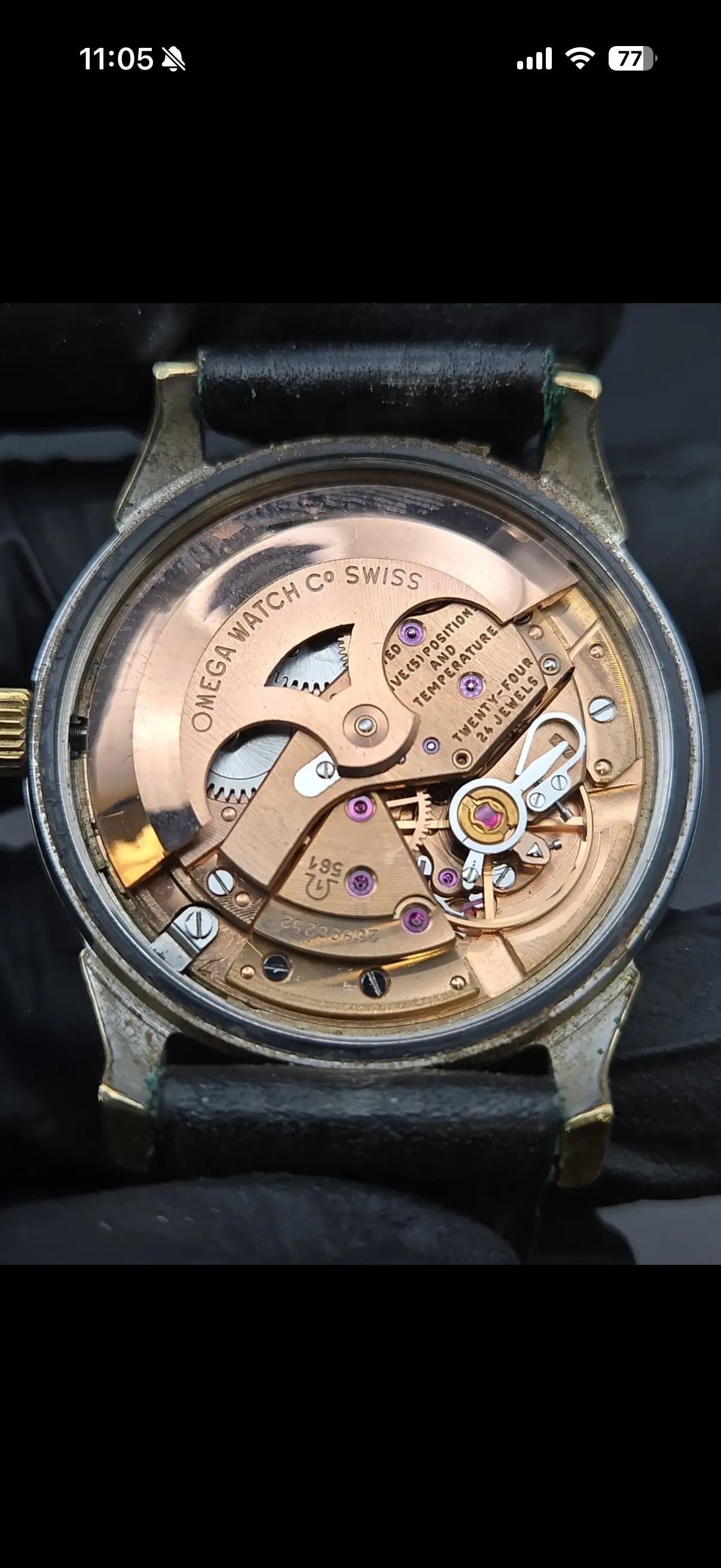

Minor other issues are the incorrect crown, for example. You’ll need a service, movement looks a bit dirty. And it won’t stay at 1k. So in the end you’ll usually end up with an example that’s more expensive than you thought, but that’ll always stay mediocre at best.
The usual dogleg advise: They aren’t rare. Buy the best one you can.
The usual vintage watches advise in general: Condition, condition, condition.
You probably won’t look back at having paid a little too much. But mediocre condition will remind you every single time you glance at your wrist that you didn’t wait till the right one came along or till you had saved up to afford a good one.

Thank you!
That is the exact information I was looking for. I’ll pass on it and look for something already in the condition I desire.
