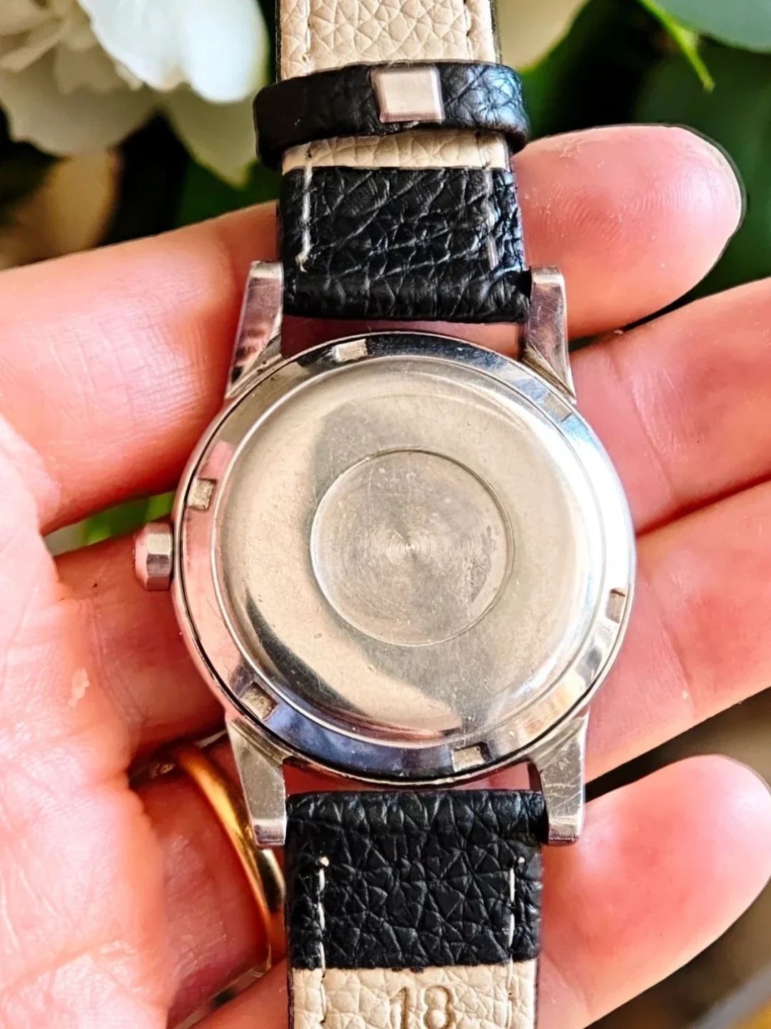

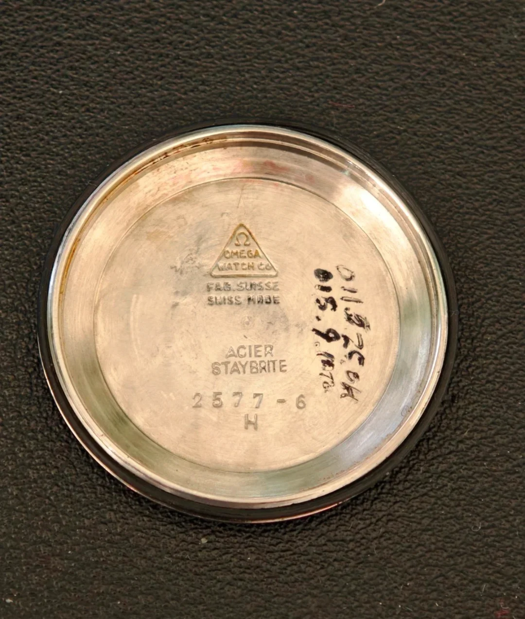

It looks like the case has been replaced with a Seamaster case.

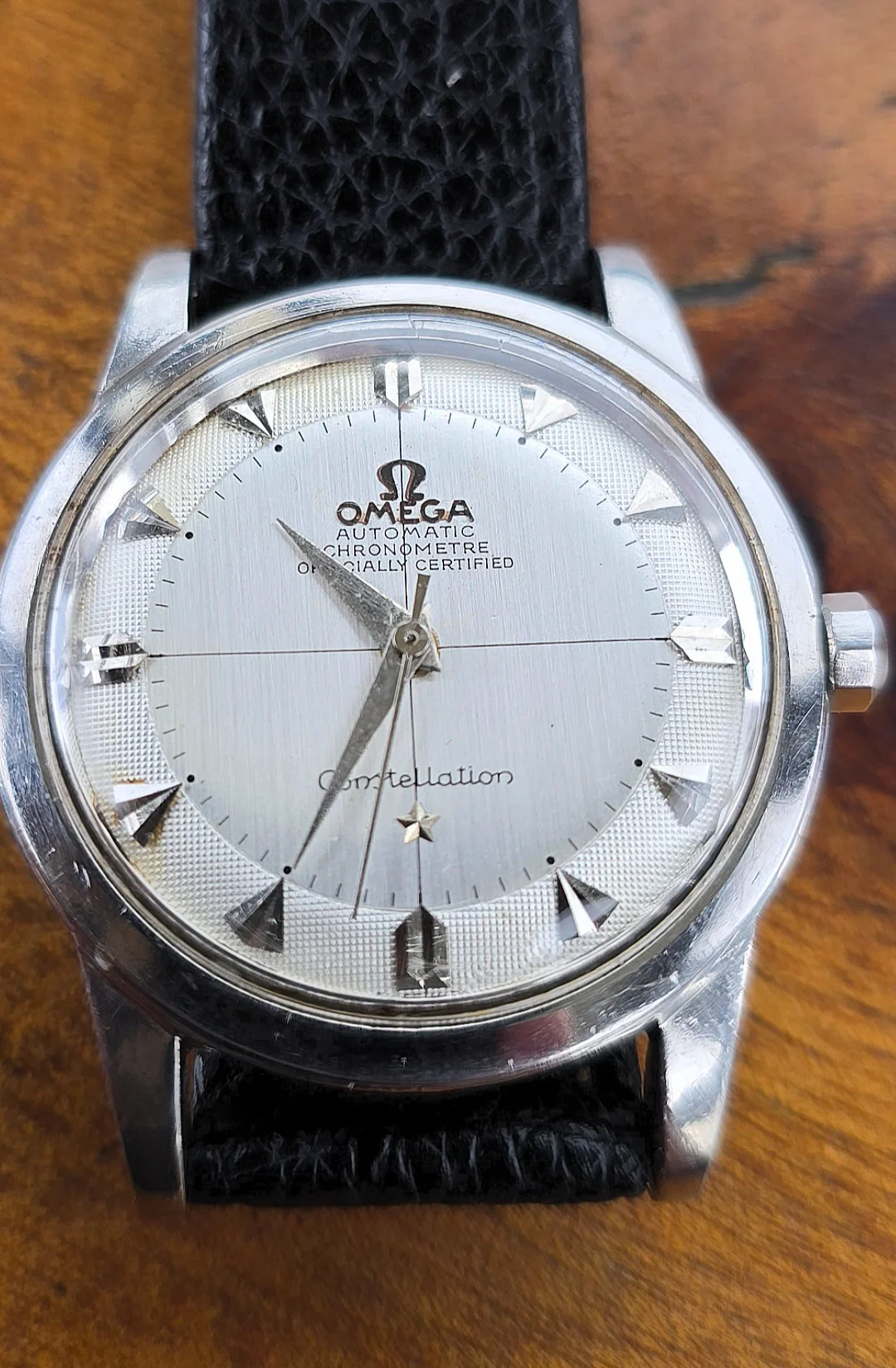

Are the dial and hands original?
What case reference would correctly match this dial? Is it the 2852?

This is a little bit all over the place. It is indeed a seamaster case, dial is refinished, second hand is too long.

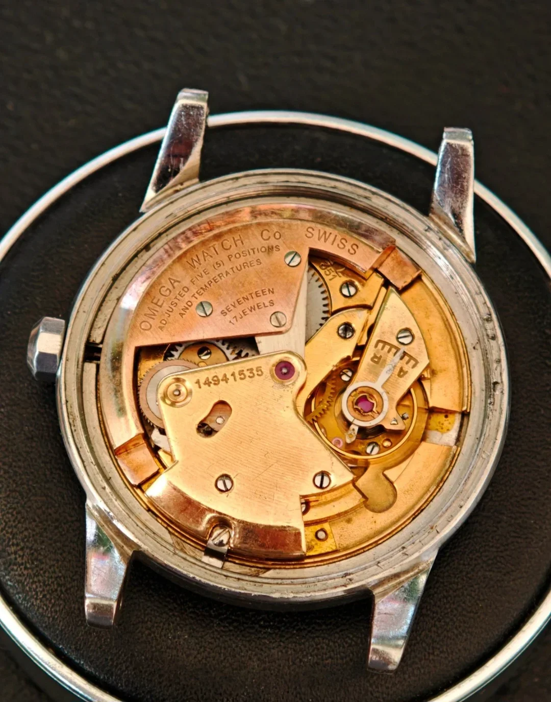

Wouldn’t be a 2852 as those didn’t come with a bumper movement, and as far as I know MAYBE some of the 2648 constellation had a 351 movement but someone more versed in these early Connie’s can guide you.
Overall, this is definitely a franken put together watch that’s trying to pass as a constellation

No Constellation had a Cal. 351 movement. Seamasters of this era would have cal. 351 and Ref. 2577 case. It is my opinion that this is a Seamaster watch modified to look like a Constellation.
The chronometer rotor was imported from another watch, maybe a cal. 352. The dial is likely an Asian fake.
Looks like someone worked on the caseback to create a depression to fit a medallion, but they didn’t find one or it fell out.
The watch itself is a mess. However, you have a nice stash of hard to find parts if you collect other bumper Omega watches.
