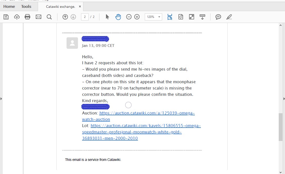

Being interested, I emailed Catawiki requesting some hi-res images and asking about a corrector, as follows:

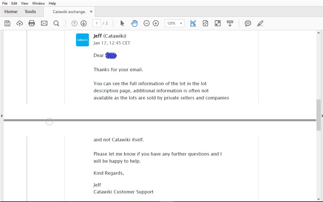

Catawiki came back with:
Needless to say, no bids came from me. The bottom line is they don't even handle the merchandise themselves. The seller takes the photos and provides the description. Catawiki "experts" do nothing of any substance - they don't even get the description translated. This listing was also Berry Harleman's and I can only concur with what @efauser said above.
