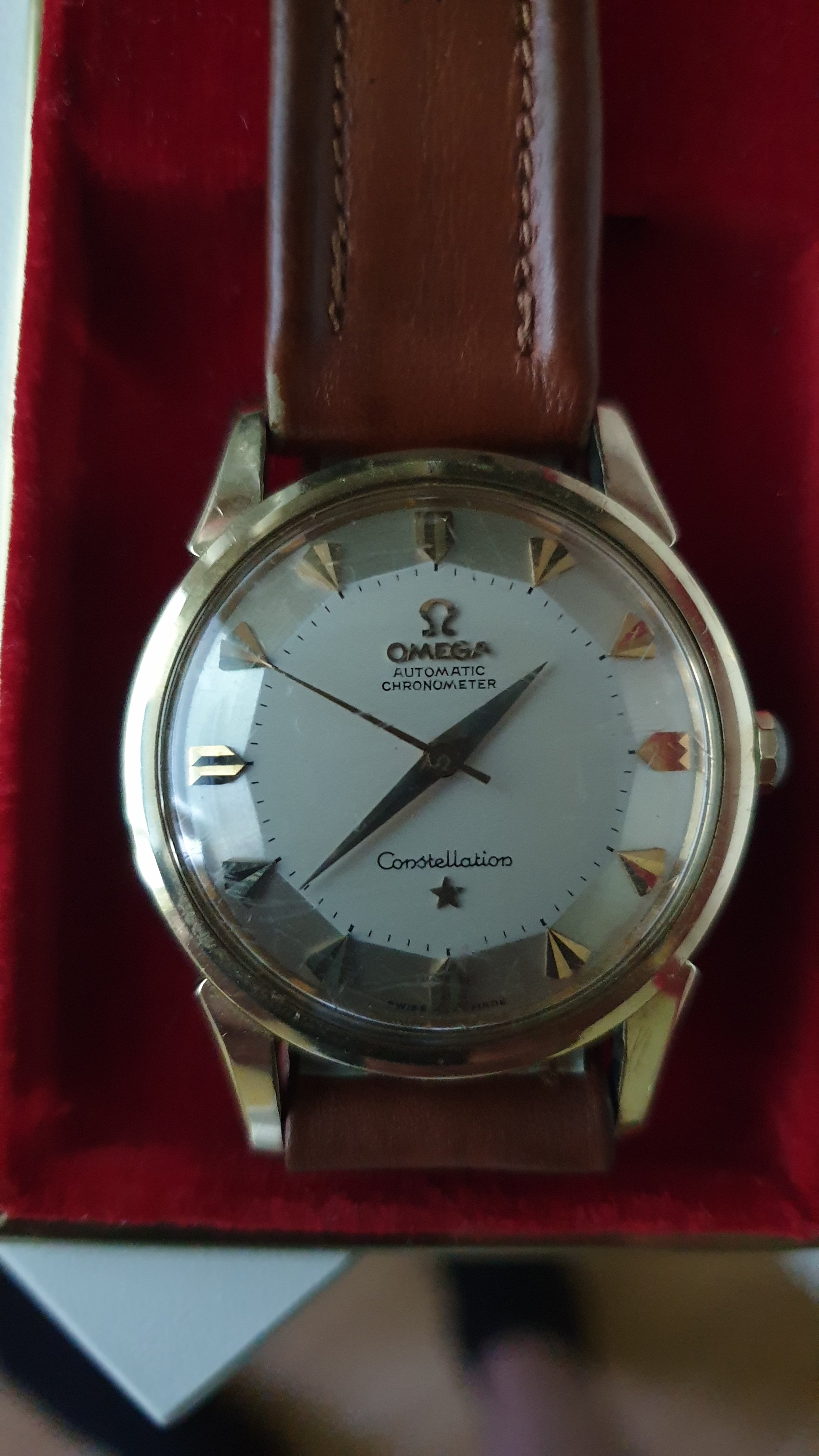

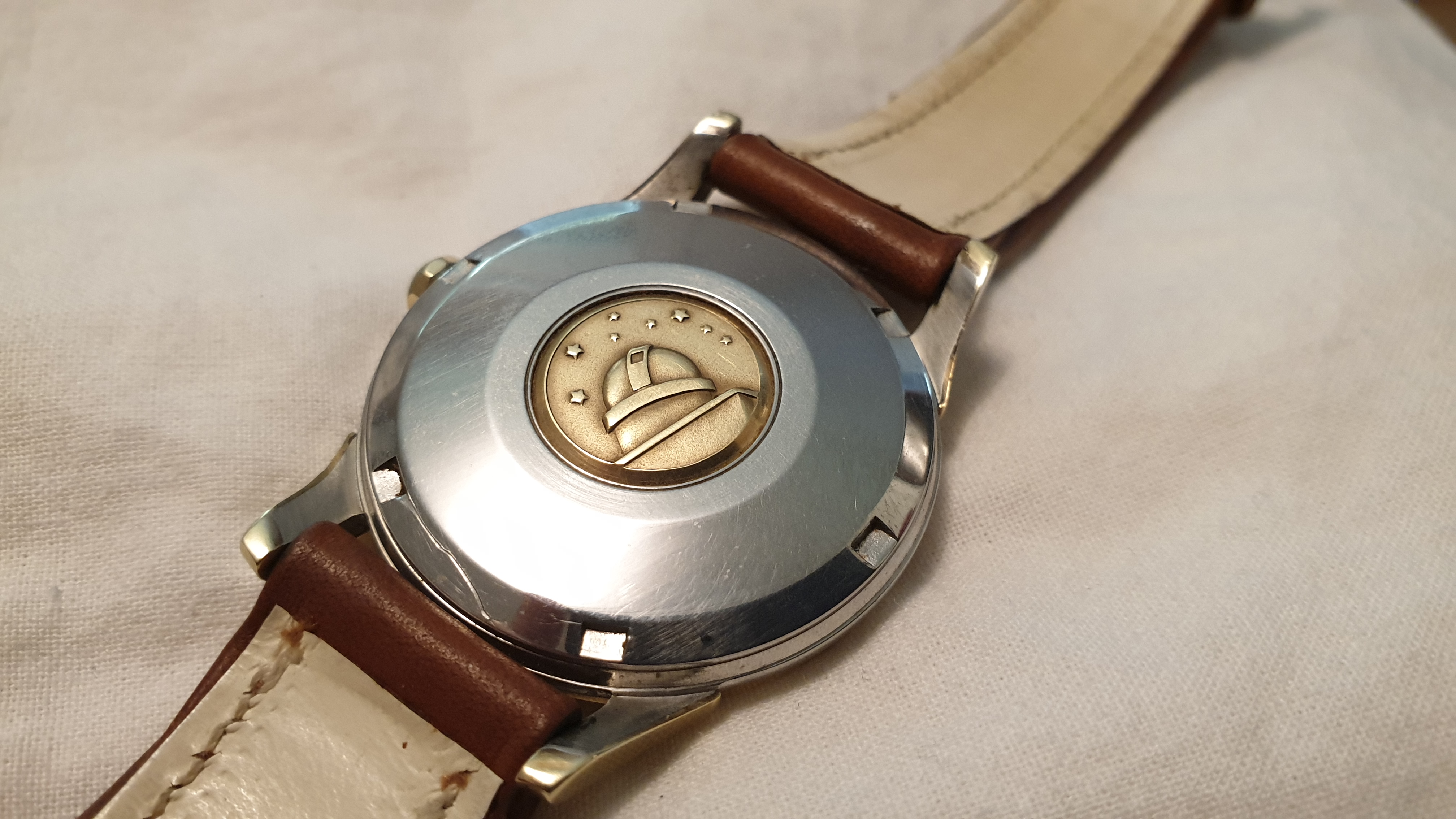

Hi you all
Just fee days ago got my hands on our "family treasure" and wondering which model and age is it? And ofcourse if it isn't fake.
Everything I know about it, is that it has been sitting in my fathers home past 30 years and only worn maybe once in a year.
I know it would help to have pictures from inside, but I won't try to open it my self without any correct tools. And there is no shop in close to visit.

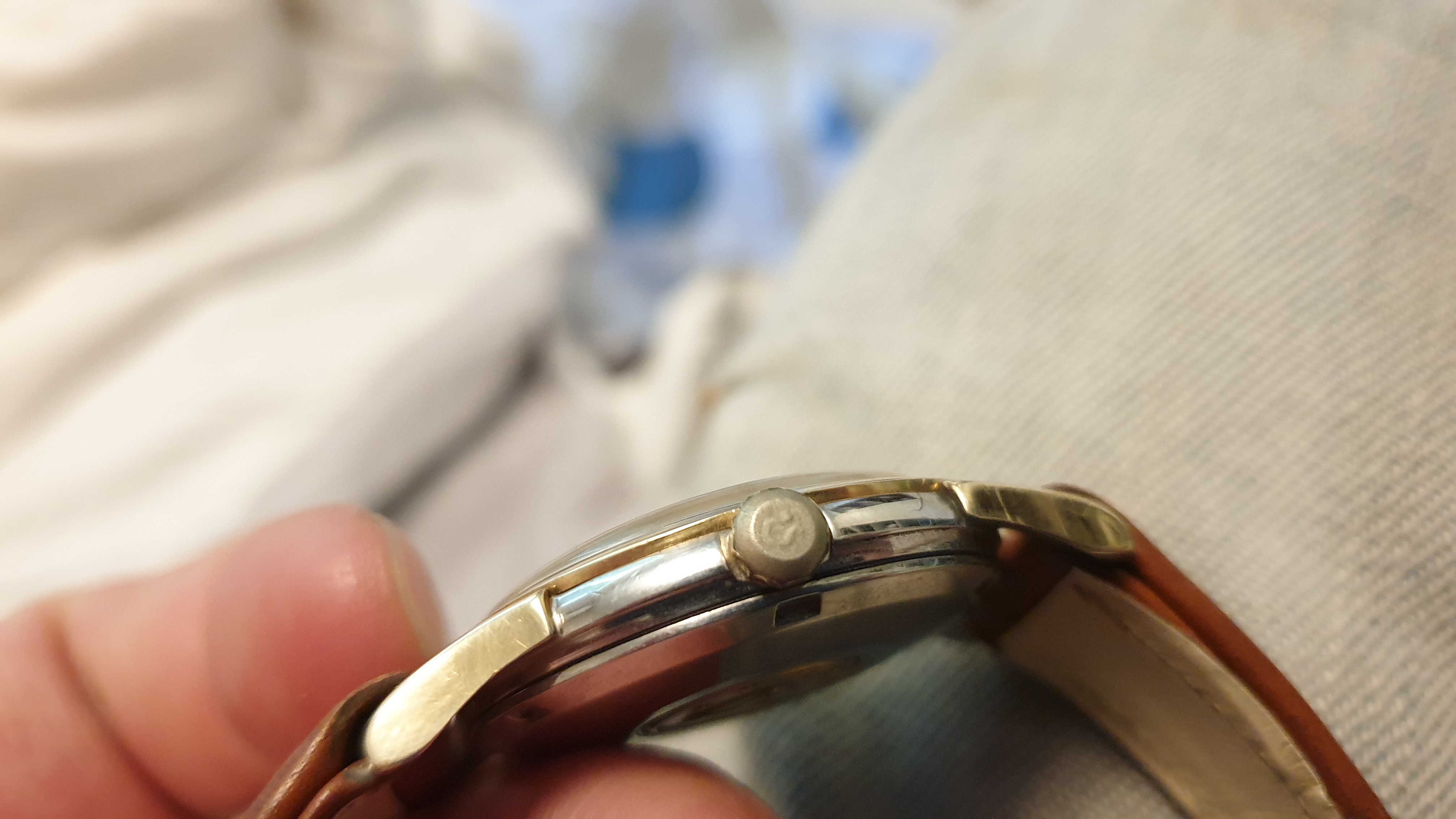

I can't find anything wrong about it, but glass is little worn out. Bigger consern is that when put to my ear it tics. I've understood that it shouldn't? Or is it just because of lack of service, because I know it hasn't been serviced at least 30 years.
Anyone to help me? Thank you already

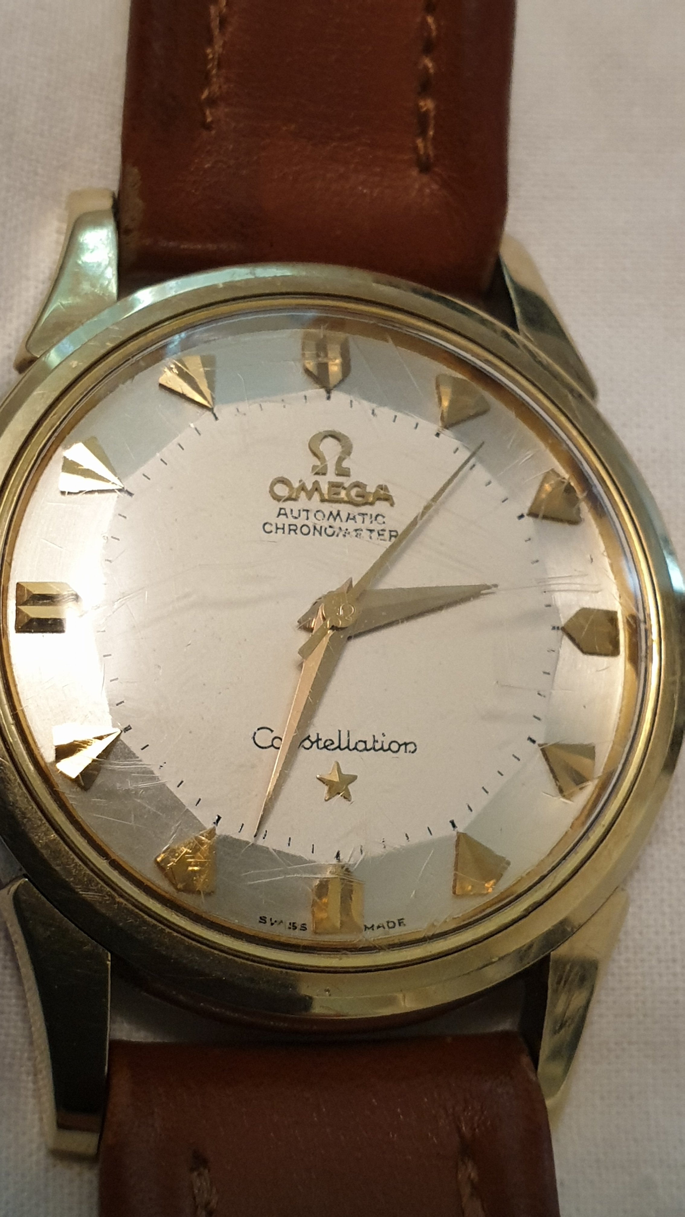

Looks like a good capped 14381, or possibly a 168.001. It has a pie pan dial with broad arrow markers, which in my opinion are the best looking markets Omega ever used. Nothing jumps out as me s being off with the dial, but the crystal has quite a few scratches. The medallion is sharp with virtually zero wear. It has what looks to be the original crown. You have an excellent example and a terrific family piece.
What concerns you about it ticking? Is an automatic so the movement starting up when the watch is handled is not surprising.
Start looking for a watchmaker local to you and get it serviced, then wear it in good health. If you tell us where you're located the guys here can help find one.

I'm from Finland. I have clocksmith quite near, but it's not Omega authorized, is that big no no? I think there is one authorized service in 80km.
What about crystal, is it ok to change or polish, or just leave it like that?
13,636
18,994
Buy some Polywatch.
Put masking tape on the bezel to protect it. Use Q-tips if possible or an old 100% cotton T-shirt.
Note that it might take a few hours after treatment to improve. Be patient.
It won’t make the crystal perfect, nor will it remove the deepest scratches, but it will look much better.

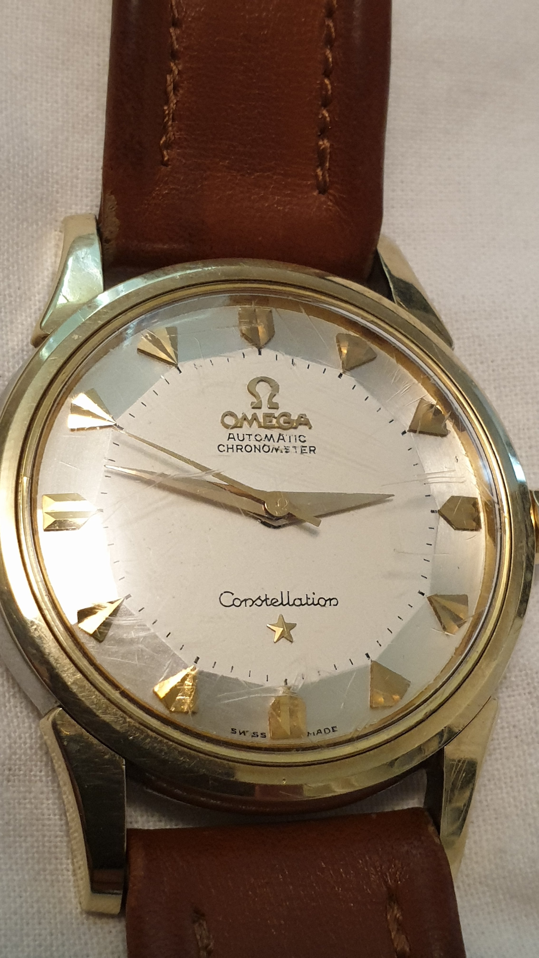

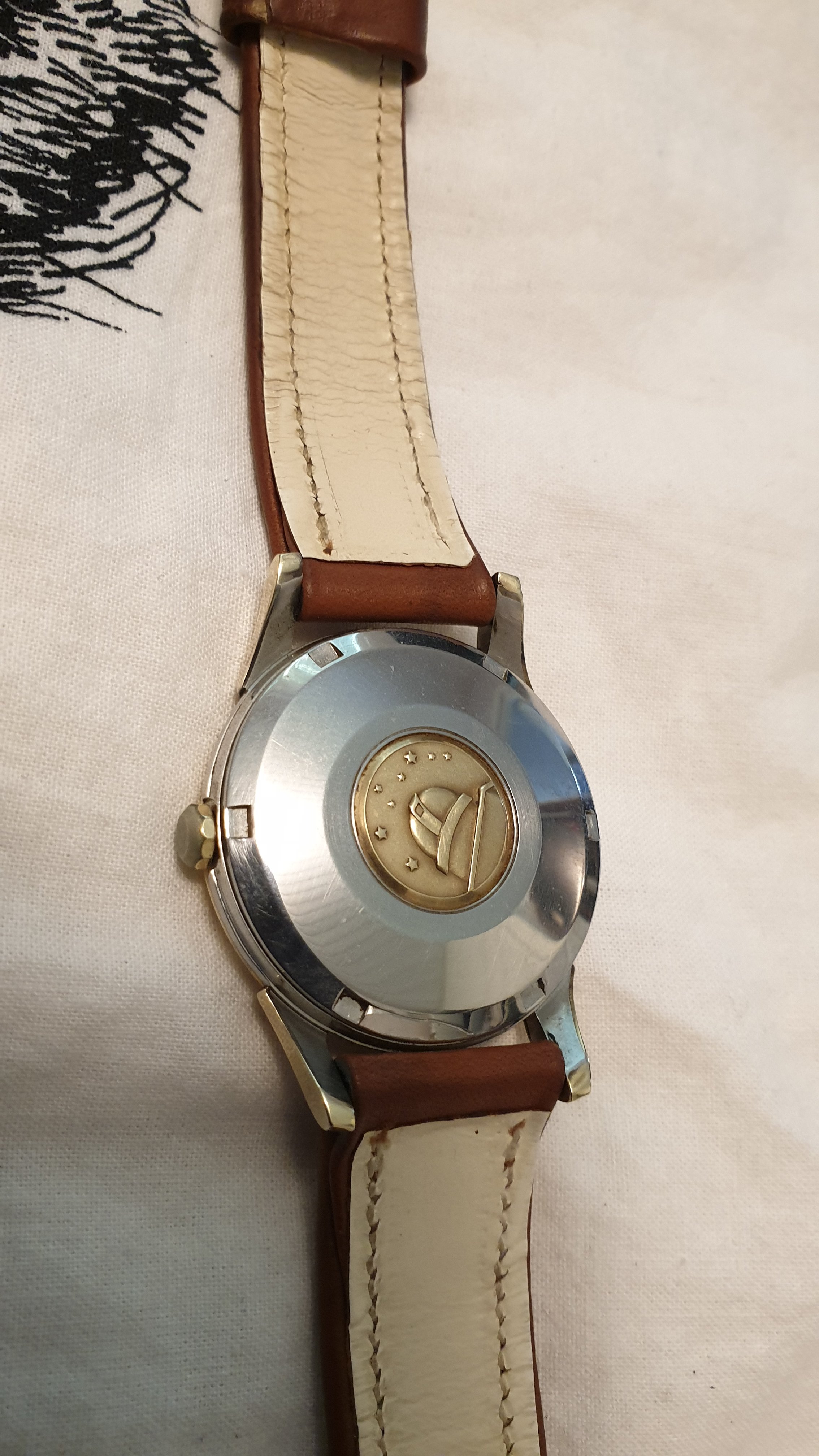

Diameter of the watch is 34mm so I suppose it it rather that 14381 then?
It sure looks nice, just want to avoid doing anything I shouldn't to do

A clock maker and a watch maker are a little different. Some clock makers are also watch makers, some aren't. The most important thing is finding someone who knows about vintage timepieces and is competent at working on them. We have several European members here that will know of watchmakers, I just don't know if any can recommend one in Finland.
I would personally avoid taking it to an AD. They tend to try to make the watch look brand new and that often means replacing parts the owner doesn't want touched. There at several examples of Omega ADs doing this if you search the forums.

Beautiful watch! You can freshen up the crystal by rubbing a little toothpaste on it with a microfiber cloth or tshirt. These plastic crystals can look great with a light polish. I wouldn’t change it, if possible, as it’s an original Omega crystal (you can tell by the small Omega logo in the center).

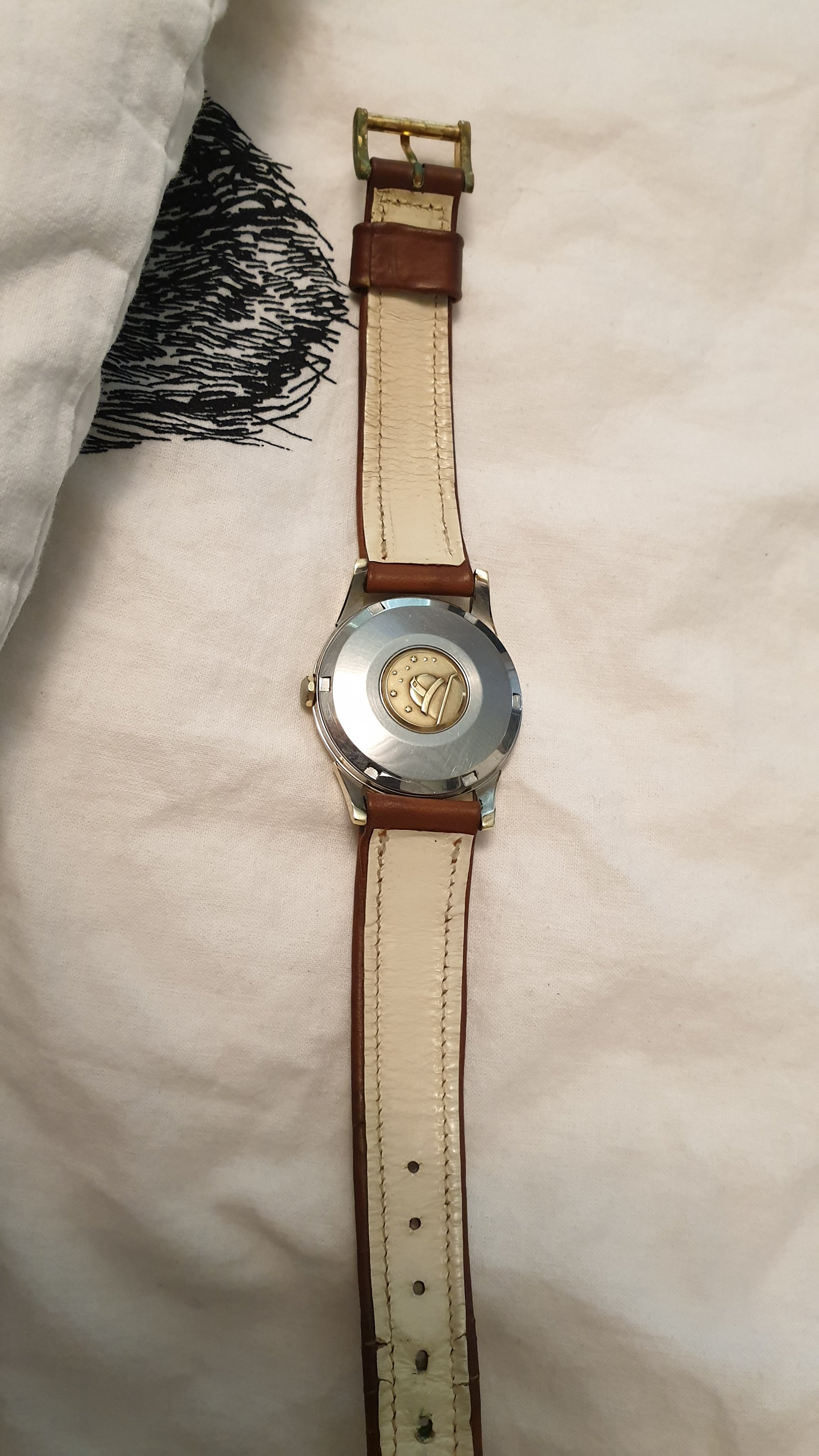

That’s a lovely watch. The rear emblem looks in excellent condition

Wow, that's a nice one to find as a family treasure! I think you can also just have the scratched crystal replaced with a genuine omega made one. I think the part number that you want to look for is 063PN1021, but I am not absolutely sure.
If the watch is a 14381, the crystal would be 063PX5140.

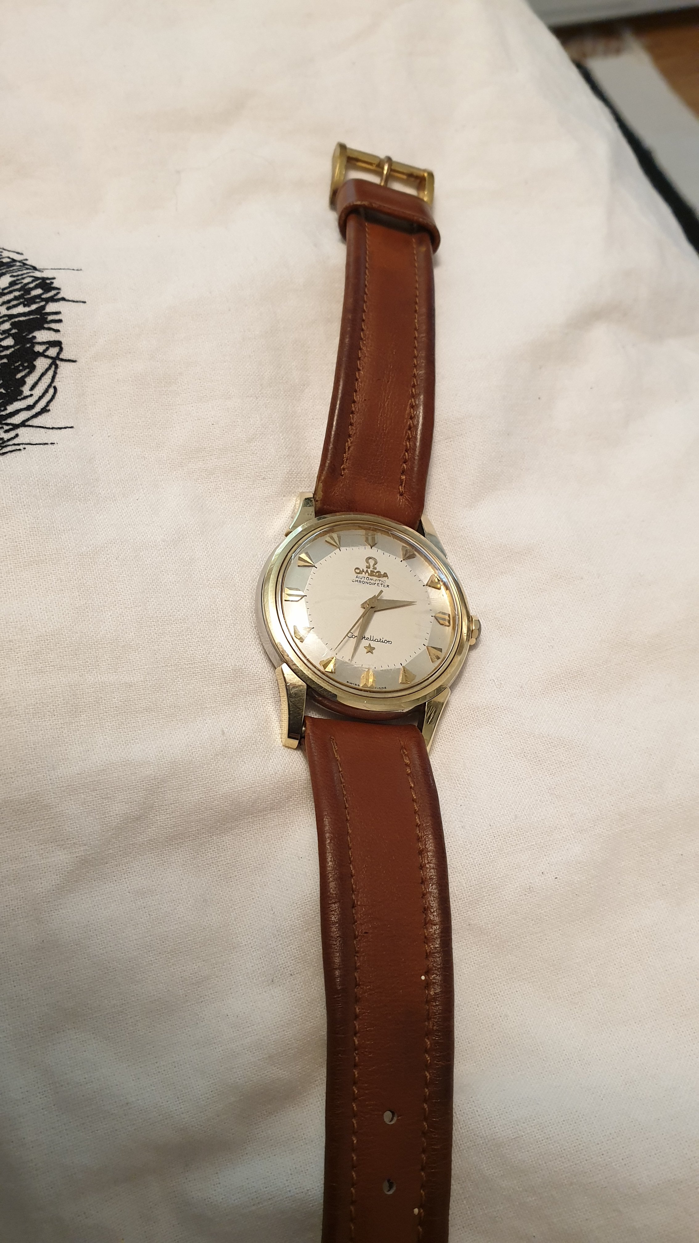

What about the strap, do you think this is original one? If not, what kind of strap and buckle belongs to this model?
