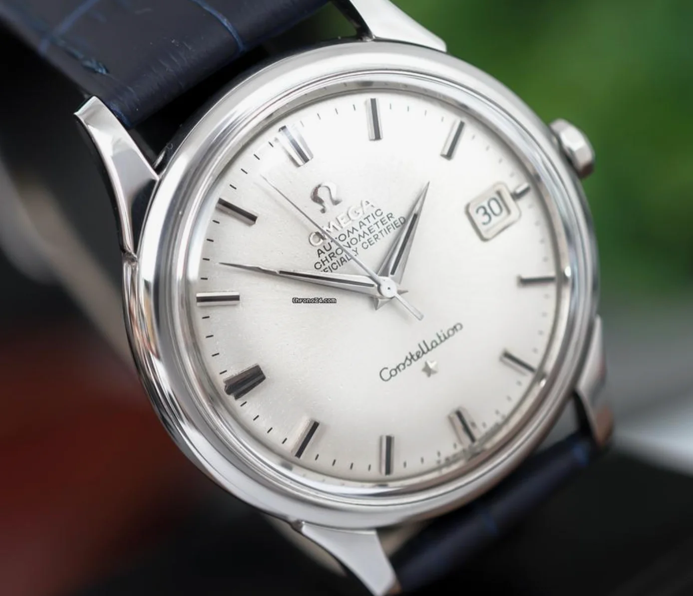

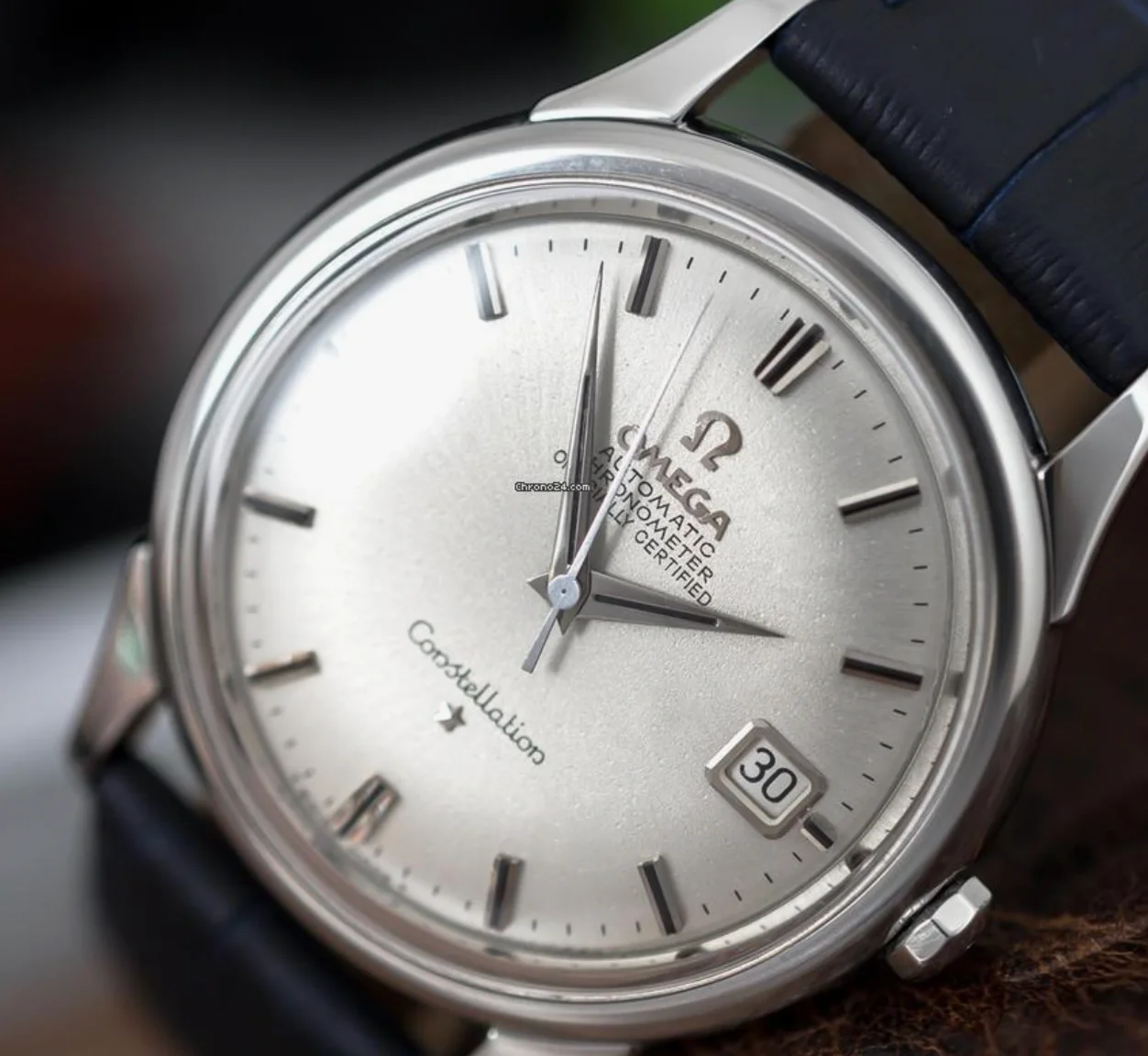

What do think? Redialed or not?
I'm not sure - the polish is a red flag...and the price as well..
Appreciate your opinions 😀
897
2,849

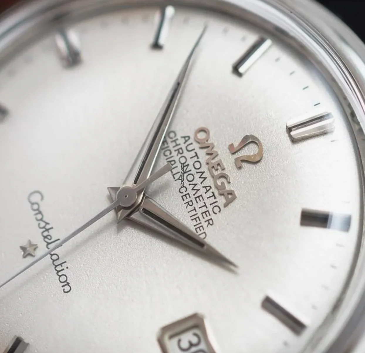

Not an expert, but something about the font seems off. Whether it is original or redial, it is nice!
2,382
2,549
T Swiss Made T with no lume
I could have sworn we just saw in another thread that the T SM T dials happened on no-lume watches too sometimes, but I'd have to look back. Only a few days ago ...
3,424
7,579
Im sure there are exceptions, I know in C case in particular. But here I would just consider it another question for the watch
2,382
2,549
Thanks! Appreciate the lesson.
6,635
10,244
I didn't see any red flags, and it is pretty consistent with the ones listed here: https://stories.omegaforums.net/constellation-jumbo-37mm-168-001/
Minute markers made me question it for a bit though, but there is some weird photograph artifacts going on here, they are not consistent thickness between photos for hte same marker.
Such is the variation in text styles that 'jumbo' constellations are a specialist subject in their own right.
Of course the term 'jumbo' simply covers a series of references that appeared in larger lyre-lugged cases. (predominantly for the Far East market)
However, the font style across the range is reasonably consistent - and by that I mean shape and serifs.
As @Porteroso said, there is immediately something 'off 'about the dial when you first look at it.
When you look closer, the font just isn't quite right.
The dial texture on the OPs watch is enough to call a redial.
And the flattened 'O' in automatic is pure fantasy for any constellation.
Ts on a watch without lume generally signify one of two things in Constellations of this era - a redial or a service dial.

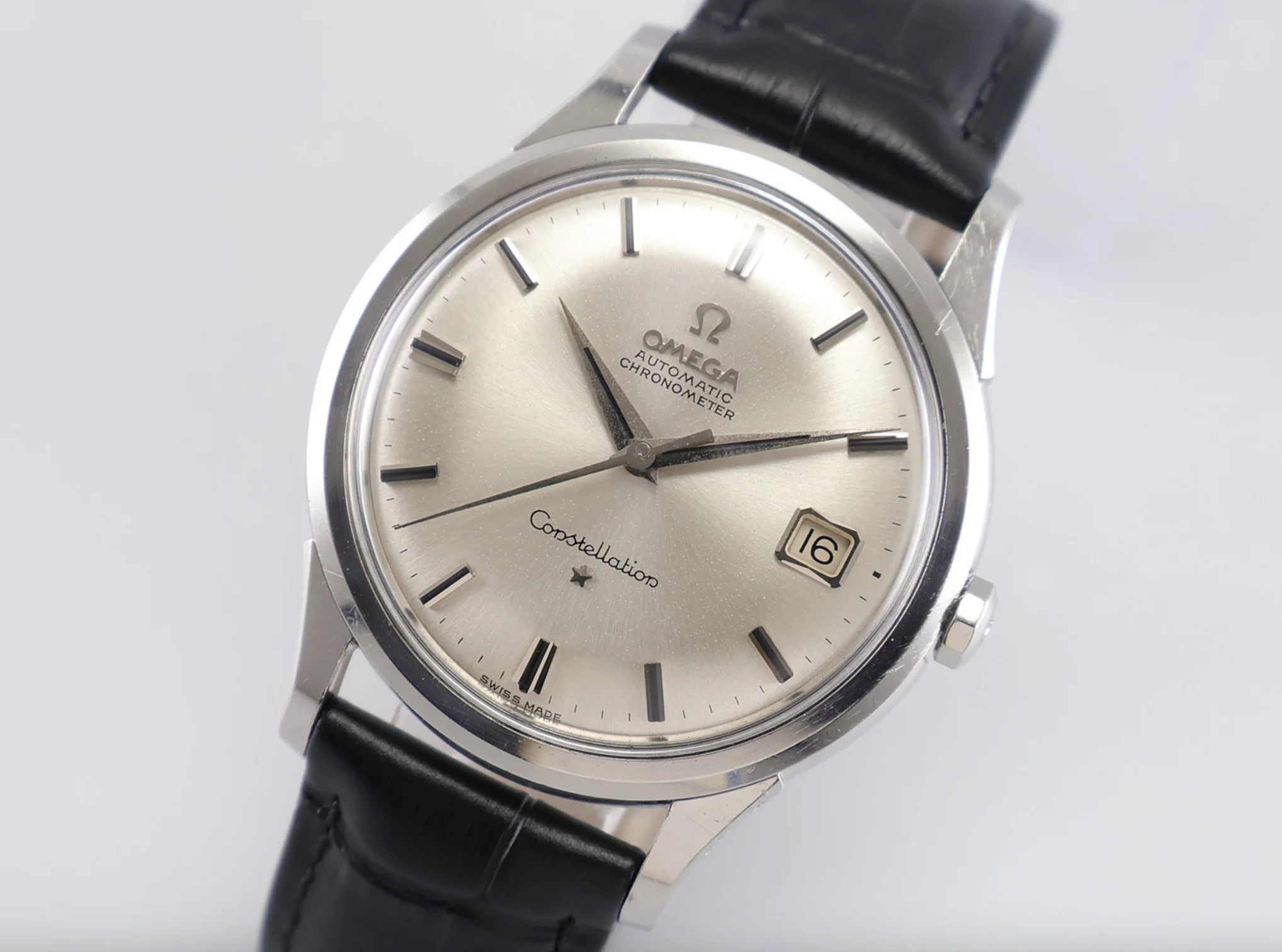

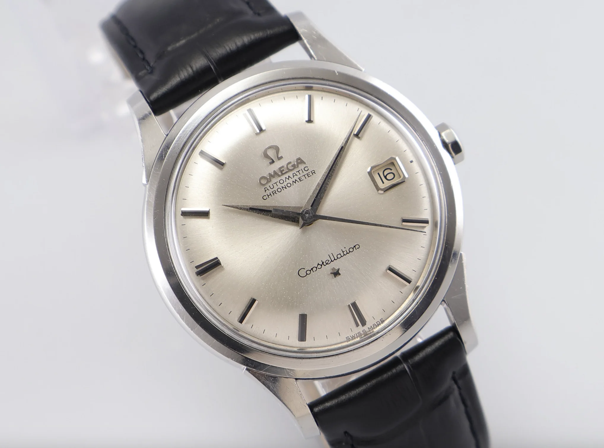

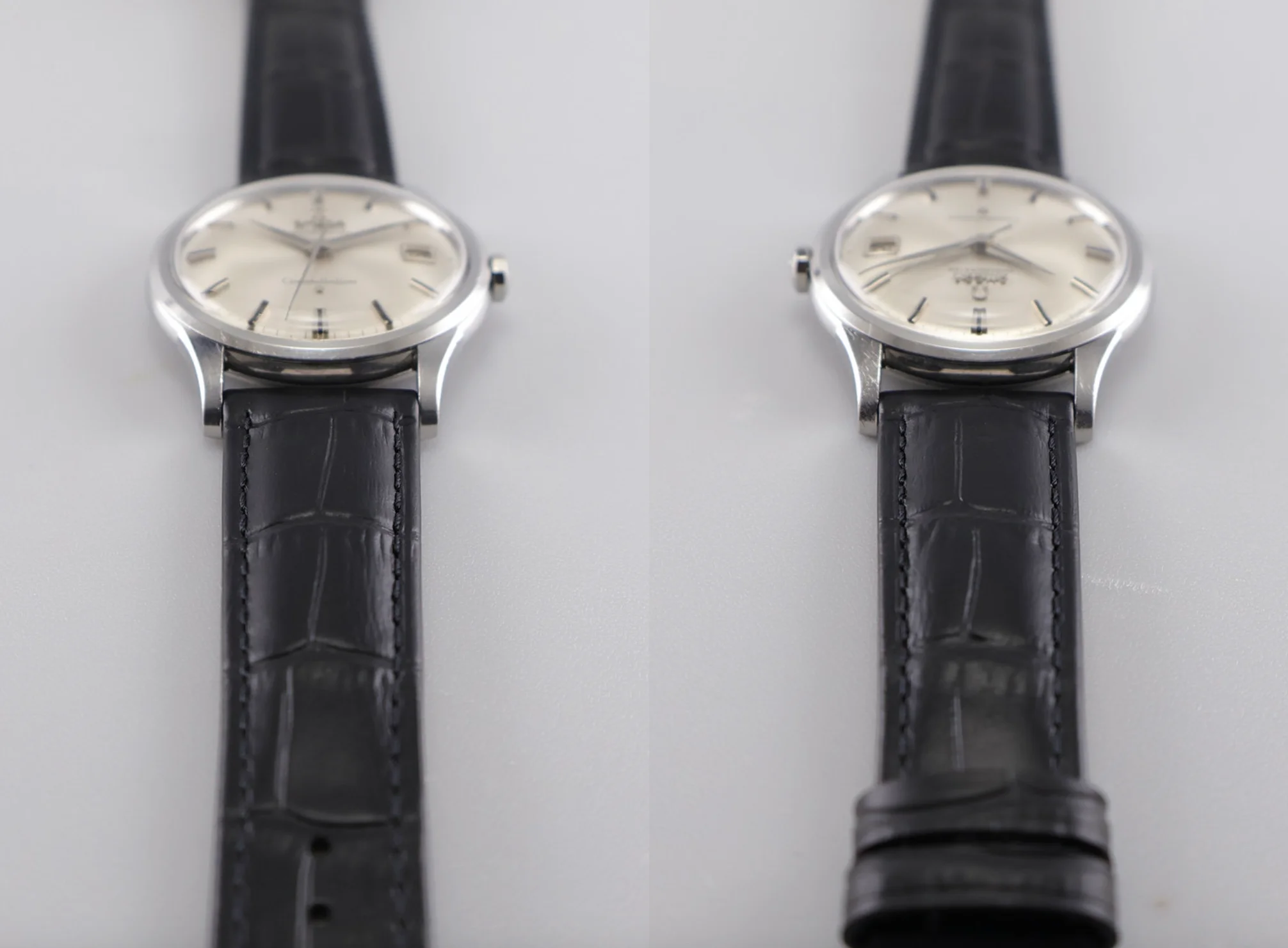

I'm still on the look out for this specific piece - recently got offered this:
Pretty sure it's no repaint and not really polished.
What do you guys think? Should I pull the trigger or keep searching for a better dial?
Appreciate it!
6,635
10,244
You’re right that the dial has some extensive spotting.
It would help if you told us what the asking price is.
89
35
2300 ,-
6,635
10,244
Whether Pounds, dollars or euros, that is too much for an utterly pristine jumbo and probably twice the value of a, albeit decently cased, jumbo with that much spotting in the lacquer of the dial.
Appreciate it!
I think that's a nice enough watch if you can get the price more in line with comps. Maybe you can do some research and find previous sales.
