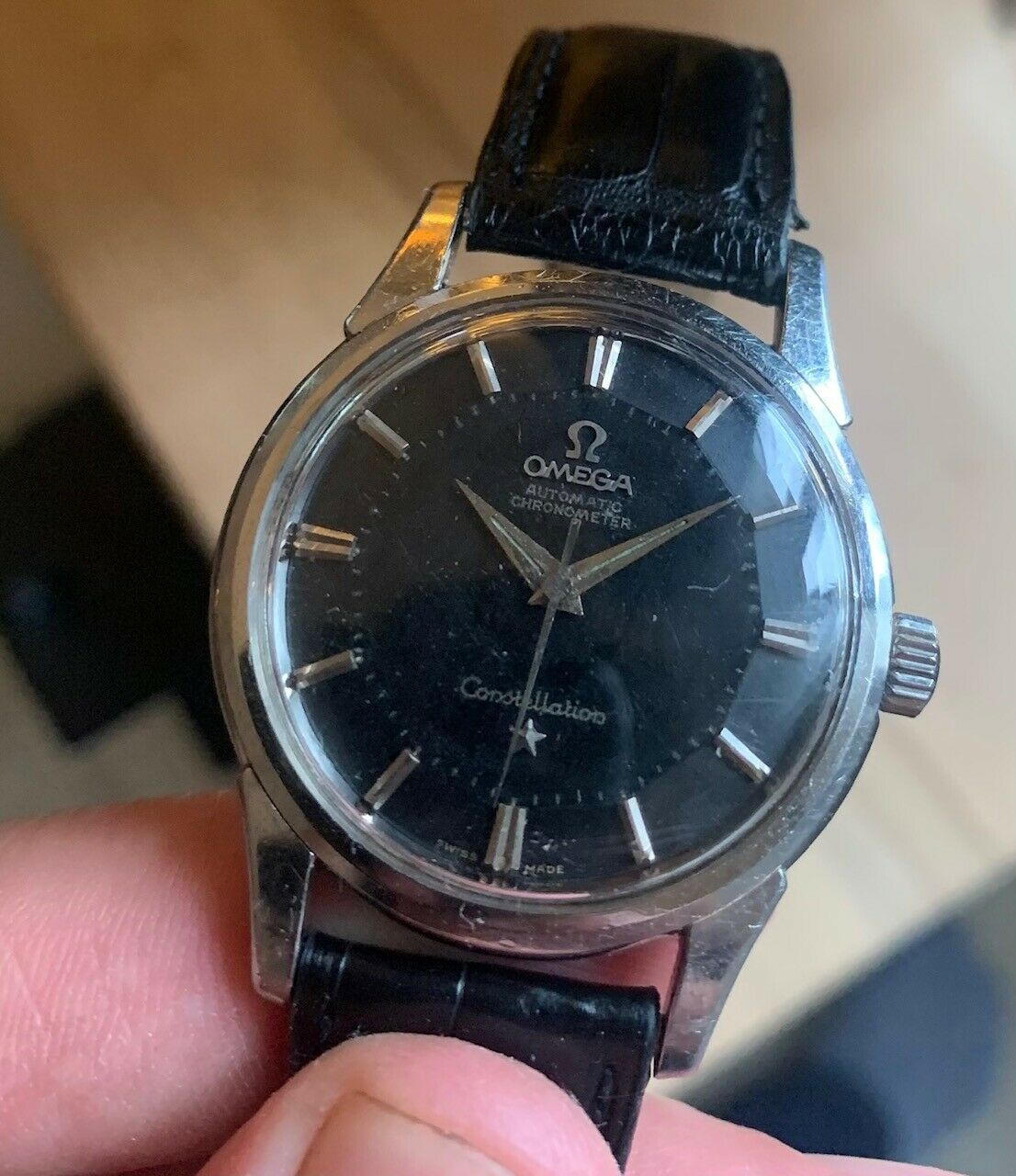

Hi, I've been sent a picture of a Constellation. It's black, so I work from the presumption of a redial. I've been comparing the lettering to the beautiful one that @nanjingcigarettes just posted in the sales section. In 'Automatic', I wondered if the lines on the 'U' went a bit too high, and whether the second 'A' was unusually feint and spaced a bit too far from the 'M' which precedes it. I'd very much welcome your advice on it.
It's a cal 551, 14381.
Thank you very much.

I would say that the dial checks out, but the moisture damage it has (most likely) suffered has made the text look fuzzy and incoherent and more or less ruined the dial.
I wouldn't pay any sort of premium for a black dial in this condition, but would treat it as a similarly damaged silver dial.
Thank you, much appreciated. That makes perfect sense because the crystal has a crack in it and it has probably let moisture in.
I have a pretty decent watchmaker. Do you think that if there hasn't been serious moisture incursion, he could 'dry out' the watch, fit a new crystal, and I'd be OK?

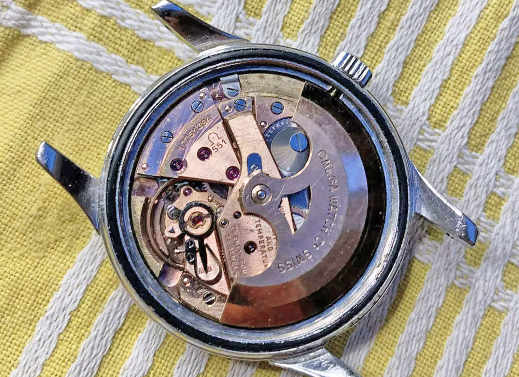

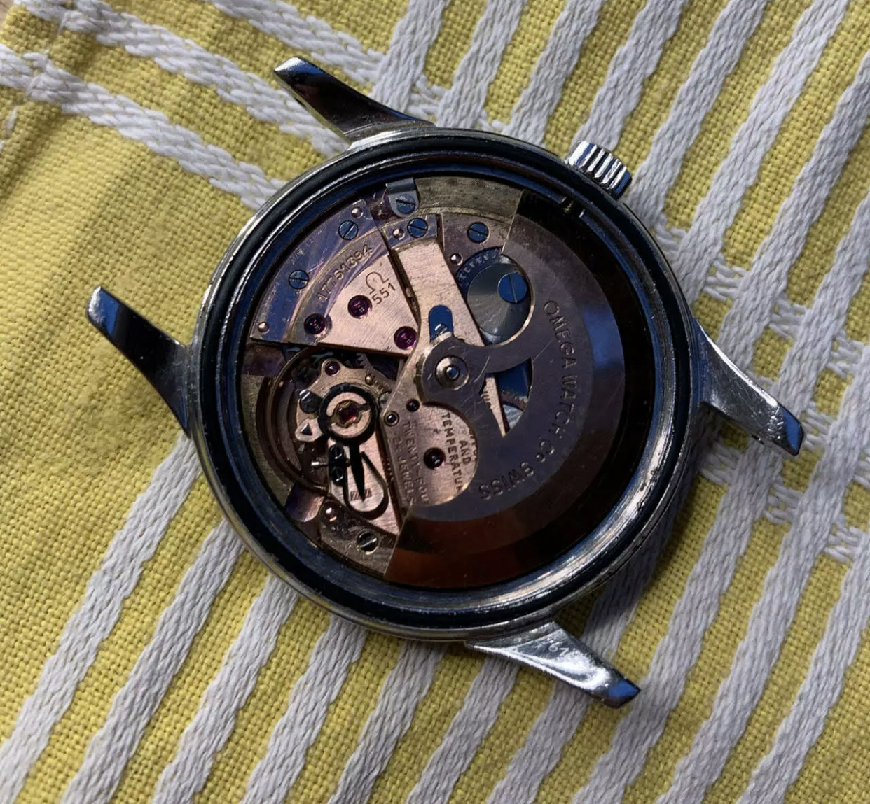

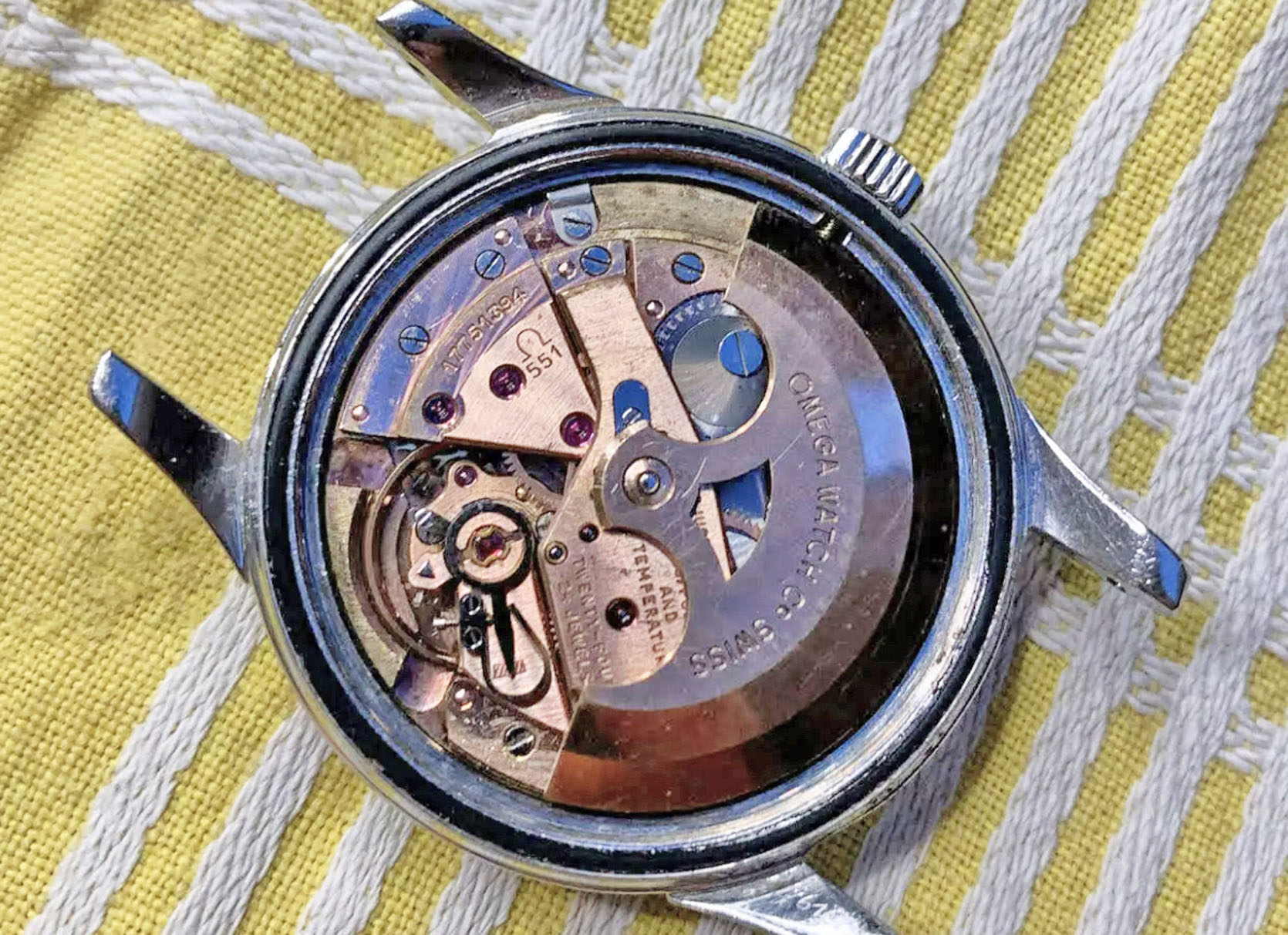

FWIW, this is the movement picture provided by the seller. Even though the lighting is bad, this doesn’t look healthy.

Ohhhh. I didn’t post that because I thought the poor quality pic would annoy people too much (I obtained an extra and rather better one of the dial).
Can you see any signs of moisture damage? My first observation was that the stem seemed to end as soon as it went through the case but surely that’s the lighting?
The rotor extends to the edge of the case, that's why it looks like the stem is short - it's under the rotor. I'm no expert but that movement doesn't look very happy. The scratches around the serial number are worrying.
Thank you. I wonder if the scratches were the product of a botched service or whether they accumulated over time.

if the writing on the dial is not white on this reference, be careful. you have only 4 hours left to make up your mind..... Good luck !
Again, others will know better than me but my first assumption is that the scratches are rotor rub as a result of the rotor being slightly misaligned. The watch may have been knocked or dropped at some point perhaps.
I don`t expect them to be scratches. looks like the plate finish to me.... movement is ok, i guess.
