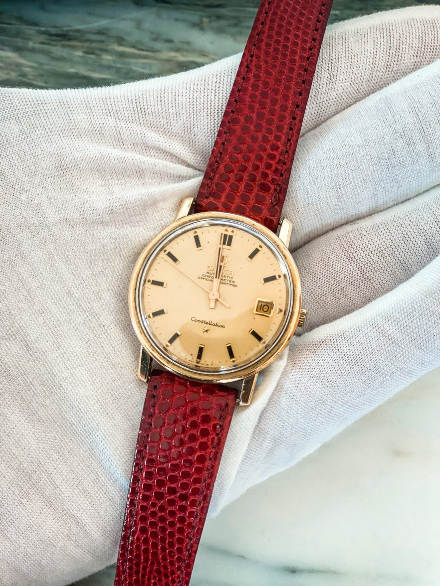

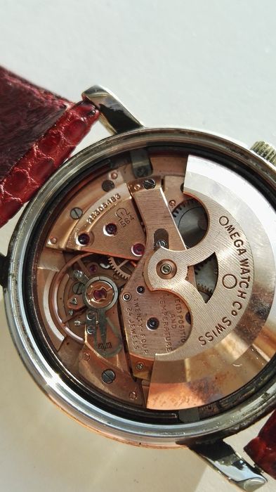

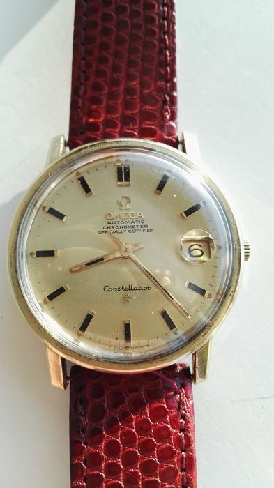

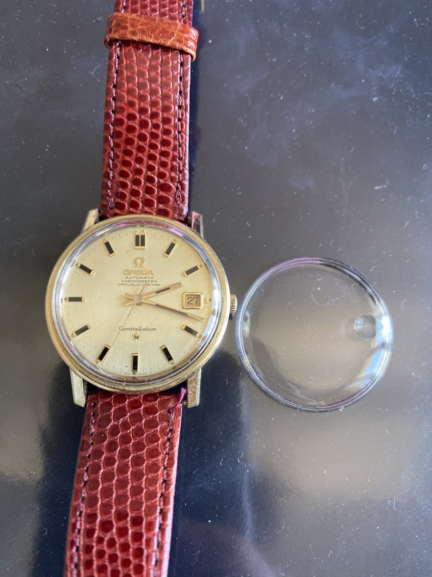

Hello Omega Experts,
I have inherited an Omega watch from my grandpa and I only have the following information:
Omega Constellation
1960 - 1969 (based on serial no. 25305483)
Calibre 564.
Gold-plated case - Generic crown.
I seriously have a doubt on authenticity and I did not manage to get any papers.
Can you please assist me to find out some details regarding this watch?
Authenticity, Exact Year , Value ? ... and also advices on watch straps ?
Thank you,
Hoot_Novice.

Welcome @Hoot_novice
condolences on the loss of your grandfather

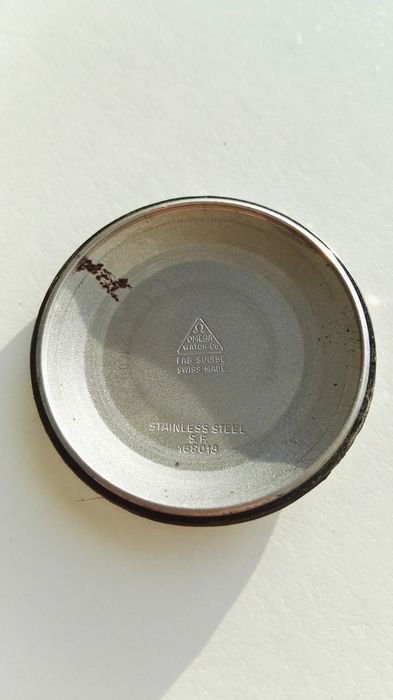

perfectly genuine Connie - so, congratulations on your inheritance.
The reference is in the case back - 168.018
Late 60s (‘67/68/69 ish)
it looks correct but would need sharp pics of the dial to be sure.
Did you change the crystal?
Probably needs a service and definitely needs a caseback gasket.

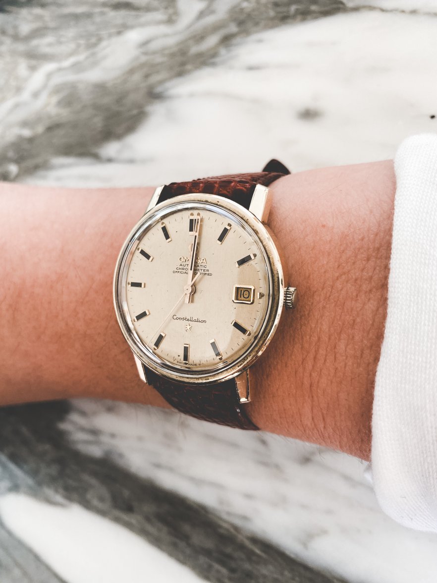

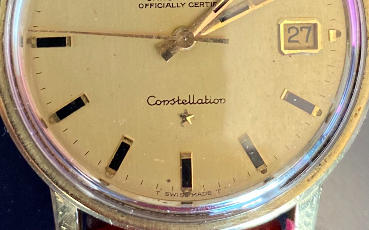

Thanks a lot @Peemacgee for your prompt response and for your condolences.
I must say that I'm proud to own this nice vintage and epic watch, so you confirm it's an authentic Omega ?

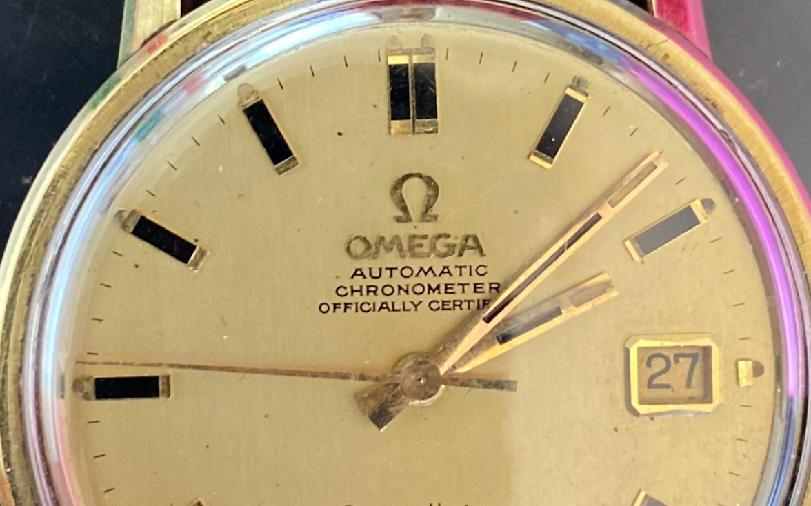

Hereunder more pictures of the dial.
I didn't change anything on the watch but I found it with old crystal, so maybe he has changed it before ?

the only dumb questions on this forum are the ones you didn’t ask.😉
definitely authentic - and I’m fairly sure the dial is fine (these particular Connies have a slightly peculiar font all of their own)
I see, you have two crystals - which explains the cyclops in the first pic, then without in the later pics.
Mechanical watches do require servicing as the oils dry up.
your watch is definitely worth servicing - these watches were the creme de la creme of Omega watches in their day.
Serviced regularly, it will likely last another 50 years.
How long it takes and how much it costs depends on where you are and who you use. Allow roughly 200-300 (£/€/$) as a cost for a service (But for your watch I would allow an extra ~100 to replace the crown and crystal)
if you let us know where you are (country will do) you may get some recommendations for a watchmaker.
Hope that helps.
ps if you’d posted this thread in the ‘vintage Omega’ section you may have received more comments.
