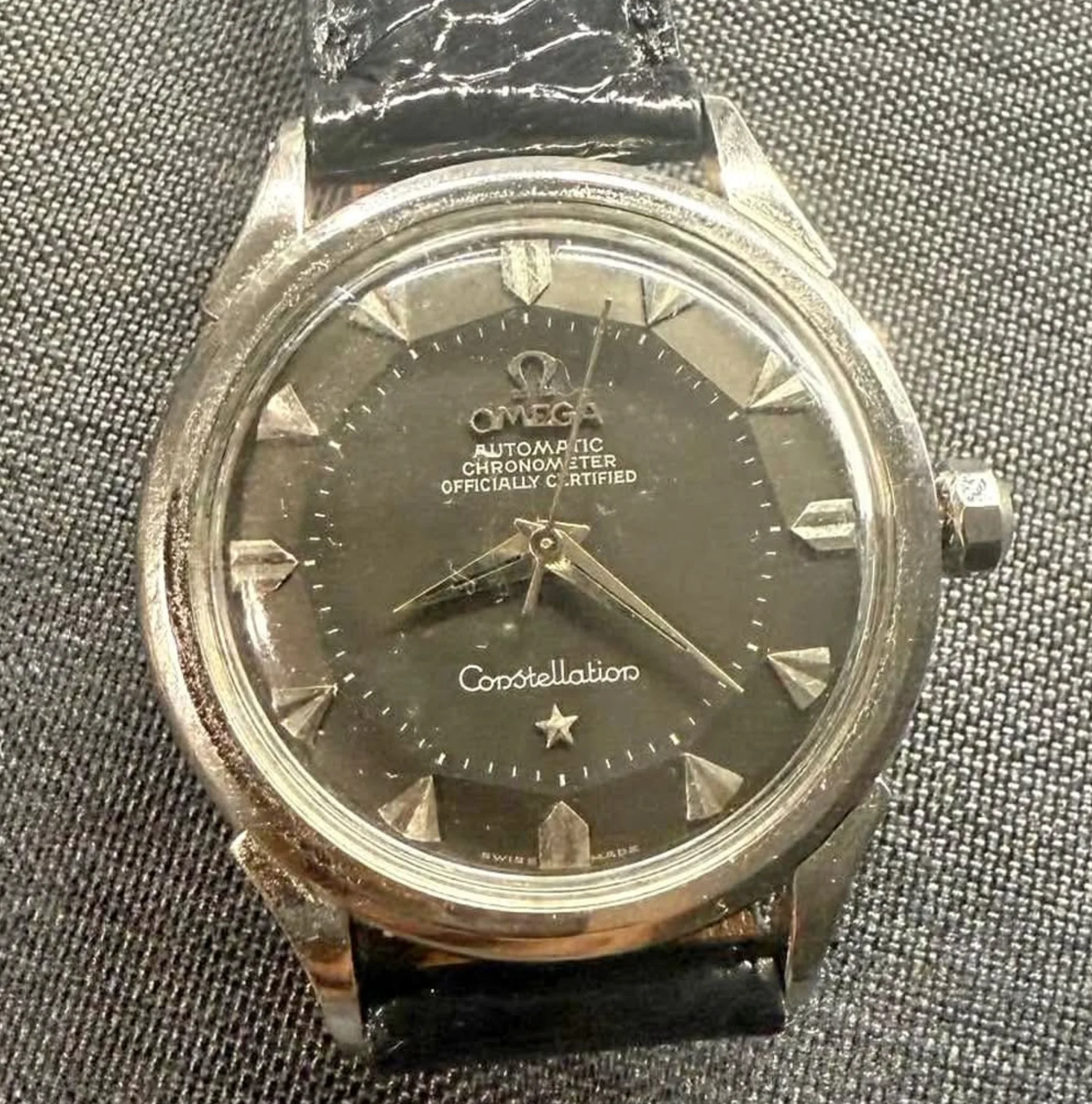

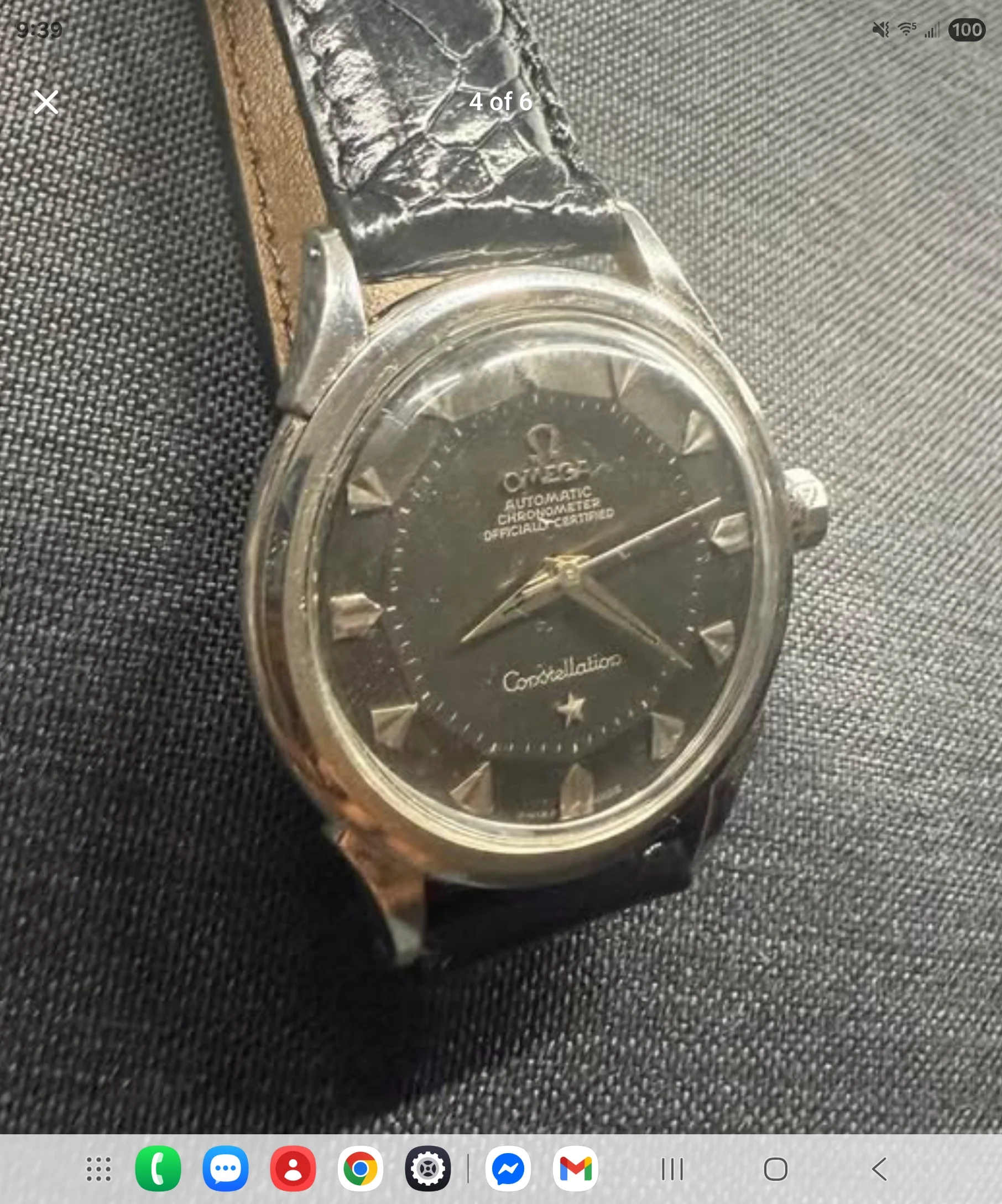

Hi. Quick ask! This came up as an opportunity for purchase, but I have never forayed into the realm of Constellations. This is a 2852 with a 501 movement and serial number dates to 1955. Is this a redial? I'm divided whether or not to drive 2 hrs to see it in person to purchase.
8,571
61,118
blurry pix of the dial, but it looks tired and worn out, same for case and movement.
gotta see better pix of the dial....but fonts appear ok
comes down to price and if you like the appearance in hand

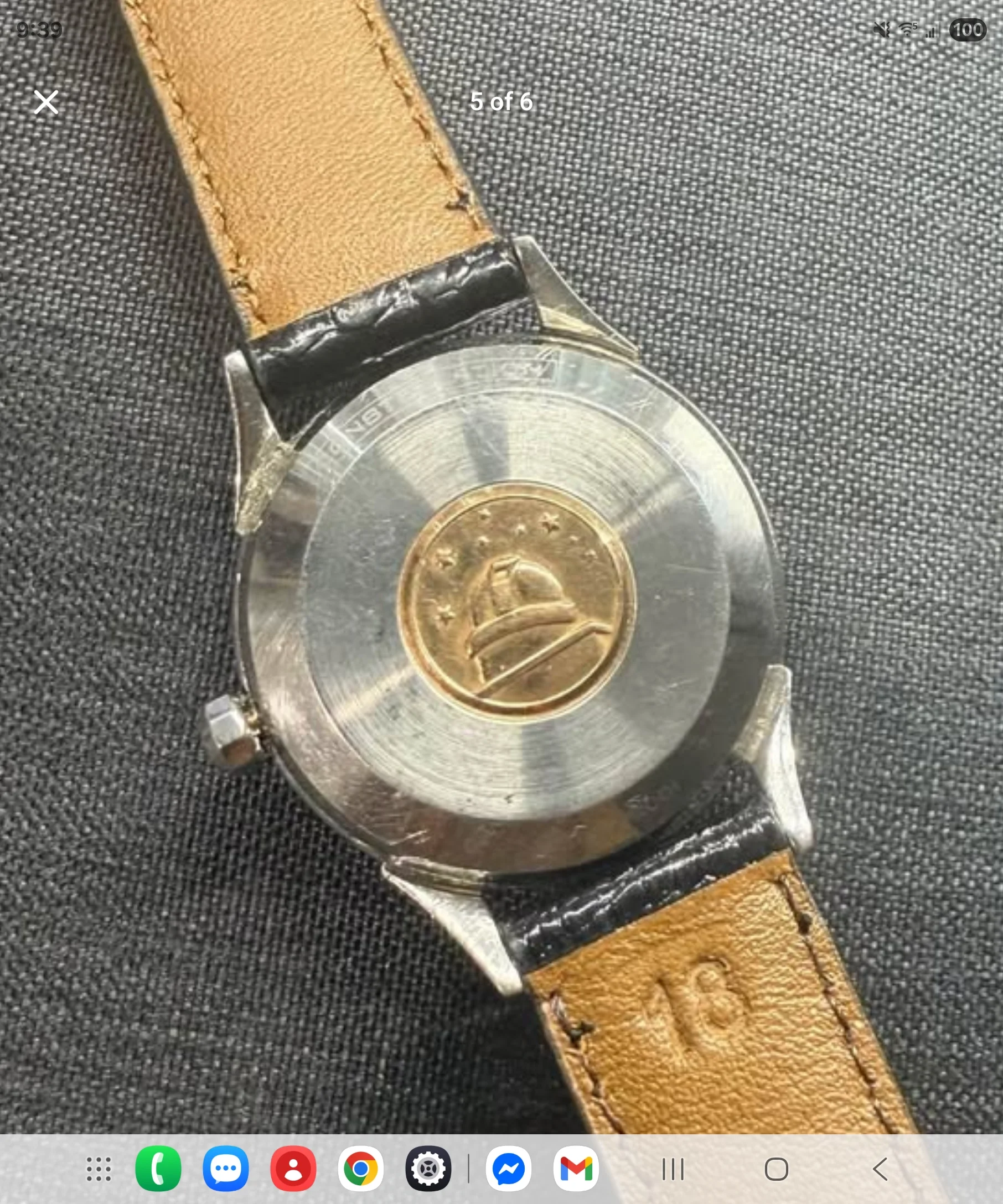

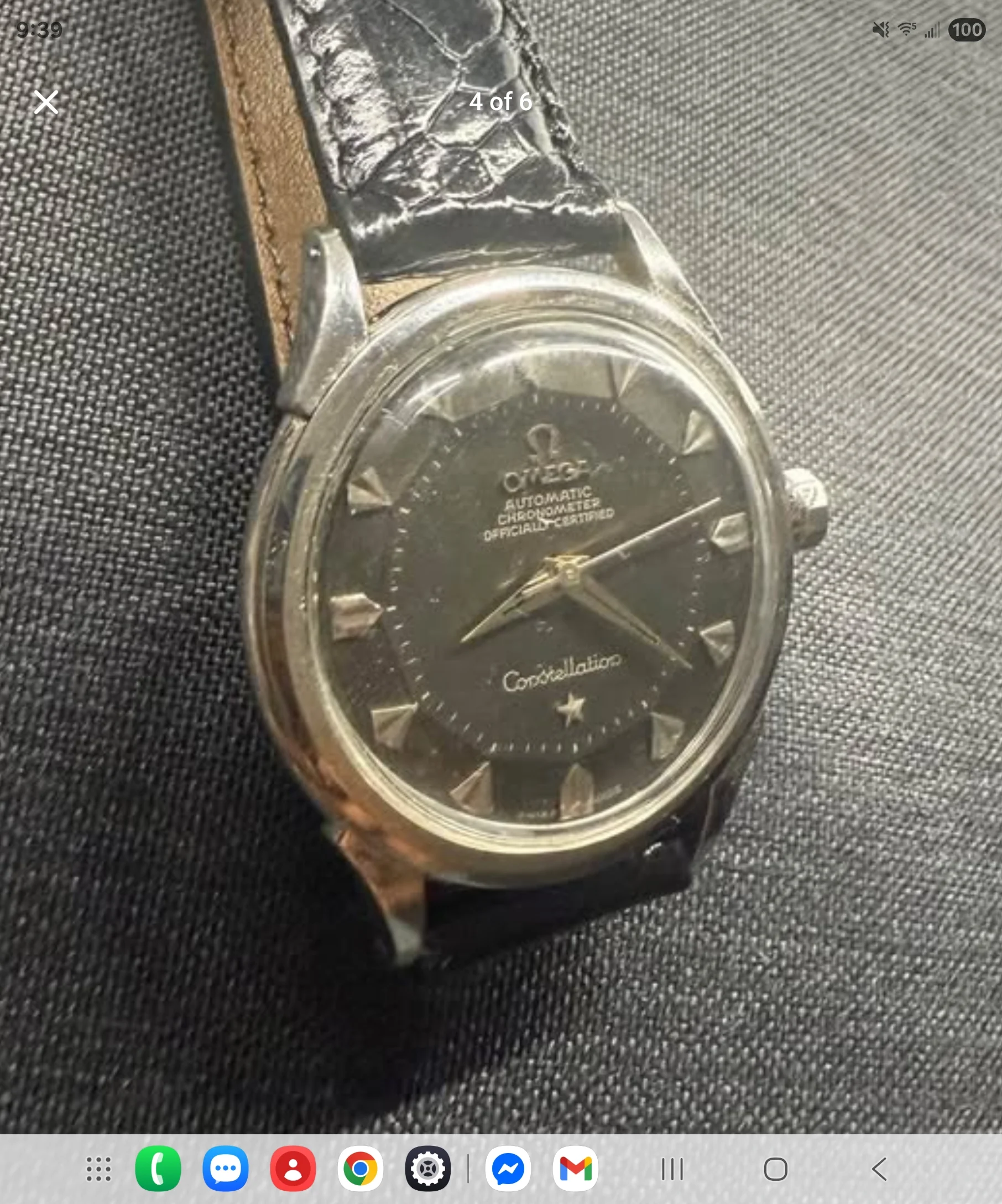

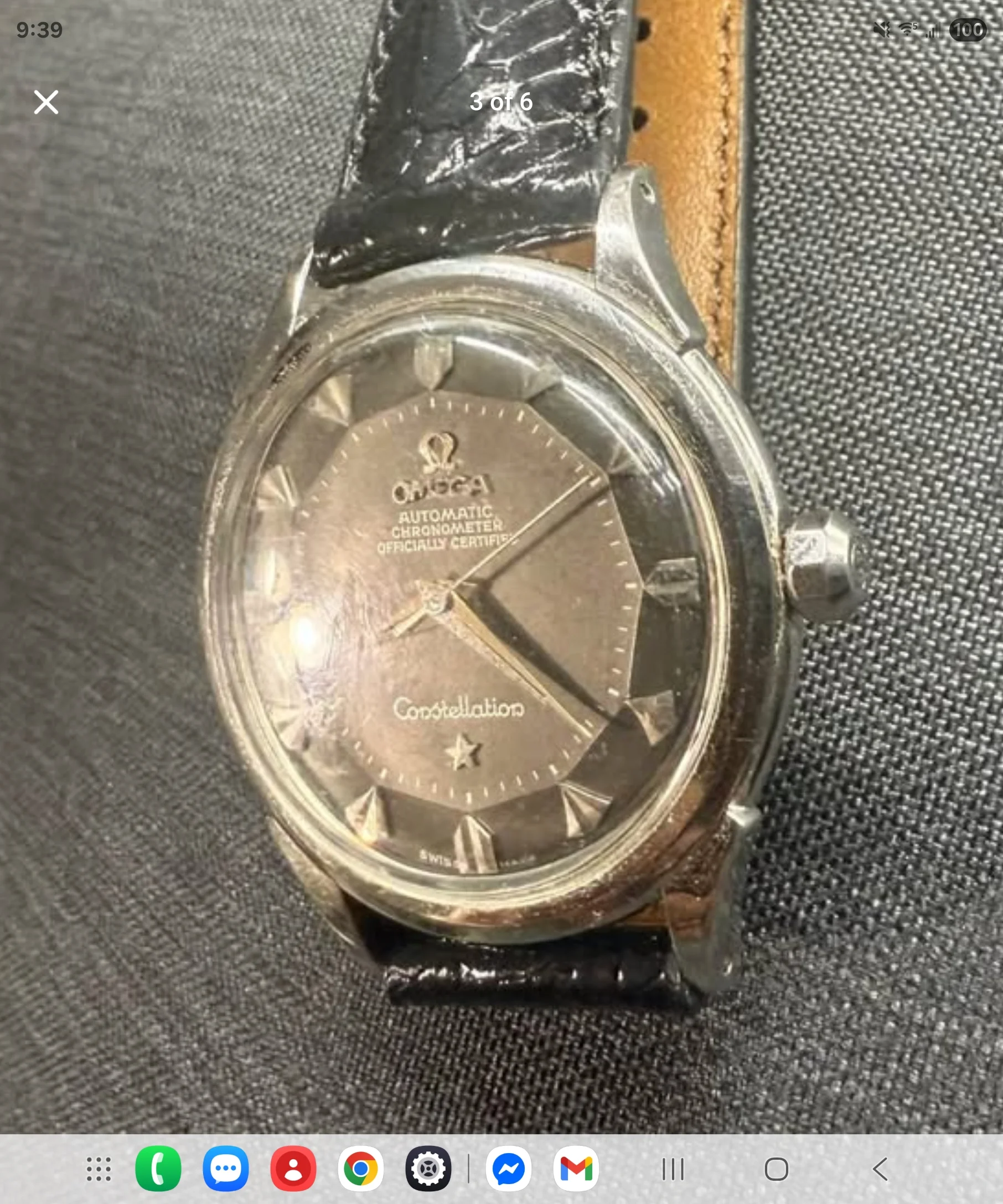

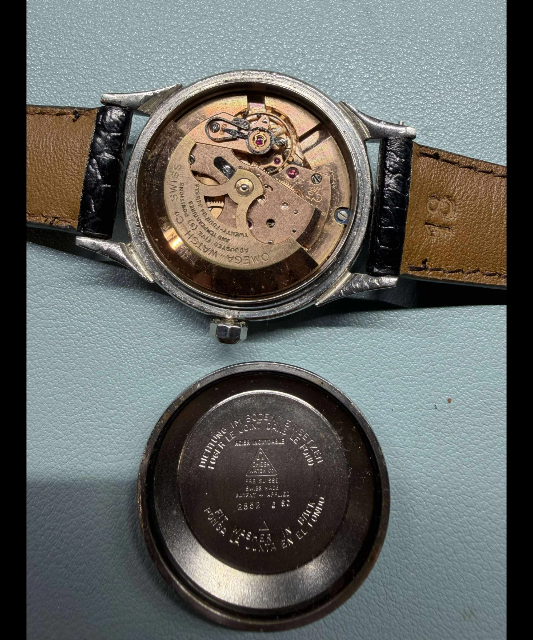

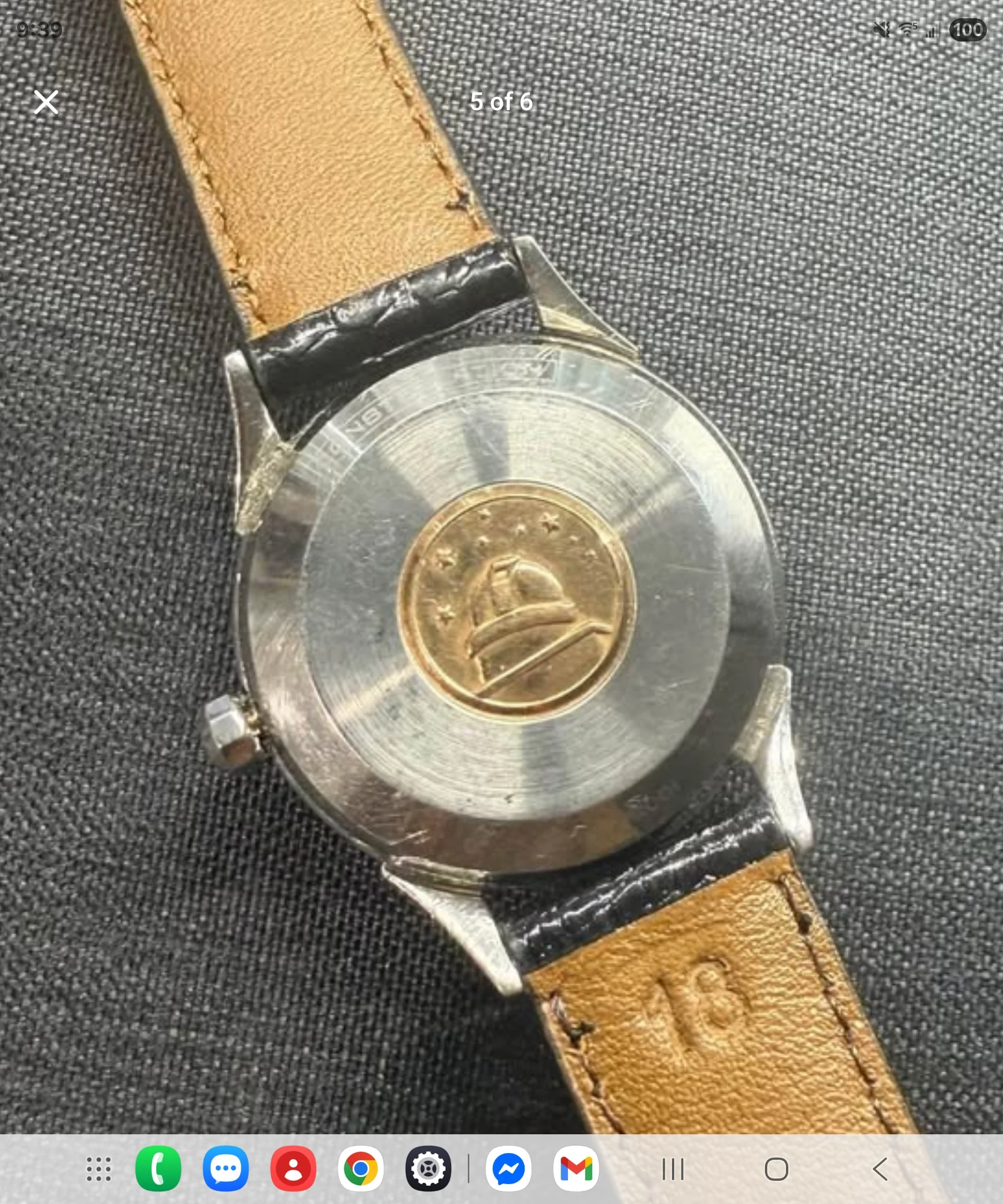

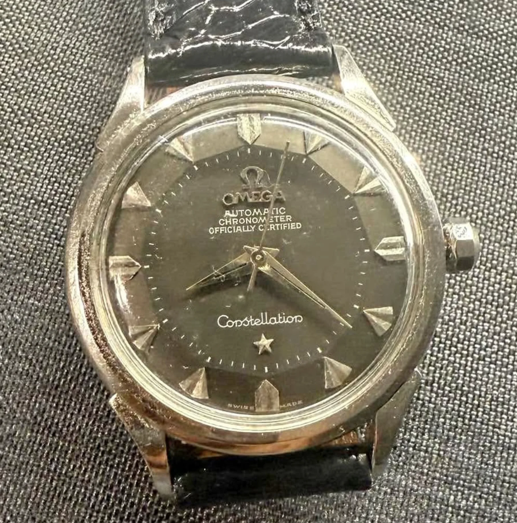

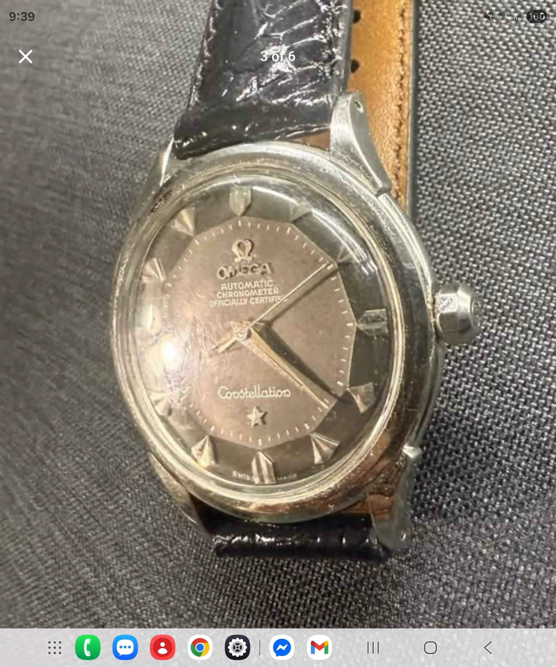

He also sent these pictures. Originality is what I want. Price is good. Effort is high due to the drive.
44
64

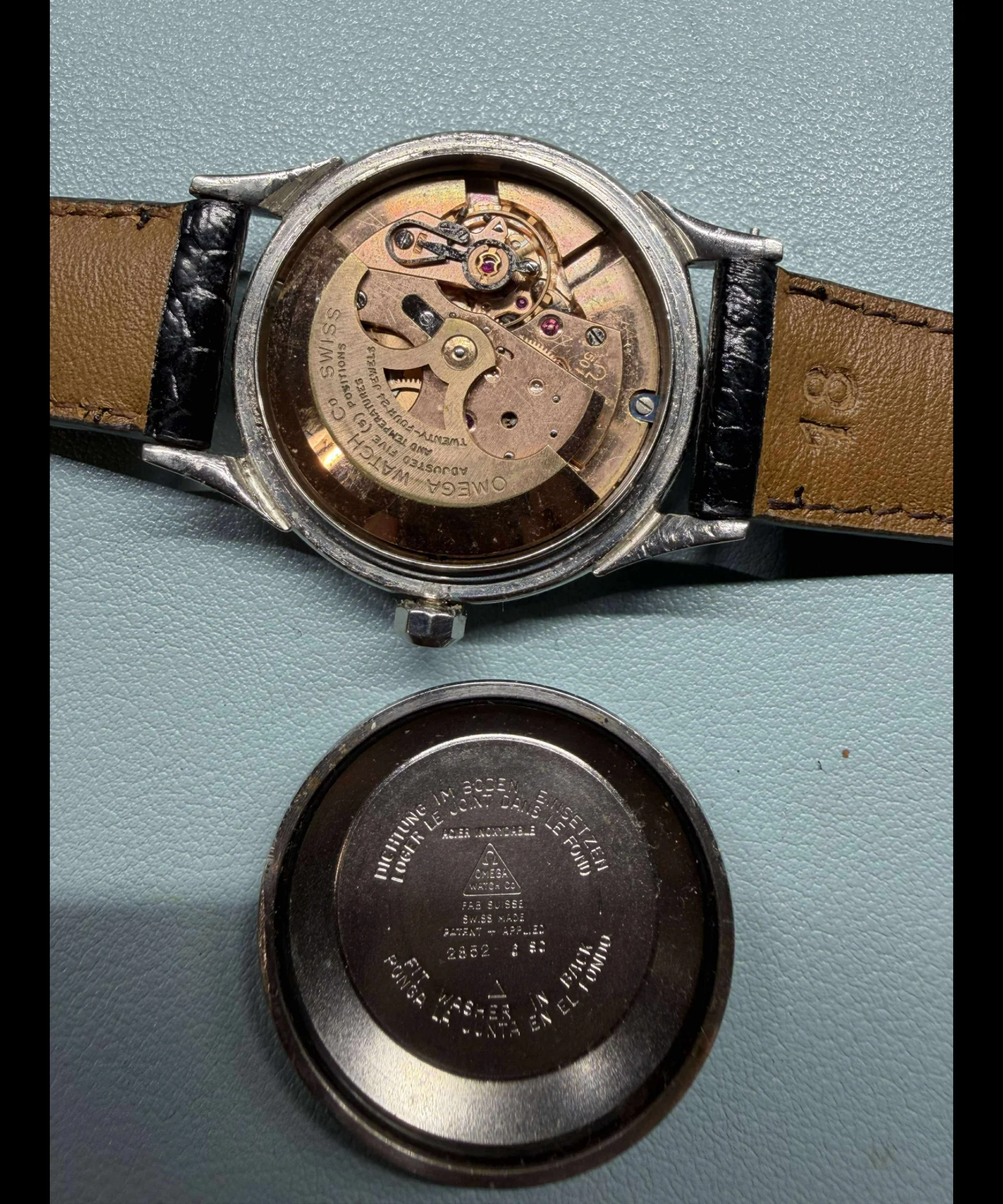

I think the calibre 501 was a 19 jewel movement, and later upgraded to a 20 jewel movement. The rotor shows lettering for ‘24’ jewels, which would make it a replacement from a calibre 505.
I would also think the spelling of ‘Chronometer’ on the dial would be ‘Chronometre’ for this reference?

It may clean up, or not... some risk there.
It will need a service for sure.

The 501s appear to be "chronometre" and are 19 jewels, maybe this watch has a service rotor and dial?

Definitely looks like a parts watch. For what it's worth, the hands are also incorrect. A 2852 with non-luminous arrowhead markers would not have slots in the dauphine hands for black paint or luminous material. Also, the seconds hand shows a visible raised rivet and stub point, which is also incorrect.

It was redialed, in my opinion.
For me, the fonts and the minute markers are thicker than usual.

I second this. It’s certainly not the worst one we’ve seen but I don’t believe it’s legit.

I also initially thought redial. Can you ask for photos of the dial in natural light before you make the drive? If it’s a redial, it’s a good enough one that you may not even know if it’s a redial in hand.

The dial looks matt grey. I've never seen an original black dial age like that before. I'm not convinced at all.

Yes, agreed. And text doesn’t appear to be gilt. Hands have lume slots but no lume on dial. Pretty sure the crown is a fake.
