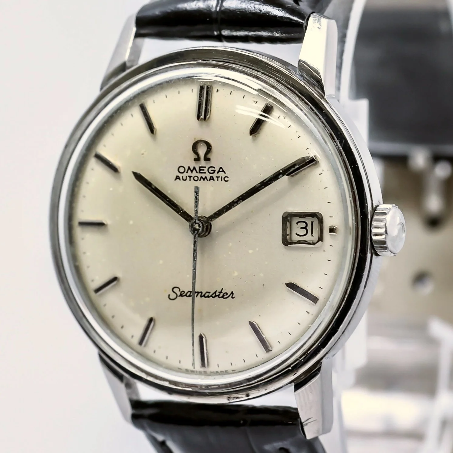

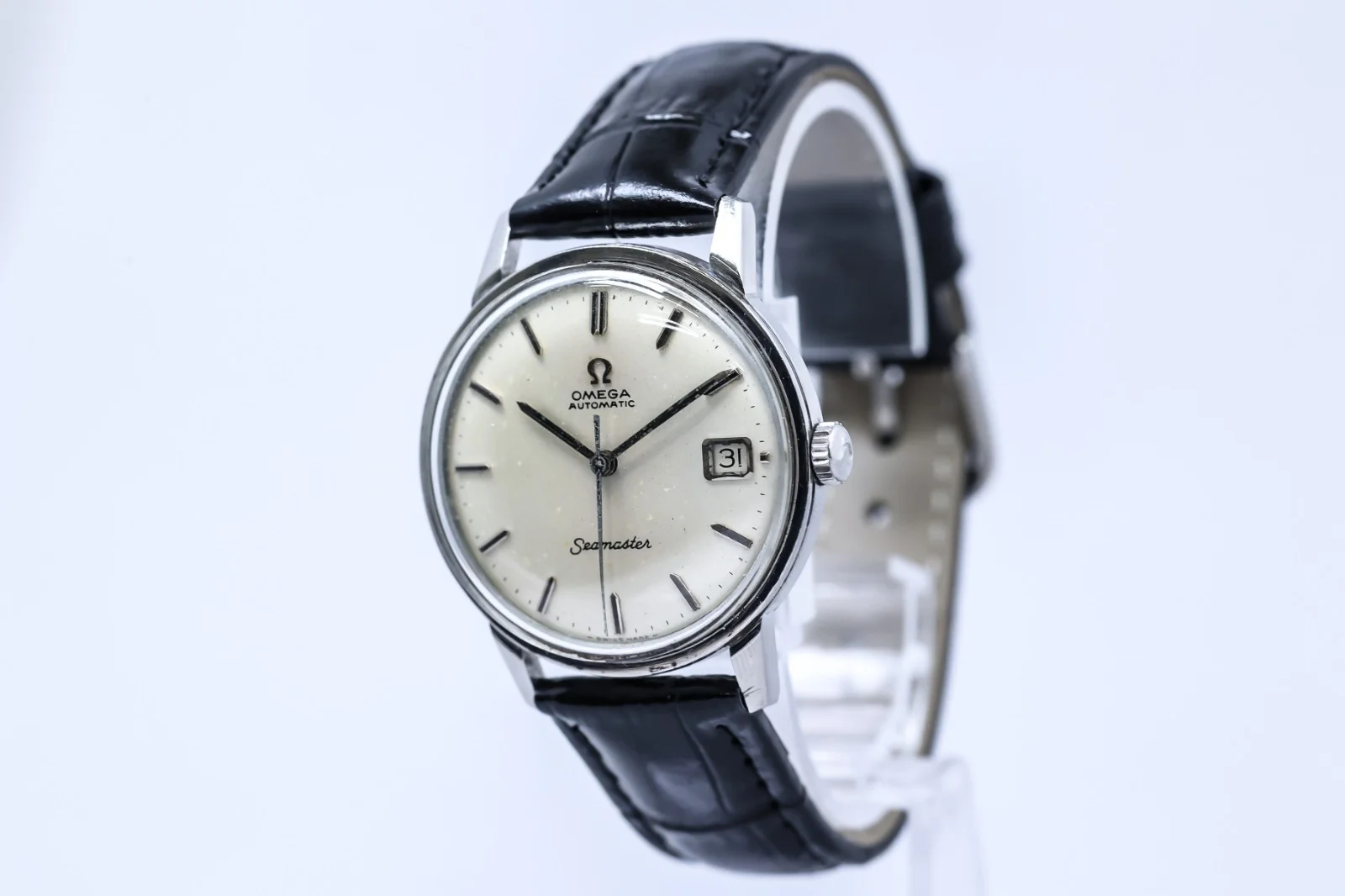

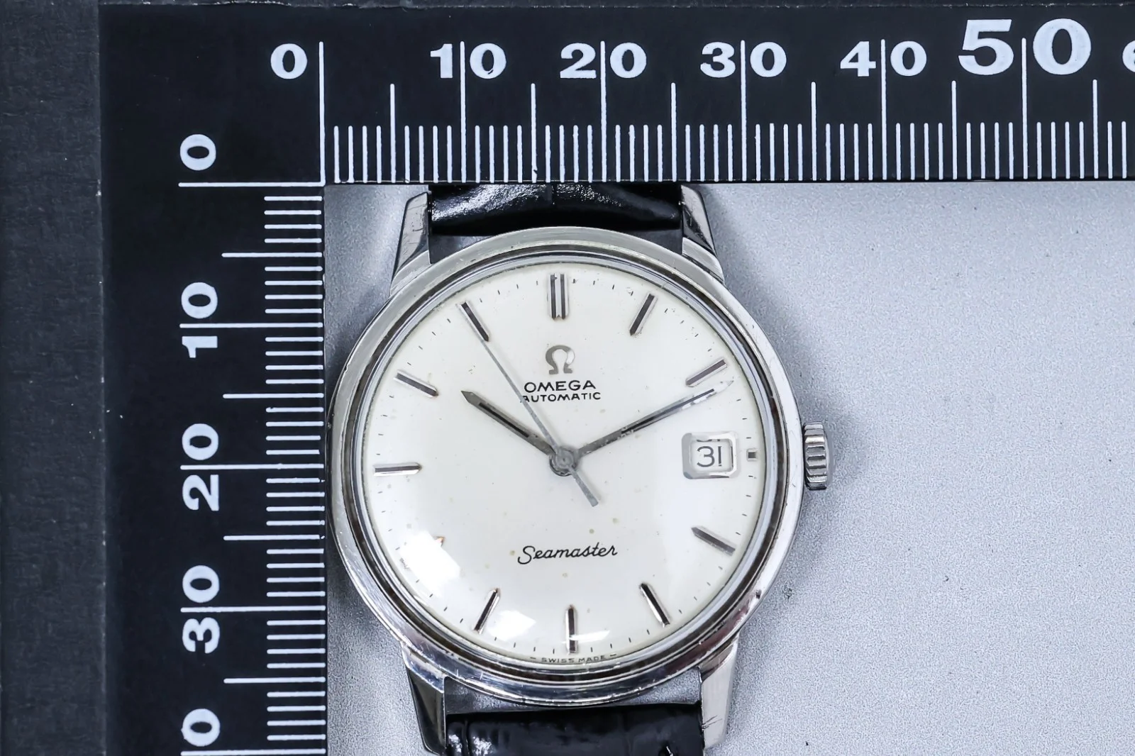

Hi everyone,
I recently bought this (166.002) from a Japanese seller on Ebay, and i want everyone's opinion on the dial if its repainted or anything, because the letters look slightly thicker, can this be caused by age and humid climate?
Thanks,
557
2,034
I would say this is a complete redial.
The writing is very thick and inconsistent. Also no serif.

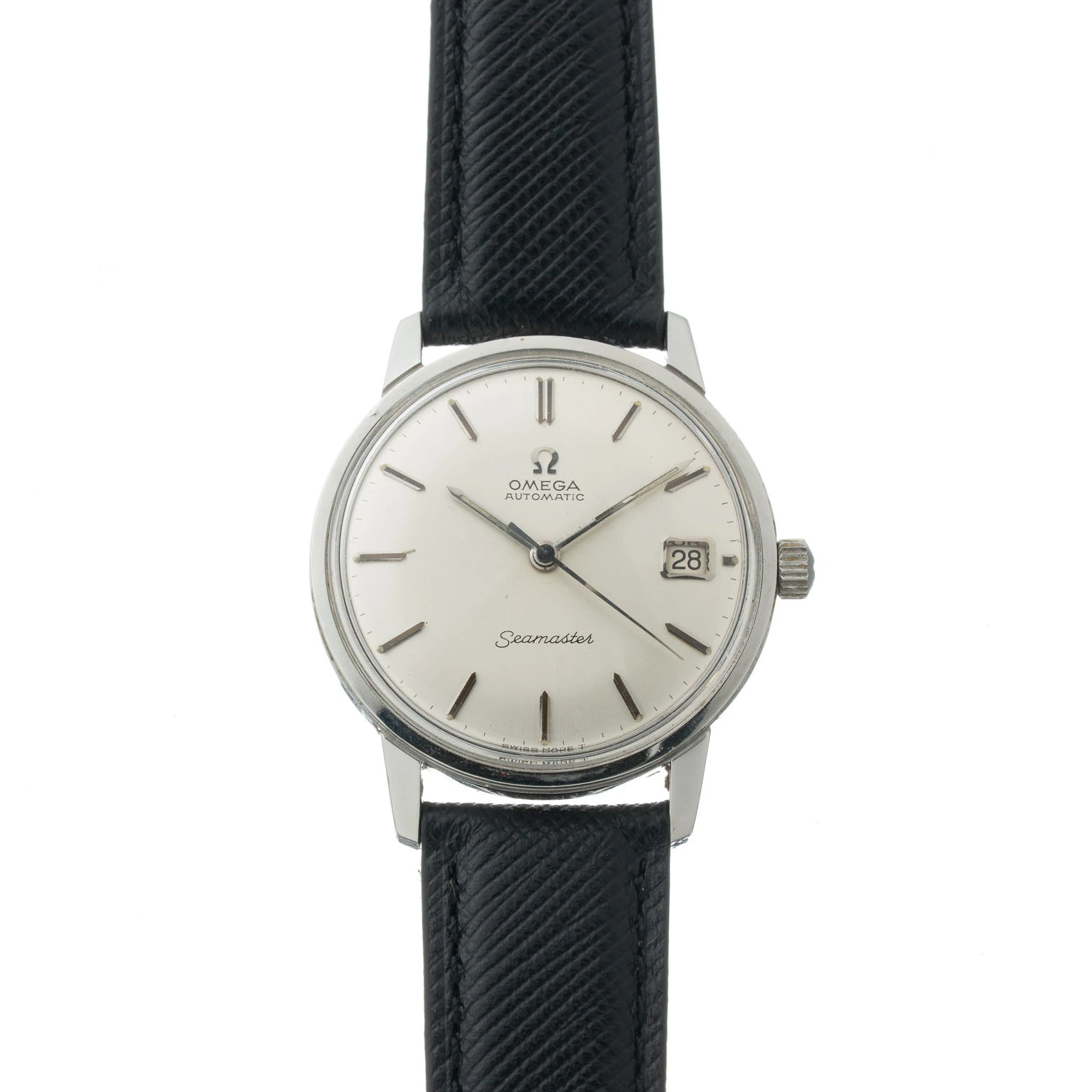

Here is an original dial for comparison:
Even if you look at the small minute markers on the 2nd picture you uploaded. They are spaced unevenly at 12 or 9 o’clock for instance (one is closer to the big cardinal marker).
