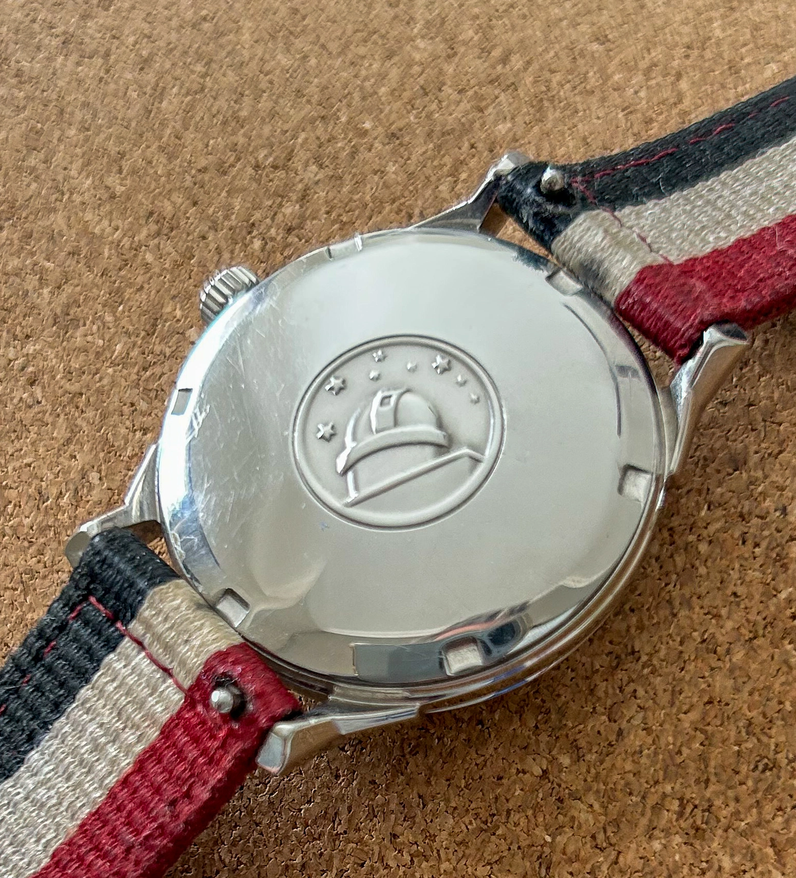

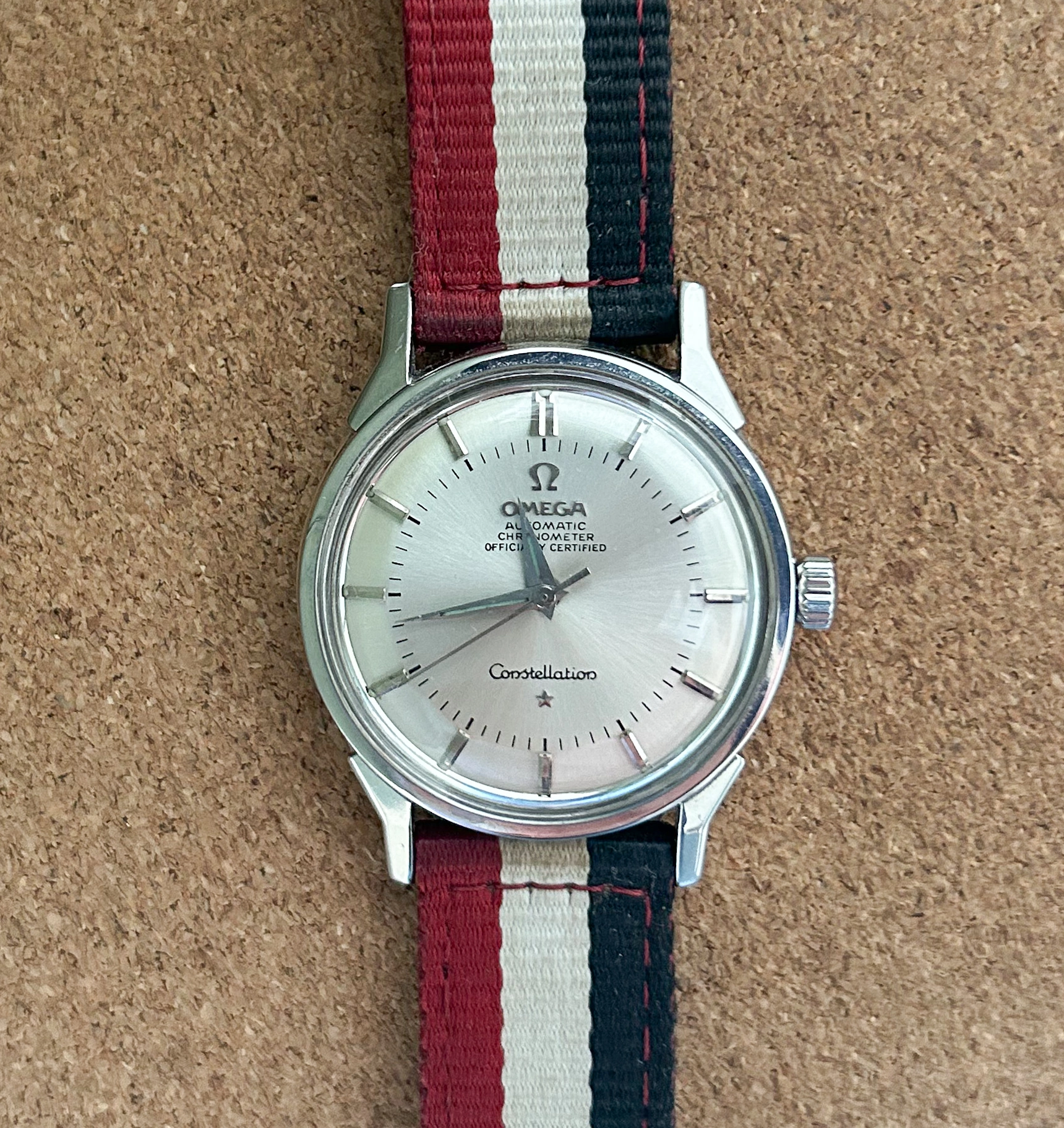

I am looking to build a small vintage collection . Have just started out and have very little knowledge at this stage.
I have this really clean and neat Omega , was told it's not an original Omega.
What type of Omega is it?
I used to have a Panpie, which was in the shop for a service and they were robbed. I had no insurance, the watch shop then gave me this watch as a replacement, not knowing much accepted it as it is in fine condition.
I think the dial has been refurbished heavily.
To my untrained eye, I think it could be a Panpie face overhauled.
I think I can just see the sharp edges on the dial- which are now very soft.
The minute markers seem slighty too long compared to other images.
Any feedback would be great!
Thanks Adam - South Africa

Dont look like a piepan dial to me
432
1,045
Case looks over polished, the seconds hand looks too long to me, missing "Swiss Made" text.
3,615
7,838
Information regarding case reference and movement are inside Caseback and on movement.
13,521
23,460
Not a great watch imo. If yours was a nice one this is a poor substitute as the dome dial has been refinished and the case polished.

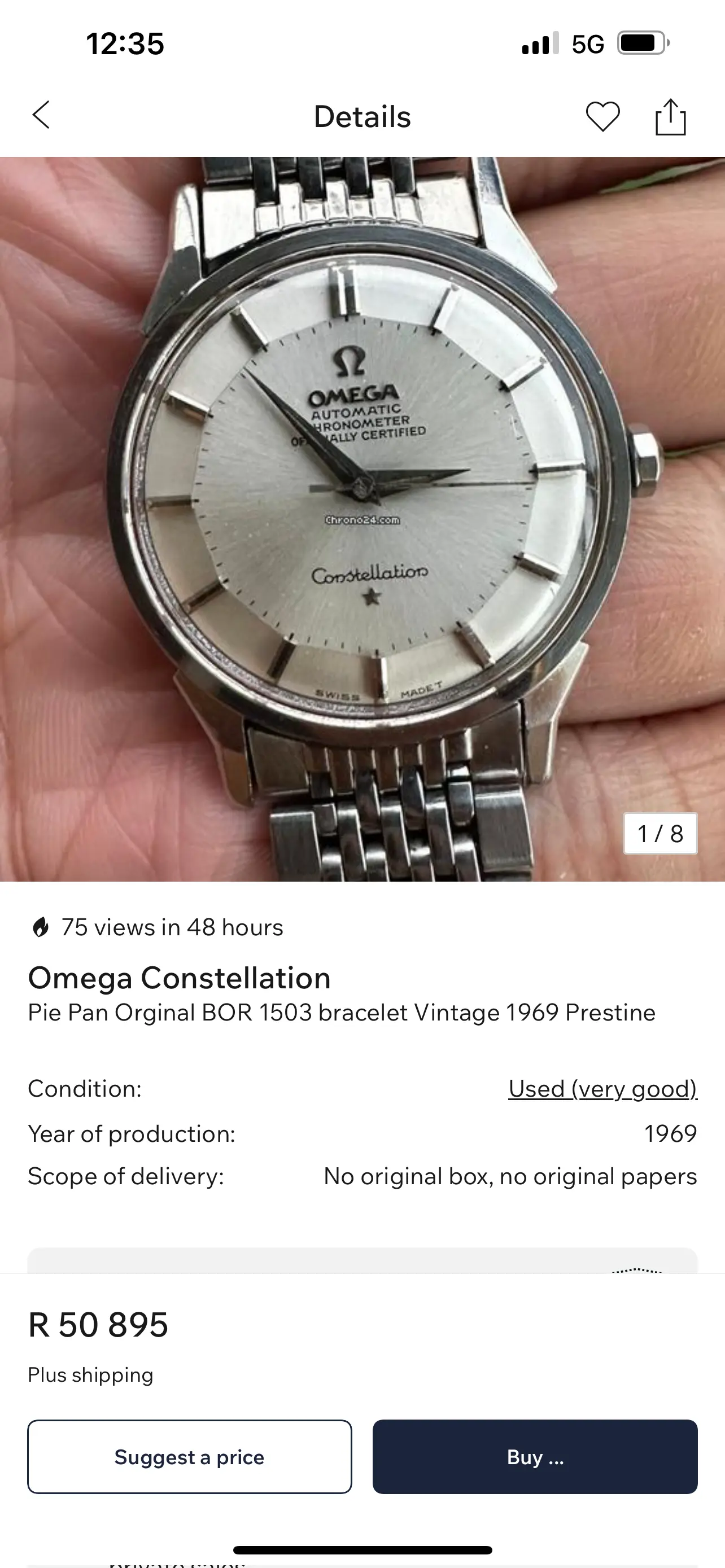

I think it is an Pan Pie , I have looked for examples on Chrono found 1 that I think is close.
Specs are all the same , as the below info from inside my watch, image attached of Chrono sample.(and case lugs also look the same)

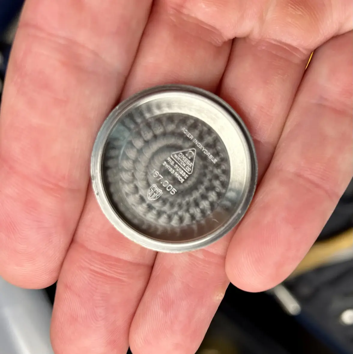

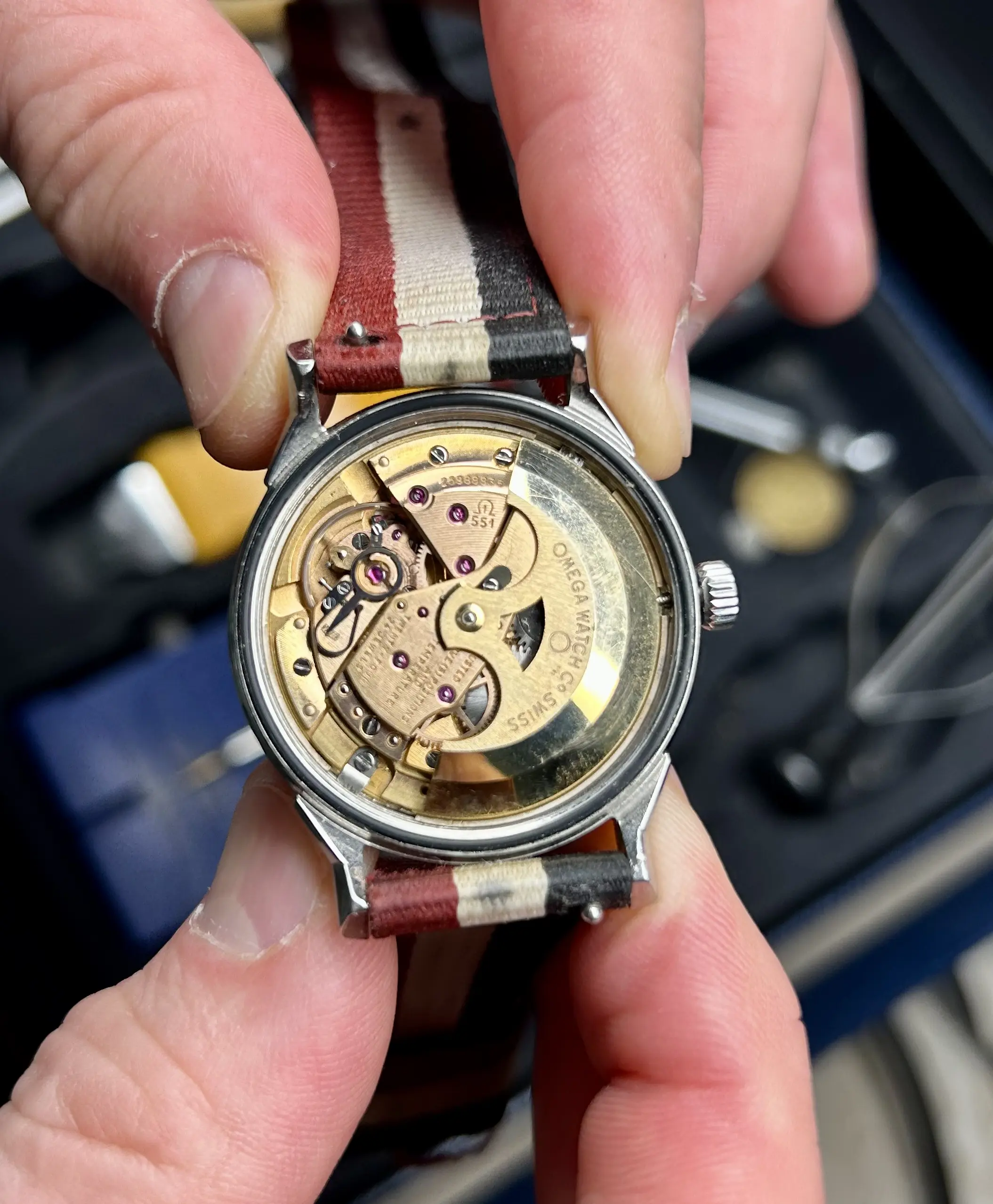

Took it in and Opened it up .( images attached)
167-005
551 Cal
24 Jewel
Serial number: 25988835
Is there a way to check this serial number and possibly advise what the original dial was on this model was ?
Will I be able to find one?
Is it worth replacing the dial? or look to buy a more original one and accept this one for what it is?
