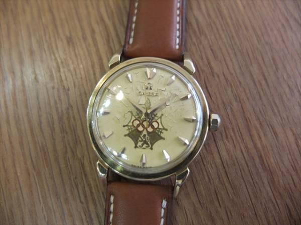

Hi is there any way to get this dial repaired ? Would also appreciate any info on this watch . Regards
1,138
322
The dial can be repaired however I doubt that it is factory original and may not be worth the effort or cost
involved.

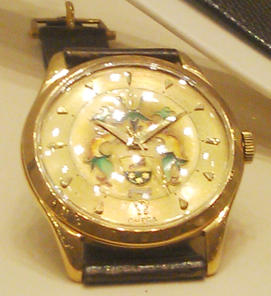

What a loss !!!!! It supposed to be similar with the coat arm cloissone in museum below:
Can you please post a pic. of the back of the dial ?

Yes I know but what's done is done , it will be great if I could get it restored.

cloisonne dial, you say...
btw I am in a process of thinking to release it ....
This is a legit example!
And yes, it could be restored (at least partly) - but will be a costly path I guess.
Depends on the condition of case and movement if it is worth to go it...

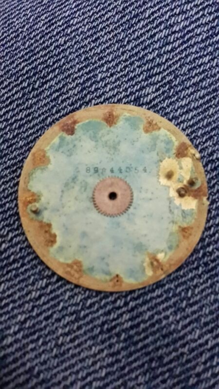

Pic of the back side
Looking at the photo of your dial I thought that may be it was poor imitation of vitreous
enamel dial. Now looking at the back I see that it has counter enamel that is always used
with vitreous enamel work. What threw me off at first was an image that was not as artistically done
as other Omega dials. I can suggest someone to you who may find you someone to work on your dial.

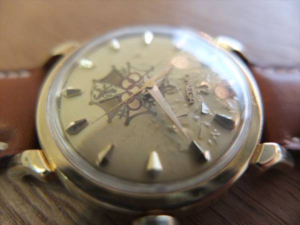

Baoquang ..... I am tempted to release pic s of the other cloisonné dial watch that I have ....lol
445
155
It's case ref 2624 and 283 movement , both are in good condition .....

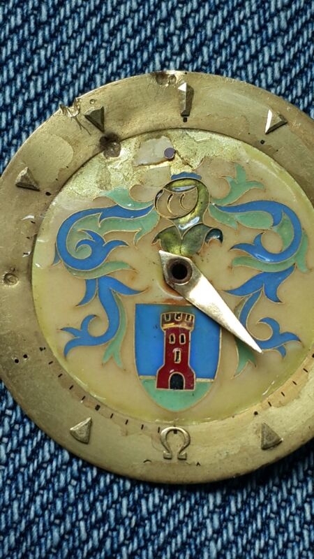

Hi, Baoquang.
Here's a video that may interest you. The same dial restored from the same condition as your watch.
7
10
I would like to thank Sohail for the opportunity to restore his dial.
And for all other users and guests I've prepared a video slideshow showing step by step how we restored the beautiful dial.
Enjoy!
