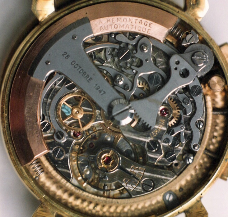

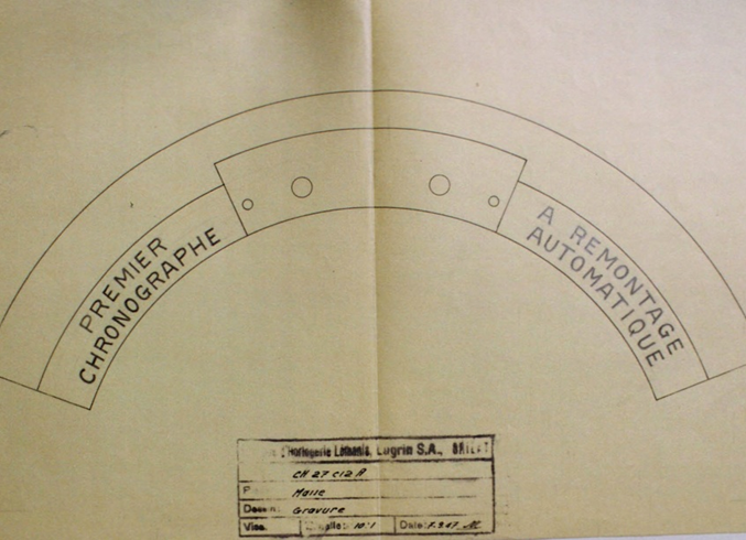

My thoughts leaps to the development of the worlds first automatic wrist chronograph, the Lemania 27CH-c12-A, completed in 1947.
As an article by Gregory Pons states it:
"Almost a quarter of a century before Zenith and Dubois Dépraz, the Lémania manufacture was working on the development of an automatic rotor chronograph, based on the famous CH 27 caliber. A pioneering chronograph that will be rejected by Omega in 1948, for fear that customers do not like the mechanical rattling of the thrust rotor (bumper!). Like what commercial conformity is a terrible handicap for brands that do not like to take risks." (Translated from an original article in french published in "Le quotidien de l'horlogerie, 23/02/2014).
Full article: https://businessmontres.com/article...hronographe-mecanique-a-remontage-automatique
Lemania never made another bumper movement, but went straight for a full rotor automatic with their cal 36xx introduced in 1951.

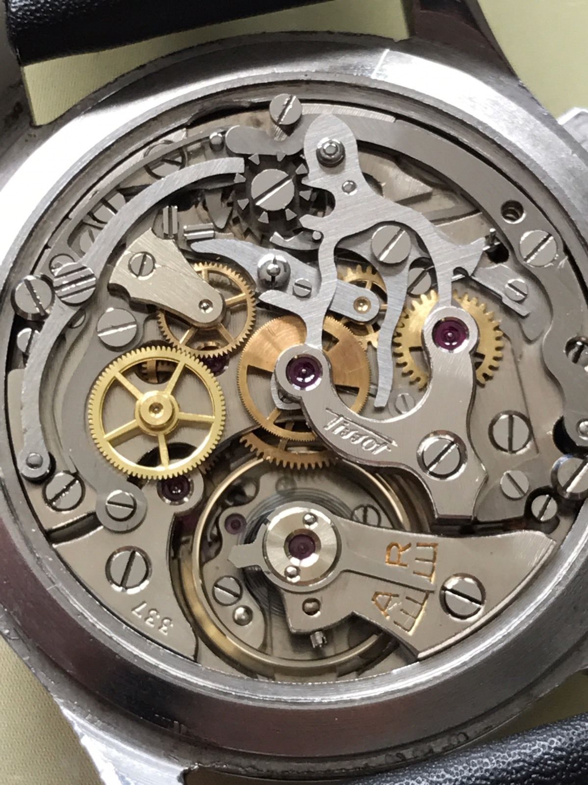

As such I would maintain that my example Lemania is a very early one.
Earliest Lemania from my photo archive is serial #337. Tissot serial dates it to 1942.
4,440
18,267
Thanks for sharing! The Lemania serial 132 is in my collection. Bought it in Switzerland some months ago.
I have always considered the CH27 to be a 1943 and onwards caliber, however looking at my caliber listings it is actually stating 1942 as first production year.
Learning something new every day!

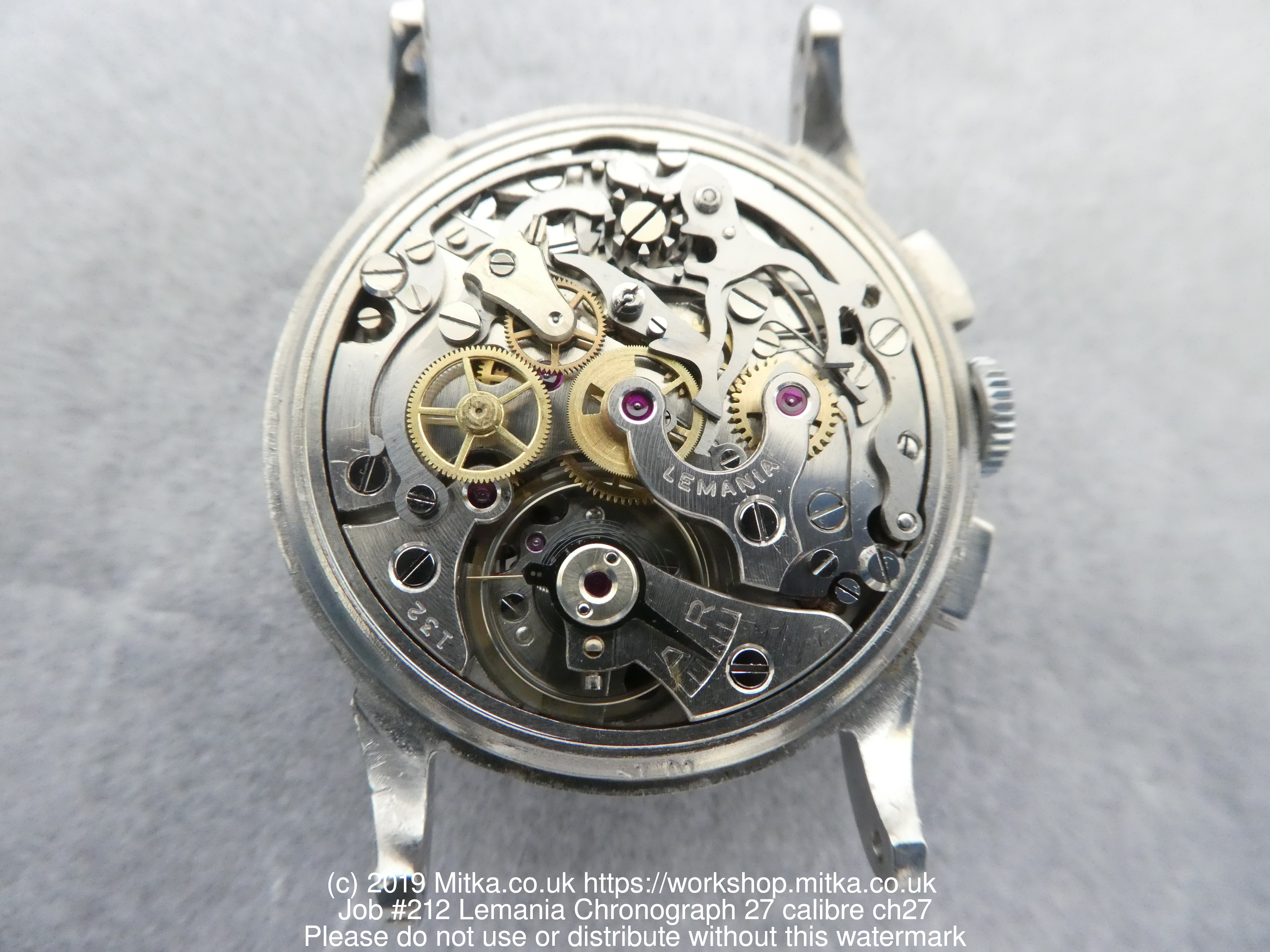

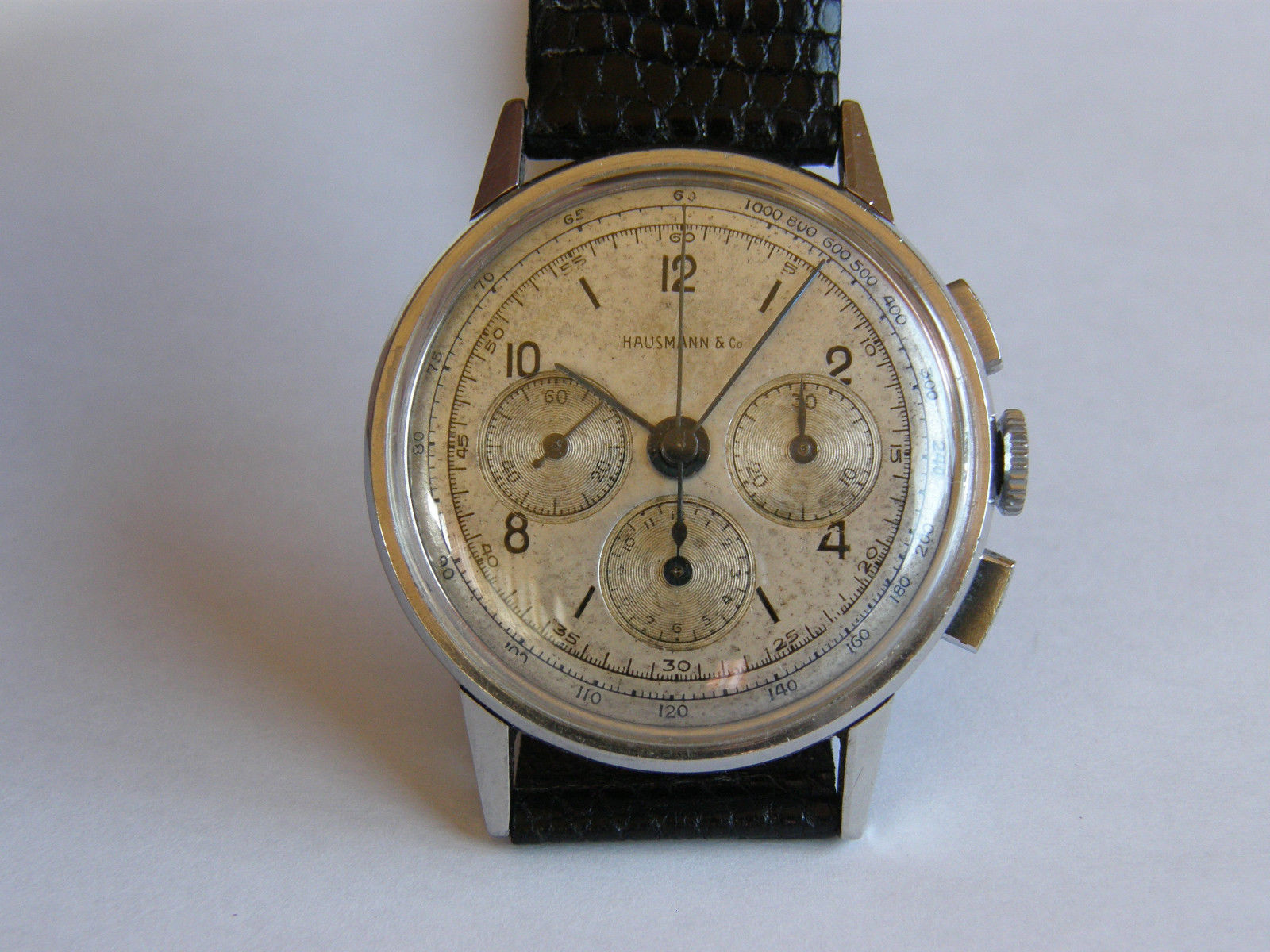

I also spotted a low serial CH27 some time ago on ebay. Dial marked Hausmann (Italian watch retailer - https://www.hausmann-co.com/):
Edit: Still up for sale here:
https://www.ebay.co.uk/itm/LEMANIA-...191272?hash=item5d8872eb68:g:CIoAAOSwtgZcBqIW
I think someone should grab it fast....
Thank you. Unfortunately the balance wheel is spinning and the type cannot be assessed.

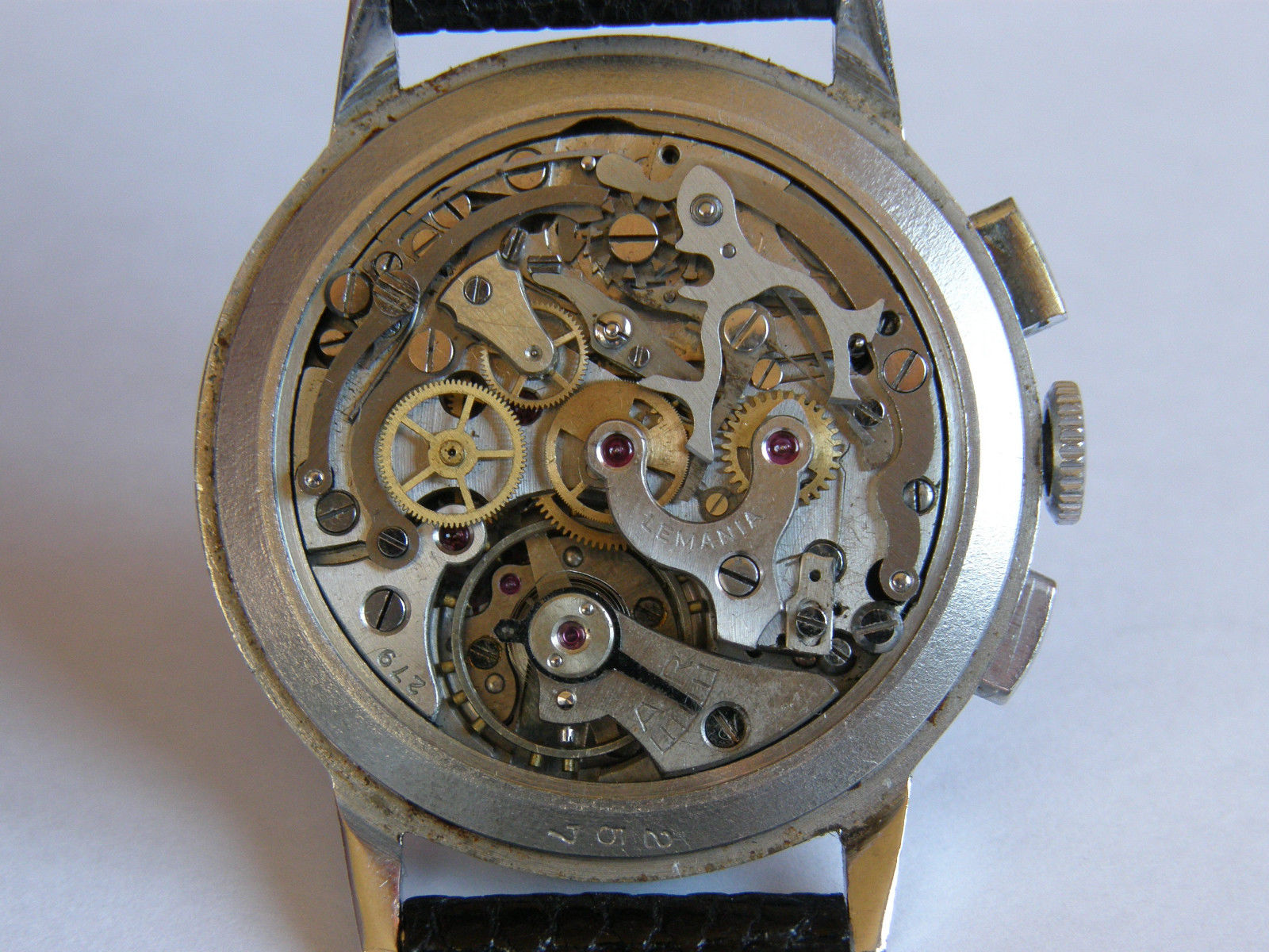

Unfortunately some parts have been improperly fixed and the movement does not look in good conditions.
4,440
18,267
True! It does appear to have been exposed to an "Italian Job".
Not entirely hopeless to get back into shape I presume, but not a mint example for sure.
The early serial does however make it interesting, and they are open for offers....
At least the balance is of nickel type.

Comparing the above, you will see that both my Lemania, and the Hausmann, has got nickel balance wheels.
I have several, relative early, CH27 in my collection, but none as low in serial as the above.
I would appreciate if you find any information that contradicts my theory.

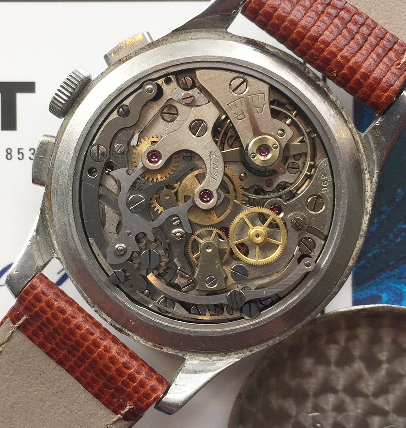

The earliest Lemania in my photo archive with a stationary balance is #396:
4,440
18,267
That is contemporary with the other Tissot movement, and has got a solid balance. 👍
As serial 337 has been confirmed by Tissot to be from 1942, I believe this is a strong indication that very early 27CH movements was delivered with solid nickel balance as well as the (Omega?) version with split balance.

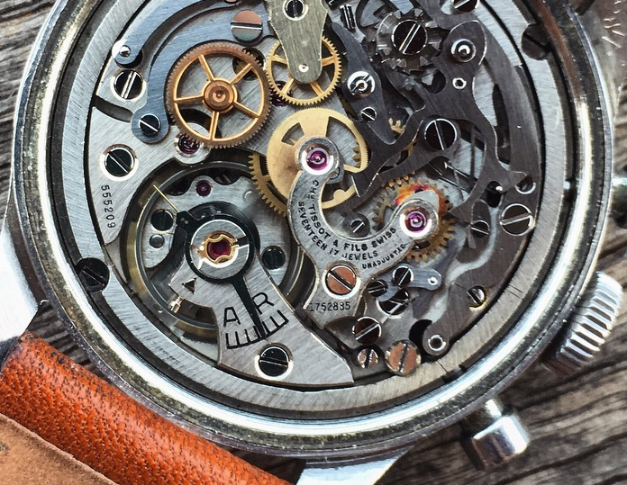

The serial numbers on early Tissot cal 27CH movements are actually Lemania serial numbers.
Later on Tissot had their own serial numbers marked on the chrono bridge as seen below.
Yes, the Tissot CH27 based chronographs have both the Lemania serial and the Tissot serial. From 1942-1944, Tissot placed their serial on the inside caseback. By 1945, Tissot had switched over to a case reference system and placed their serial on the bridge as you show above.
The Lemania #396 shown above is also from 1942 according to the Tissot caseback serial.
