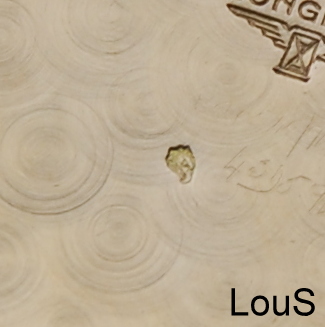

I don't think its automatic that a french market watch has a French-made case, which is what the value issue is about. I don't think the "fab. Suisse" in and of itself alters value . When you get your eyes on it, look for hallmarks. Swiss 18K hallmark is the woman's head (Helvetia). The French hallmark is an eagle's head, as shown here on a Longines case
If its got the French case, it does tend to get "marked down" by collectors, although not clear to me why other than Swiss-centric chauvinism. As far as I know, the French never got up to the gold-content shenanigans the South Americans did in watch cases.
