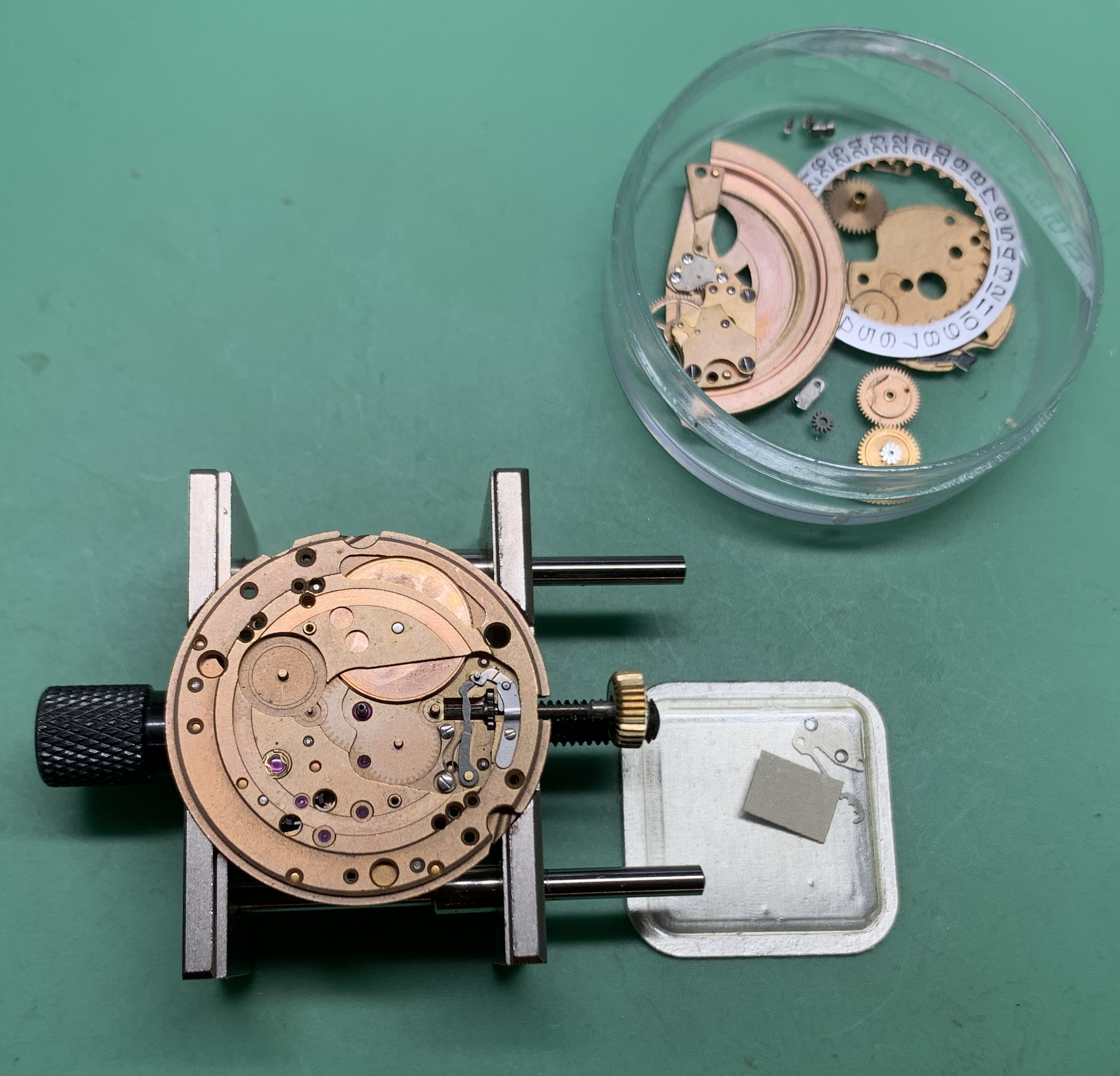

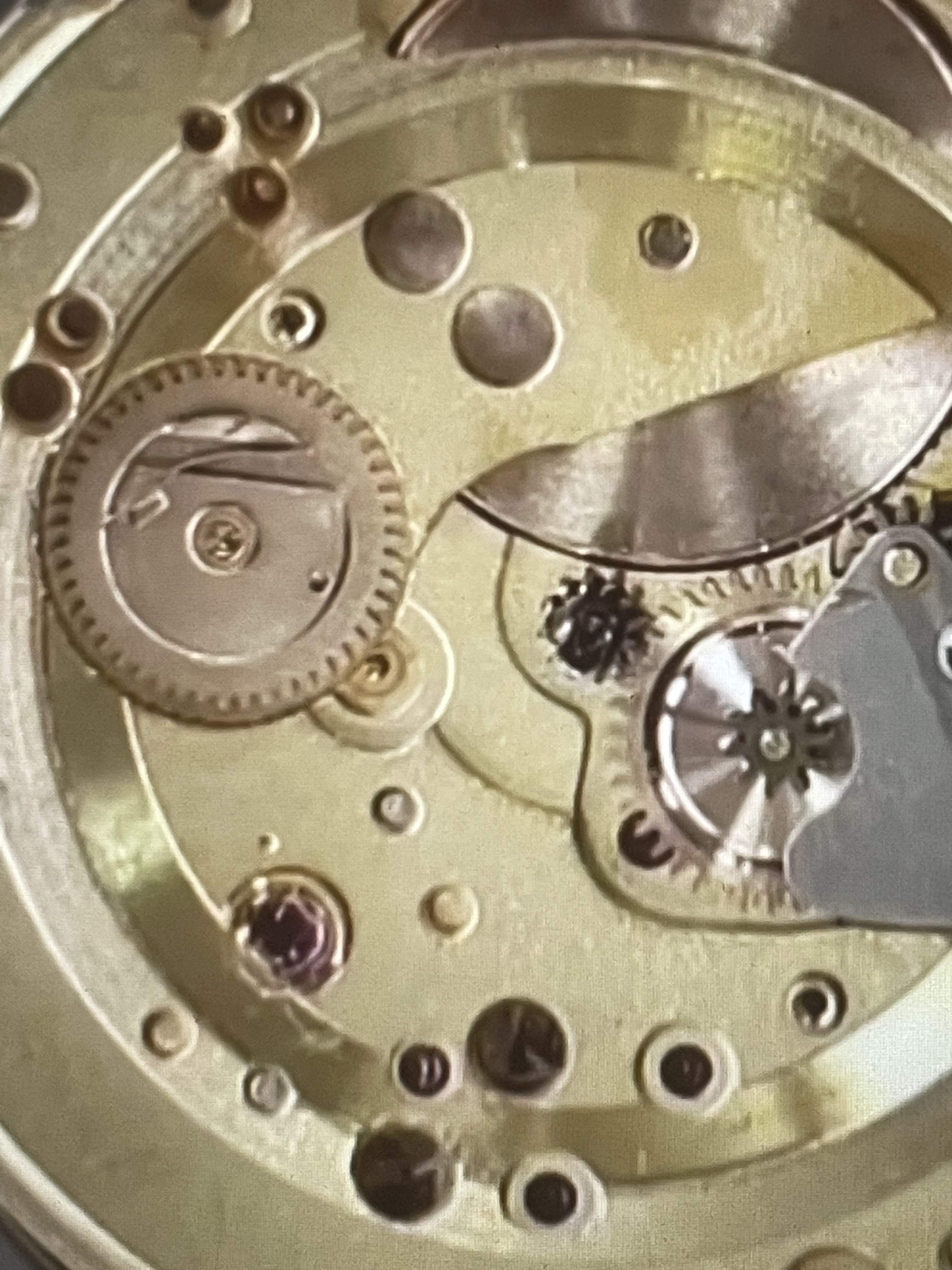

I have a cal 565, 279xxx serial number which I’m currently working on , there are some missing parts mostly on the date mechanism .

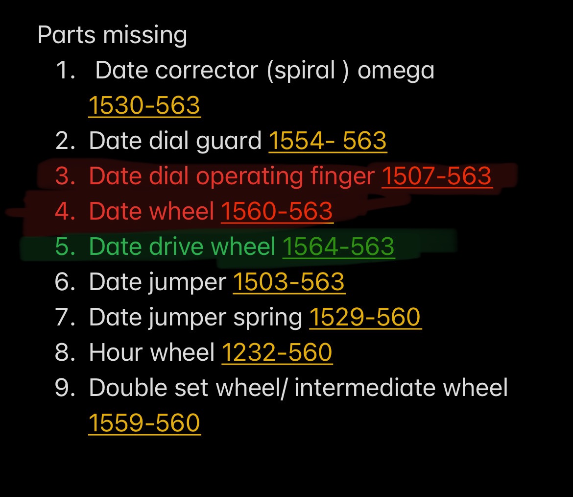

I have made a list of the missing parts but i found 2 versions of the date wheel .

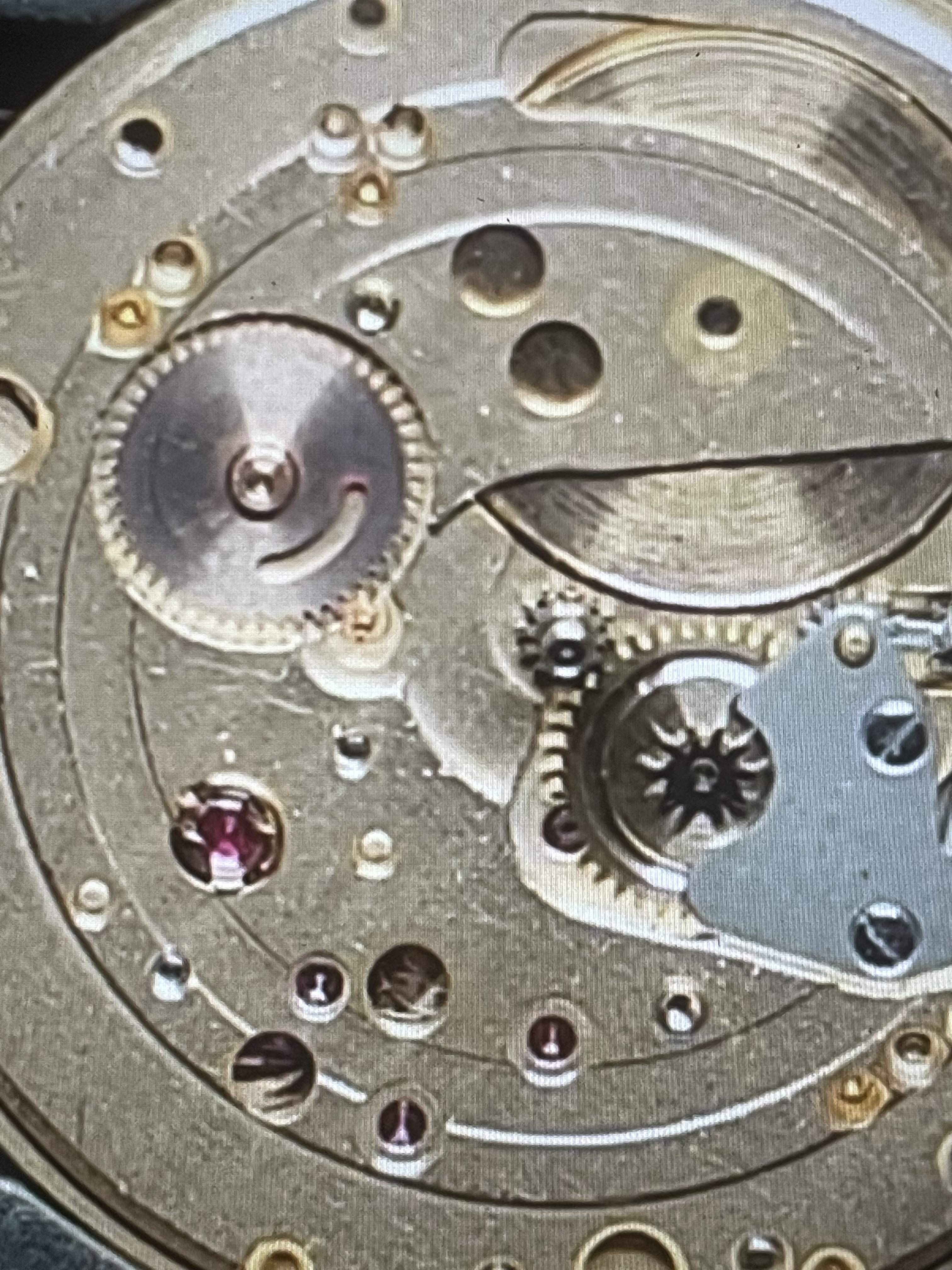

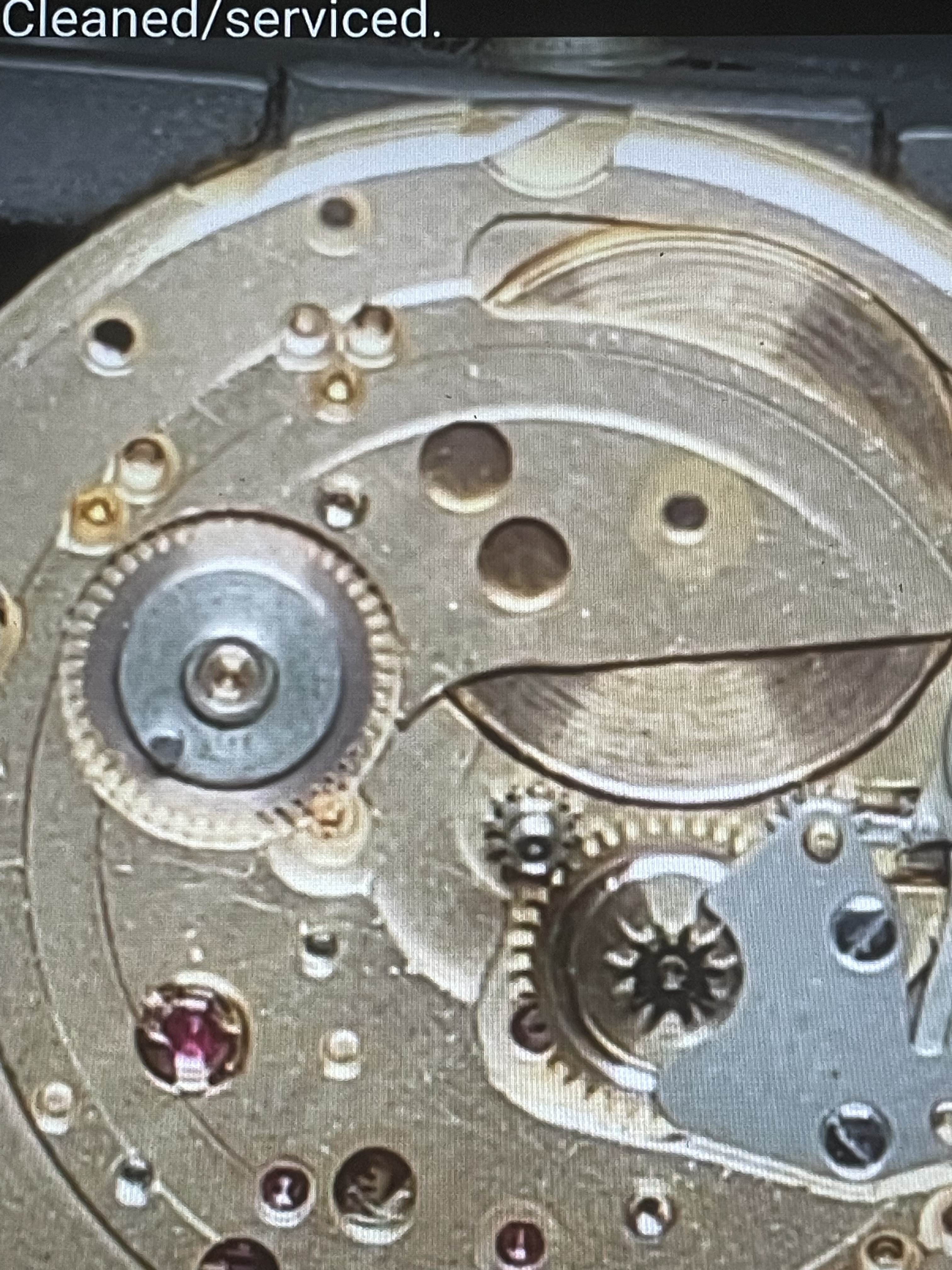

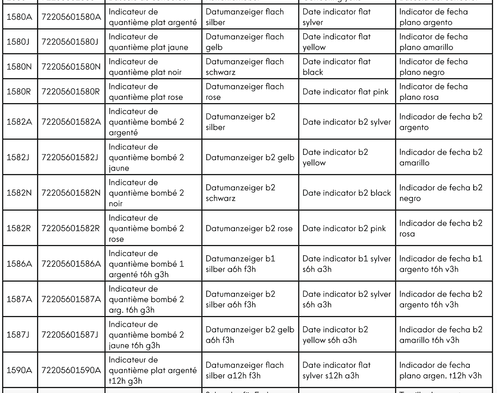

The first photo is from my movement , the second photo is option one which is highlighted in green on the list , the third an fourth photos are the second option which is highlighted in red on the list .
I would highly appreciate any information . thx

that part has been updated a number of times your 3rd photo(563-1564 date indicator driving wheel,mounted), the one with the spring built into the top of the one piece wheel is the most recent version, though there are 2 versions of that with the updated version featuring a small spot weld to prevent the spring from working loose.
are you saying you are also missing 560-1500 date indicator as well? because there are many versions of that in different colours for different dials.

interesting, mine has a date indicator b1 1500 and a date indicator b2 1580, well there are many many variants with the ones that have a curve to match dome dials and the flat ones as well

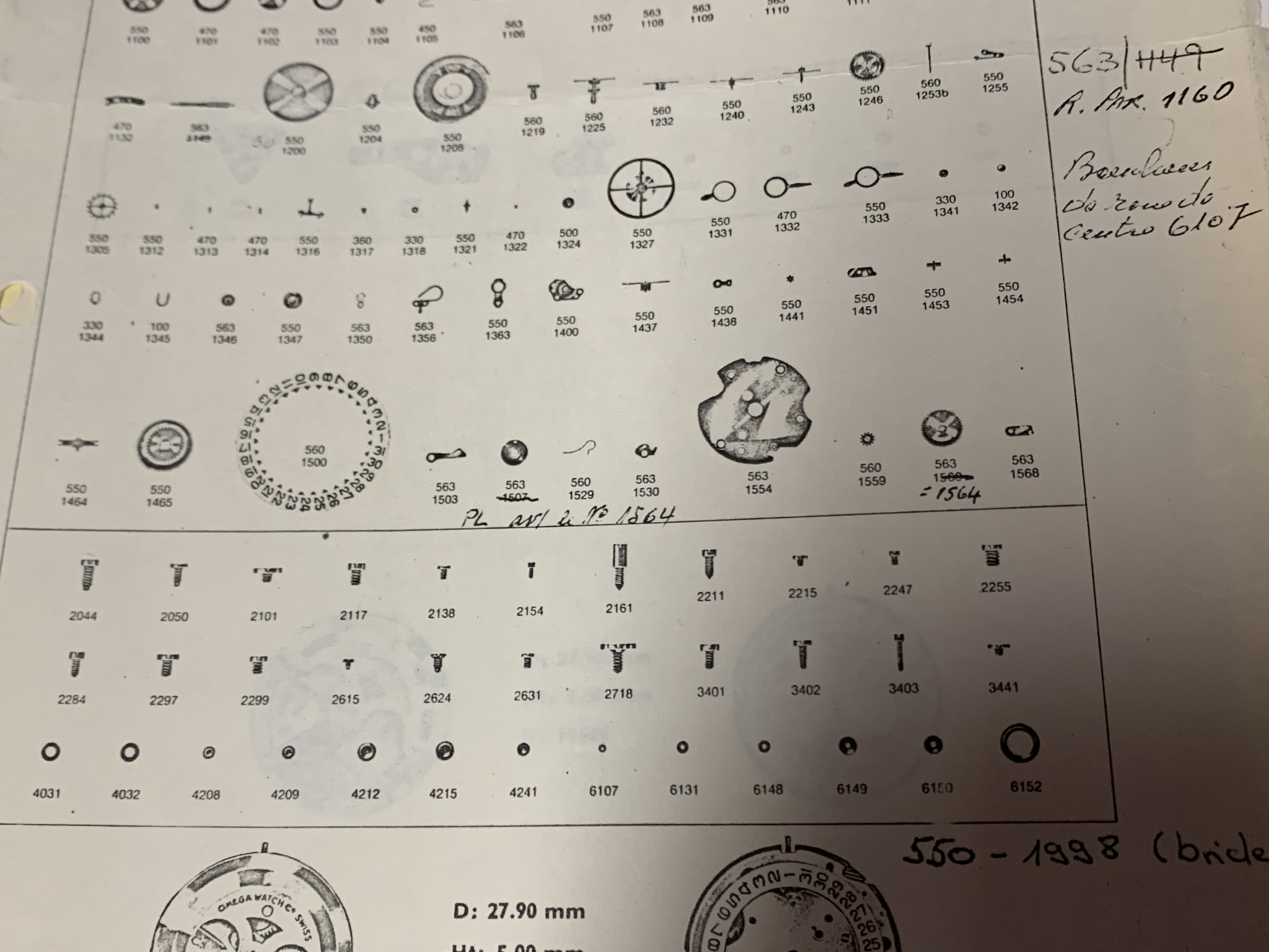

Where are you getting your part numbers (Date dial operating finger 1507-563 / Date wheel 1560-563)?
They don't align with the two tech guides I have for the 563/565.
@Archer explained a similar "part difference" here. Maybe he can shed light here.
https://omegaforums.net/threads/cal-564-quickset-date-question.149529/#post-2108087
from , what i have read here those 2 parts were an older version that then switched to the 1564 instead later on , i got those parts numbers from a few sites http://cgi.julesborel.com/cgi-bin/matcgi2?ref=OME_565 this list shows both i have also found a a parts reference page on cousin’s uk.

I also found clipped into my reference an annotated xerox which shows these part number changes.
The version I downloaded with the 565 addenda has the changes with the spiral variation which this watch has.
good luck with your project !! i am not sure if i will try to fix mine because there are many parts missing and it could be expensive .
i have ordered twice from TM watchco and was very pleased , the first time i ordered from ebay but because im not from the US the shipping was very high , the second time i ordered it was from etsy and the shipping was much less expensive .
that part reference that you found is very interesting , it makes me think that i can use both options as they both fit with no other part changes .
thank you for the information ! , so both of the versions would work for my movement ?

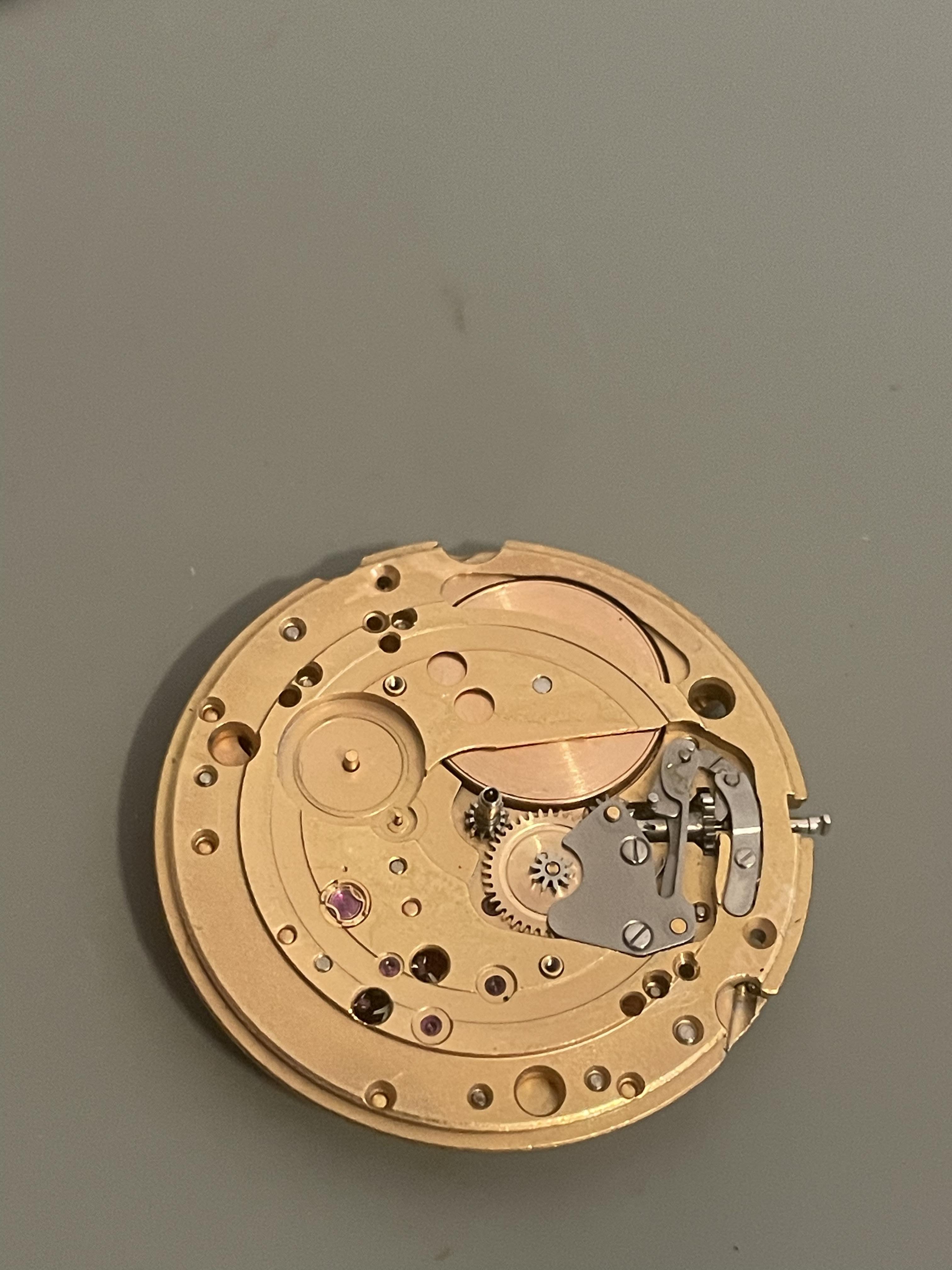

i do have the original date indicator , this watch was a very good condition working watch but a few years ago my father which owns a vintage watch store took this watch to fix a broken one of one of his customers .
he recently gave this watch to me because i am in the process of learning watchmaking .
