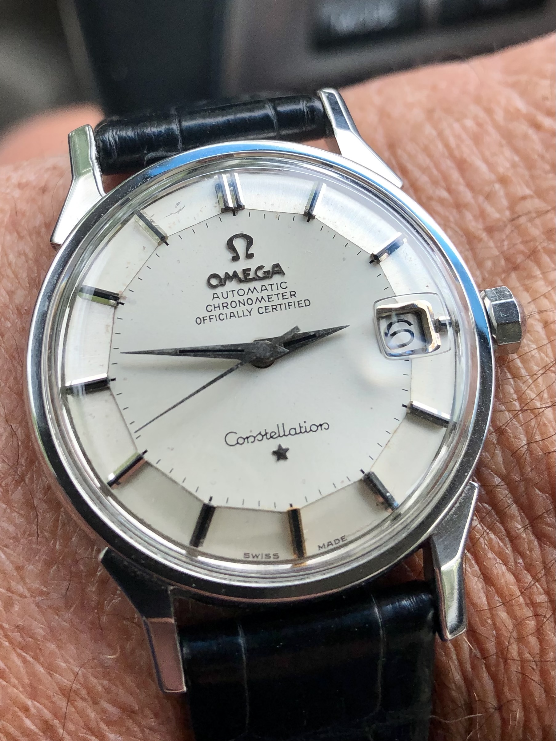

Hello all,
I continue my search for a dog leg Connie, and am having thoughts about looking at a date model.
However my question today is related more to the movements in the date model, in particular the 564 with the quickset date.
I don’t mean for this to be an inane question, and hope that I might get some good insight. I have heard anecdotally at some point that the 564 quickset mechanism can be prone to breakage/failure. Certainly from a logical point of view the method by which the date is set (repeatedly pulling the crown in and out) is potentially stressful for certain components. From a practical and experience aspect though, is this actually the case, and as such is a model with the 561 perhaps more safe, with the tried and tested semi quick set.
Thanks in advance.

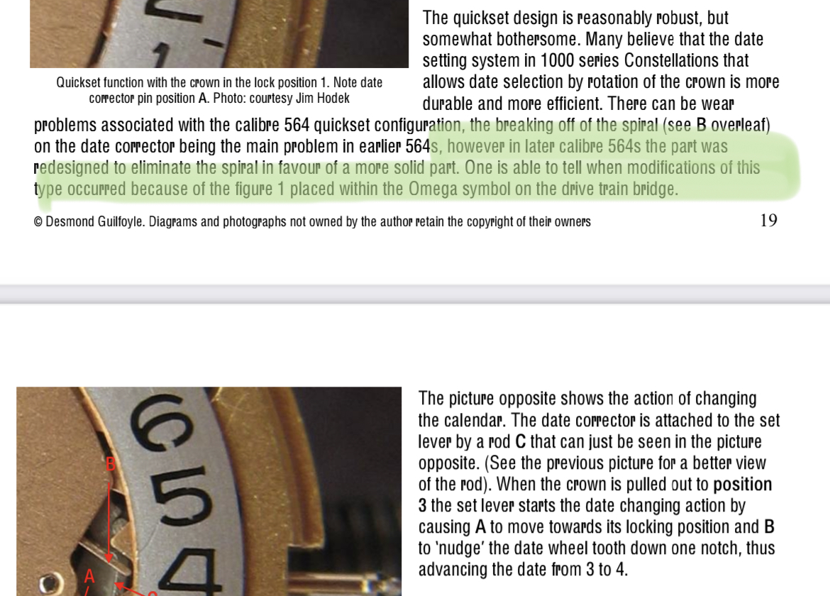

In @mondodec (Desmond’s) essay he mentions that later cal. 564 have an alteration making them slightly more robust. I’ve highlighted the bit where this is mentioned. Does anyone know if this can be pinpointed around a serial number/year? Also, I didn’t quite understand the thing about the figure 1 being placed within the omega symbol on the drive train bridge. Can anyone clarify?

I think Desmond may be in error with that particular sentence, something that is a rarity.
A '1' in the Omega symbol is linked to the hand height for that given dial and is seen on dials with large blocky applied indices that need to be cleared. It is seen on many 1960s movements, not just the 564. I guess the mark may have been introduced coincidentally when the 564 was rolled out, but I don't think it is related to any supposed improvements over the 561.

This information is incorrect on two fronts...
The “spiral” design is actually the updated version, and the more solid design is the outdated version. This change was made to ensure that if there was a quick change made at the wrong time, the date indicator or date driving wheel didn’t get damaged. This design will often just flex and not damage anything, or in the worst case the thin end will break off.
Second, the number inside the Omega symbol has nothing to do with movement modifications. If it did, it would be in the double digits by now because there have been a pile of upgrades done to this series of movements. The number reflects the hand height, which is the length of the sweep seconds pinion, the cannon pinion, and the hour wheel. These are different heights so that hands can clear dials with higher applied markers on them.

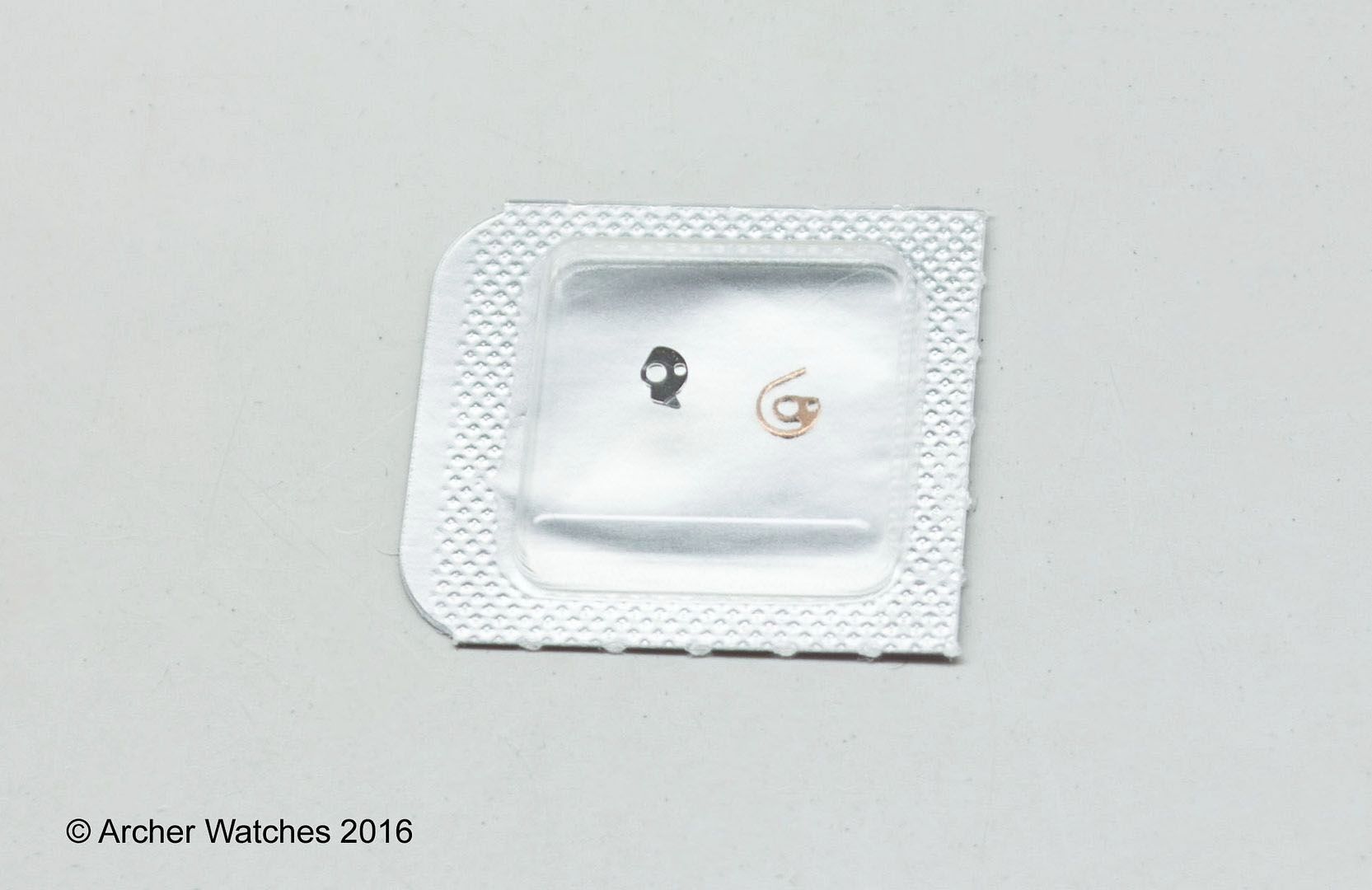

Thanks for this detailed explanation @Archer! Do you have any photos to show the difference between the two different styles of mechanism (spiral and original bit)? Also - what is the reason for using the quick date function when the watch is set to 6.30? Someone mentioned to do this earlier in the thread in order to minimise wear.

The old style is on the left, and the current design is on the right inside the package:
6:30 is just a "safe" time to use the quick set date, no matter if it's am or pm. It's not about wear, but about avoiding damage.
