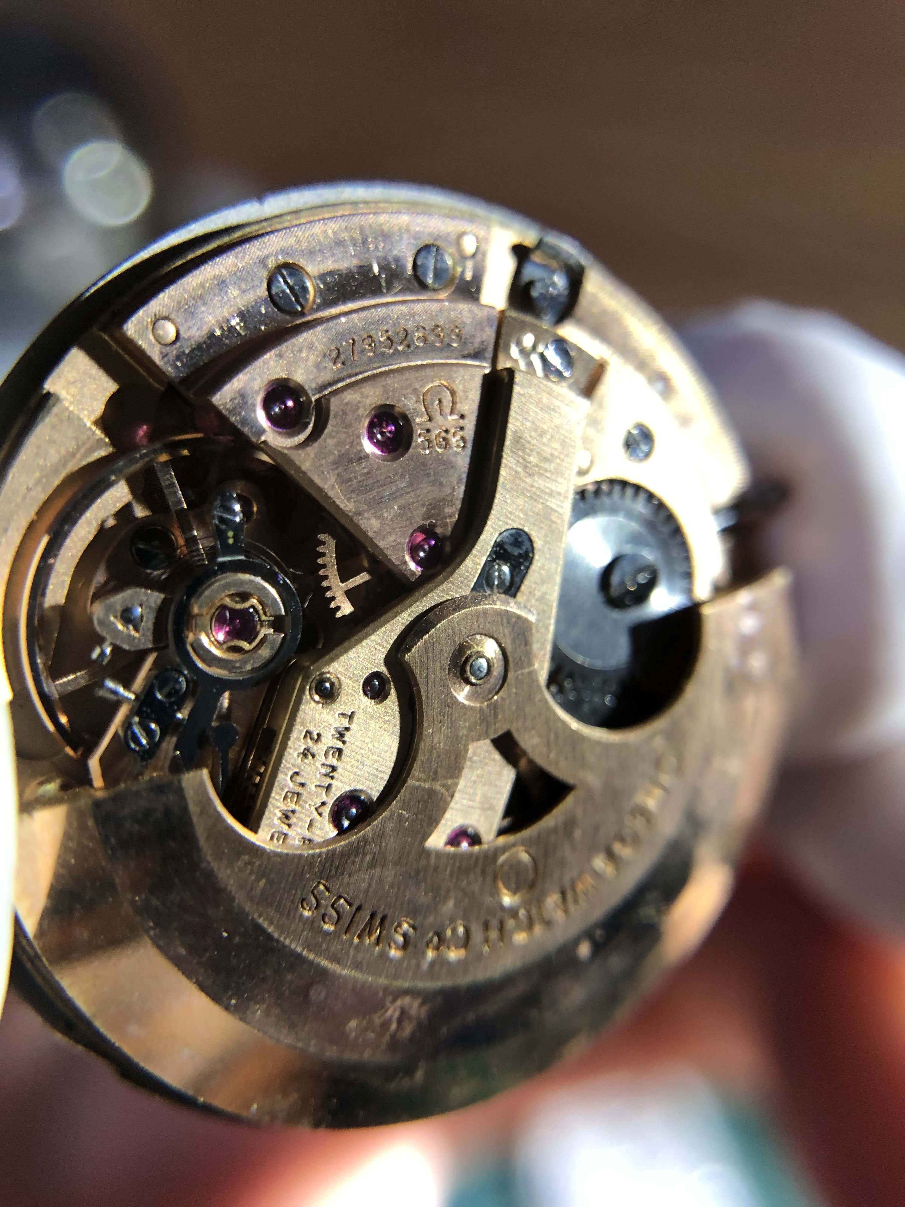

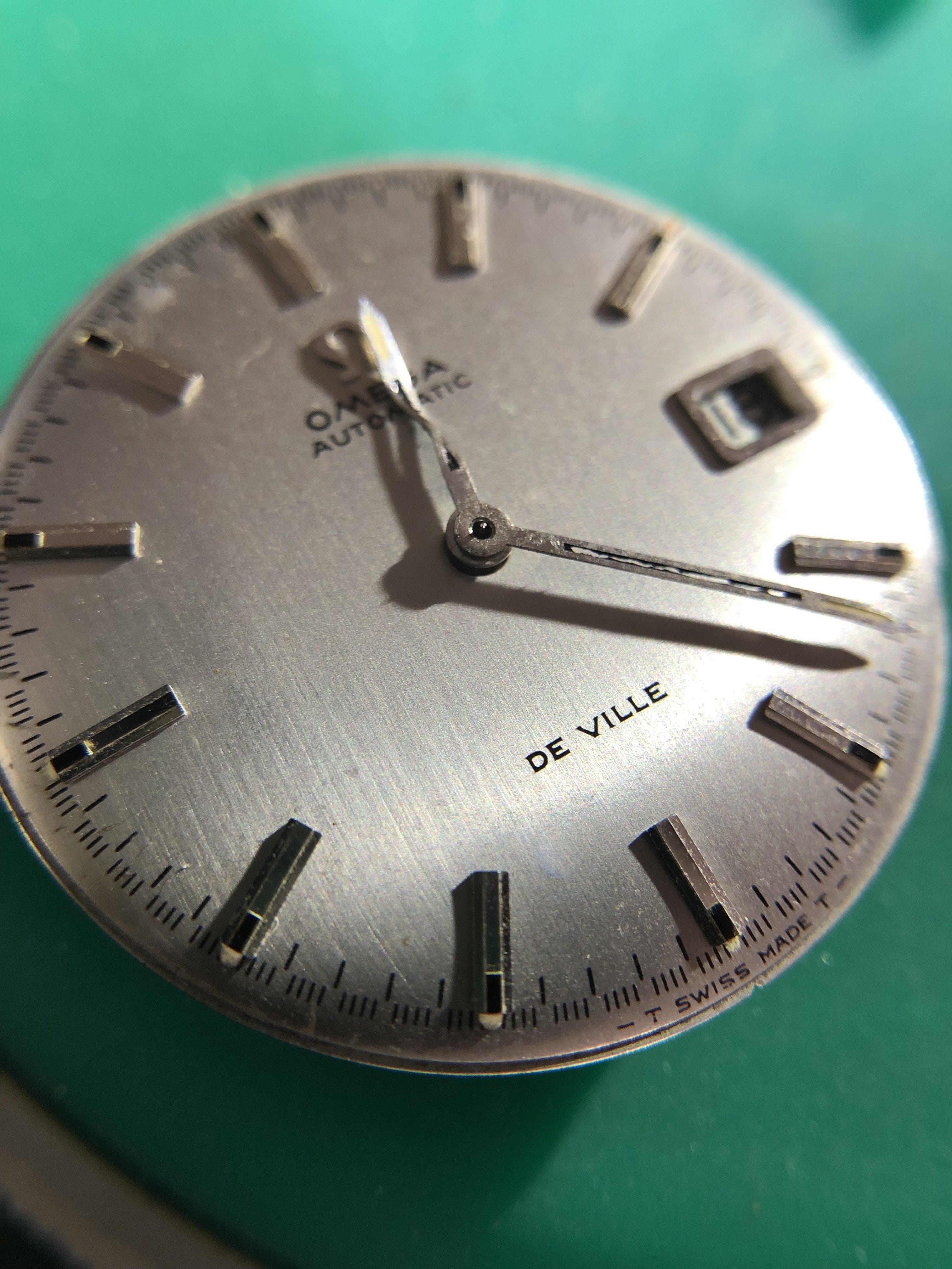

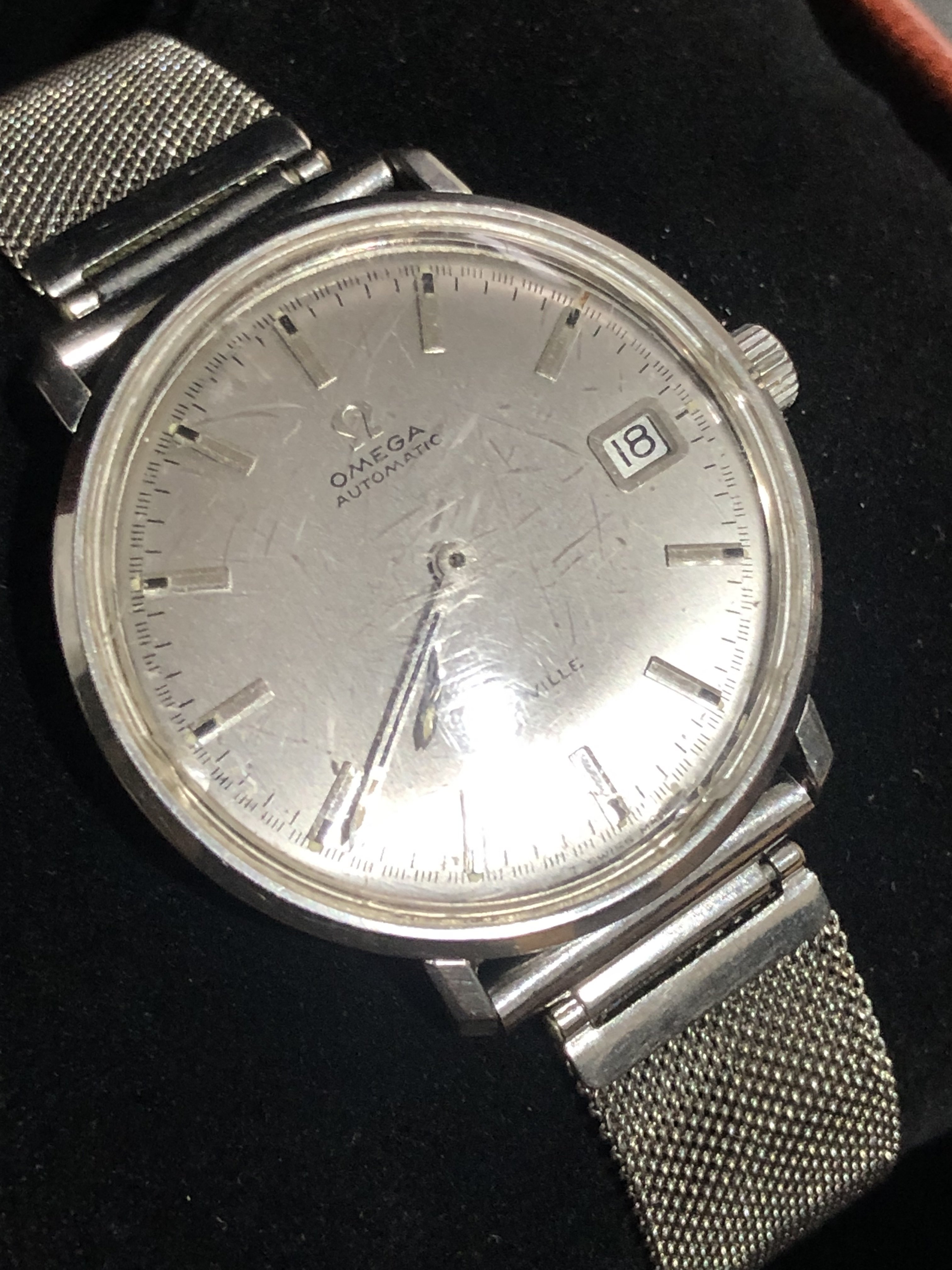

Hi all,
I have been given a Deville Cal.565 Case No. 166.033 with missing sweep second and damaged hour hand to repair. I have scoured the inter web best I can to no avail. Im not even sure how to find the watch hands part number for these. All I know is that it should be 1.50/0.80/0.18 from another forum elsewhere.
Pictures attached for reference, I would be very grateful for any assistance and education on how to find part numbers.
Thank you,
Manny

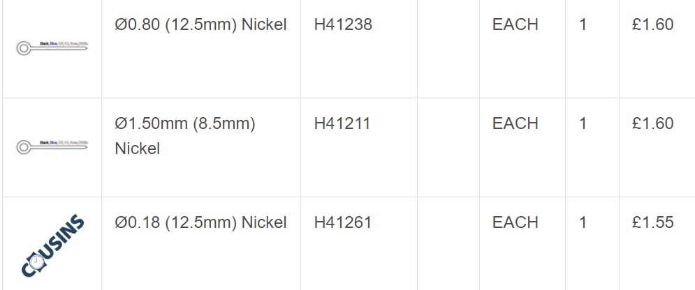

I wonder what hands you ordered from Cousins, last I checked I wasn't able to find any viable 0.8 / 1.5 pairs
But cousins is very cryptic to me, hard to find things

I was able to get individual generic hands in silver, will see how they look once here,the length is not a match either.. This is what I found.

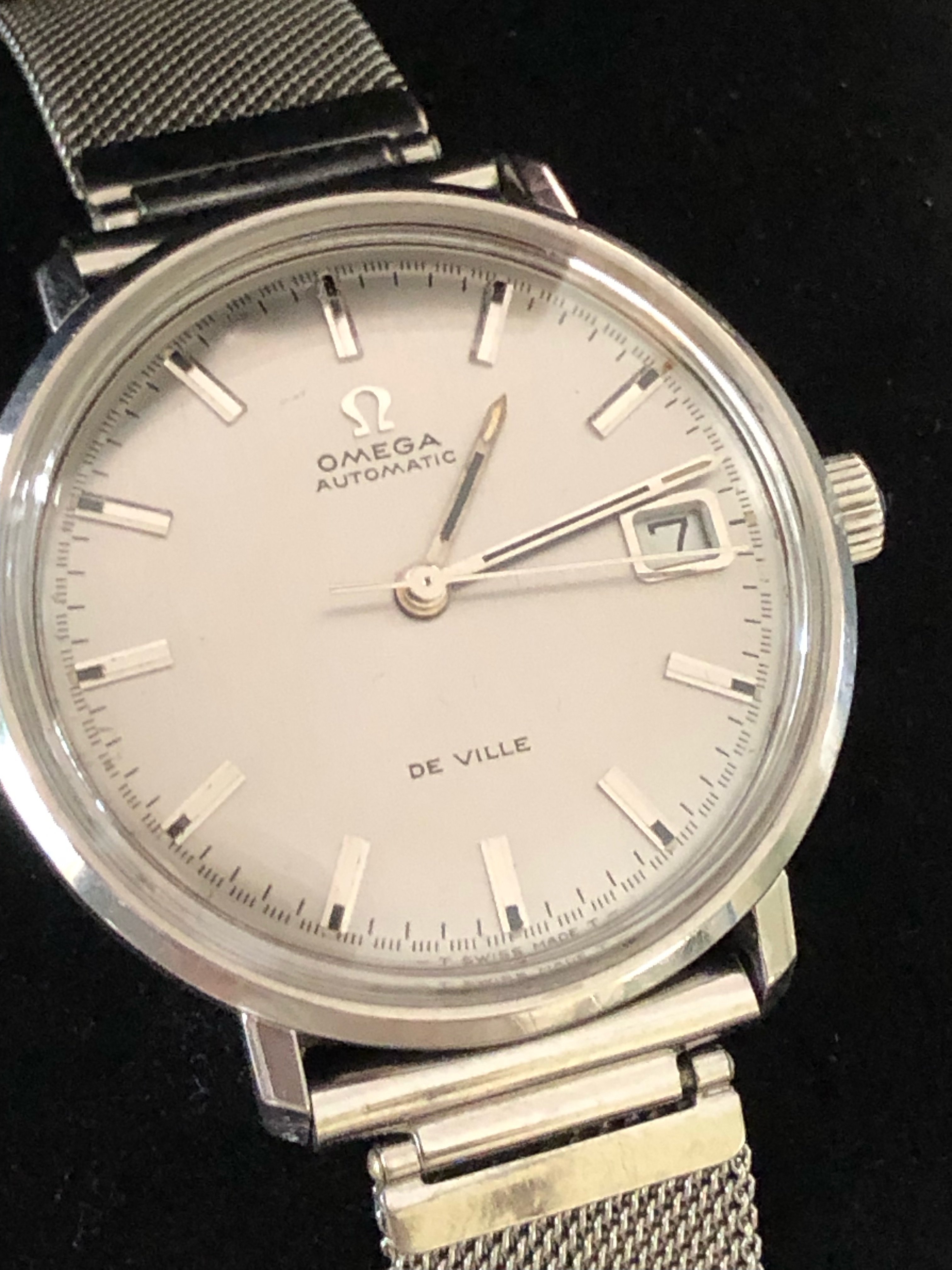

Thank you all for your kind assistance. I never managed to source the correct hands and my friend did not want to spend any money or as little as possible on the repairs. He was agreeable to a repair of the hands with the backup option of replacement with straight nickel.
For those wondering how this turned out - I managed to repair the hour hand best I could and repaint both black and lume insert. Perfect - not by a long shot. Replaced missing sweep second with generic from Cousins (above) and with watch now working properly (repaired the date corrector and quick set date mechanisms as both were not functioning and replaced the crystal with a genuine). The watch isn't in perfect condition by any means overall.
I will call this one done. Pretty happy with the outcome to get his late grandfather's watch out of the drawer and on my mate's wrist. Down the track a full service in order but with my couple of months experience in the hobby, this will be enough for now and my mate got away with spending $100AUD.

I think you did a great job, and it shows a lot of patience and attention to detail. I suspect that the H/M hands are going to look fine to the naked eye. TBH, the shape of the sweep hand is what bothers me the most, but that's only because I know what they are supposed to look like. 馃槈
