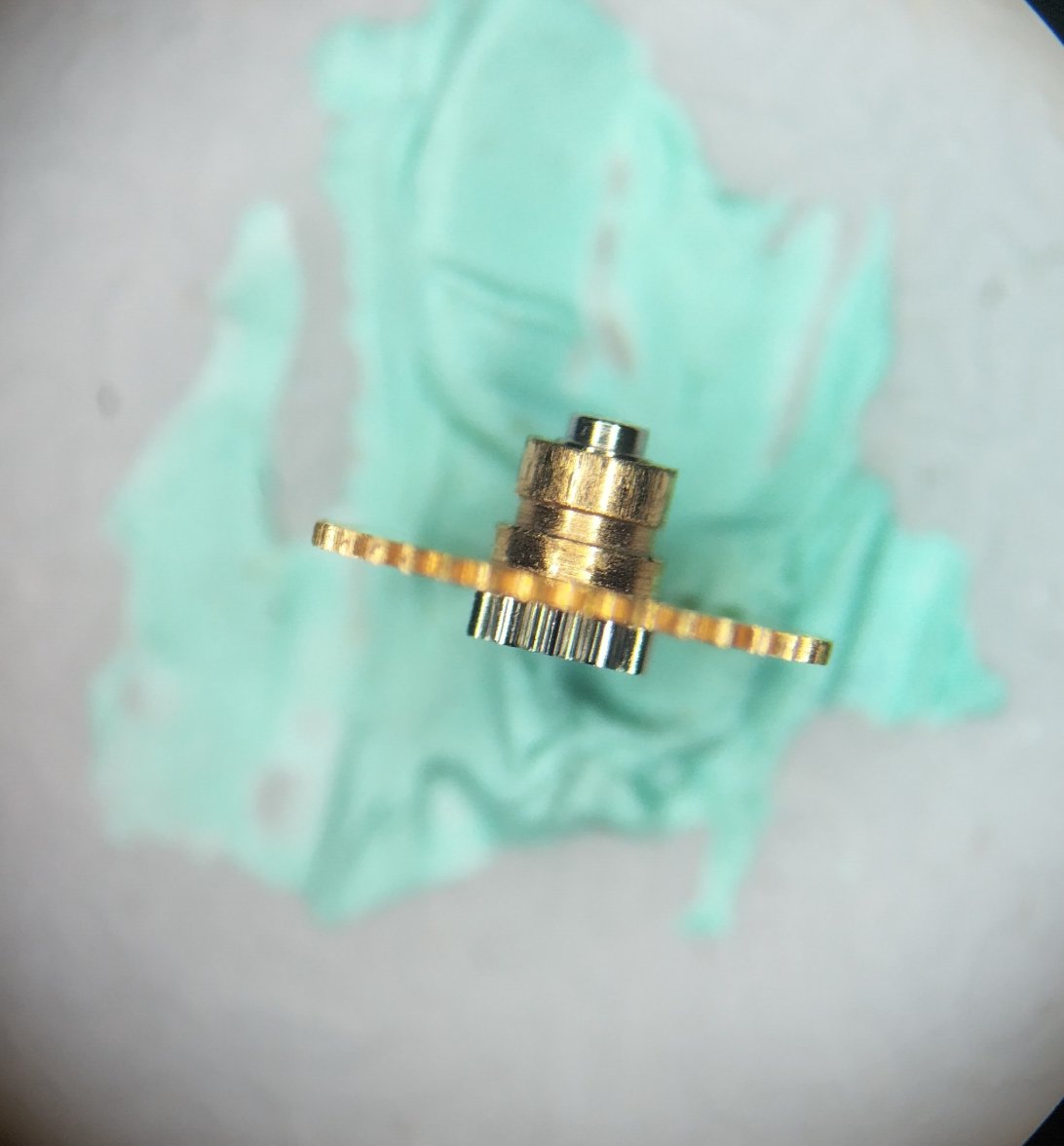

I have nearly finished the restoration of an early 1950's 'bumper' and it has been a joy to work with such astonishing craftsmanship. Unfortunately I mislaid the cannon pinion during cleaning and so have purchased another. It was sold as 'used' and should be part 351-1218. I realise that we are looking for an interference fit on the centre wheel shaft and note that the new cannon pinion has a professional looking crimp on both sides of the middle of it to provide this 'interference', but unfortunately the replacement cannon pinion is too tight to get more than half way down the centre wheel shaft. So my question is whether Omega matched an individual centre wheels to a cannon pinion in house to make a matched set? in which case presumably I need to ream it to a sliding fit (how?) and then re-crimp.Or have I been sold the wrong part?
Photo attached and any guidance would be much appreciated.

The parts list usually shows these together. Canon pinions listed separate, but not center wheels.
They come in different heights. That can often be the only difference between calibers. The dial/calendar mostly determines the height.
I recently got an assortment of bumper parts. Canon pinions seem to often be lost. I have found loose fitting more common that tight fitting. I have a staking attachment for tightening them.
Online sellers often do not really check the subtle differences. Parts in estate lots often get mixed together. There is also the risk of someone dumping broken parts. Once got an assortment with half a cannon pinion vertical. Tips are also often missing or damaged. Makes for much of the challenge.

Could be the wrong part - really no way to tell when you are shipped a loose part like that, so you are at the mercy of the seller on that front. The crimp doesn't look particularly aggressive or anything.
Cannon pinions and center wheels are sold separately, so there is no factory "matching" done. However it's not unusual for new parts to need some tweaking.
You can open up the ID of the cannon pinion using either cutting or smoothing broaches - both if you have them. Just work it a little at a time until you get the right fit. Don't forget to apply a little grease to the recessed area on the center wheel, just to keep the cannon pinion from seizing on the center wheel over time.

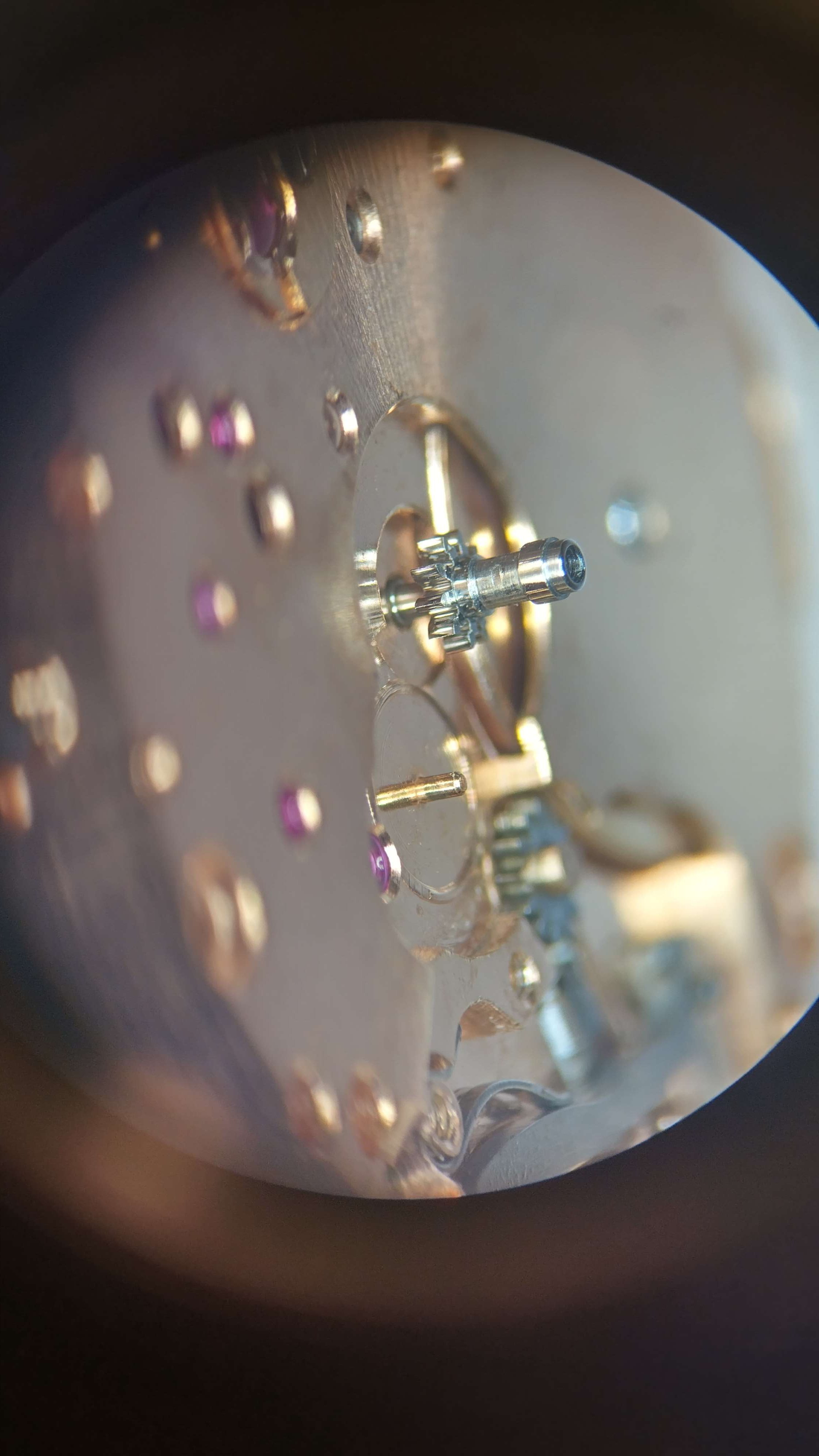

I'm learning from you that cannon pinion height is varied and my replacement one measures 2.2mm. Of course I don't know what it should be although I see that some sellers advertise at 2.5mm, so I have test fitted it to the original hour wheel to see what end clearance I'm left with. Photo attached and I would be grateful to hear back from those with more experience than me on whether it looks right?
If the height is OK, then I will keep the cannon pinion and do as Archer suggests by investing in a set of broaches. Any recommendations on sets/brands or has it to be Bergeon?

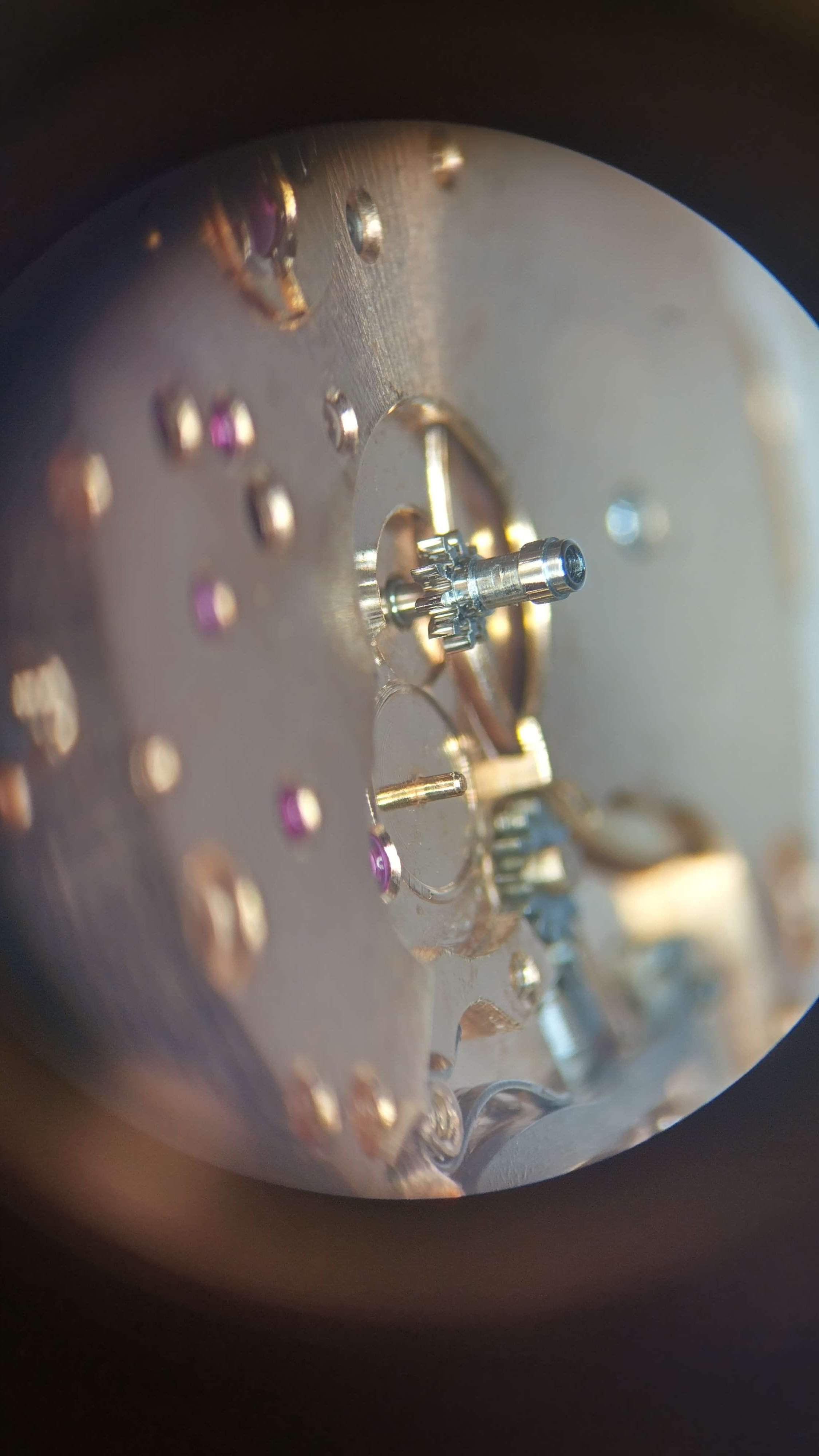

Thank you both for taking the time to respond, much appreciated.
That looks correct. If you think about it, if the minute hand is fully pressed onto the cannon pinion, it should be just above the hour hand, which is usually pressed flush with the top of the hour wheel.

There's 3 heights
Caliber 350 - 2 mm
351, 352 and 354 - 2.2 mm
353 and 355 - Calendar - 2.9 mm
I use Bergeon - Set 4338 and if needed. Smaller set for hands
