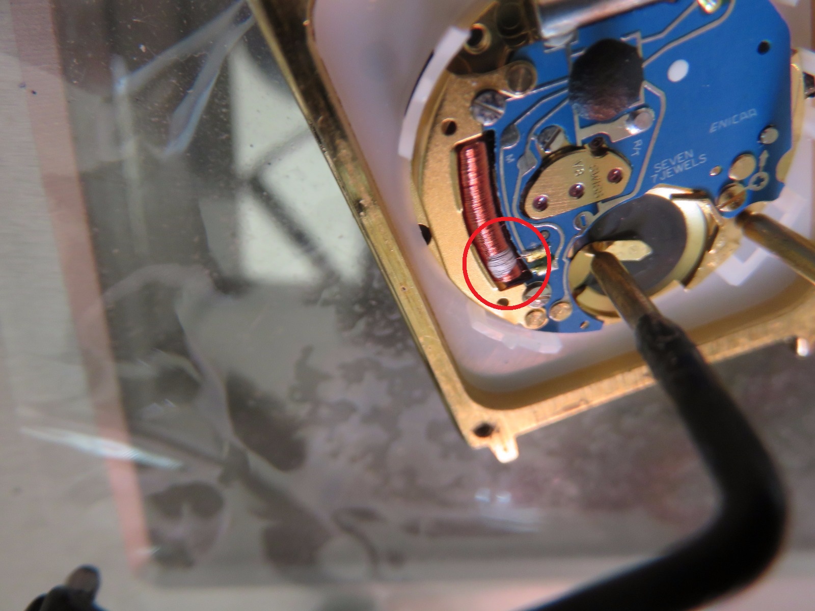

Well, looking under the microscope I was able to see that one of the coil wires was separated from its pad, someting impossible to see under medium magnification. In the spirit of the hobby I took up the challenge and grafted a small piece of wire from a coil out of a quartz movement I had previously replaced and basically extended the broken coil wire and after a few tries I finally managed to solder the two ends in place. Quite a challenge. Interestingly enough, I now see the second had flickering back and forth very slightly but no forward motion. Anyway, I know I'm probably postponing the inevitable to either get a new electronic module or pay a bit more and replace the movement altogether but in the meantime I'm learning something about quartz movements and also reminds me why I never warmed up to them which explains why this watch sat idle for such a long time. I also honestly don't see myself investing in any specialized test equipment since I hardly ever spend time trying to troubleshoot quartz movements, of couse with the exception of this one. By the way, all my research so far seems to indicate that ETA 255.461/462 is a direct (physical) replacement for the 1441/255.561 and would appreciate to hear if anyone has personal experience contrary to my findings.

By the way, one of the technical documents/links that sirtaifun had kindly shared earlier did include the testing procedure for the electronic module and I didn't read it all the way to the end and completely missed it. The test also confirms a faulty coil. I also decided to go ahead and order a fairly inexpensive test device which seemed to have good reviews. I should receive it tomorrow. I'll see if the mechanical side works, if not, the rabbit hole will get much deeper...I suppose the movement could use an unplanned service...

Soldering these would be quite tedious, so most coil repairs are done using something like this:
https://www.grobetusa.com/vigor-circuit-maker-item-no-ce-590890/
Although quartz movements can have electrical faults like damaged coils, they can also have mechanical issues, and keeping in mind that even a very small piece of debris can bring a movement to a halt, if you still don’t get movement of the train after all this, the mechanical portion may need to be serviced.

As for me it sounds like an mechanical issue. I would service the movement according the ETA specs given.
BTW coils can be repaired using silver solder also.

Just a quick update: I received the device and tested the the watch. The hands spin freely so it looks like the movement is mechanically sound. However, there's no heartbeat from the electronic module which is what I expected. The module has a bad coil and I have exhausted all options within my skill set with the tools that I own to fix it. The next step is to decide whether got the replacement module or just go for a new movement. By the way, for $25 with free next day (Amazon Prime) delivery this little test unit is pretty handy for testing the mechanical train as well as the electronic pulse. It also has a battery tester but any basic voltmeter can do that.

Just curious: Did you test the device with another functioning quartz movement?
And as I mentioned earlier coils can be repaired using silver solder:

I always check the test devices with known good units, especially the cheap ones coming from overseas. It works just fine. I don't have any silver solder at the moment but will fiddle a bit more to see if I can bring the coil close to the specs shown in the technical documents. Not very optimistic. And thanks for the links. I'd run into them when I started down this rabbit hole...
