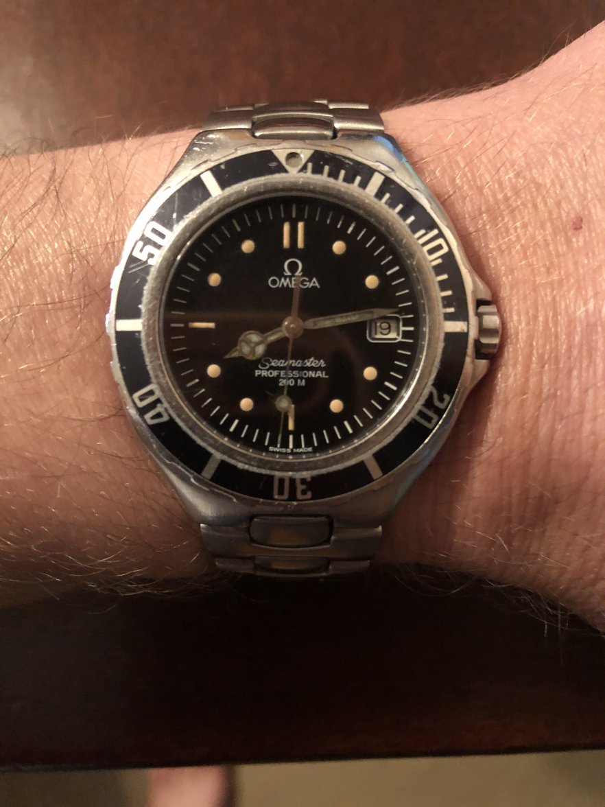

Hello All!
I purchased this Seamaster 200m a couple weeks ago off ebay. Per some research it looks like it is a 1987/88 based on the mercedes hands. It has the 1441 movement. I do not know when it was last serviced but it runs well and everything functions. The only issue I am having is with the hour hand not aligning up directly on the hour. I can adjust it in the morning to be exact and it will be spot on all day, but the next morning it is a minute behind again. The only thing I can think is it has something to do with when the date changes over at midnight. Anyone have any thoughts or had/have a similar problem? I love the watch and its not a huge deal, but I does bother me a bit!
Thank you!
2,820
5,902
It’s unlikely to have had a recent service given the amount of misalignment - looks to be about 14 minutes out. It needs to be within one minute for it to be acceptable. The date change will have no affect on hand alignment. Some date-change movements will cause the hour hand to jump forward slightly, but only at the point at which the date changes - there’s no consequence on the hand alignment. People have different tolerance levels when it comes to issues like this, but ultimately it’s just lazy watchmaking/servicing. A good watchmaker will service it and sort it out for you. They’ll also put the date misalignment right for you as well - doesn’t look central within the window to me

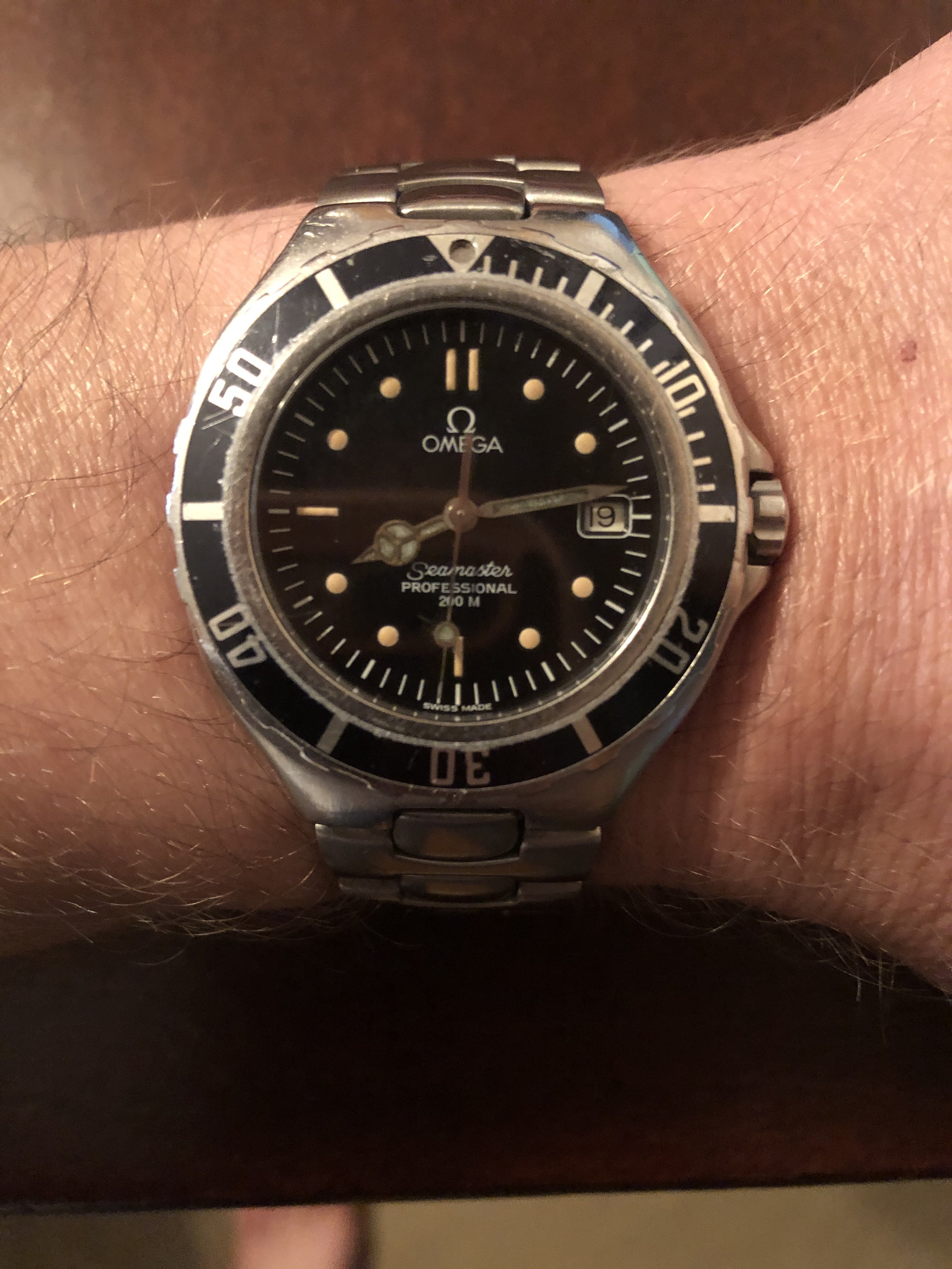

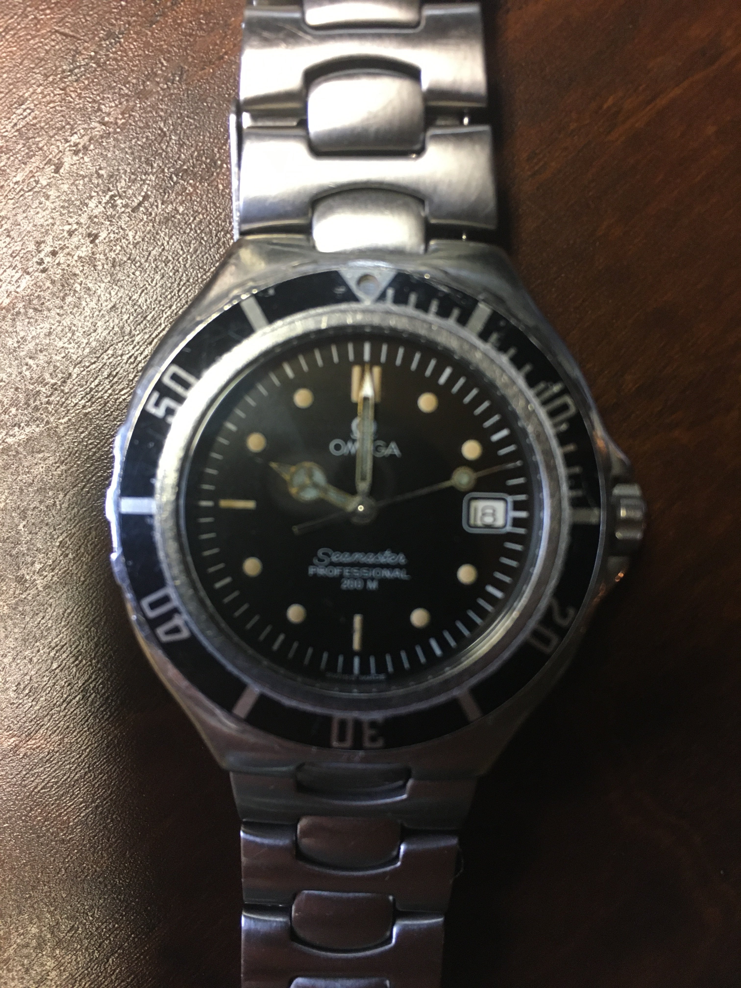

Yes I know about the time zone feature and used that to set the time when the watch arrived. While it does jump one hour, I can also make small adjustments with it. So the past couple of mornings I have been able to set it right on the hour (the date will center in the window as well). I set it exact this morning at 8am (see pic). By 10pm its still all aligned, but in the morning at 6am the hour hand is slightly behind and the date is misaligned again. The hour increment position seems to be very finicky, sometime when I push the crown back in when I have the hand set it will jump back/forward a minute or two.

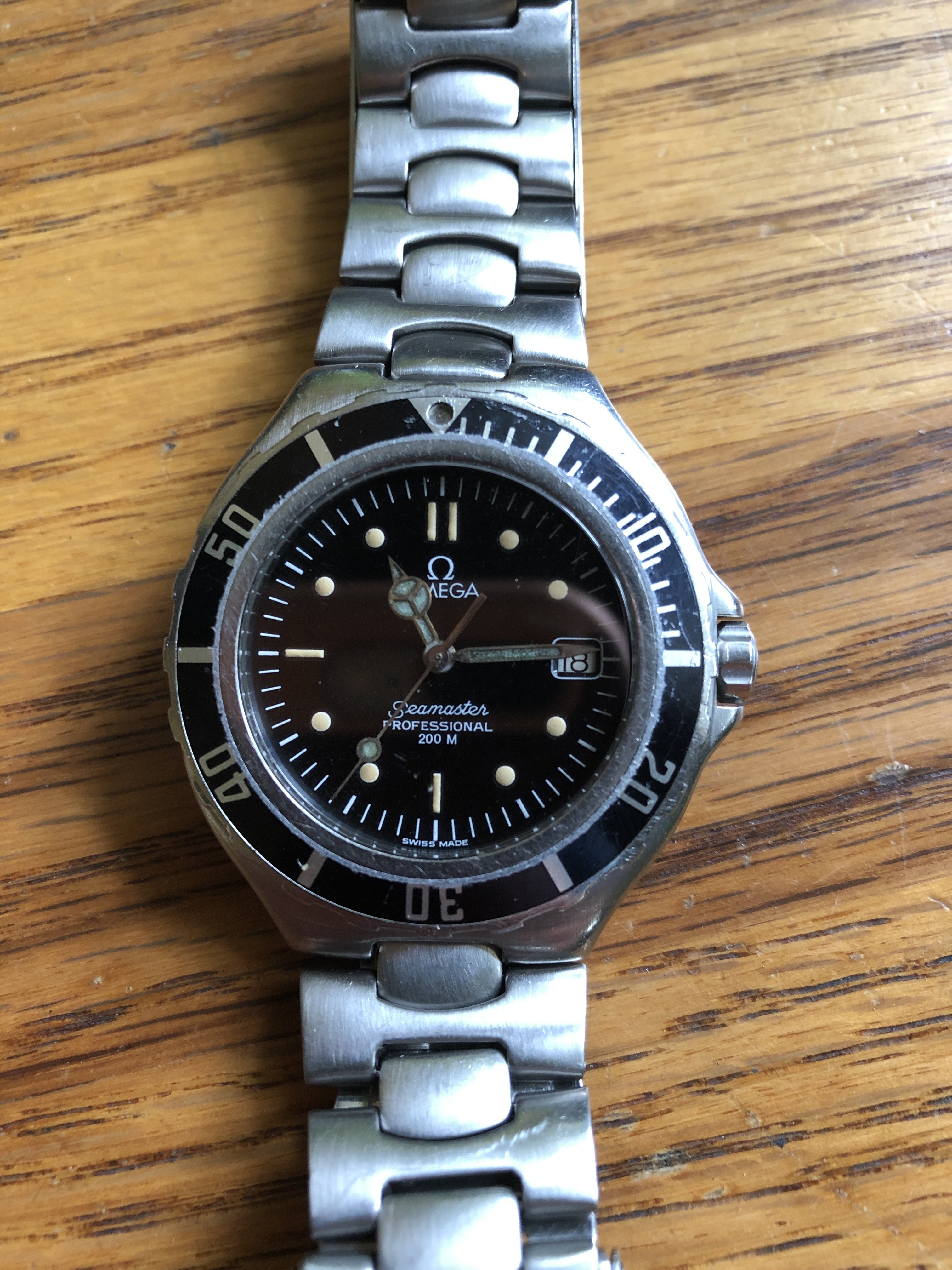

This morning it was exactly an hour behind. I manually wound it past midnight and sure enough the hour hand jumped back an hour.
30,274
78,128
You probably need a new hour wheel...
